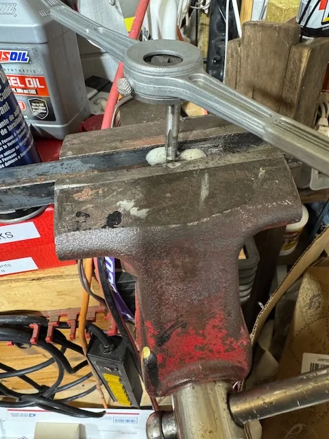

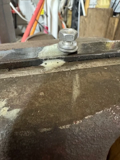

Every day I want to get this finished but the first 6 hours of the day went by quickly, picked up my 10 yr old grandson, he helped with a bunch of other things and blew leaves, under supervision. I did get this 3/4” square measured, drilled and tapped..welding tomorrow

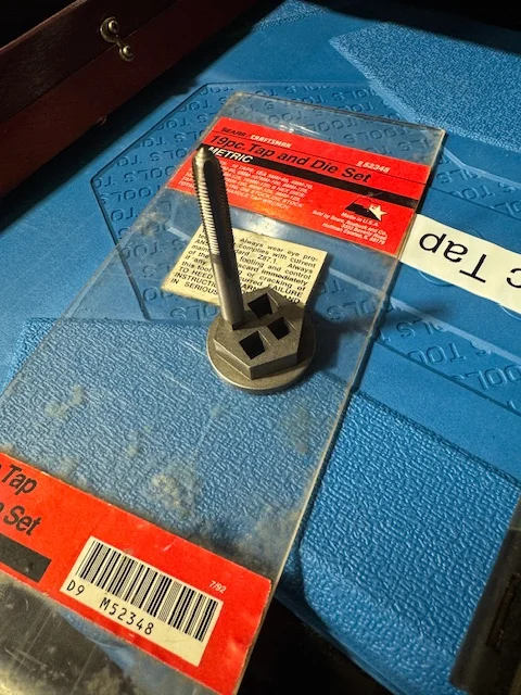

It got the job done and THAT is what came in that Craftsman metric tap and die set in 1994. I could have used the new set I bought last year but, first in, first out. FIFO.
It’s an odd set, this was made to support 4 different sized taps. But as I say, it worked fine. Got 4 of the 3/4” thick holes tapped in under 9 minutes

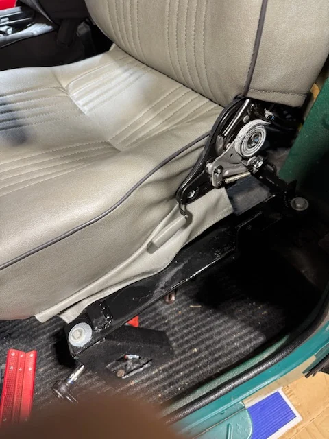

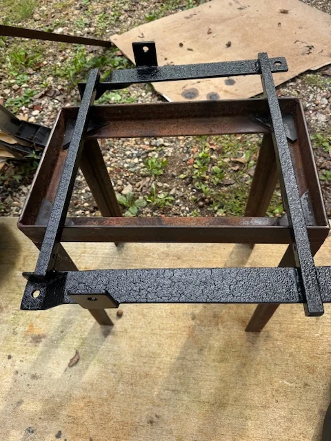

This seat adapter I had made really knocked me out this weekend. I was trying to be 101% sure it was perfect and bolted the seat to it 5 or 6 times to triple check the alignment to center and lifted the seat in and out over a dozen times. I don’t have that kind of strength anymore but the drive to get it right must have given me the will power.

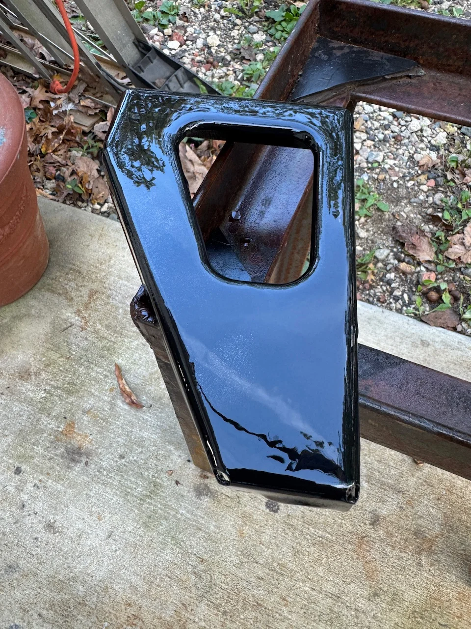

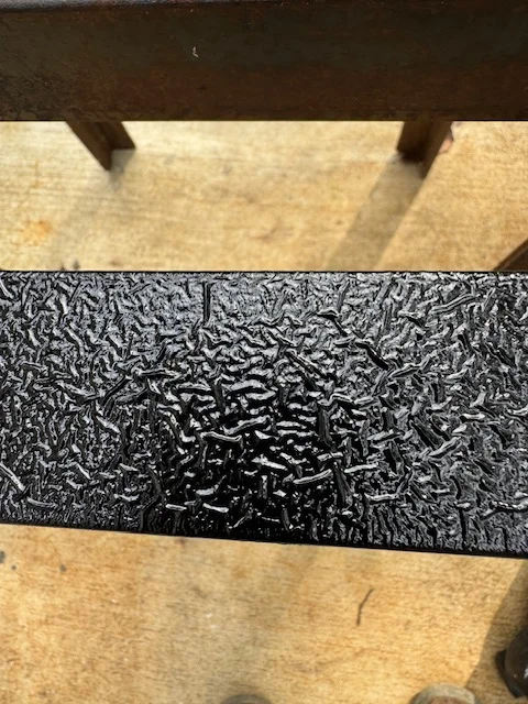

A few tack welds did not hold it squarely or flat… so a 12 hour job but…. It is done. Then, I’d painted it gloss black waited the recommended time using compatible solvents and the unspeakable happens.
I’ll take it for powder coating eventually but I’m using it until the snow starts

My 1 front driver seat mount was Raptor coated while the rest of the front seat frame is gloss black. Once thing about the Pro-Car seats is positioning the center console. The inboard tabs for the seat belts interfere with the rear end of the tab reading the floor. I made and extension to mount the console tab about 2 “ higher …works fine. My new friend James mailed me a front seat bracket. It came in today’s mail, sanded and cleaned up and is already under the seat. With all of the lifting and and taking out …the seats are the same height and about 1 1/2” higher than stock. I love it.
