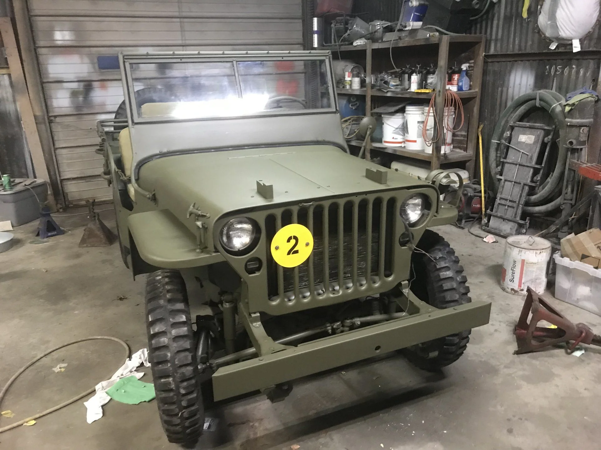

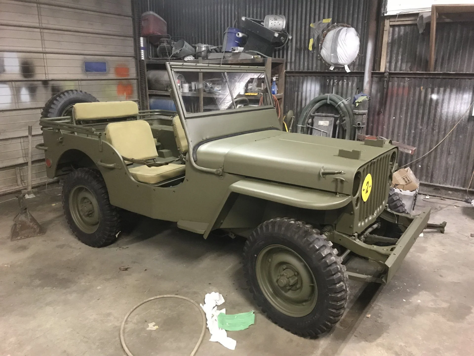

I know this isn't land cruiser related but now that I'm done with this hopefully I'll have time for my own project.
It still needs the stencils but the owner is going to have a guy that stencils all the old military vehicles and airplanes around here do it

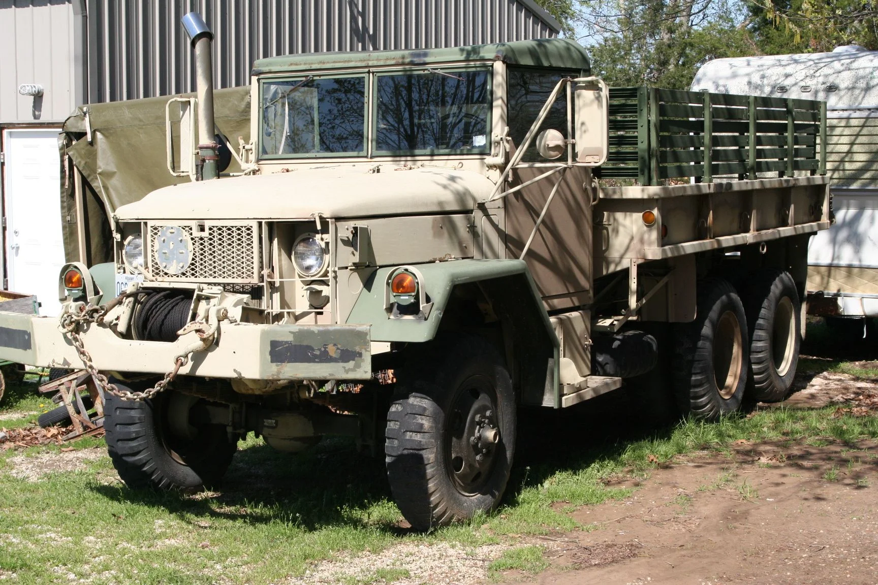

sweet i have a 41 wc12 dodge powerwagon that i arsenal refinished , love old military stuff hence the cammo pig
I love those M35. The guy I did the jeep for wants me to do a M35 for him too. I just don't have the time for it. It would be fun though.
