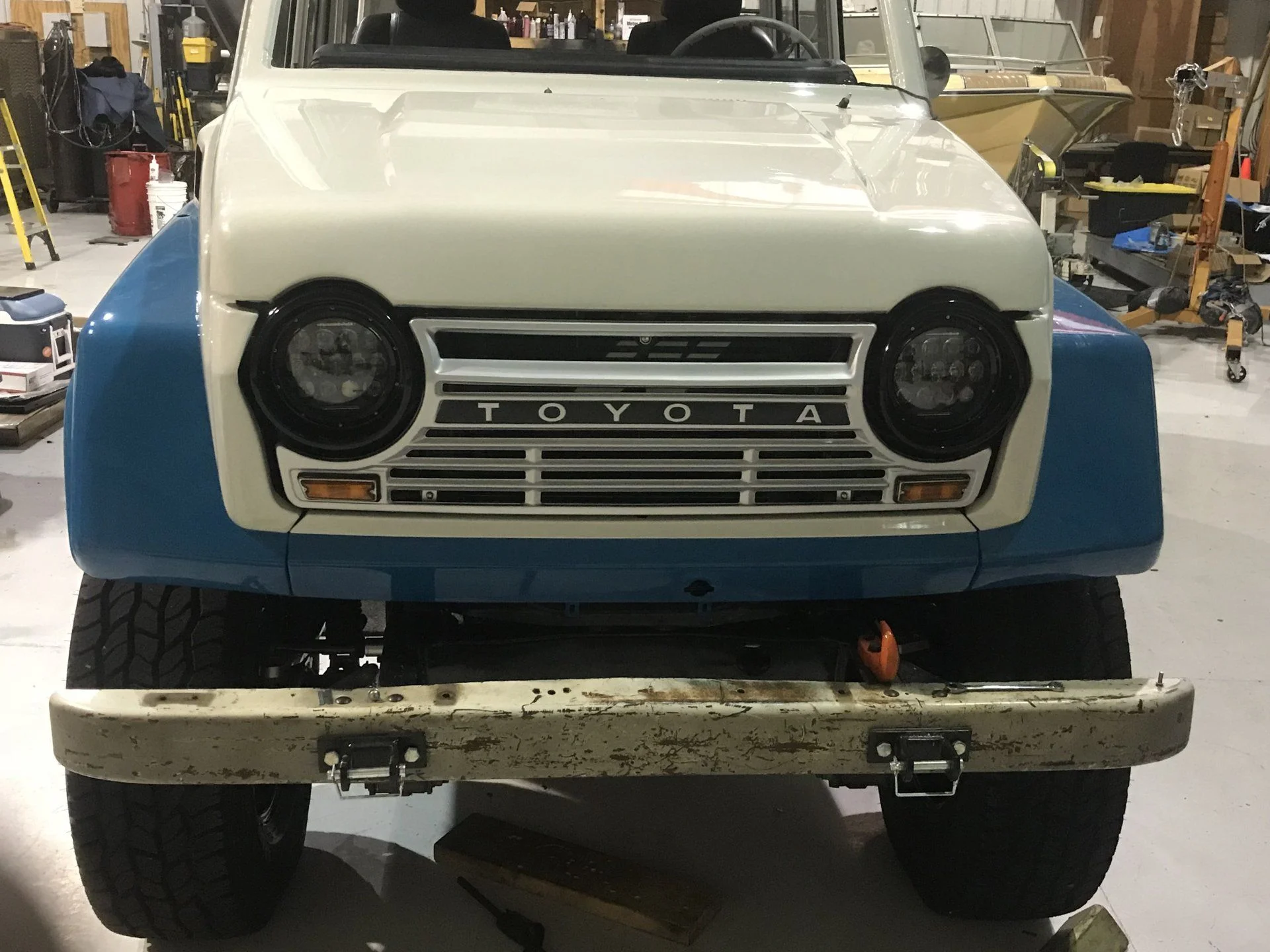

I got the turbo back and installed. No leaking of oil. Nice to have hat issue fixed. I even got to drive it for a few minutes today. It ran well and there weren't any weird little issues. I am a little concerned about my gearing.
I also got all the fenders and good back on so it's finally looking like a real vehicle.
