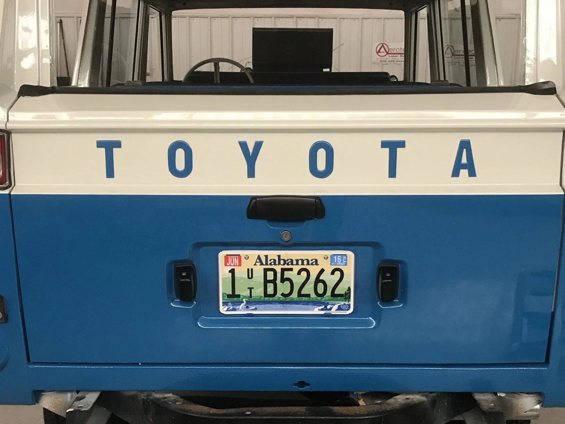

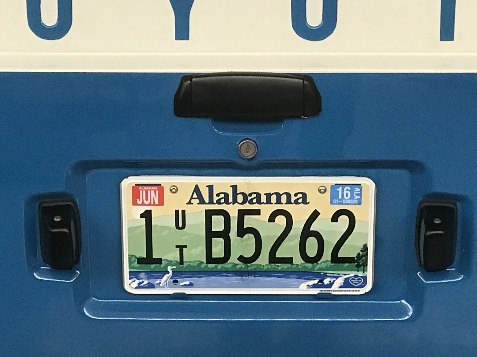

  • Thought they posted it was late. Here you go.
My tailgate handle never had the spring on it. Is there a spring that you guys are using to replace the factory one? Any suggestions?
I installed the handle and it works. That's a relief. I'll try to paint it in the next couple of days and get it installed. It'll be nice to get the tailgate finished up.

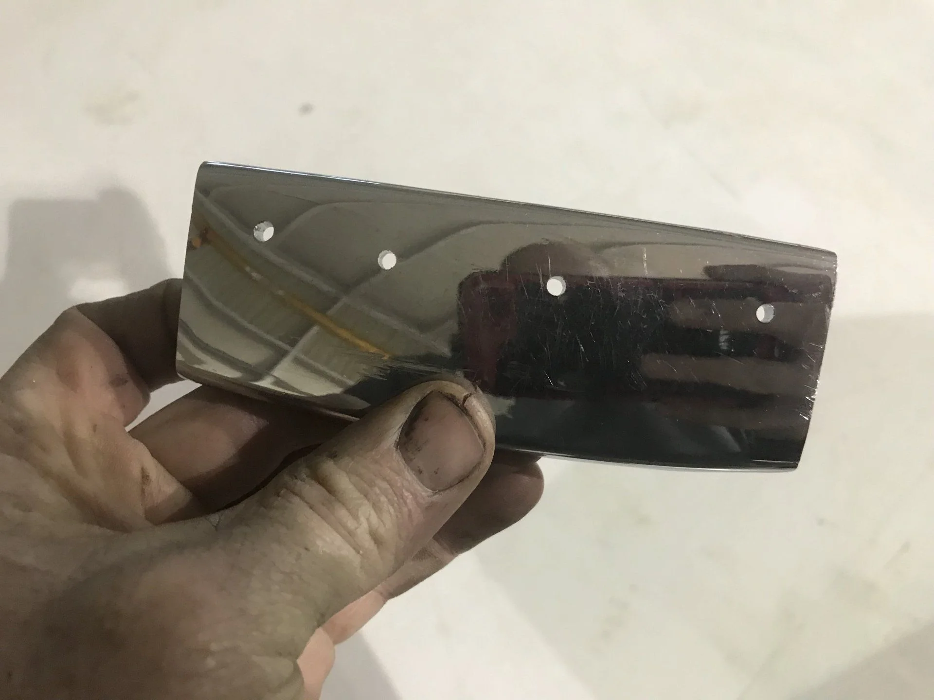

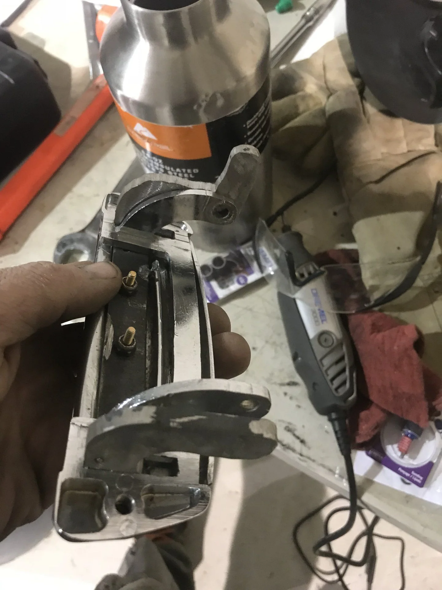

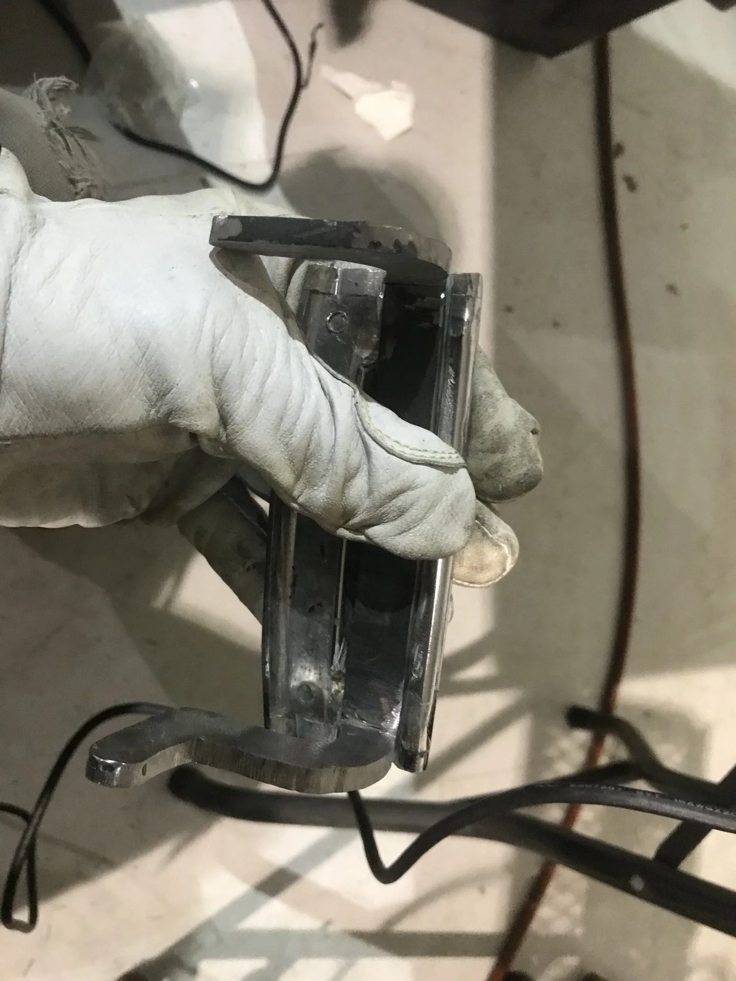

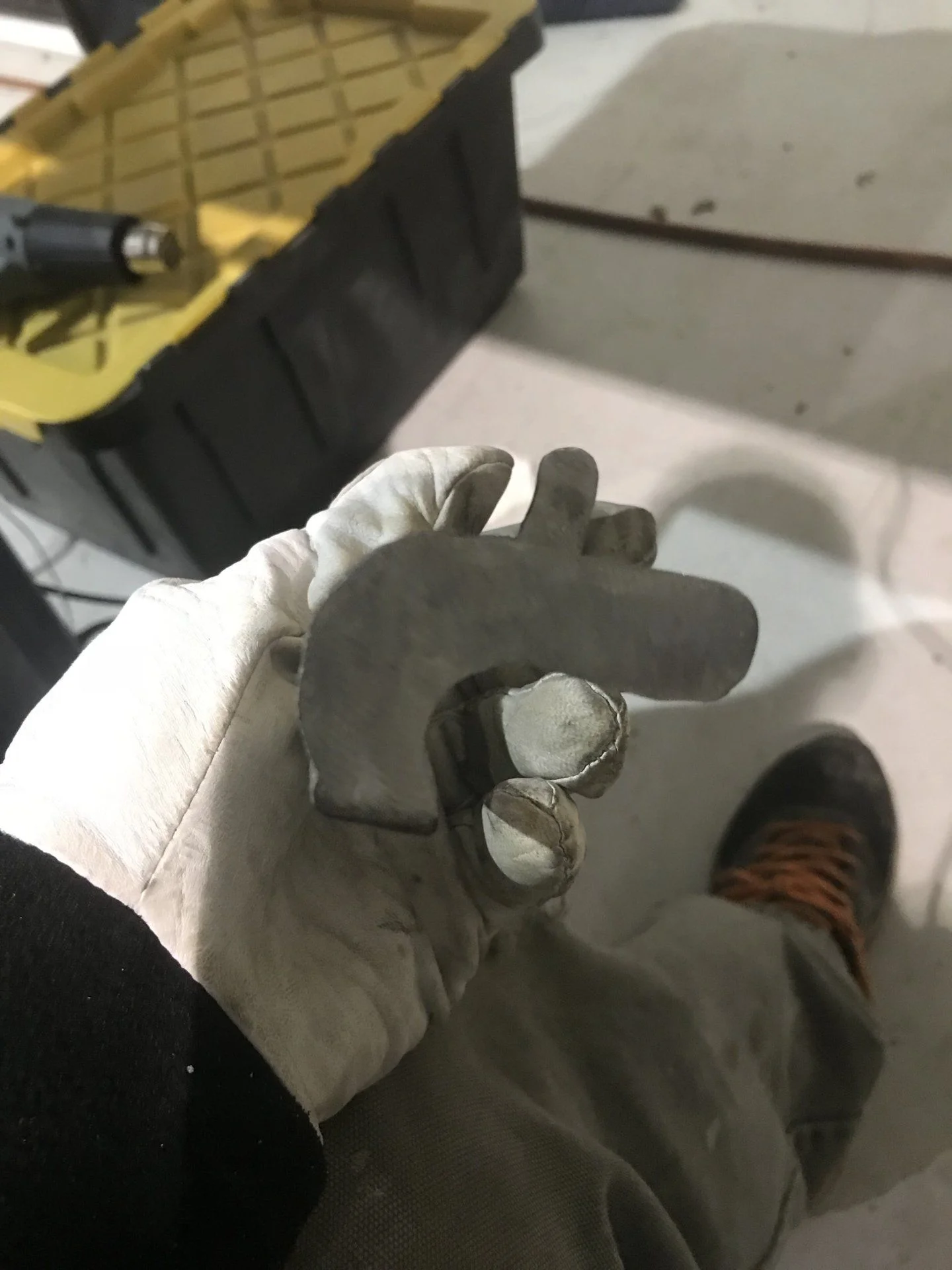

I may have fixed my tailgate handle. I got the plasma cutter and cut out the arms for the handle and grinded them down to the original shape. Then used a small piece of metal and welded them together. After that i ground out the handle to clearance for the metal piece connecting the arms. Once it fit into the other part of the handle I drilled it and counter sank the holes. I'll use 6-32 machine screws to connect the two and if it works I'll use panel bond and the screws. Then I'll sand blast it and cover the screws with putty and paint it. I'm hoping it'll work and be a long term fix until someone starts selling the handle.
Pretty cool idea! Better than nothing.
I do not know what people do about the spring when missing...
That sure turned out nice! I vote black to match. Truly some good thinking.
Thanks. I'm glad it worked. It really wasn't that difficult either. Just a bit time consuming. If I had it to do over again I was thinking I would have drilled the holes more consistent and bucked aviation rivers and left it chromed. I think the brass would look good with the chrome.
Looks great!
There are also some crazy strong adhesives these days, may not even need to drill V2.0?

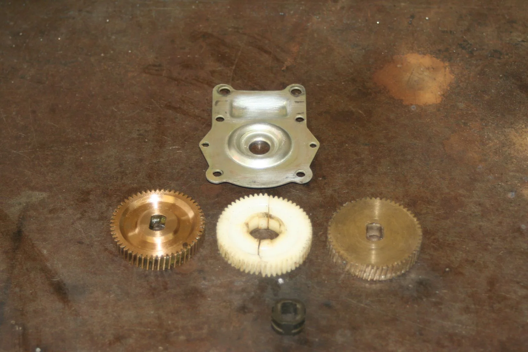

I messed with the tailgate assembly. I removed the motor and cleaned it again and used a small amount of grease when reassembling it. I have replaced the original gear with a new brass gear. When I tightened the plate that holds the gear in, the motor doesn't turn the gear. I loosened up the screws on the back of it and it turns but doesn't have much power. And when put back into the assembly it moves slowly without the window attached. I saw that there are brushes on the motor. Has anyone here rebuilt the motor. I searched but couldn't find a thread on it.
The metal cover plate wouldn't fit right if the gear didn't have the recess in it because the cover has the same indent...Here you can see the groove in the left gear, stock in middle and another gear without the groove on the right. The cover will fit down in the groove when flipped over.
