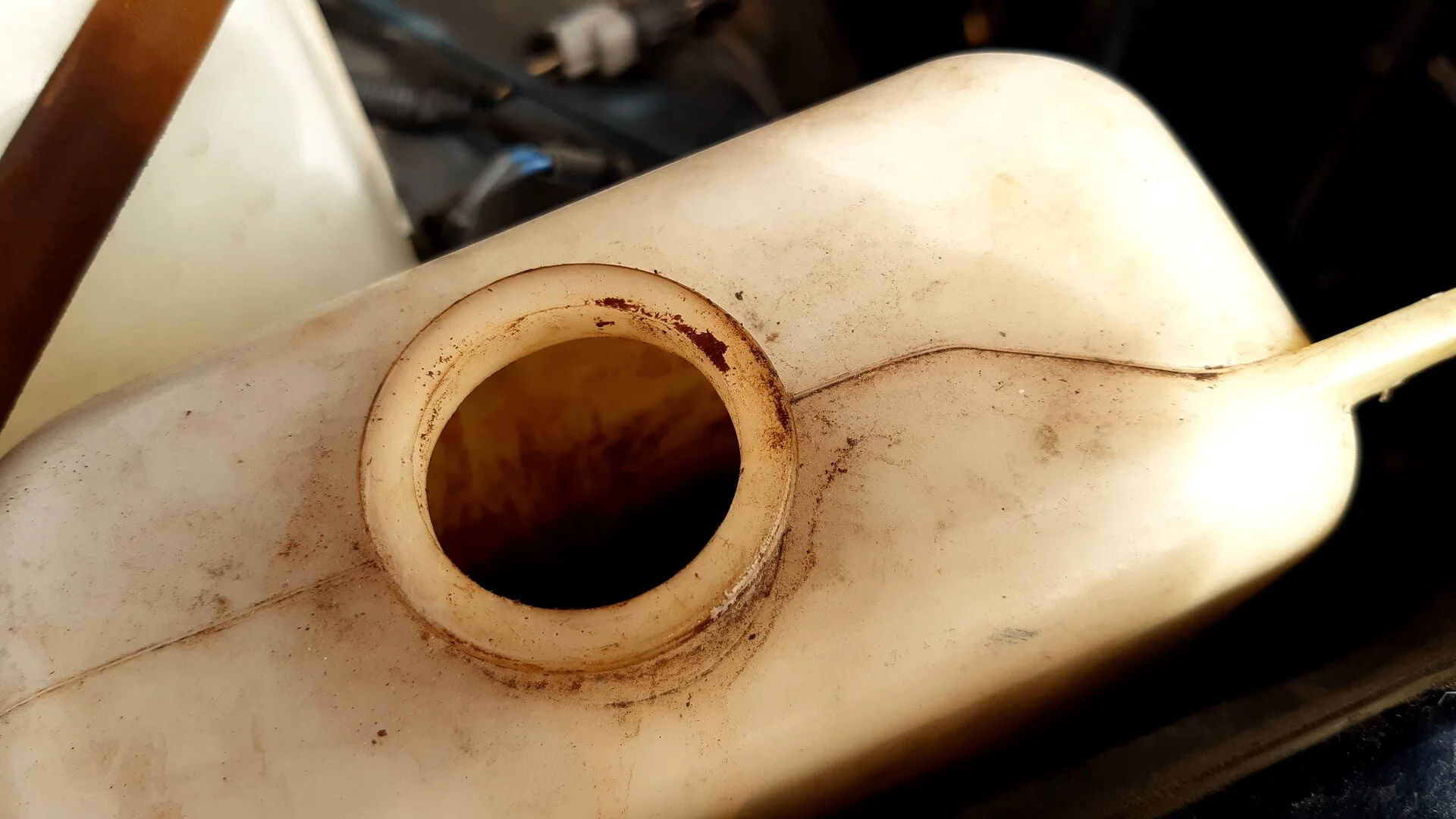

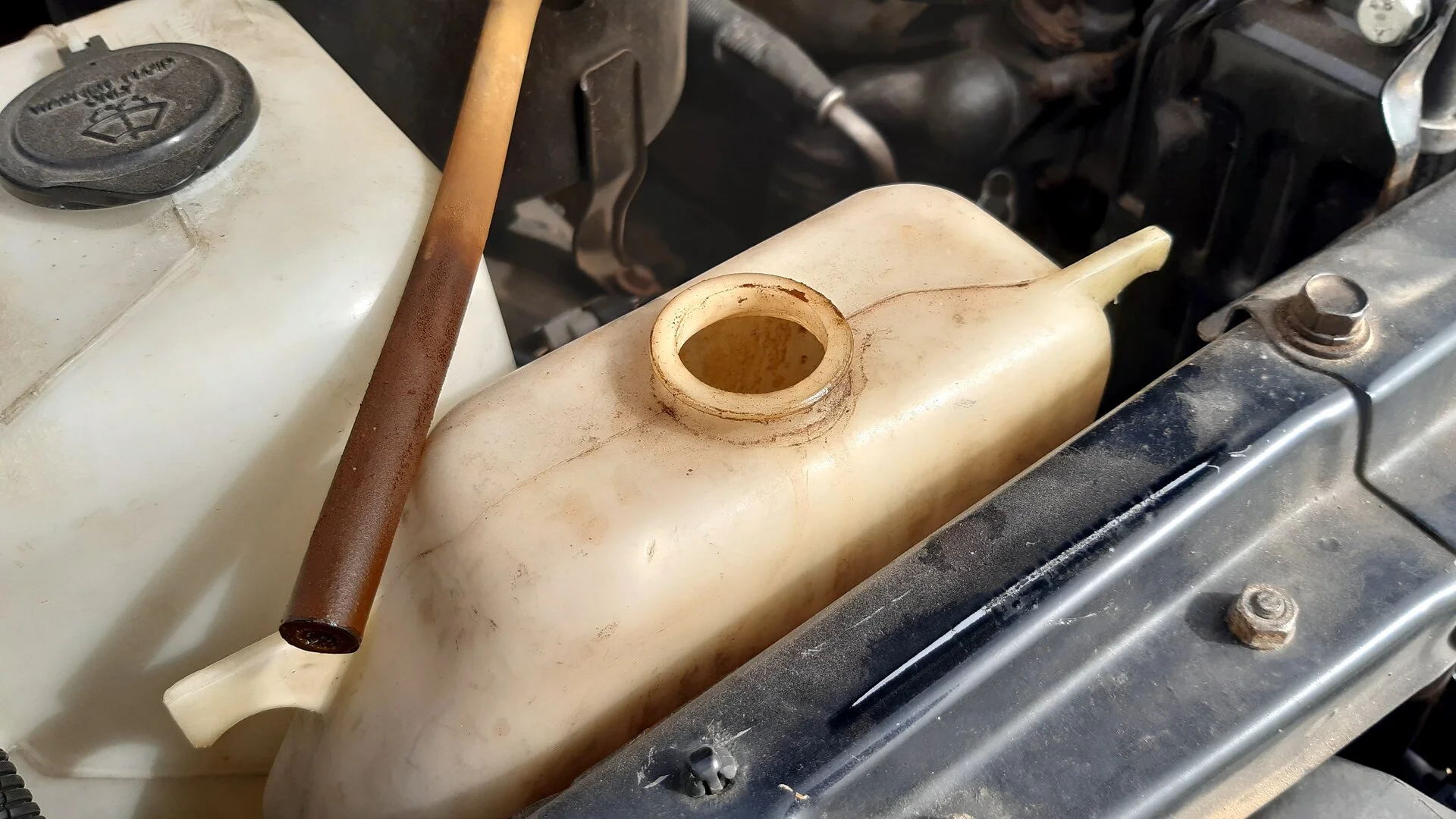

Thanks a lot for your support. I am attaching a link showing some pics of the engine bay and the open radiator cap.
The coolant is obviously heavily corroded and some grumpy small particles are floating in there. Needs to be flushed...

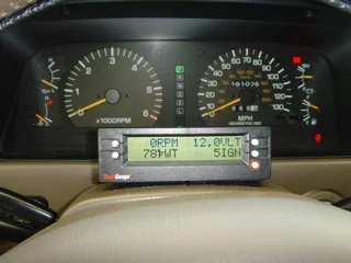

I find the temperature gauge in the 80 to be useless. I have a Scangauge mounted on the steering column to monitor temperature, voltage, and rpms.
In addition, @Beast of Berlin your cooling system is overdue for a flush. That's a lot of rust which can impact water flow through the block and heater core. Your coolant should look like red or green koolaid depending on which coolant you install. There's a lot of debate between red vs green. In my reading, red is superior for older vehicles but green is a LOT cheaper and easier to find.
This isn't my Scangauge but it gives you some idea of the mounting location. The metrics are individually set and the background color can be changed.
