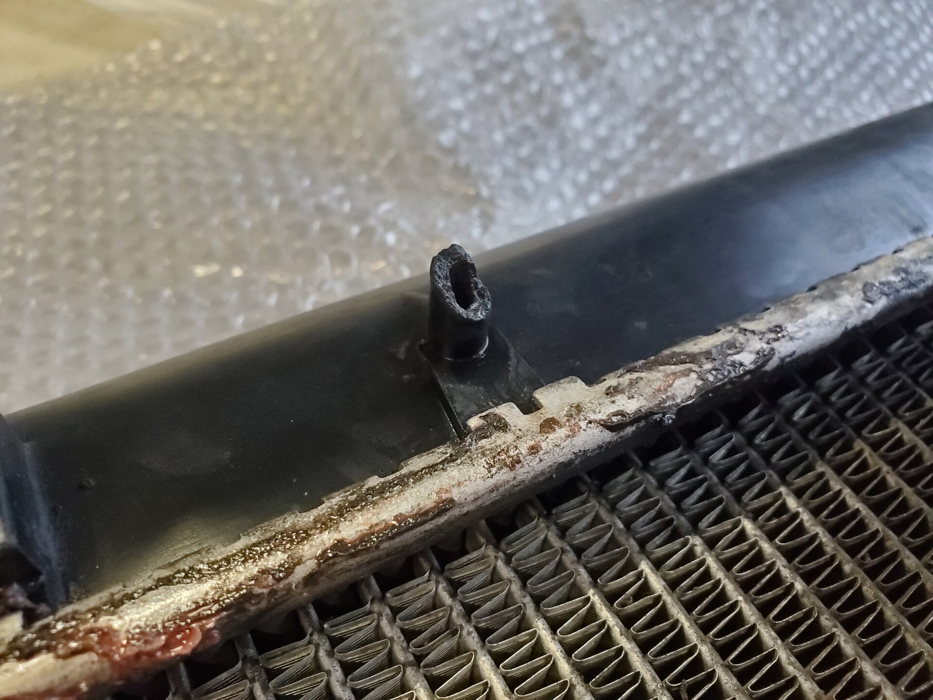

It depends on how many times you have personally broken the tap for the water by-pass hose number 3 from the plastic tank. If you're one of the fortunate few who've never done it, the Toyota radiators are the bomb. After about the third time, you'll get a metal tank model and won't look back.

I know you said you want the best but, I didn't want the nipple on an OEM radiator breaking on me again.

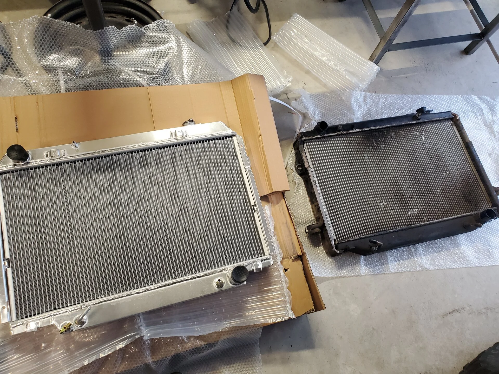

Ordered a Leiland right after getting back; incident happened 8 hours away from home where I had our 2 dogs and pregnant wife with me.
Fit like a glove.

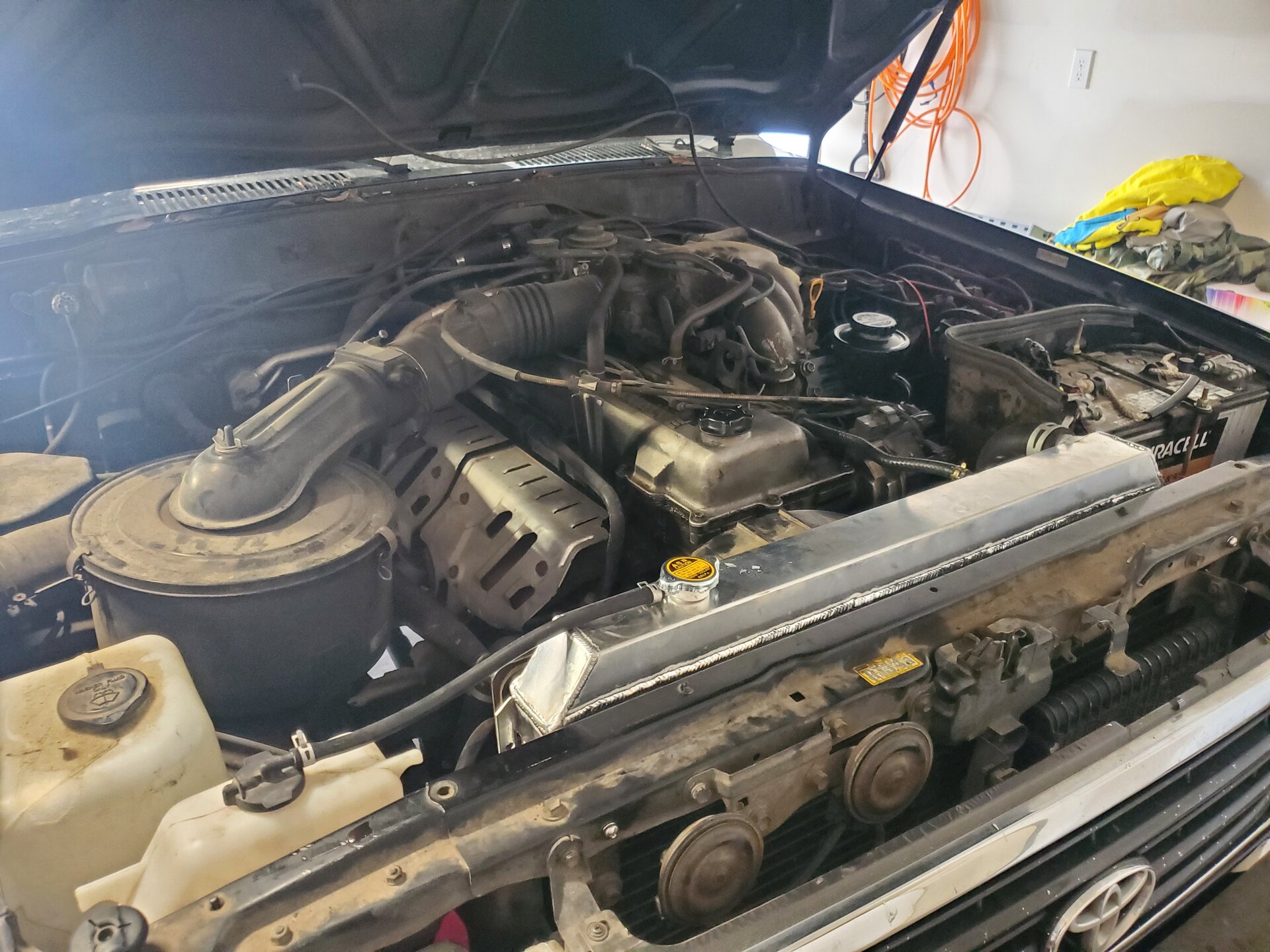

While I was in there, it gave me an opportunity to; replace my steering damper (OME), replace my power steering pump (had an extra OEM, rebuilt it), replace my drive belts, replace all power steering hoses including the high pressure line, even replaced the bolts and bushings for mounting the radiator. Chose to go with a new OEM cap vs the Leiland cap that came with.
Living in Central Cali, it was hitting +110 here and the rig stayed at a nice 175-180 with the AC on even.
