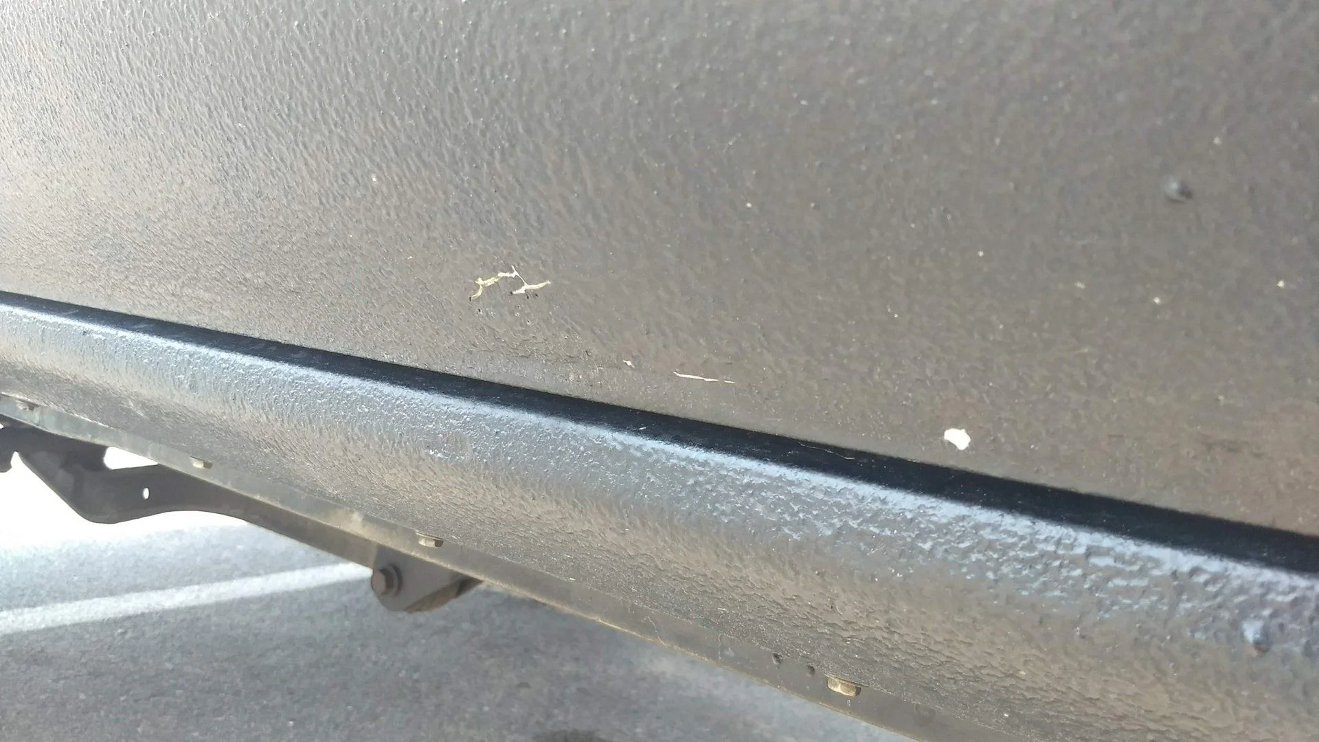

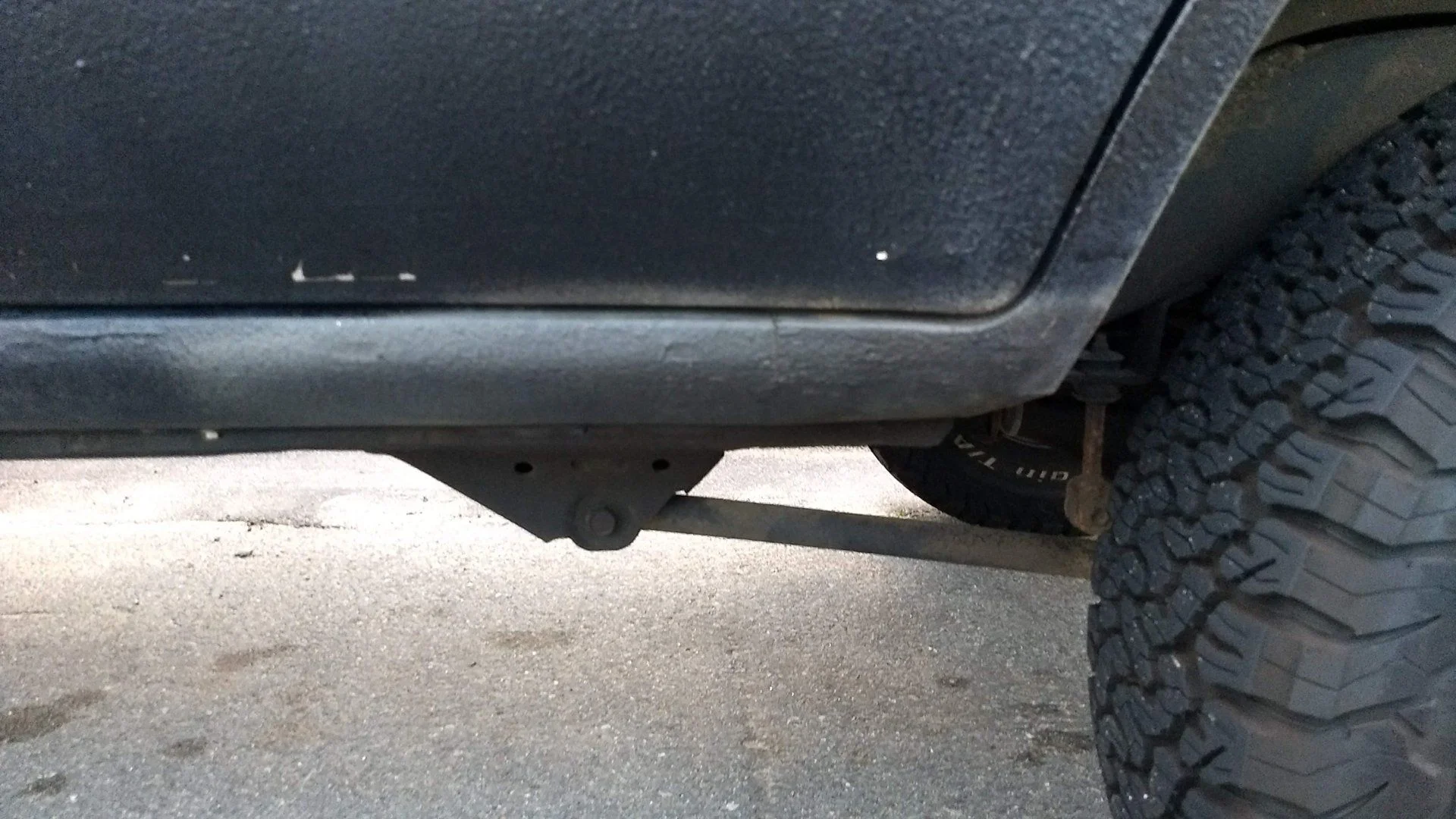

Just an update that may be of interest to some of you. The previous owner of my LX450 filled the holes with tape and Monstalined over them. You can see in the pics that the Monstaliner is now coming off where the tape is. I suspect that the tape has poor adhesion properties, and needs a better base for a proper application. I am also including a pic of a stain that has developed on my rocker. I'm not sure what it is, but I can't remove it. I'm assuming it is from some sort of chemical that I either drove through, or ended up there from shop work.
Damn, that sucks about the tape, sorry about that. I wonder if those who did it before me are having the same problems.
To be fair to Monstaliner, I think the stain you're seeing is the 3M rubberized fender spray that the body shop used and not Monstaliner. The small spot of rust that was repaired wasn't re-Monstalined, I think if you go over it with Monstaliner the discoloration will go away permanently.
I don't think the stain is a faultf of the Monstaliner either, but thanks for the update. My main goal of the post was to update folks who may have used the tape method since it seems to be failing a bit.
I have planned on redoing the liner since I bought it from you anyways so it isn't a huge deal for me, but I am curious if anybody else has run into longevity issues as well .
If the liner is coming off the tape, and the tape is the same as some adhesive backed aluminum tape I've seen used for this purpose, it would have needed to be primed first for the ML to stick long term. Liner should never go direct to bare surface like that.
Many people ask about putting ML over Dynamat which can also have a foil facing and we always recommend epoxy primer over the foil first.
The tape does not look like it was primed, but I can't speak for BltByKrmn since my 80 came from him. I figured this was the deal though after all the info that I have read about your product. That said, I definitely plan to redo the truck in Monstaliner again as I really like the product. I will be doing my gf's XJ with it as well.

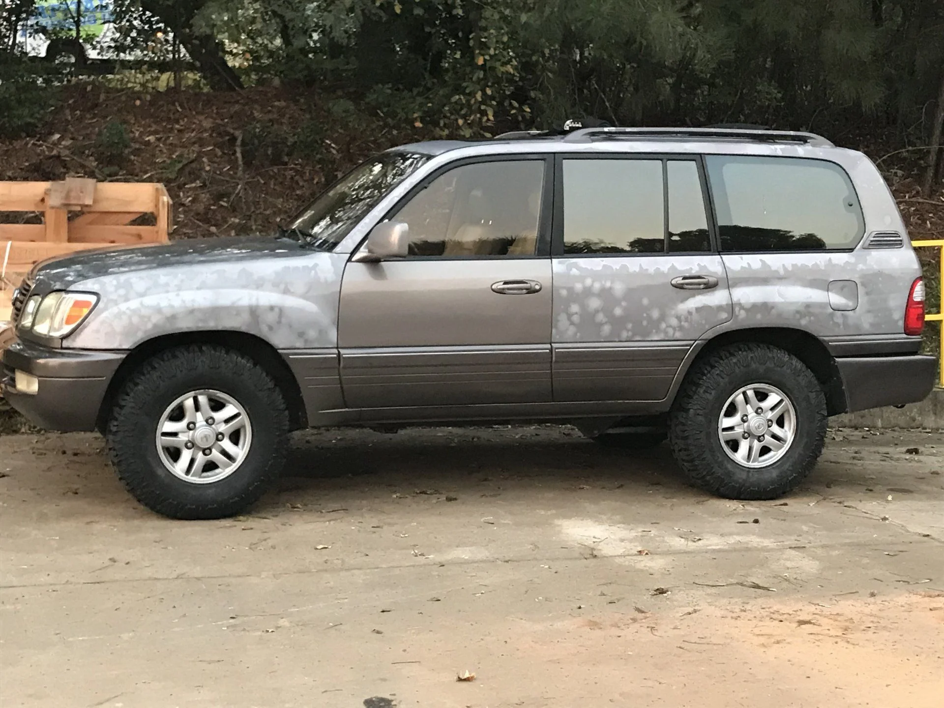

I have a 100 series. I imagine it’s a little smaller than a Tahoe. Would I need 3 gallons to cover it? My paint on it now is in very poor condition. Not sure which part, but either the clear coat or the paint’s uv protector has failed long ago, and caused this splotchyness. The clearcoat is also flaking off. Where it’s splotchy, I’d say the clear coat is at least 50% flaked off.
My thoughts are that I’ll have to sand all of the clearcoat off, even on the panels that aren’t failing. That way, the Monstaliner will adhere to the paint, and not the failing clearcoat. At the bottom of the doors is a plastic cladding. Will I need to just scuff up that paint and roll right over it? What about door/hood/panel seams? Just roll over them? Should I open the doors and paint in the door jams or will the thickness of the monstaliner affect the door opening and closing?
if you will be using monsta liner, you might be able to remove a lot of that clear coat with just a metal putty knife. It would ssve a lot of sand paper.

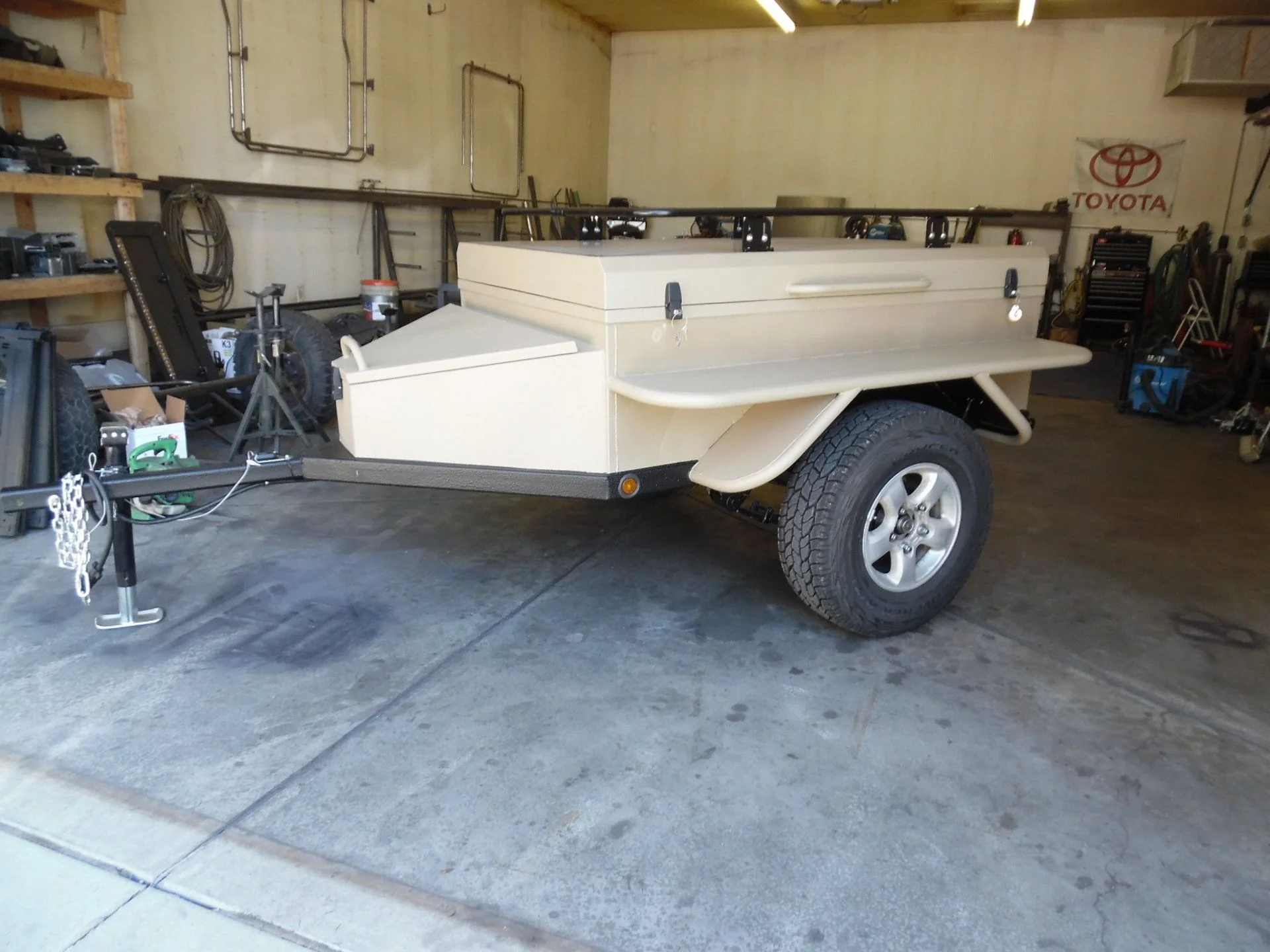

Hi Pit Elevated,
Did you use the "white" off of the Monstaliner color page?
Looks great!!! How is it holding up?
At least 2 gals here, possibly part of 3rd. You think that has more sq footage than an XJ?
Sand the clearcoat off with 120 grit and scuff well whatever is not failed. There's a good chance you will wind up sanding through basecoat and possibly the primer before you're done so I would then prime it all with 2K epoxy if I was you looking to do the right kind of job.
Plastic must have adhesion promoter before liner. See this PDF
http://www.monstaliner.com/documents/Monstaliner_Coating_Plastic.pdf
At the panel edges you should try to wrap the liner around the edges with the doors open before you line the outside. I can discuss this with you in further detail when you get ready. What color were you planning to use here? May want to consider doing the jambs as well if color will be different.
