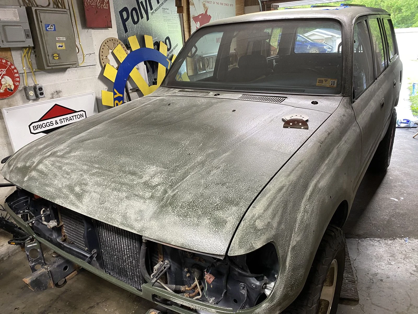

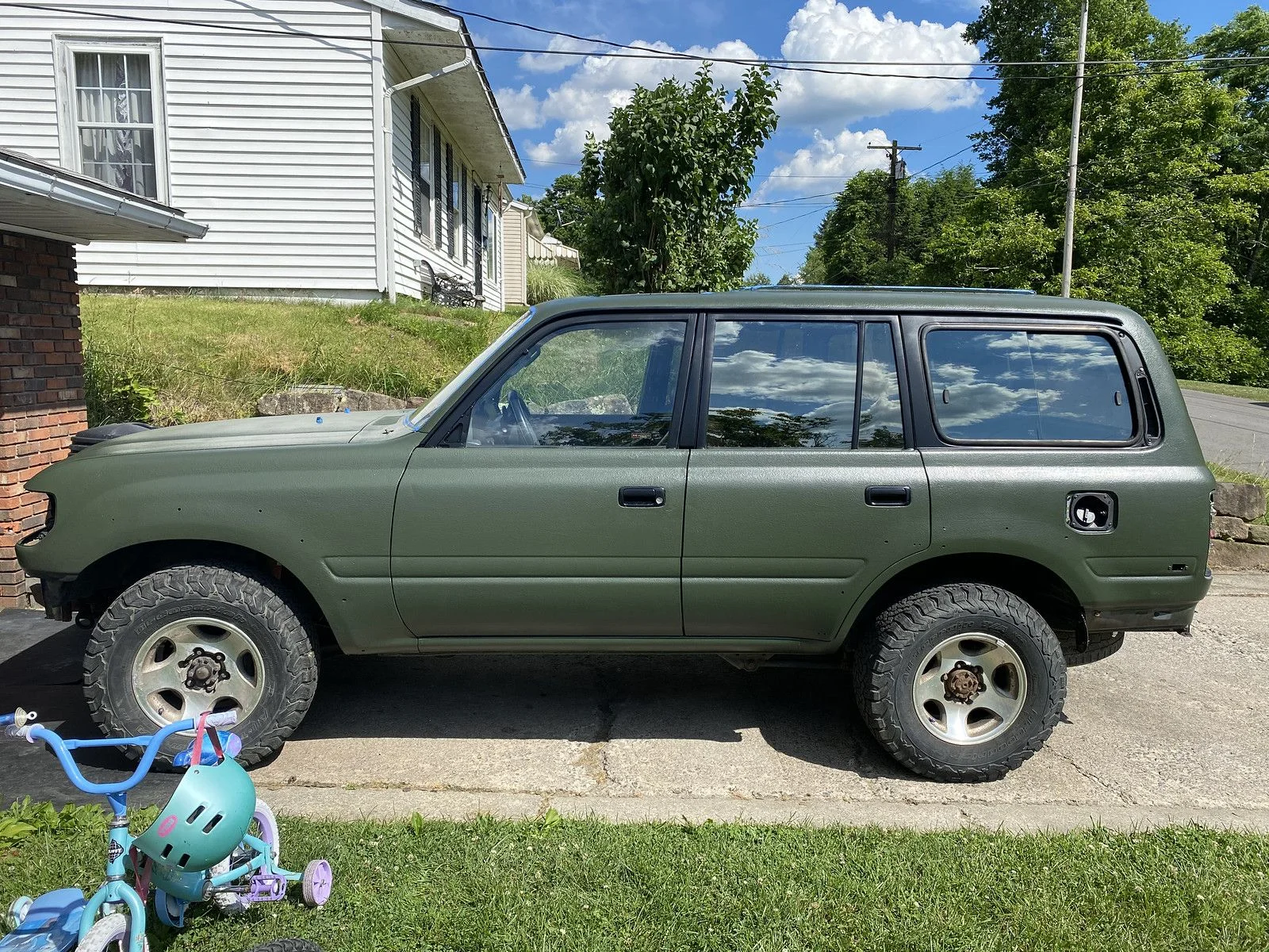

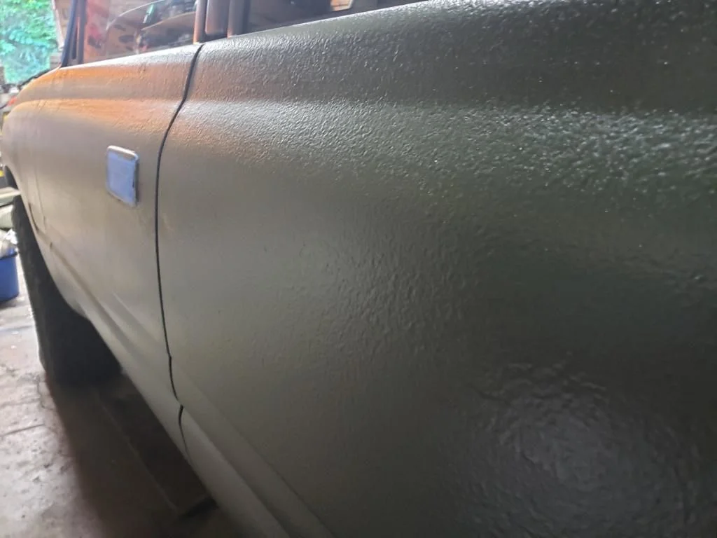

I don't post much, but I wanted to post an update about my issues that may help someone else. Mine as you see above was done wrong. I let air get into the paint for the 2nd coat, roller fell apart...etc and made a not so great finish. I used a plastic rzr blade and scraped the garbage out after several days of curing. I then went over it with 180 grit on my portable sander. This left a lot of texture and paint, but smoothed it out where the garbage was. I ordered another gallon kit from monstaliner, had more toner mixed and followed the directions this time. It went on like butter and covered perfectly. Here's some pics, but follow directions kids lol, it saves headaches. Now for lift, tires, wheels, roof rack, bumper and rock rails this wknd.

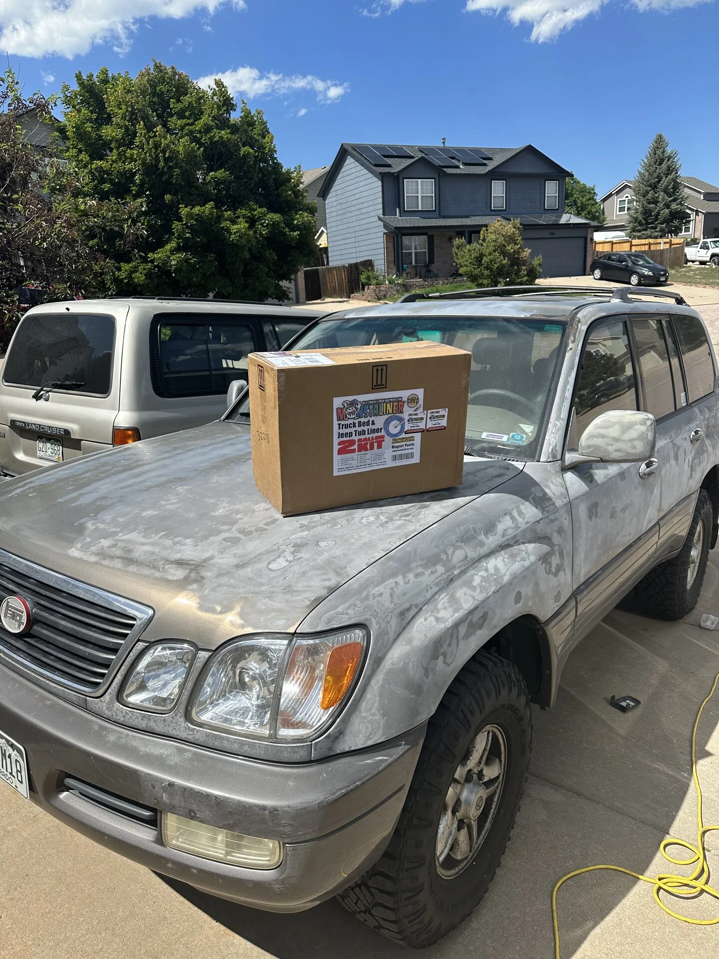

How are things looking now. I requested some samples a few weeks back and now when I emailed support@monstaliner.com I get a bounceback. Hoping that ya'll are around an still doing business as I'd like to use the product. :)
Wooohooo! Despite the email bouncebacks it looks like they are alive and well as my samples came today. Now to decide which 'gray' will look the best as a replacement color for my 80's front and rear bumpers.

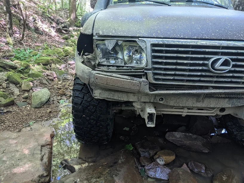

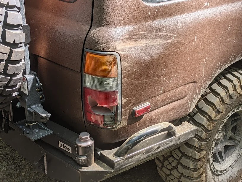

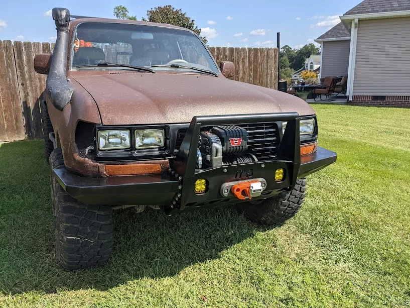

This stuff is amazing, I've added 4-5 dents and tons of scrapes and the monstaliner is holding up great! Sadly the rear quarters, tail lights and headlights aren't as tough...lol Got my front bumper installed so hopefully my quads will hold up better moving forward.
