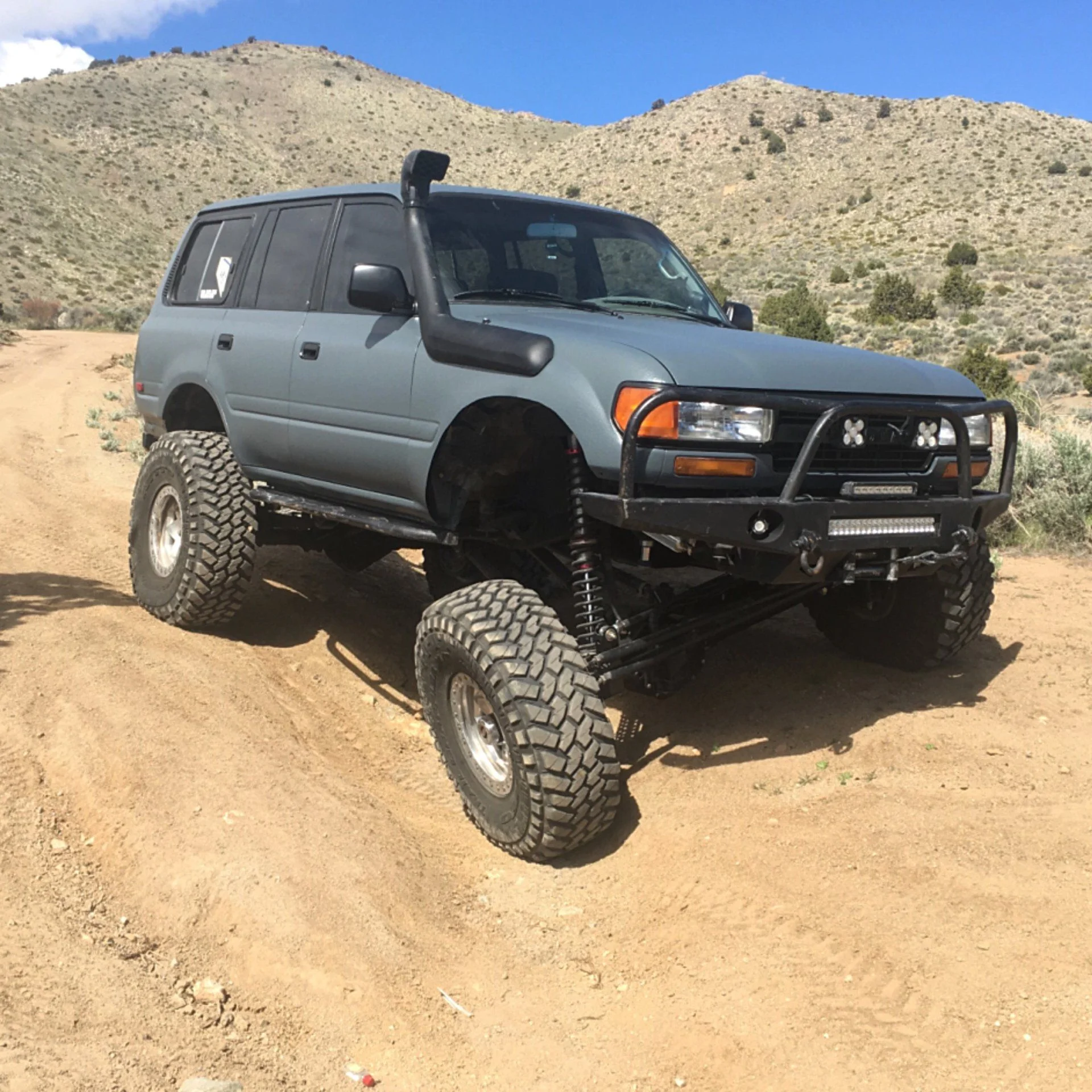

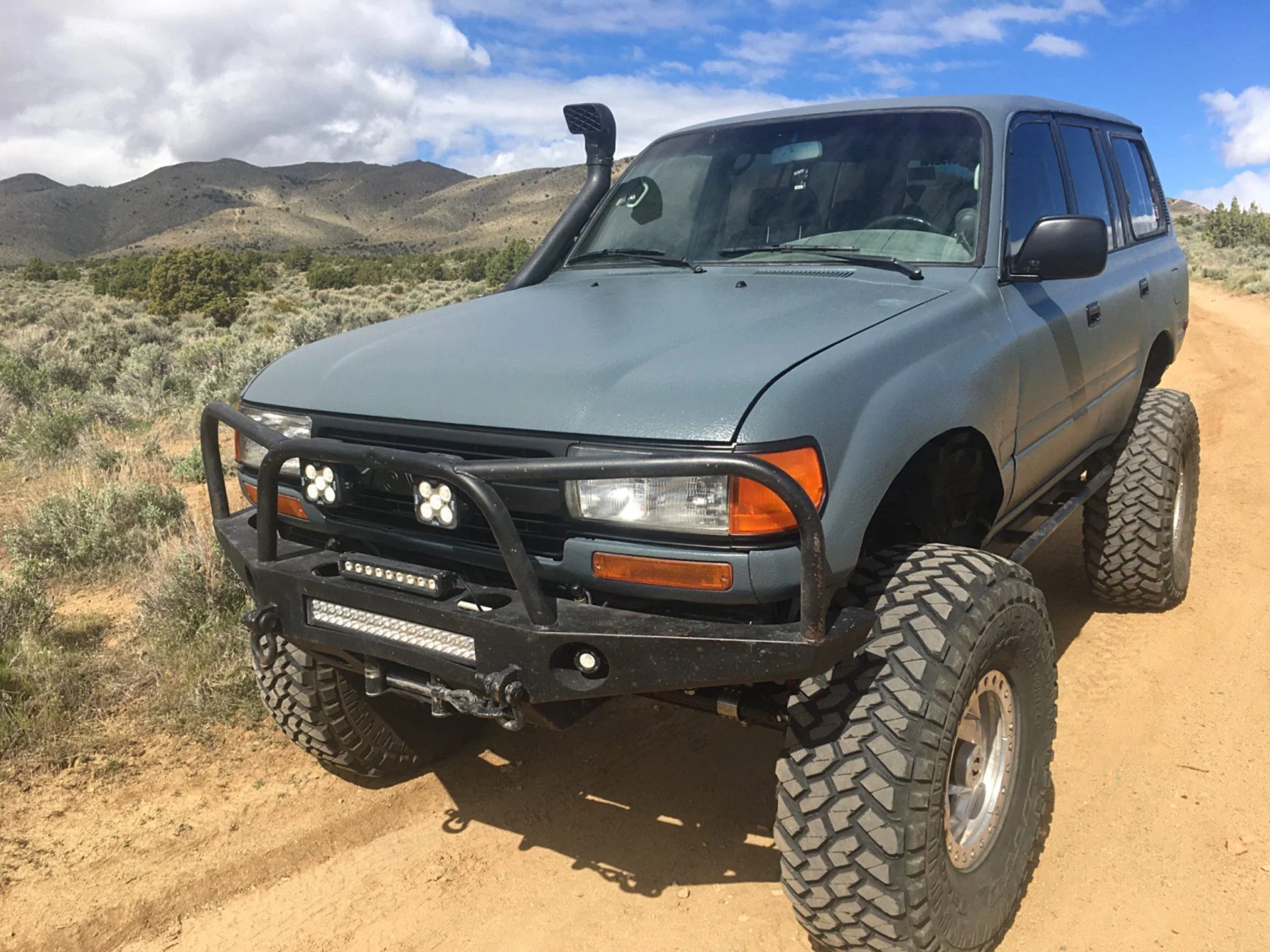

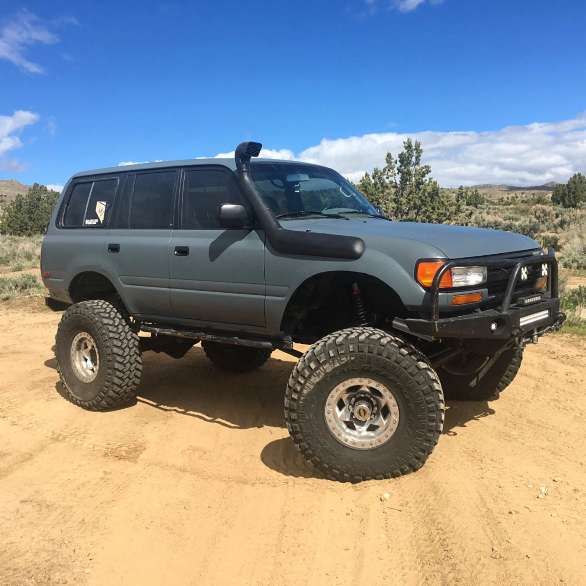

Get Hammered Monstaliner over a Dark Gray Metallic/Blue Slate. Rolled on.

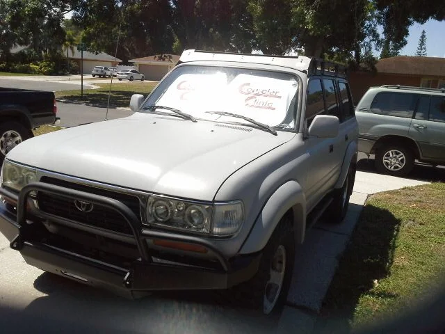

Used 2 gallons but need to order a touchup quart. Lots of tips already on here but wish I’d have removed sunroof from the start, as I cracked it... whoops. And pulled the hood and hatch doors. And ideally the windhield and rear hatch glass. Pull almost everything you can. I took off the belt moulding, which was trash but broke like every clip and for an 80 series it was about 300$ for the full set. Prepare to spend a lot of money on paint supplies as well. I went back to home depot like 5 times at 50$ a pop. Also I’d probably have like 10 rollers on hand. Anyway, just wanted to share this color as I couldn’t find but one example anywhere, and share a few of my thoughts on the process.
That looks fantastic! Digging the color choice. Well done.

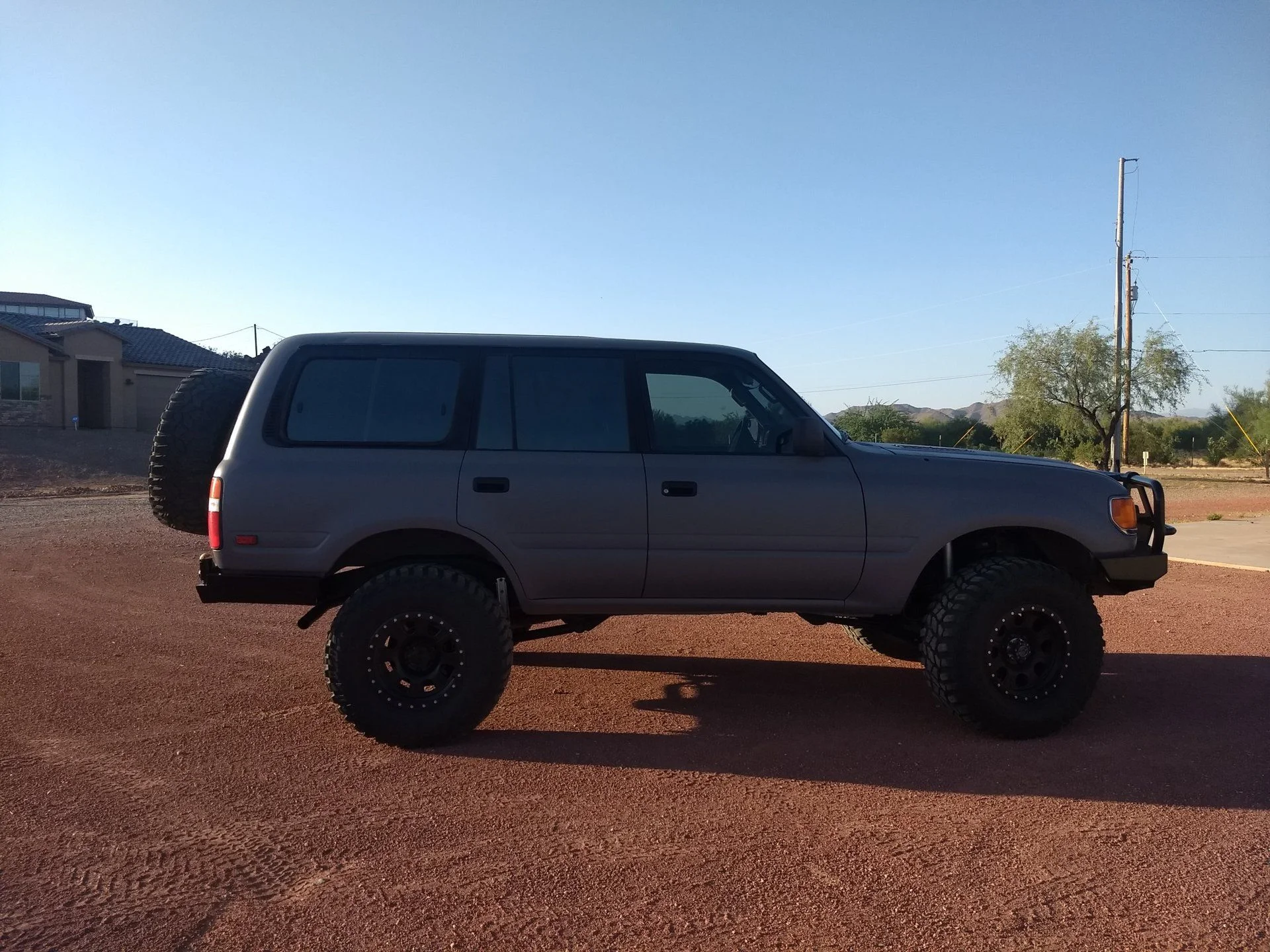

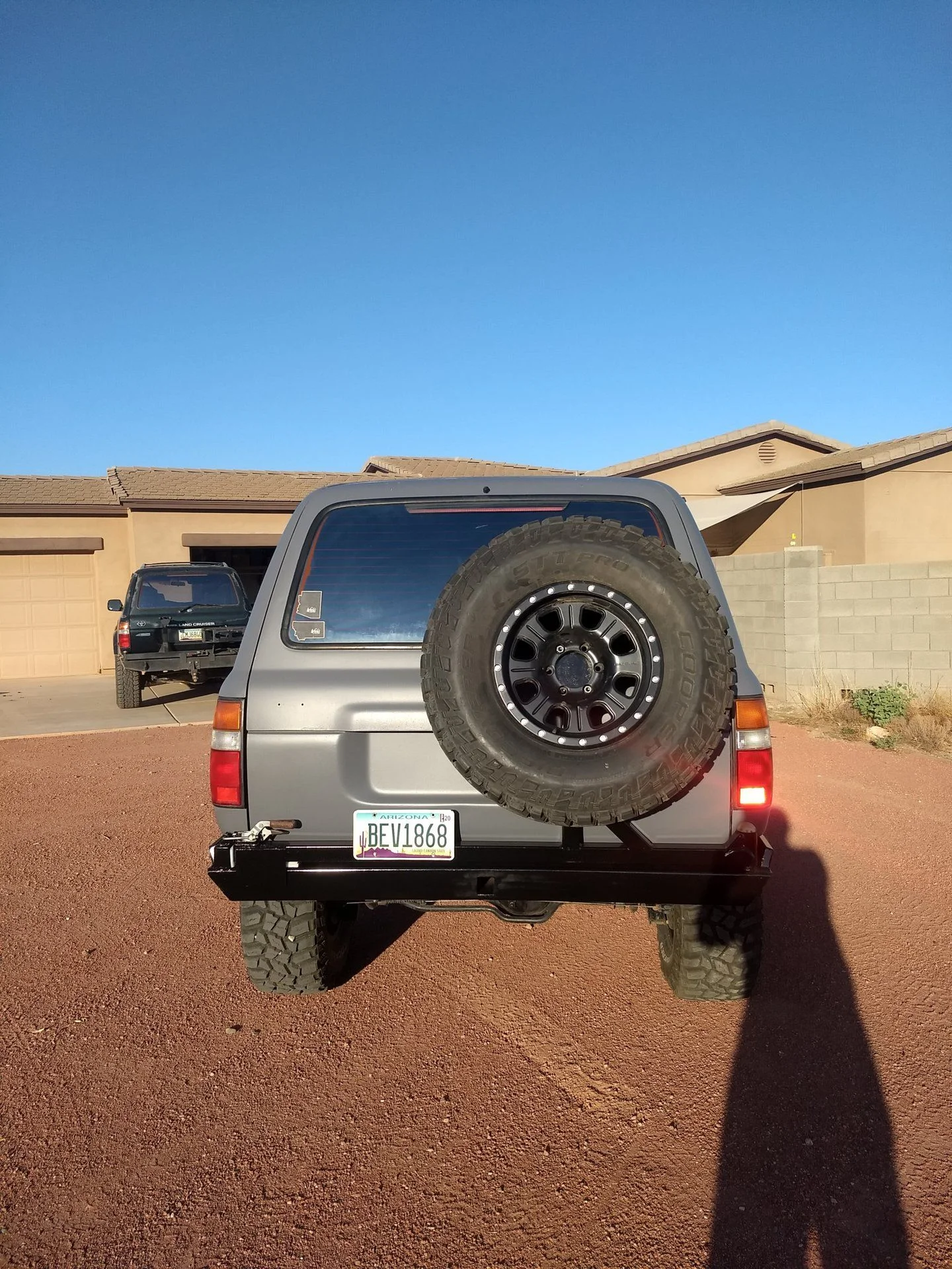

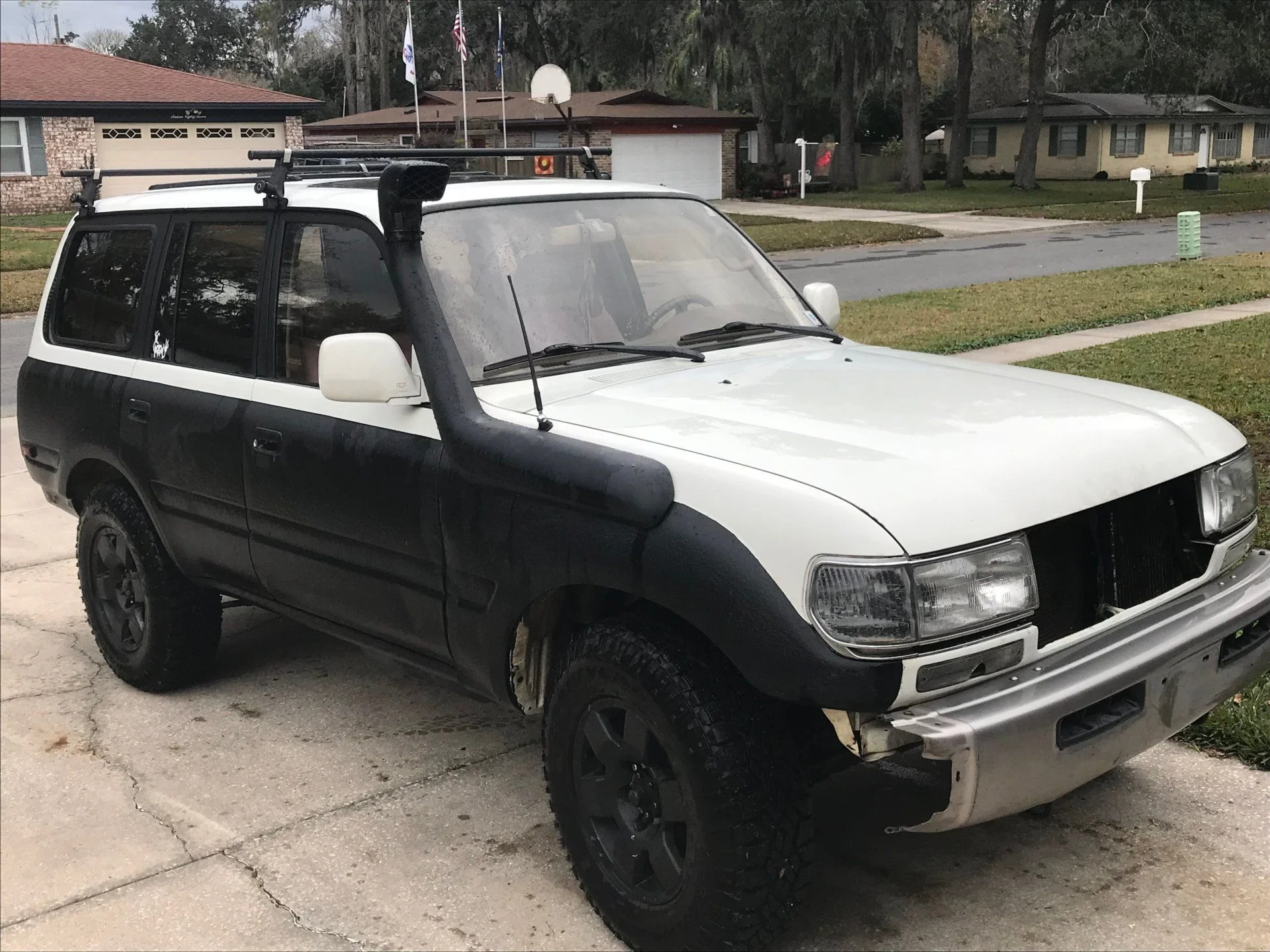

Here is my 80 in medium quartz gray. Like maxamillion said above, remove everything you can. I regret not removing the door handles, but not a big deal. I welded all of the fender flare holes
This stuff is easy to work with, but you definitely need an extra set of hands and need to work as quickly as possible. This is also the only paint/coating I have ever used that seems to repel bugs.

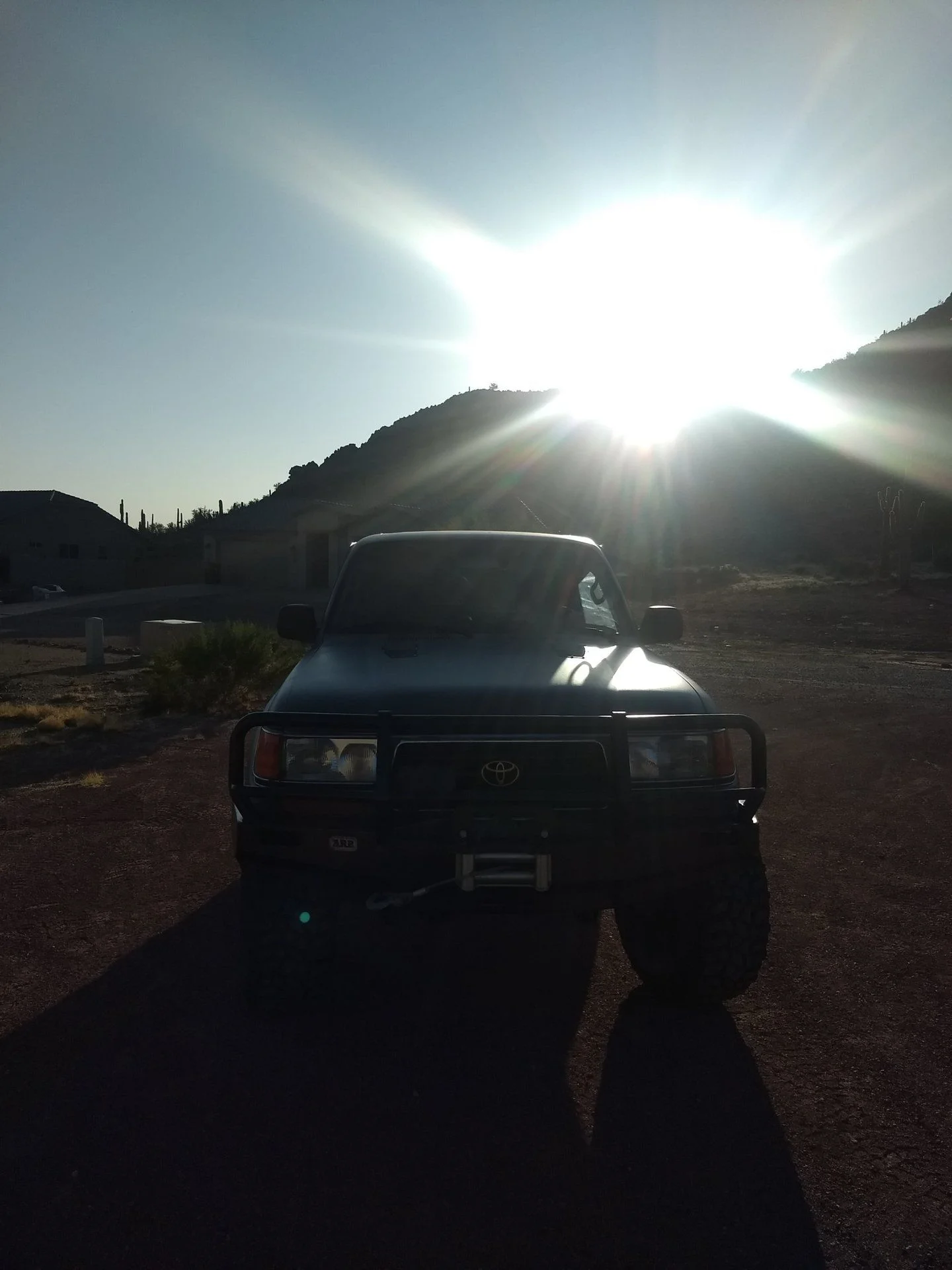

@peacesells63 Very awesome.Give us a few more pics in the sunshine please.
Will do. I took some, but they are terrible due to the low angle of the sun yesterday when I got the truck put back together.
