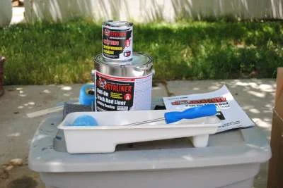

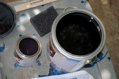

    I finaly got around to doing the hood and rockers with Monstaliner do-it-yourself roll-on truck bed liner outperforms Herculiner Bed Liner, Duplicolor and Rustoleum Road Warrior.
    So far, I am much more impressed with the monstaliner than I have been with Duplicolor and herculiner. I have used the duplicolor roll on and the duplicolor and the herculiner spray on bed-liners with limited success. The spray on liners wore through too easily (canoe tie down straps were able to wear though the spray on bed-liners in a 2 day camping trip).
    This material seems to roll on much thicker and with a better consistency than I have seen on the other aftermarket liners.
    I was tempted to use a undercoating gun to spray it on, but Eric at Monstaliner suggested that I roll it on and see how it turns out.
    I basically followed the directions in the kit.
    Here is what comes in the gallon kit. You get the catalyst, a slightly unfilled gallon of the bed-liner (you cannot have a full gallon if you want to add the quart of catalyst). my kit did not come with the roller pan so that is from Ace Hardware. Everything else came with the kit..
    One you add the catalyst to the gallon, you use the mixing stirrer on a drill to make sure the catalyst is evenly distributed in the gal of bedliner material.
    Prep was fairly easy. Tape off the edge you want and then use the sanding pad that comes in the kit to rough up the surface that you are going to cover.

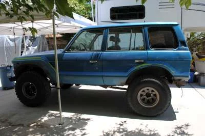

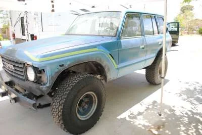

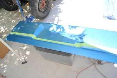

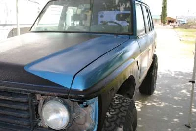

    I wanted to black out my hood and do the fenders/rockers of my 60 with the Monstaliner. The first coat went on fairly well but had some holes in it. That is not suprising considering that the rollers they provide are fairly rough and only hold a certain volume of material.
    Being careful is important. I had to clean up a couple of splatters and overzealous rolls with MEK. Which does a very good job of removing the bedliner when it is not dry (I have not tried it on dry Monstaliner yet, doubt I will actually)
    Pics are of the area sanded down and ready for Monstaliner application.

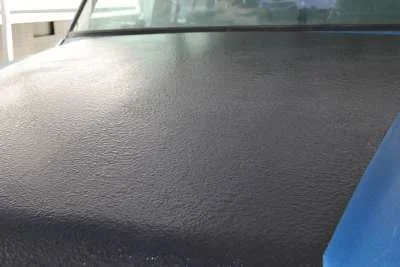

    After the areas have been sanded down I used a rag soaked with MEK to clean up.
    The first coat went on well with a couple patches of non coverage as I mentioned before. Honestly, I probably could have put the monstaliner on thicker for the first coat, but I was going to apply a second coat, so I was not all that concerned. As it turned out, I had nothing to worry about.

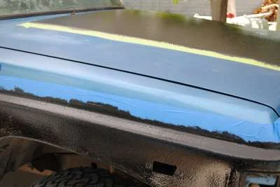

    In the end, 2 coats was only about half a gallon of the bed-liner material.
    Drying time was considerably faster than the 3 hrs suggested in the manual. I was going to put a third coat on there, but after pulling the tape off my tailgate, I saw no reason to make the bed-liner thicker.

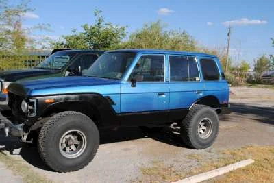

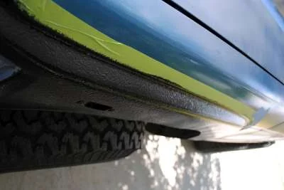

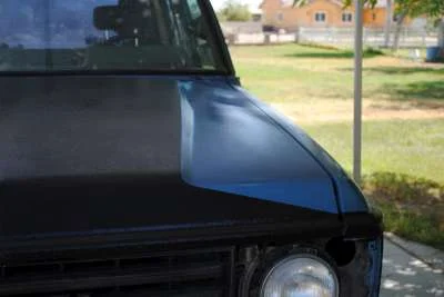

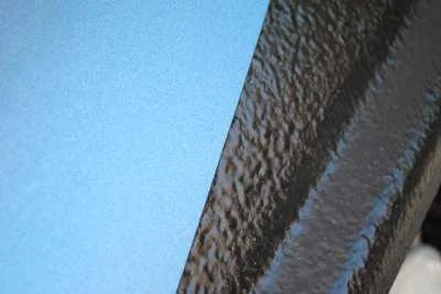

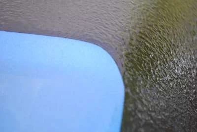

    The Monstaliner has a nice balance between rougher texture and smooth texture. They do recommend running the roller over the liner after it is slightly dry to get a rougher texture. However I really like the fairly smooth consistency that it gives right out of the can.
    Overall, I am fully happy with the product. I will keep up dates going on how the liner weathers the test of time. I am curious to see how the Nevada Sun treats the UV stable liner.

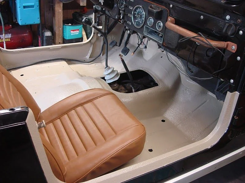

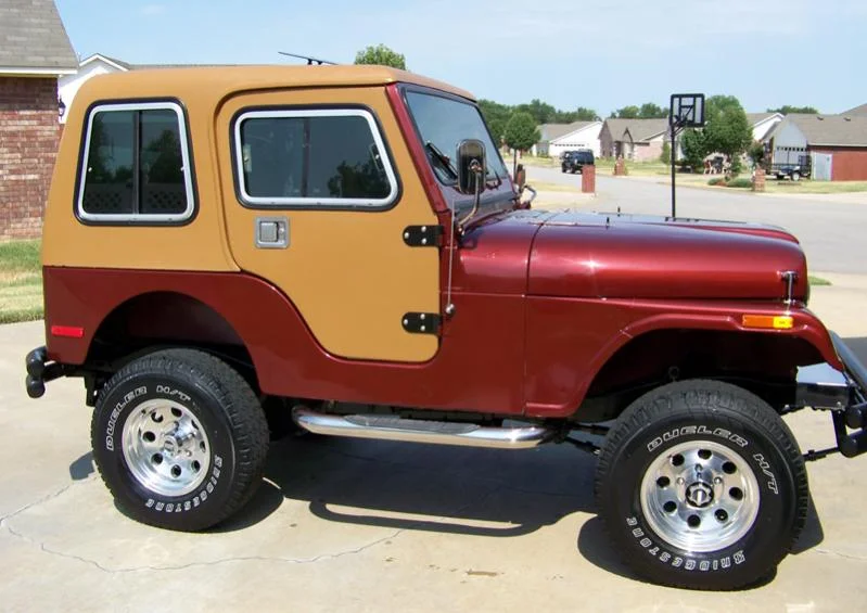

    Mace
    Here's the latest pics of some cool jobs
    Regards
    Eric
    075.jpg 85_CJ7_Desert-Sand_DSC04204.JPG 1980-CJ5-dh_jeep-hardtop_Spice_100_0266.jpg
