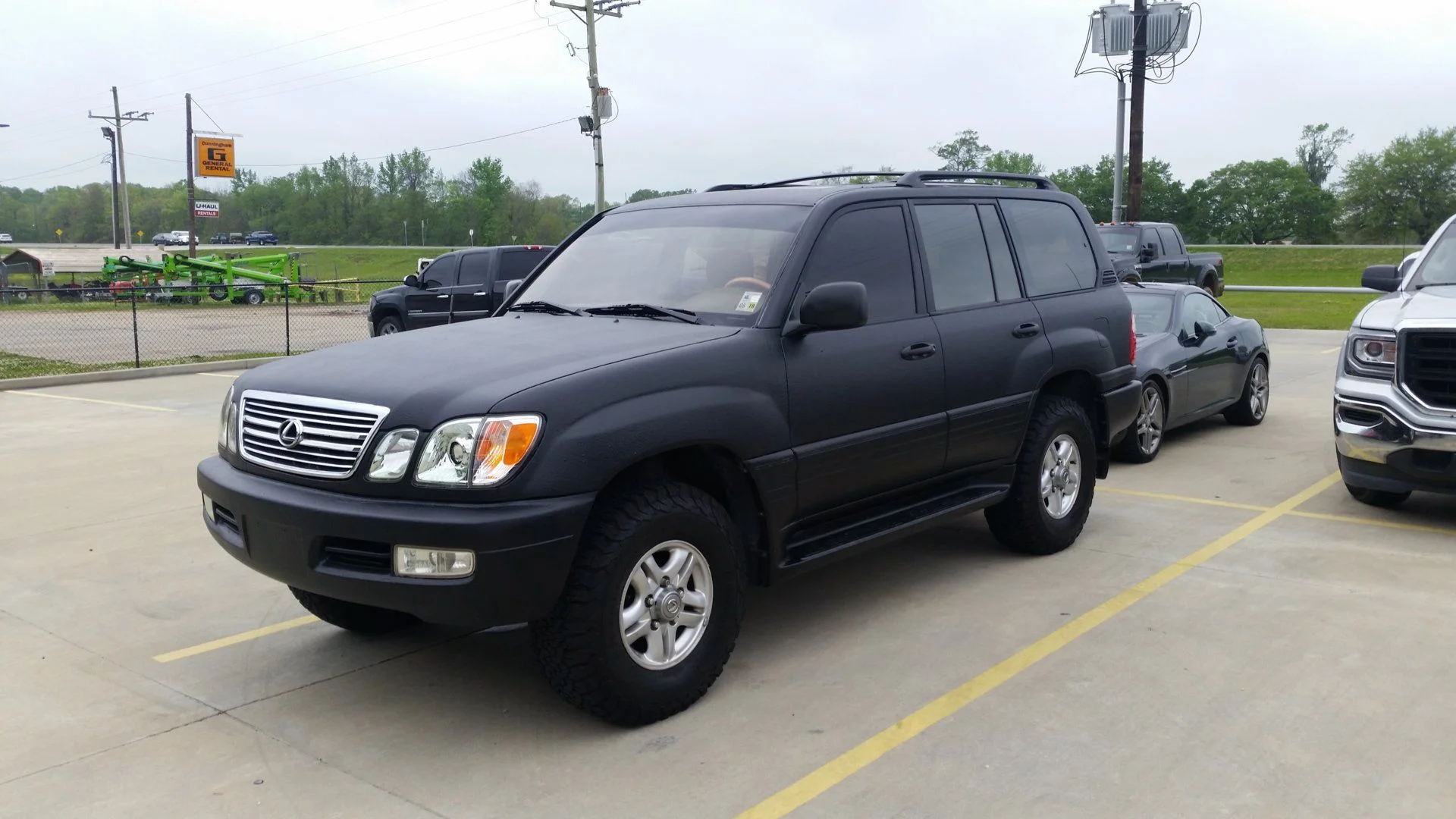

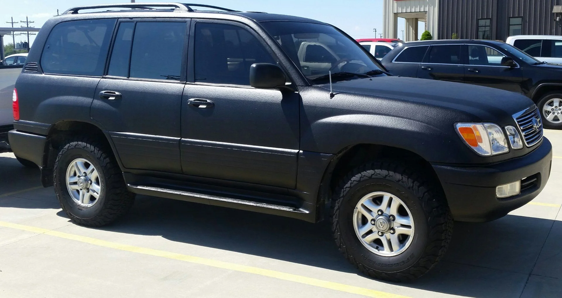

Thanks, long project of rust repair and I was really looking for a finish that accomplished a few things:
1. I did not want to spray. I do not have a good workspace to do that and after brush / rolling everything I feel like it is better sealed than when I had sprayed parts.
2. I wanted a finish that at best could be hosed off. I painted it "nice" 15 years ago and never waxed or really washed it, it's a tool and I use it.

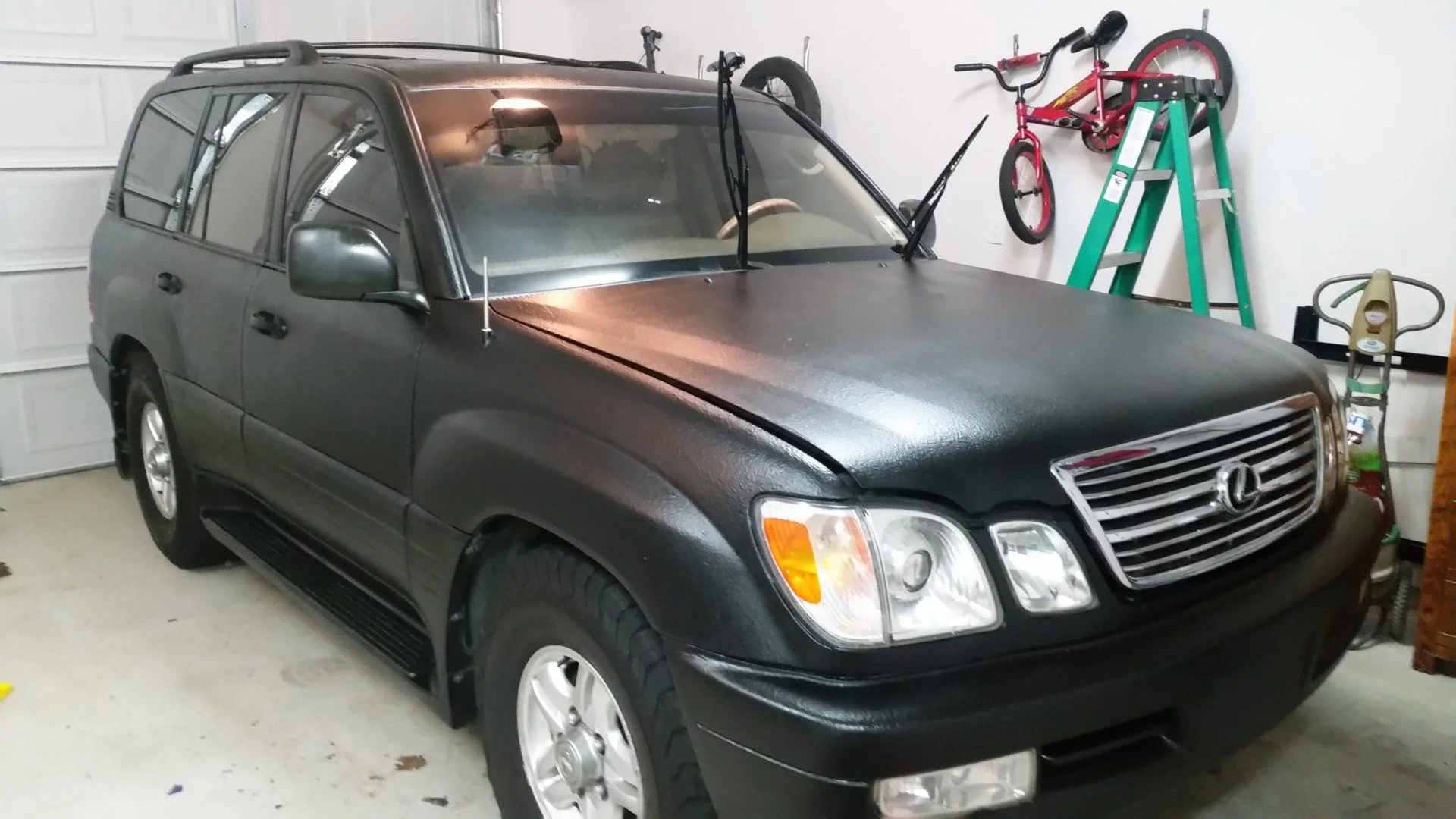

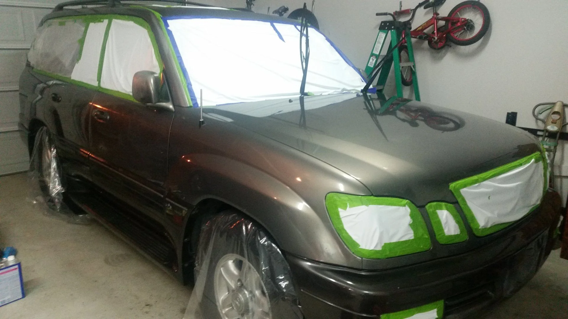

3. I did not want it to look too rough. In hindsight I wish I had experimented more but it is tough with the pot life. I did the roof with the monstaliner rollers so it has more texture and then moved to the small foam rollers for the rest. The larger areas like the hood would be easier with a smooth foam 9" roller.View attachment 1454221 View attachment 1454222 View attachment 1454223 View attachment 1454224
Best looking job Ive seen in here, IMO. I'll be using white as well and like your results. I shall use the same roller. If you could do it over would you thin it more? Or at least try for a thinnner coat?
Thats a cool look. At first I was thinking how nice your paint was to begin with. But I think I see what you did there... The chrome looks sweet on the flat paint. Dichotomous. Sneaky.
Thanks but the lighting makes the original paint look much better than it actually was, I never liked the smokey topaz paint and it was scratched and had clear coat peeling everywhere. I was never going to spend the money it would take to get a good full paint job and after following this thread for a long time took the plunge. I questioned it a few times especially when I was into the second day of prep work, but I'm really glad I wentered with the monstaliner
Will you show some close-ups ? As well as overall in different lighting ? - Your all-black looks really good. Really spiff. ~Skydog

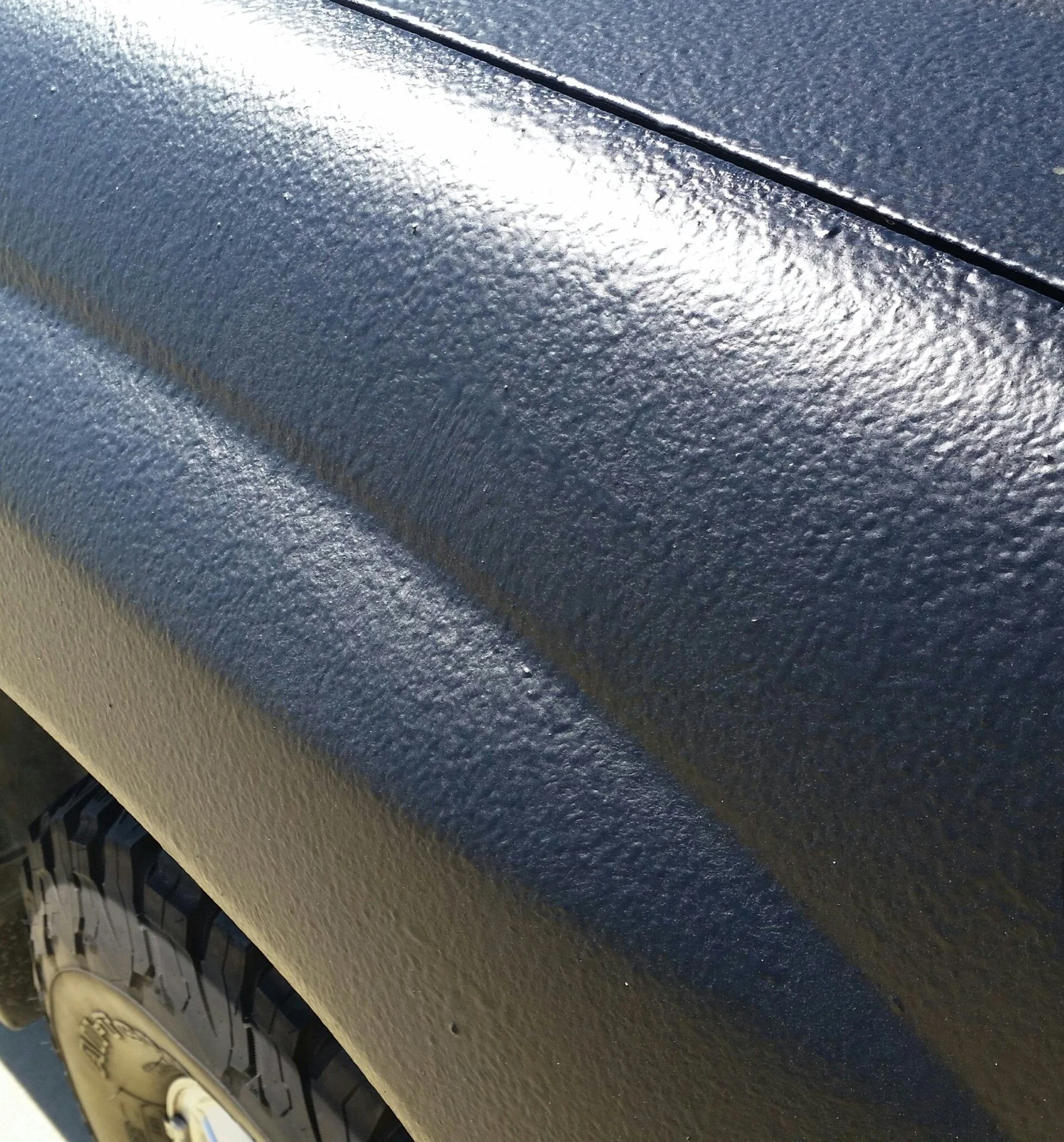

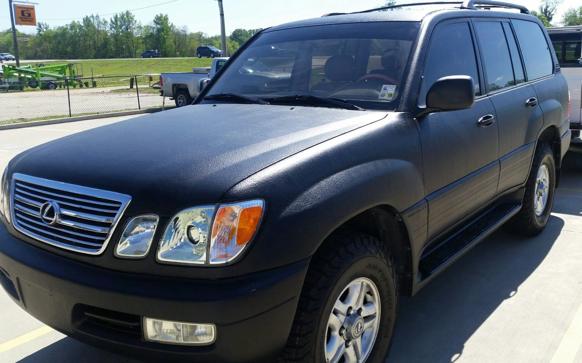

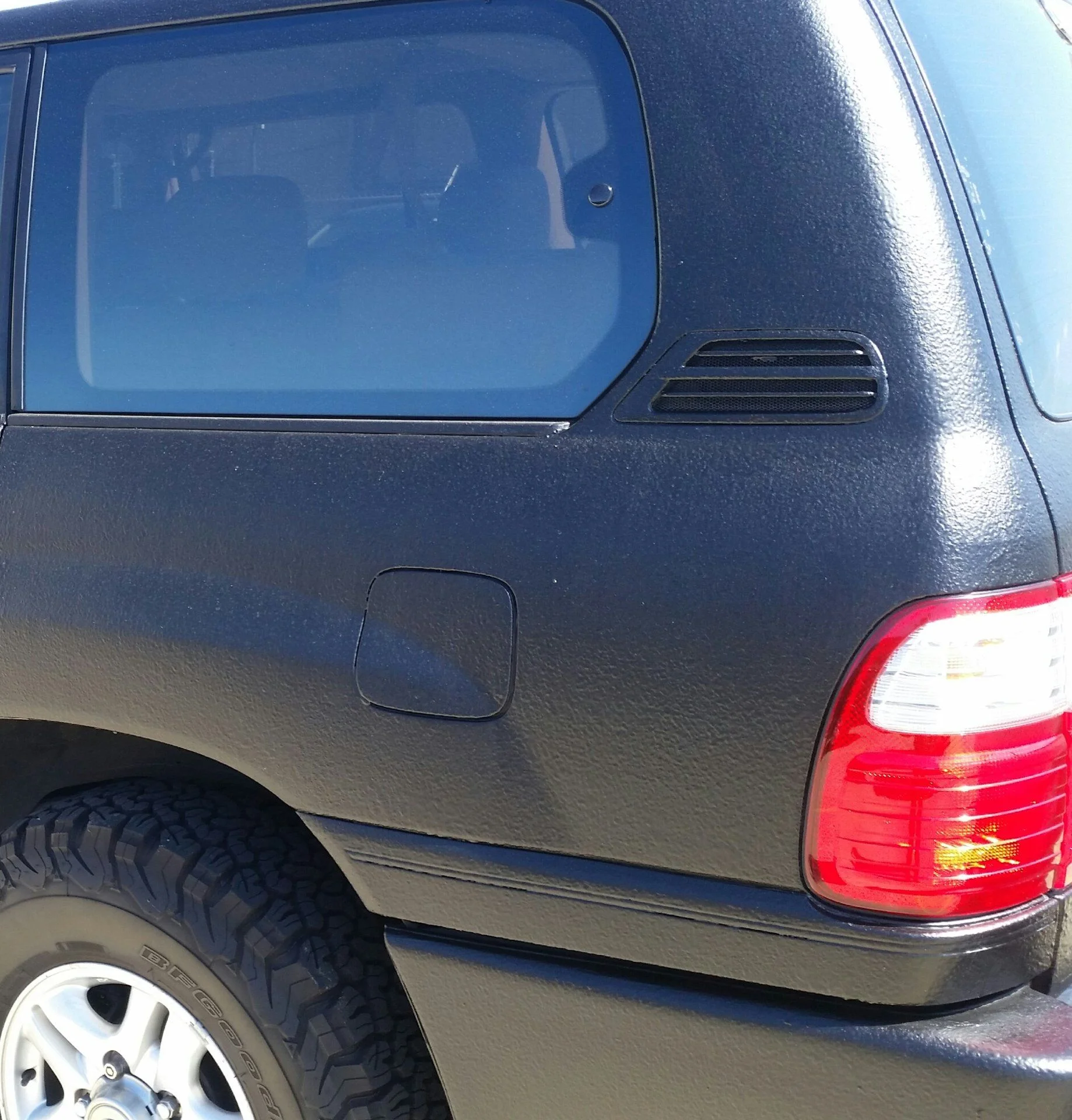

Thanks it's definitely not a perfect job there are some drips, roller marks, uneven patches etc, but I was pretty darn tired by the time I was rolling the second coat after spending friday evening through Sunday morning doing prep. I wish I'd swallowed my pride and asked for a buddy to help. Here are some pictures in the sunlight there is some pollen on it right now:

Really good job. Well done !!

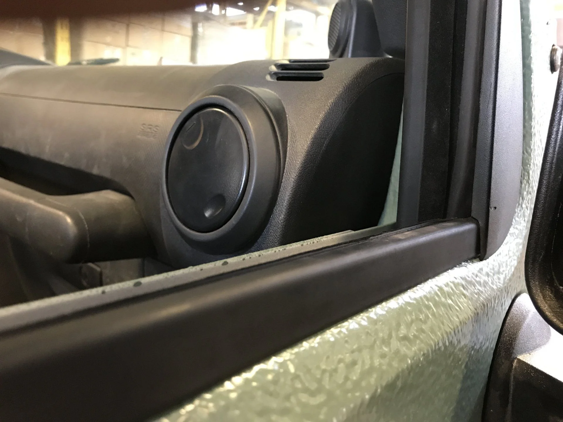

I'm still finishing up but it's definitely worth pulling all doors and hardware. I just made a zip lock bag up for each door etc. I also marked everything and took good pics as to how everything reassembled. I went with epoxy primer with light quartz gray on top. I also used the whizz smooth rollers. They eventually fall apart too. I didn't want to pull glass so elevated rubber seal with some thick weed eater string. I did remove moon roof glass ( 6 10mm nuts) for better access to roll.
