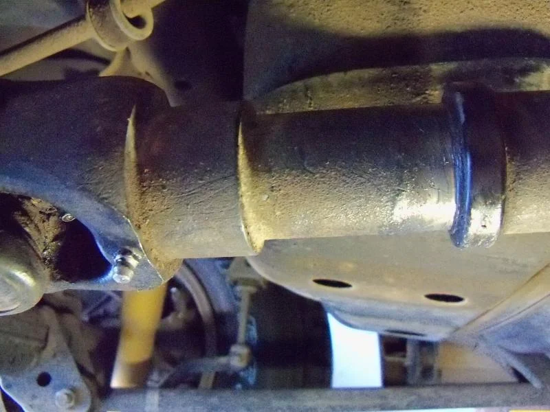

After reading these discussions about driveline greasing, I took some 5% moly Amsoil grease to all of the fittings. On the rear slide yoke fitting I stopped after about 20 pumps and it seemed like the shaft was moving - no grease came out of the slide. This morning after having driven it around for a week I pumped several more strokes in and again watch the shaft make a slight sound and move some. Still no grease coming out of the shaft as some others pictures show. I removed the zirk and jumped up and down on the rear bumper to relieve some pressure - about a 2" stream of grease came out.
I'm feeling like I need to remove the rear driveshaft. My question is do I just remove the four bolts where it connects to the rear diff, or ???
Pictures of the area:

Pump more! The sound and movement are good. Pump it until the shaft raises at least an inch or so. Clean the area where the yoke slides with a mild solvent (I like WD40) or even a penetrating oil like PB blaster.
Then I'd drive it but you could just let it sit a few hours and then pull the zerk again since it sounds like you have hydrolock concerns. Keeping that grease under pressure should push the oil into the junk.
Give it a few more weeks to allow the oil in the new grease to seep into the old dried up grease and make it pumpable.
Until you get flow you could try using a #1 or #0 grease. It has a greater oil/thickener ratio so more oil to seep into the accumulated junk.
