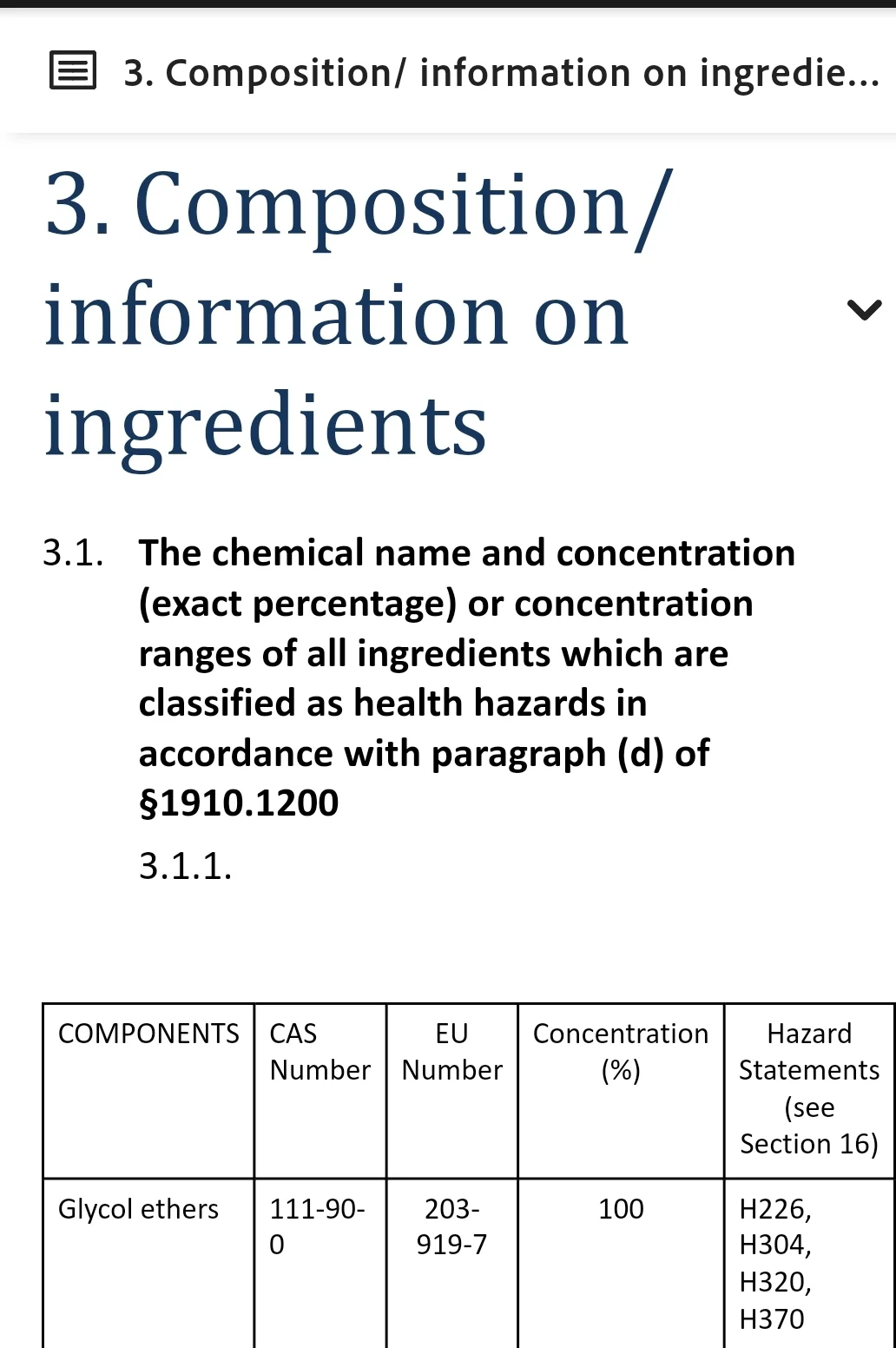

Here's the composition of AT-205, as per the MSDS (linked below). Glycol ethers, which are commonly used as plasticizers.

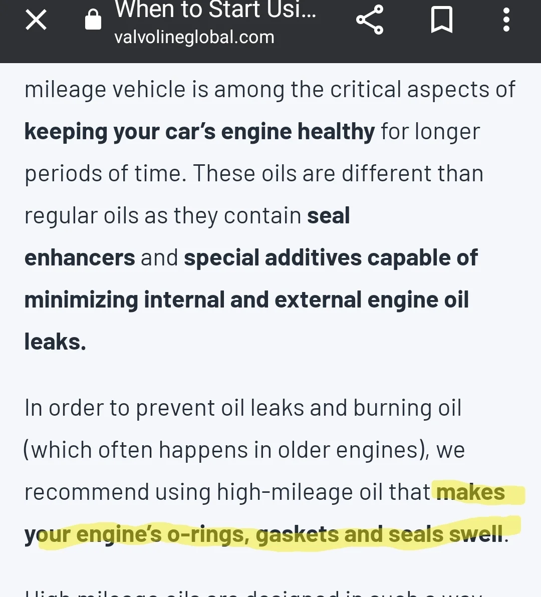

Mobile is a little mum on how their seal conditioners work, but here's Valvoline:
For the record, AT-205 is indeed great stuff, and (in my experience), more effective than HM oil alone. Next time I change TC and diff fluid I'll likely add some there, and to my transmission as well when I do a fluid change in the future, as I have some minor seepage on a few of those components.

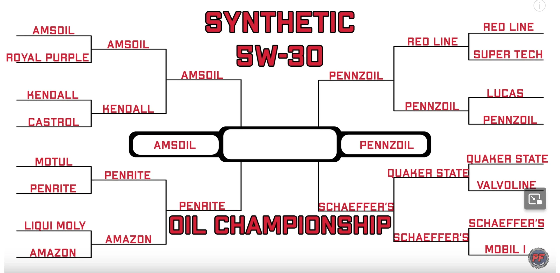

I know suggesting to folks which oil to use is the equivalent of religion and politics. Mobil 1 was once upon a time the cats meow (as long as you didn't use it in an airplane engine), but there are many better oils on the market today. Project Farm did a great youtube series on synthetic oils. I choose to run Pennzoil Ultra Premium, now that they took Rotella Gas Truck off the market.
Seems weird to do a bracket instead of just ranking them. Just tell me which one to buy! 🤣
