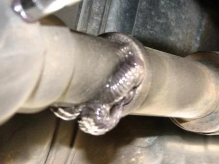

This is what you want to see ...
Front drive shaft showing new Moly grease (shiny purple) pushing out old Amsoil 2000 series grease (red). If the old grease was contaminated or emulsified with water this flushing action would be more important.
attachment.php
Clean new grease spilling past the grease seal on the rear yoke. This is what you are after.
attachment.php
