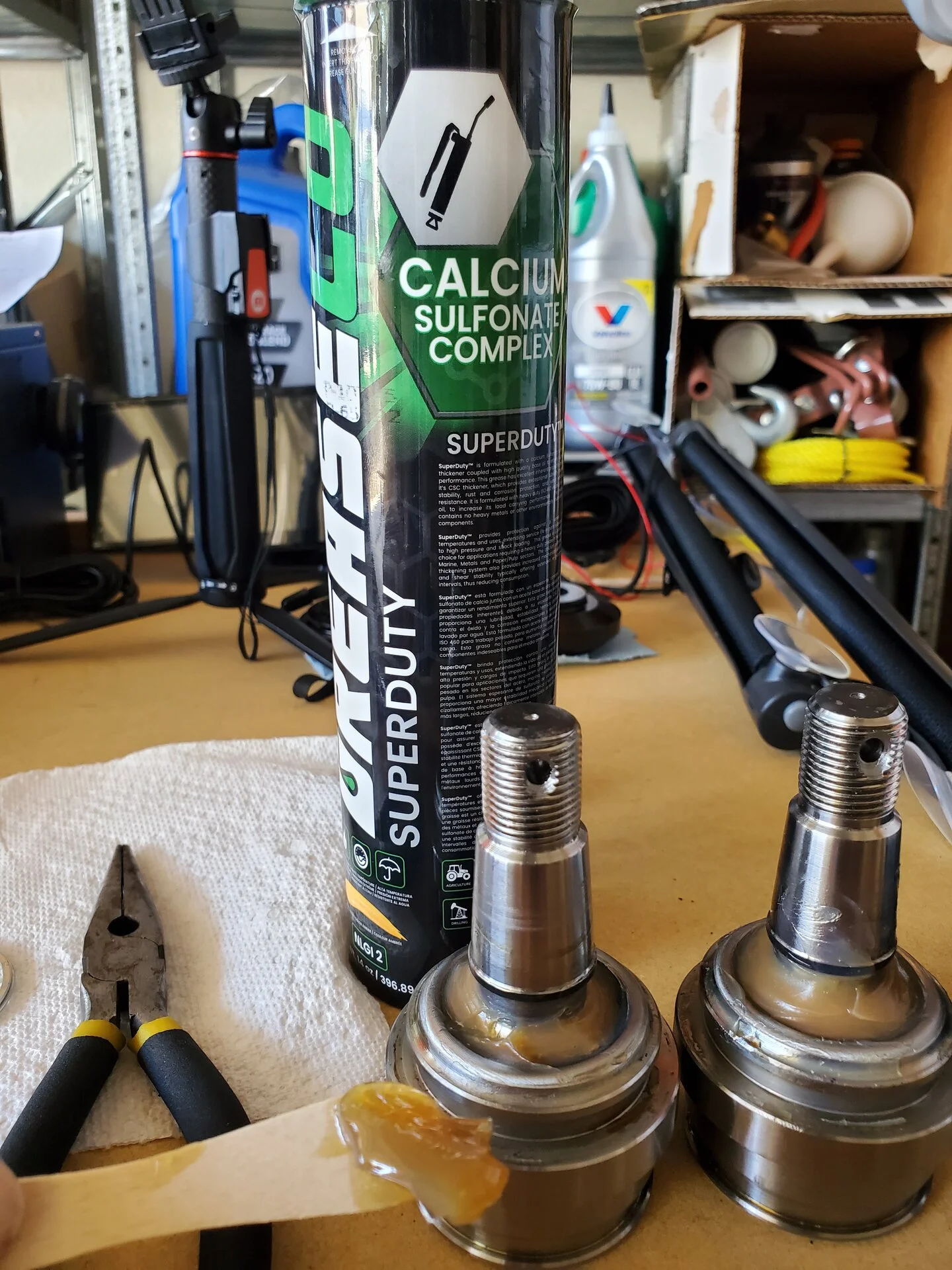

Trying to install the new 555 ball joint for LCA, and then realized one on the left seemed having less grease than the other one at right. Is that a concern?
If to add more grease what grease should I use? I happen to have the Calcium Sulfonate Complex NLGI 2 grease which looks like in the similar color. Is it a good or bad idea to apply more of this grease to the ball joint?
Highly unlikely to have a chemical reaction between the 2 that would compromise the joint in any way, doubt it would negatively affect the rubber boot either. It's not like mixing different weight motor oils that would causing aerating or foaming and potentially damage engine bearings.
If it makes you feel comfortable you can always clean out the existing grease and repack with grease of your choice. We have been exclusively using Redlines high temp high pressure grease in axles, wheel bearings, and a long list of other assemblies for over 20 years. Incredible stuff!
It's a 555.
As long as the grease you have is rubber safe you'll be fine. You just don't want to use any petroleums that are caustic and degrade rubber and seals. You can usually find the TDS for a product which will help
Found this online: Lithium complex and calcium sulfonate grease both have the advantage of being compatible with each other and many other types of conventional grease lubricants. The only classes that are incompatible with a lithium complex and calcium sulfonate grease are traditional polyurea-based grease and bentonite clay grease. Calcium sulfonate is also incompatible with calcium complex grease.
I would have to think that 555 uses plain old lithium grease in their joints from the factory.

Any grease will outlast the 555.
Not very helpful or what he's asking considering he's bought them and is installing them. Grease you've got should be fine, in fact like you've said, looks like a match.

Like you mentioned, just hit bare metal parts like ball joints or tie rod ends with spray paint.
Thanks everyone for the advice. I will pressed in the 555 ball joints and sprayed the bare metal. Will report back how long it may last.
