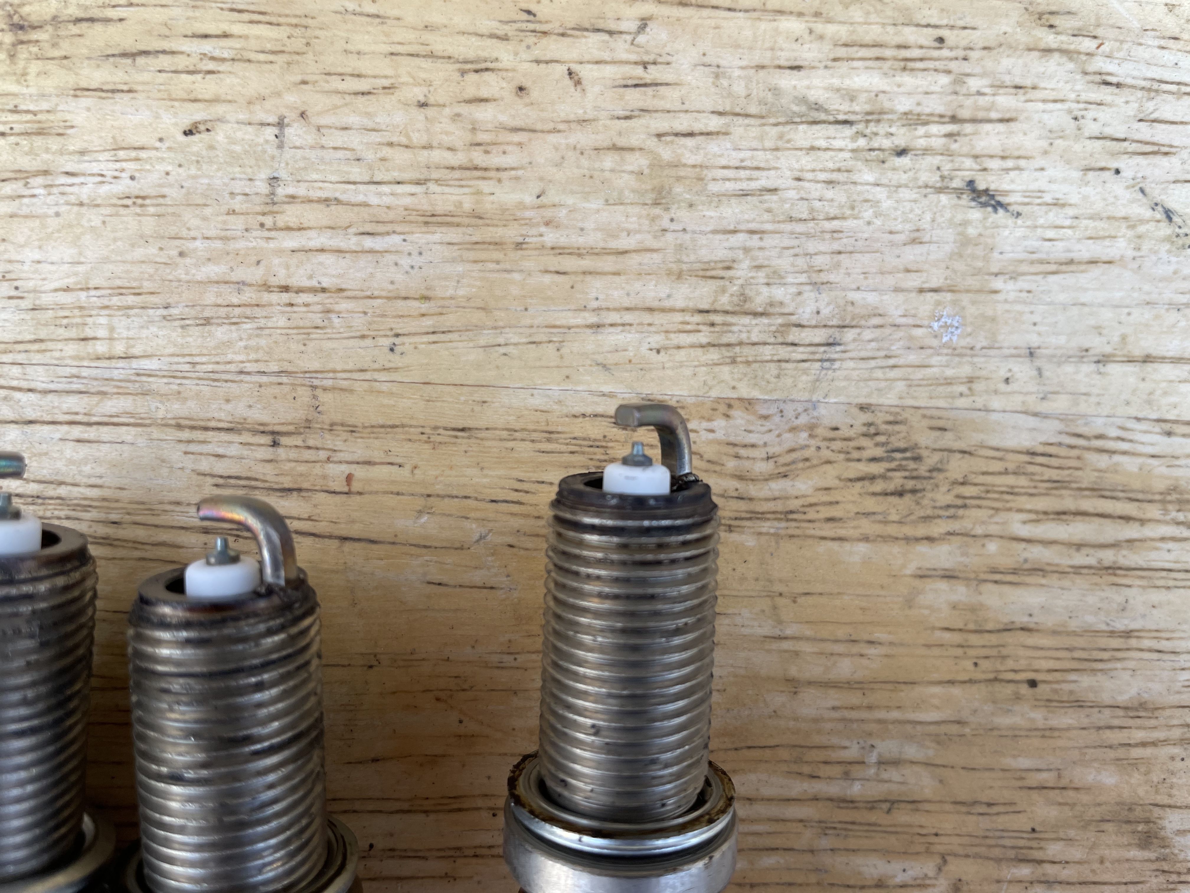

Thanks gaijin, I will find my densos 3421, measure them and try them. I am showing them online to be .044, not .043 as your screenshot indicates.

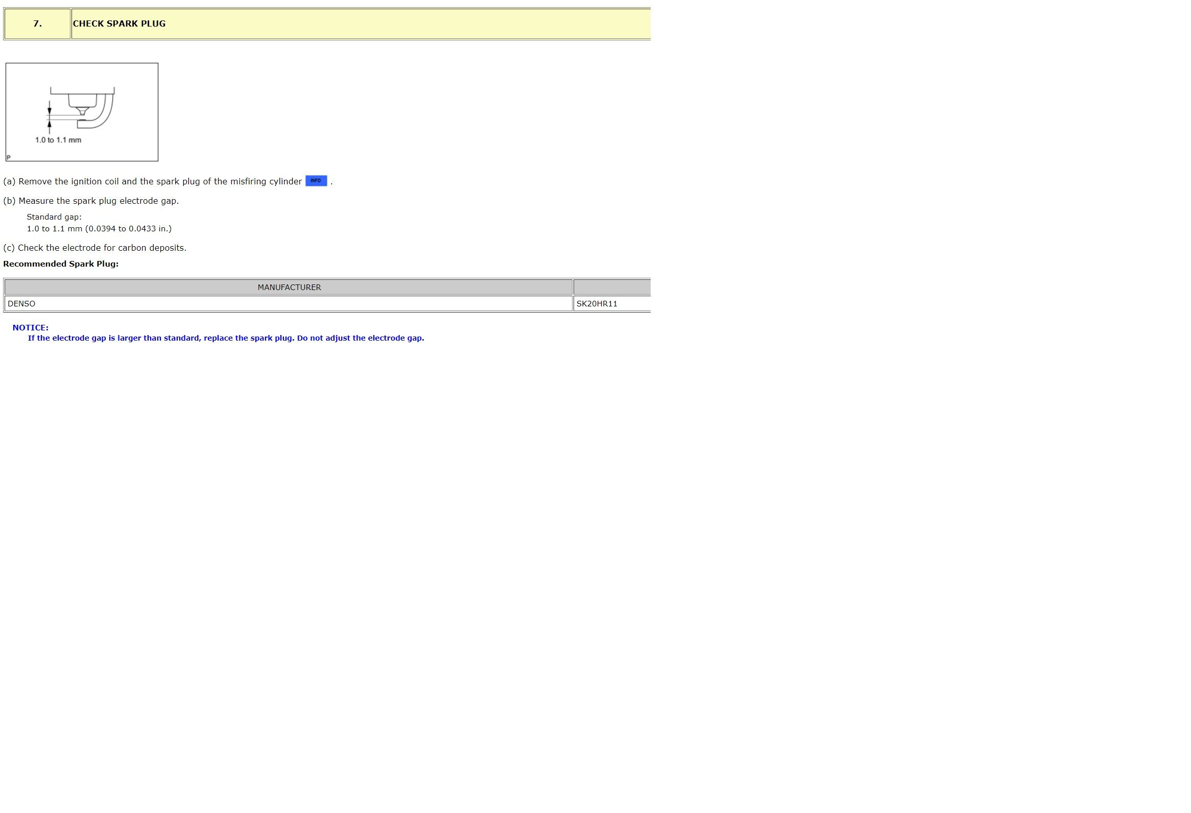

The document I am working from says 1.0mm - 1.1mm; .0394 - .0433:
The Denso website (See it here: 3421 SK20HR11 Product Specifications) shows the
3421 SK20HR11 Iridium Long Life Spark Plug​
Gap = .043" (1.1mm)
Which is consistent with the Owner's Manual.
HTH

The denso 3421 are at most .041.

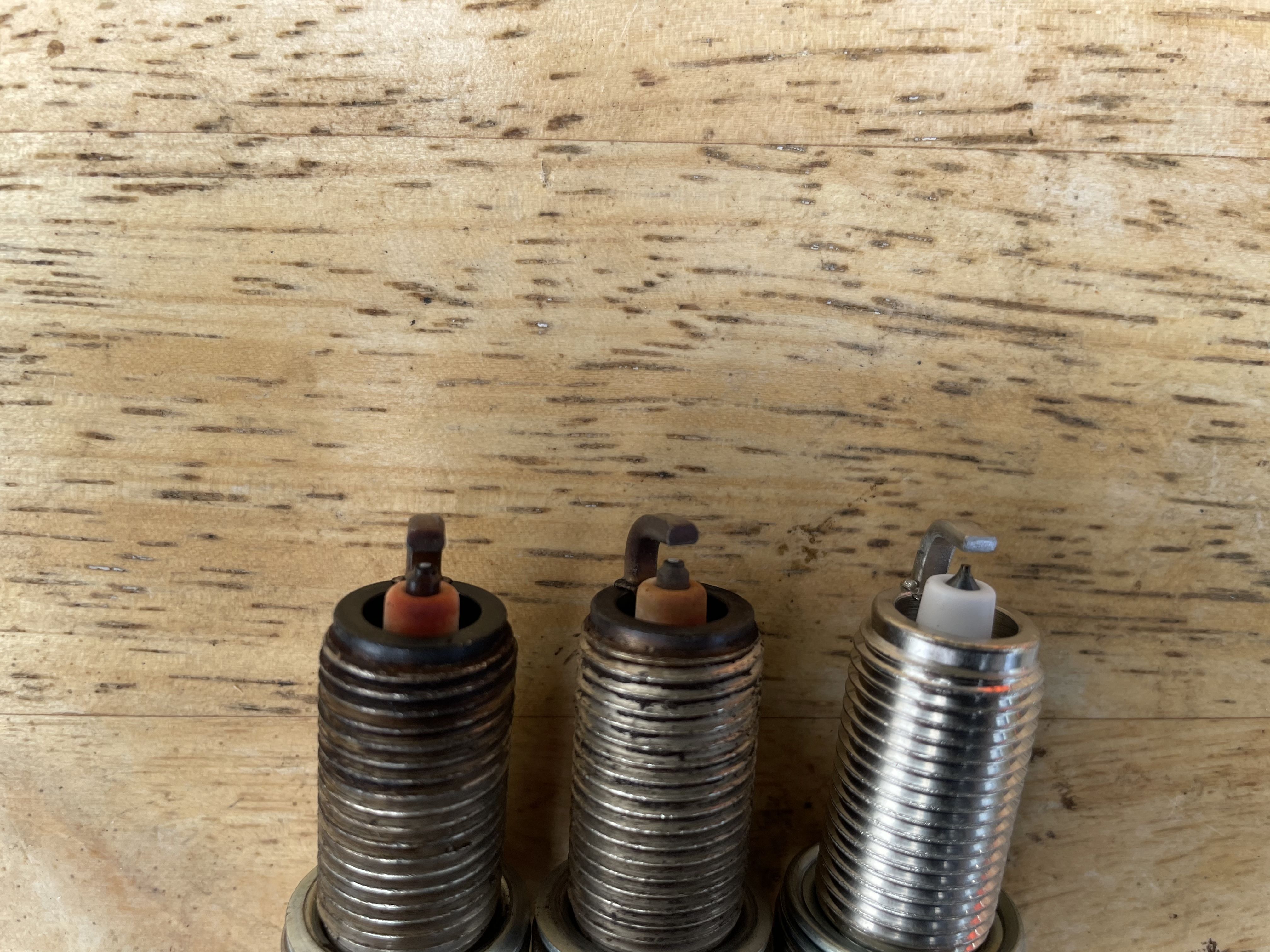

some plugs, left autolite with a couple hundred miles, pulled immediately after stumbling misfire. Middle put back in run several miles without stumbling and pulled, right denso. Bottom autolite with several miles no stumbling.
installed the denso 3421 after letting it sit and cool a bit. Misfire and pending dtc on all cylinders at initial startup.
