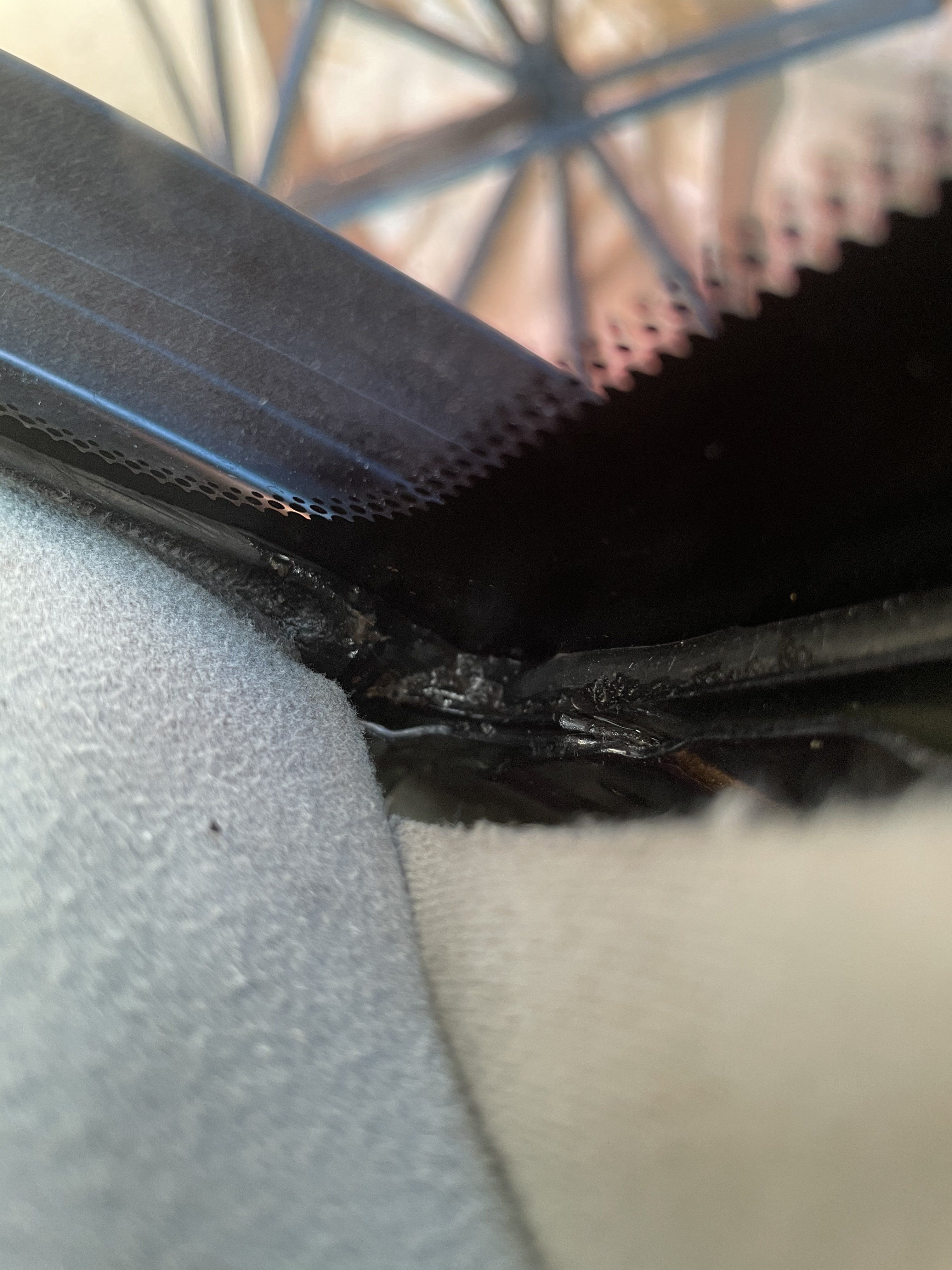

It’s barely drizzling so I poured water in the sunroof drain, I can hear it hitting the ground and the pillar wasn’t damp.

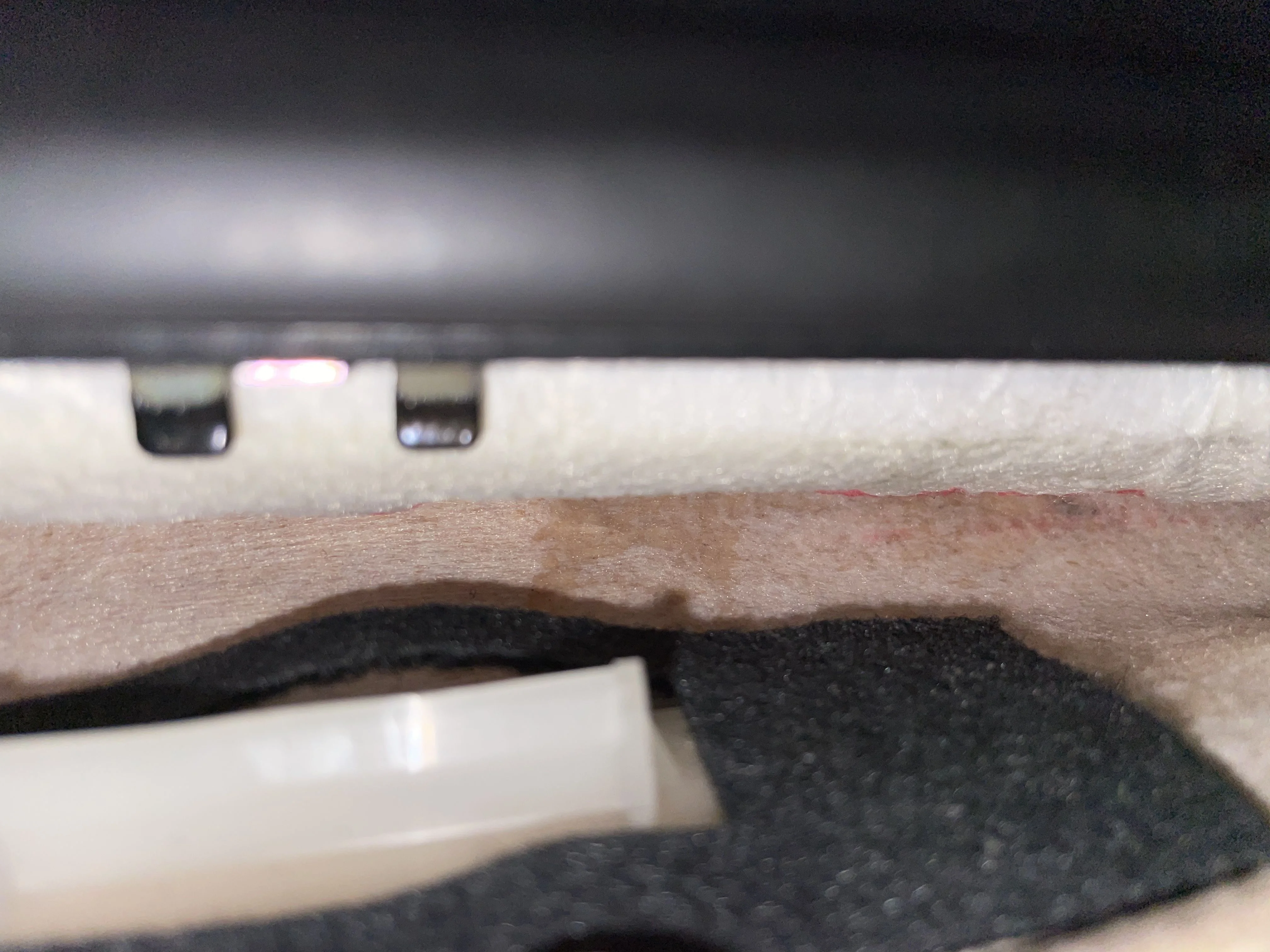

I moved to pouring in the gutter, and the dampness returned. I can see it on headliner near where the cable enters the channel.

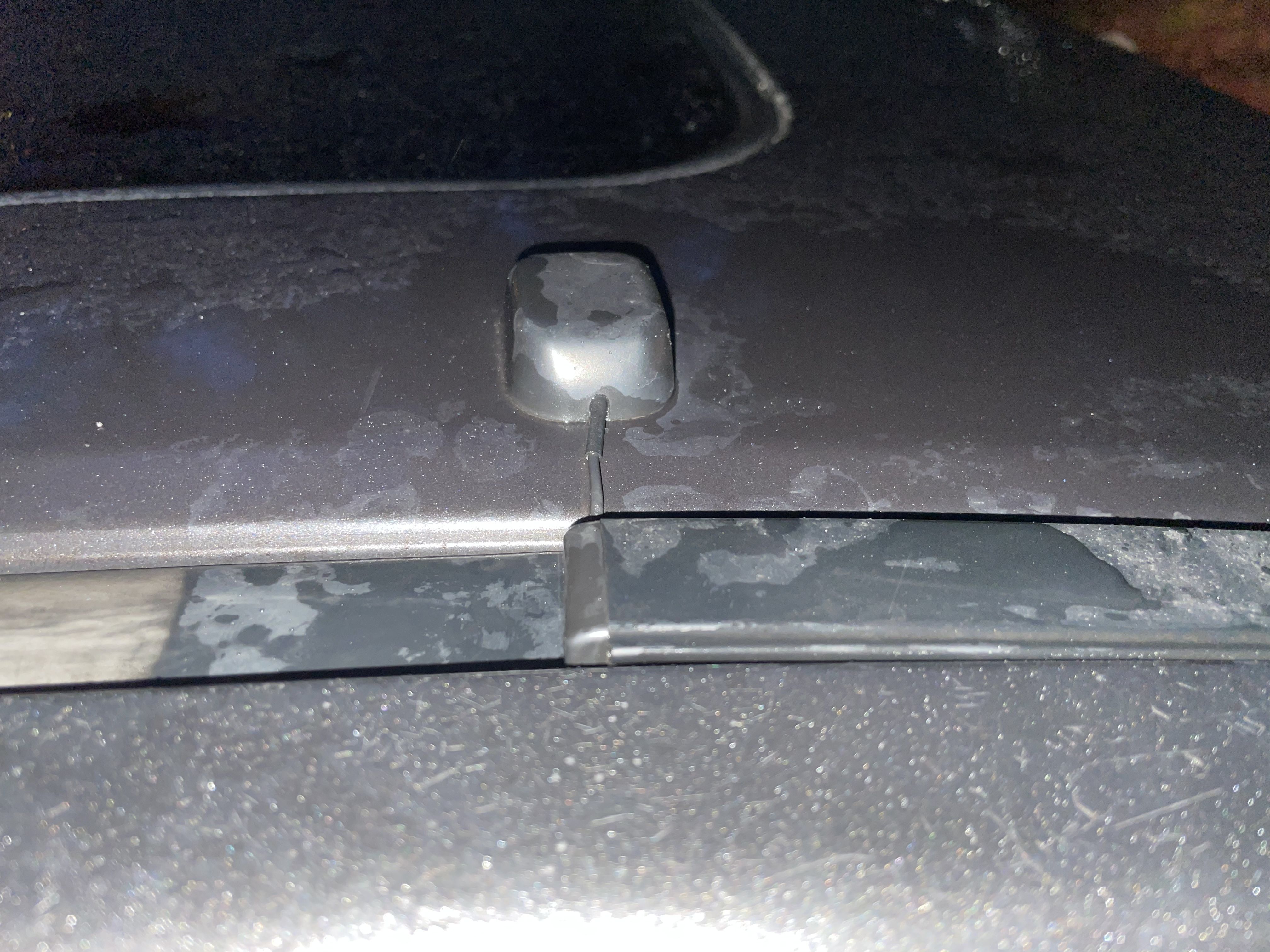

Vin is not factory etched in the glass. It is often a dealer added item (extra profit).
I’d look at where the cable for that aftermarket antenna goes through the roof.
Did they really put it through the roof!? I envisioned it running down the gutter to the firewall.
Who knows? It isn’t factory, so they could have done it many ways. If you have a leak there, it seems like it may be worth investigating the possibility.
If they ran it through the firewall, you should be able to observe where it penetrates the grommet.

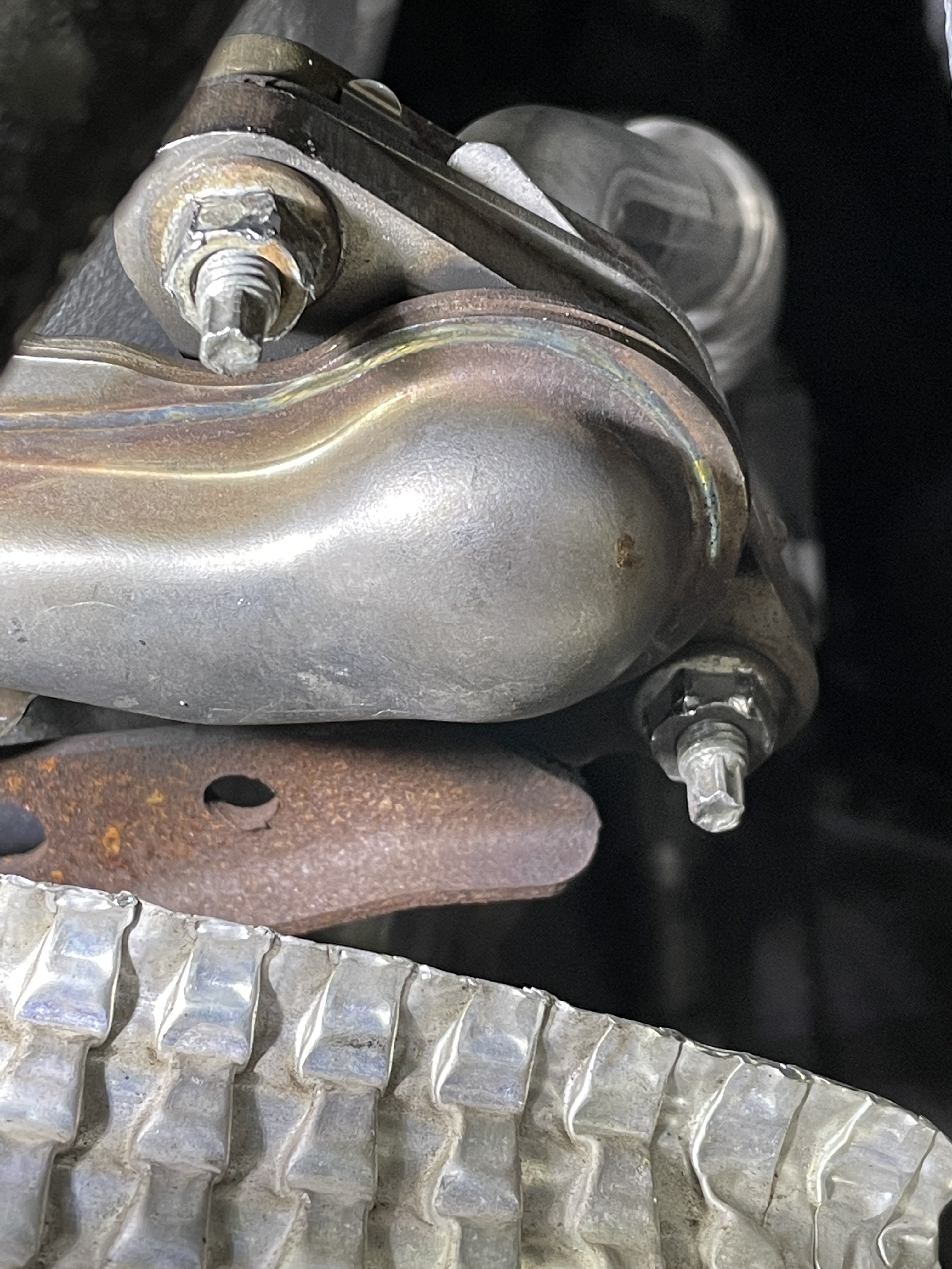

I removed the plates today and apparently messed something up on the drivers side, exhaust leak. I went to put the plate back in and still an exhaust leak. I can’t seem to find what I broke, bent etc, any ideas?
I think my leak is coming from the pipe to flange on the manifold side, not between flanges.
I don’t really like this idea, but not ready to pull/weld/replace the manifold... thoughts?

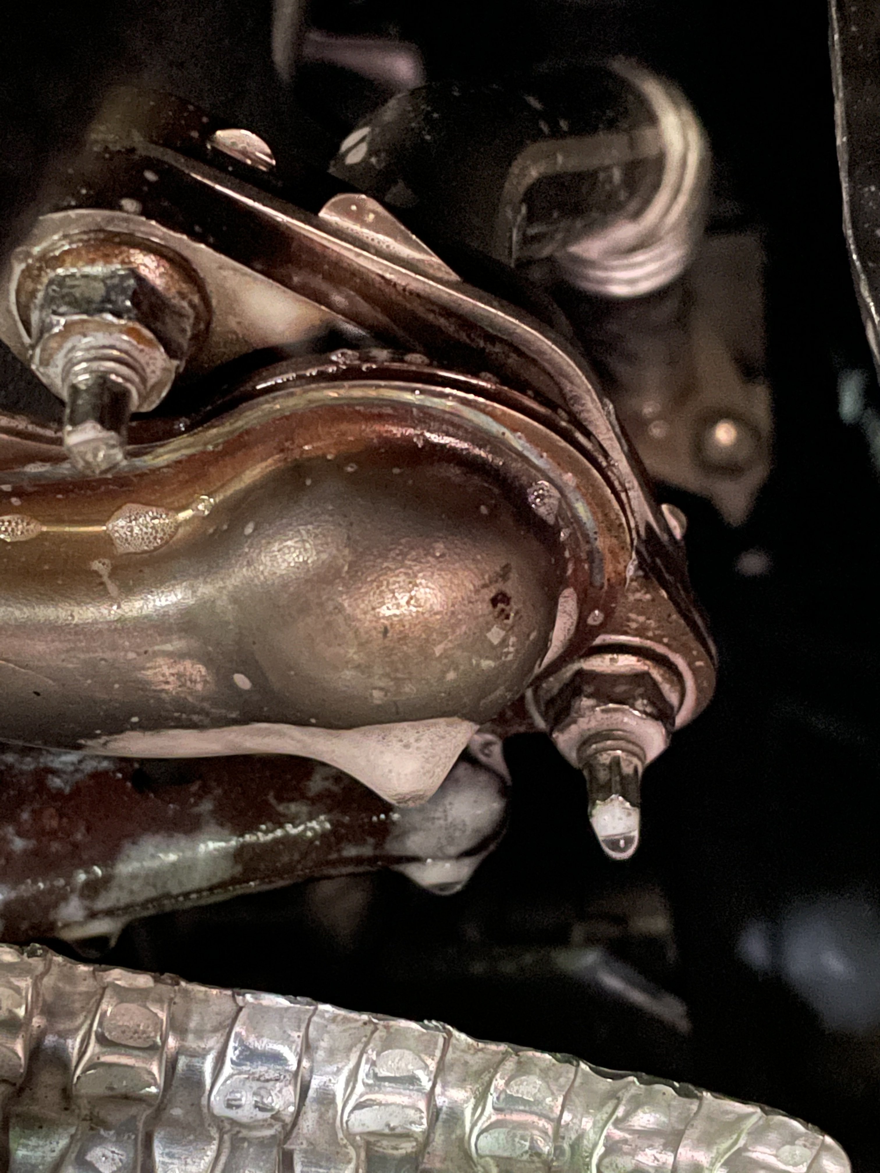

Wait? WTF is going on there? Why is there metal strapping there at all? Clearly, you've got a leak in that area. My advice is to replace the whole part. Are other parts of the truck put together this way? Was the strapping idea to put pressure on the lateral tube against the flange?
I stole that picture from a Tundra site. Mine currently does NOT look like that, but may soon.
I have an exhaust leak there after messing with the bypass/block off plate. I think its the pipe flange which is part of the entire exhaust manifold, hence my entertaining of above option.

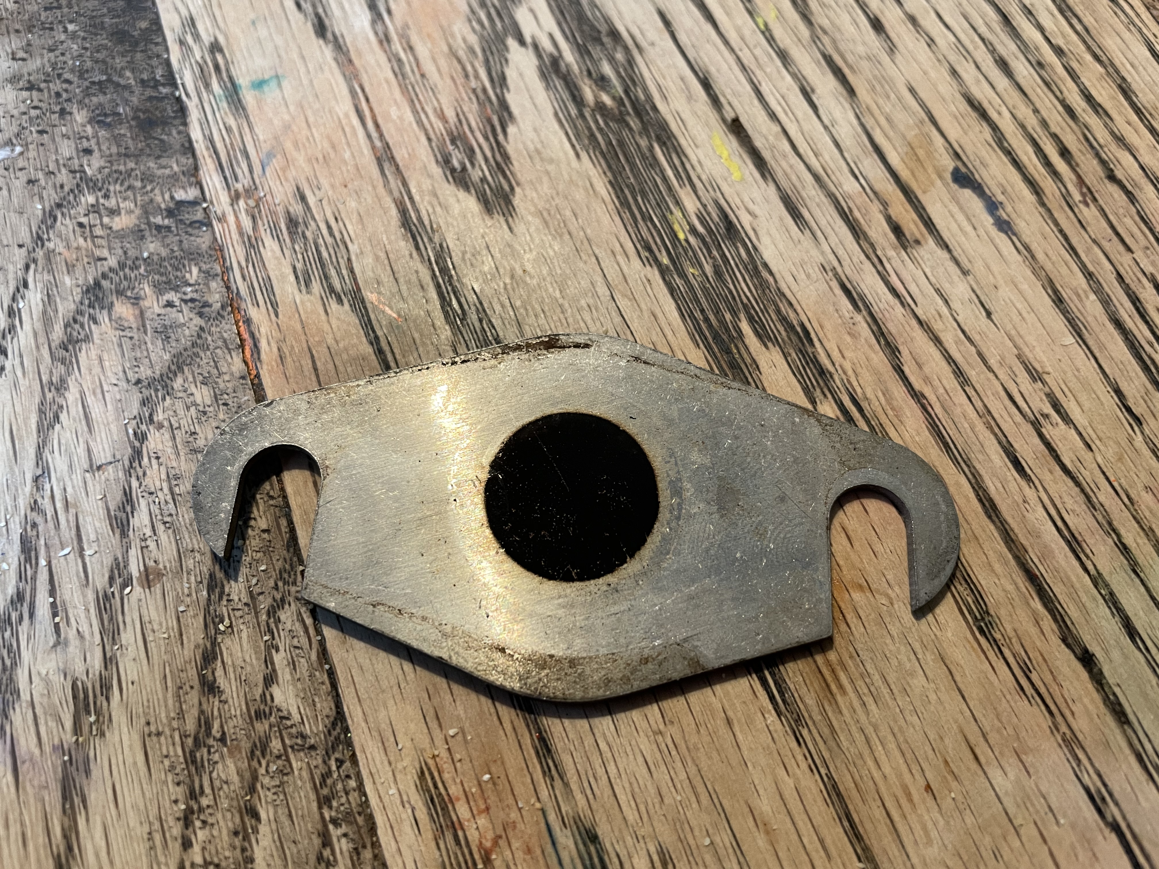

Thanks, but I think they are the right plates, now removed. Regardless that’s not where it’s leaking. You can see the carbon on the nut side of the flange. I only see two options, try the awful metal plate over to sandwich or pull it and weld it up.
Removed block off plate
