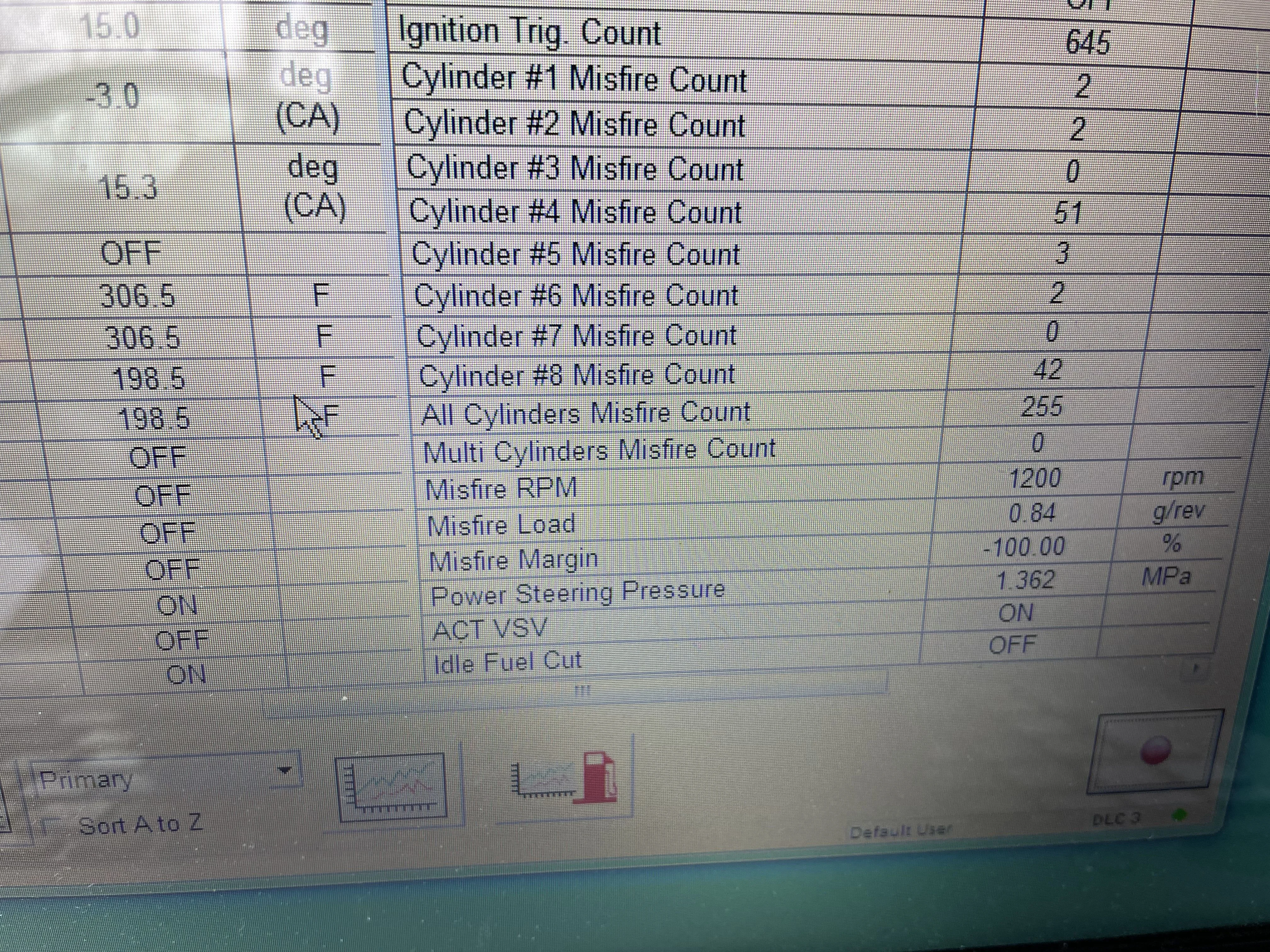

2 misfire rpm 1200, load 0.84
looks like cyl 4 and 8 and misfiring right now.

misfire count appears to roll over, only 4 and 8 are showing now. There numbers are consistent with one another.

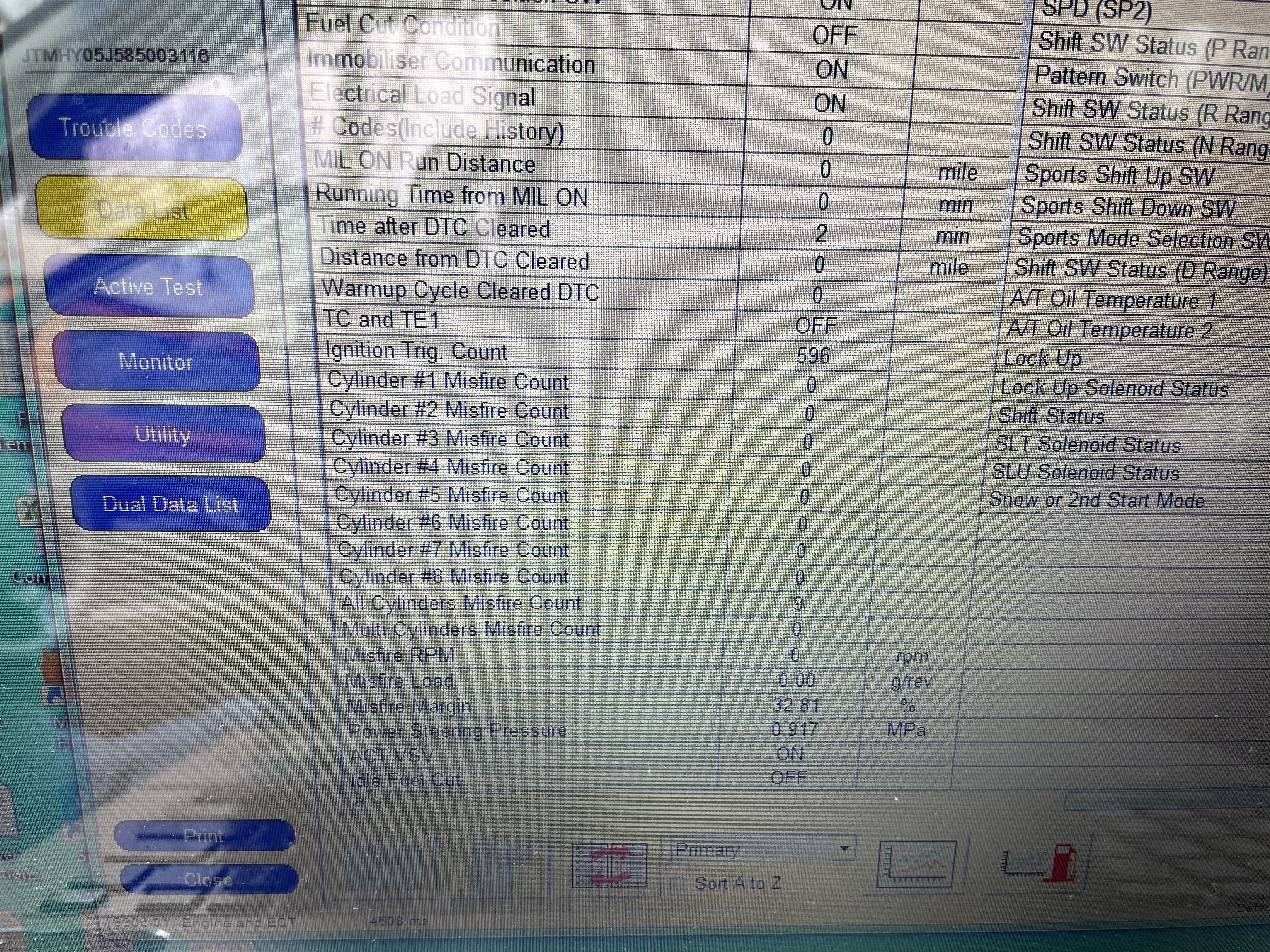

No codes, but there were a few individual misfires on start up, 9 all cylinders. It did NOT trigger misfire rpm or load though. This is restarting, not initial cold start.
