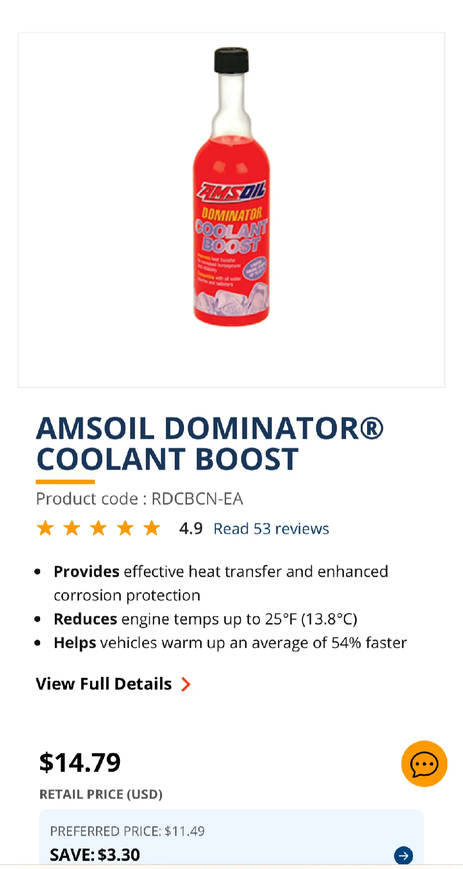

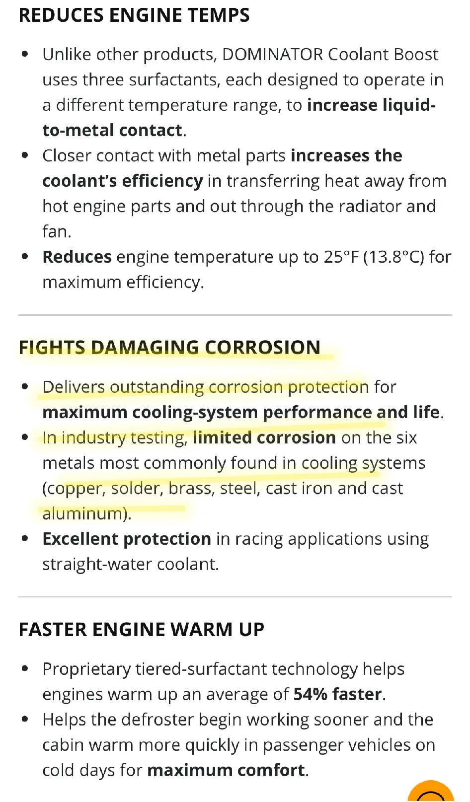

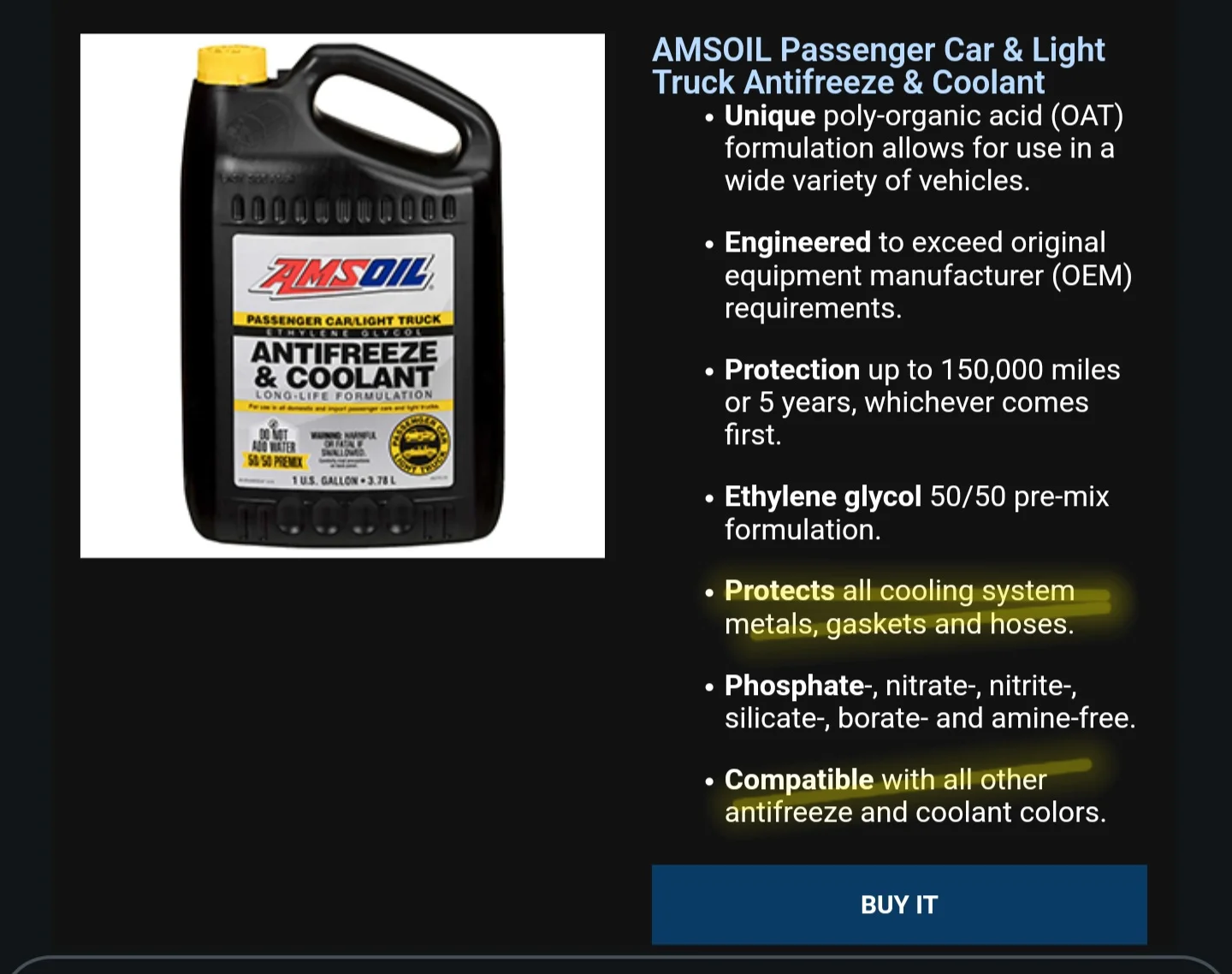

Amsoil's coolant and "snake oil" additive claim to prevent corrosion on metal and gaskets ..... for what that's worth.
Could be a worth a shot but I dont think there is a consensus on the root cause of the HG Failures.
Manufacturing defect, neglected cooling system with old corrosive coolant , over heating due to the radiator defect or coolant valley leak...etc are all possible explanations.
With that said I have first hand experience with a used and abused early 3urfe with 220k that has seen little to no maintenance and is still running strong and then we see the ones that failed at 140k with regular maintenance. 🤷
