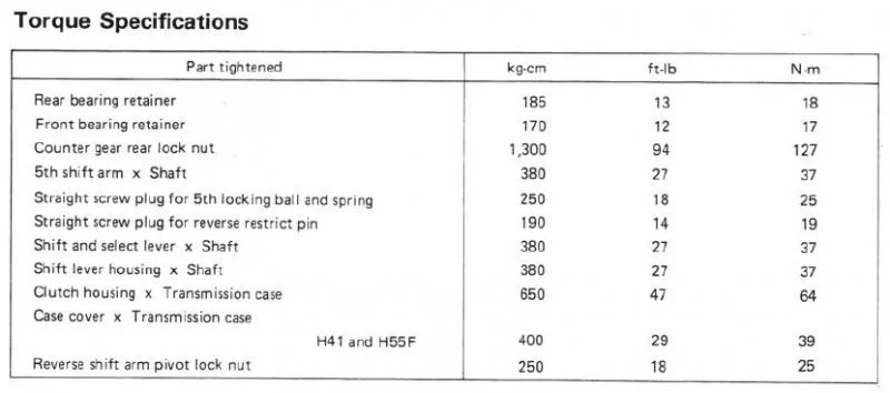

Here are the only torque specs listed for the H41 and H55 in the FSM:
H41/H55 Transmission Torque Specifications
