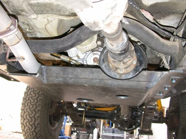

Fabricate a skid plate that protects it similar to this one.
In Marks Off Road FAQ, it seems like he discourages this type of conversion... He is wise, it would be wise to follow in his footsteps.
"d. DISC PARKING BRAKE. Other than the bling factor, I don't recommend this unless your cruiser is not going to leave the pavement OR you have a skidplate that is impregnable. While the theory of the disc is interesting, as a practical matter you cannot get a disc big enough to reach into a caliper of any worth without it being big enough to hang lower than the transfer case. That being the case, it becomes the weak link, because as soon as you hit it, you WILL dent it, and it will not travel thru the caliper any more. At that point, something will have to give, and I don't want to be there to find out what it is." - Marks Off Road FAQ
