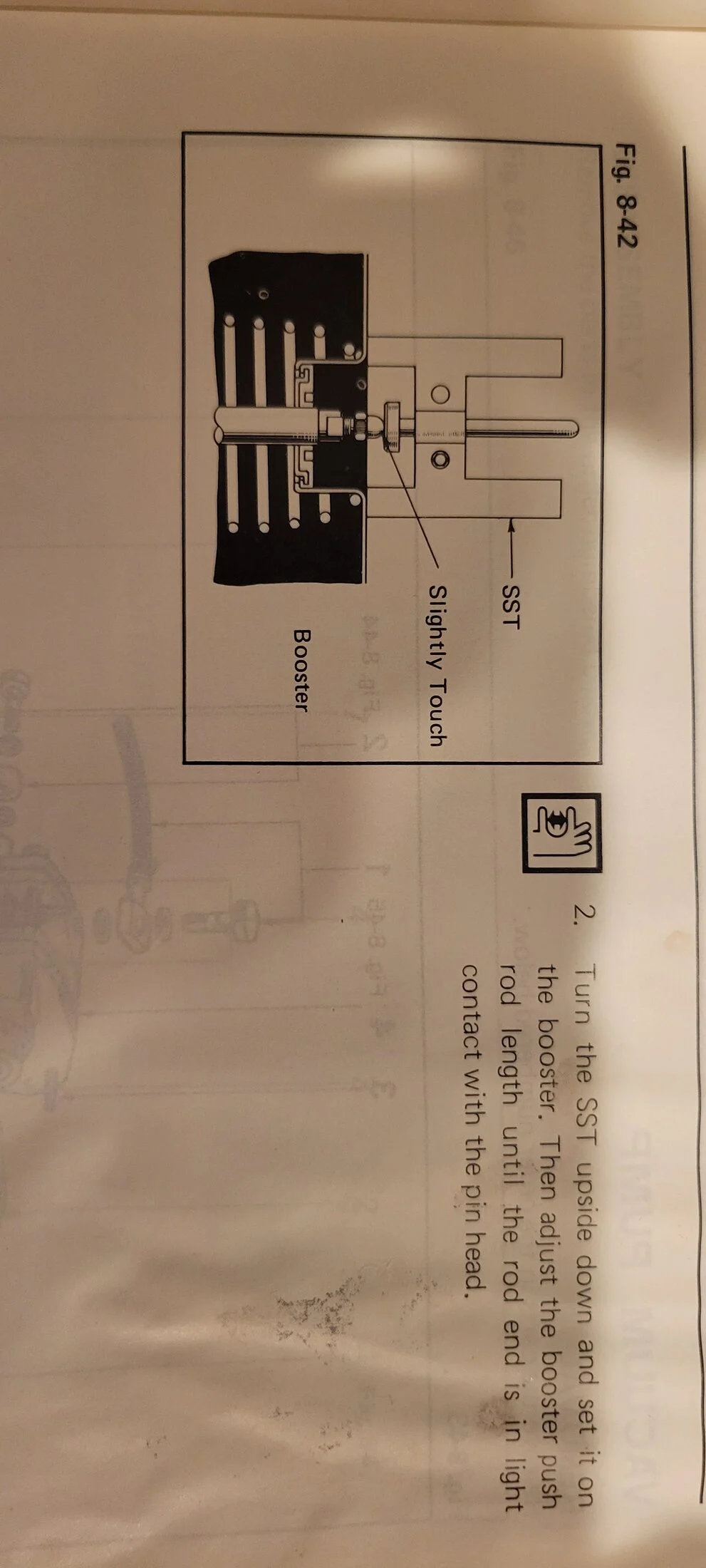

You probably need to adjust pedal height then adjust the threaded rod extending from the master to the pedal per the fsm. If the brakes continue to build pressure while driving you may have to adjust the rod between the master and booster per the fsm.
If thats the case, I'd check the rod between the master and booster. The brake lights might be the pedal height and the rod under the dash.
Auto parts probably sell a tool similar to the sst.
I bought one online made for a Corvette and it works perfectly.
