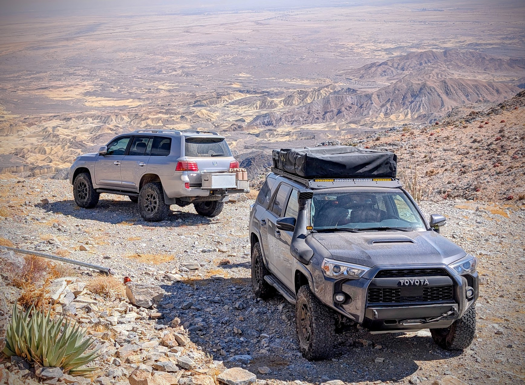

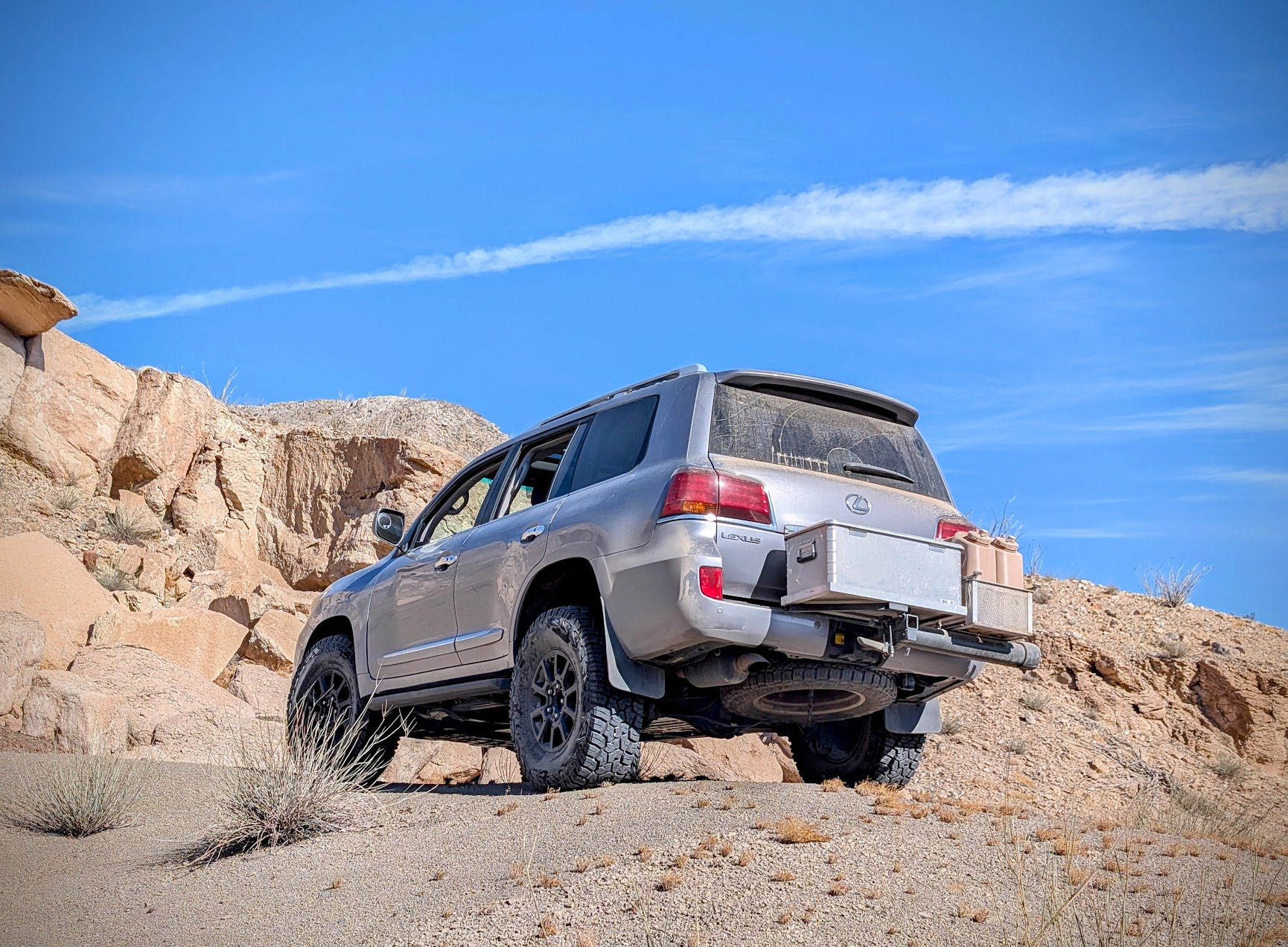

Second long weekend trip out. 37s deliver and totally worth the upgrade. Impressions are substantial improvements in overall clearance and angles. Rocks look and feel smaller.
Did some business in the dunes and sand. Floatation is awesome. Where I would bog down previously on super steep dunes, this tire set maintains floatation longer and can surprising to put power down where I thought would be impossible. Love it.
Obligatory photos

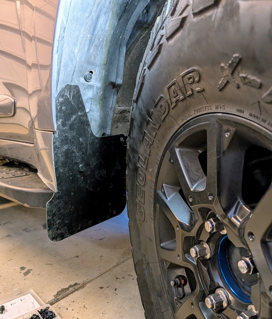

Getting to the details. As winter is coming, wanted to make sure I had mudflaps so salt, sand, and road grime doesn't get sprayed down the chassis. I got stock mudflaps to work with 35s. Homebrew for 37s with generic flaps cut to fit.
Looks so damn good! Man I wish I could get away from these tundra arms and use smaller mudflaps like yours!

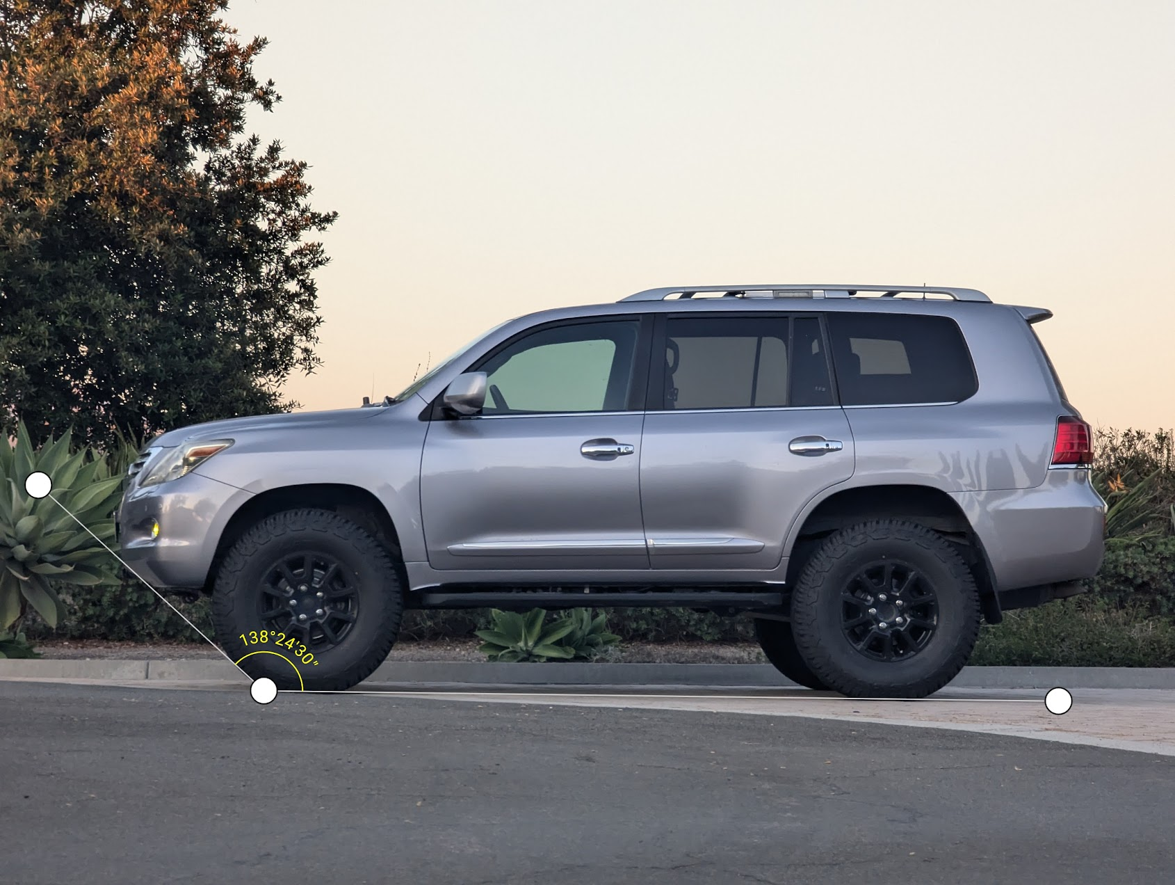

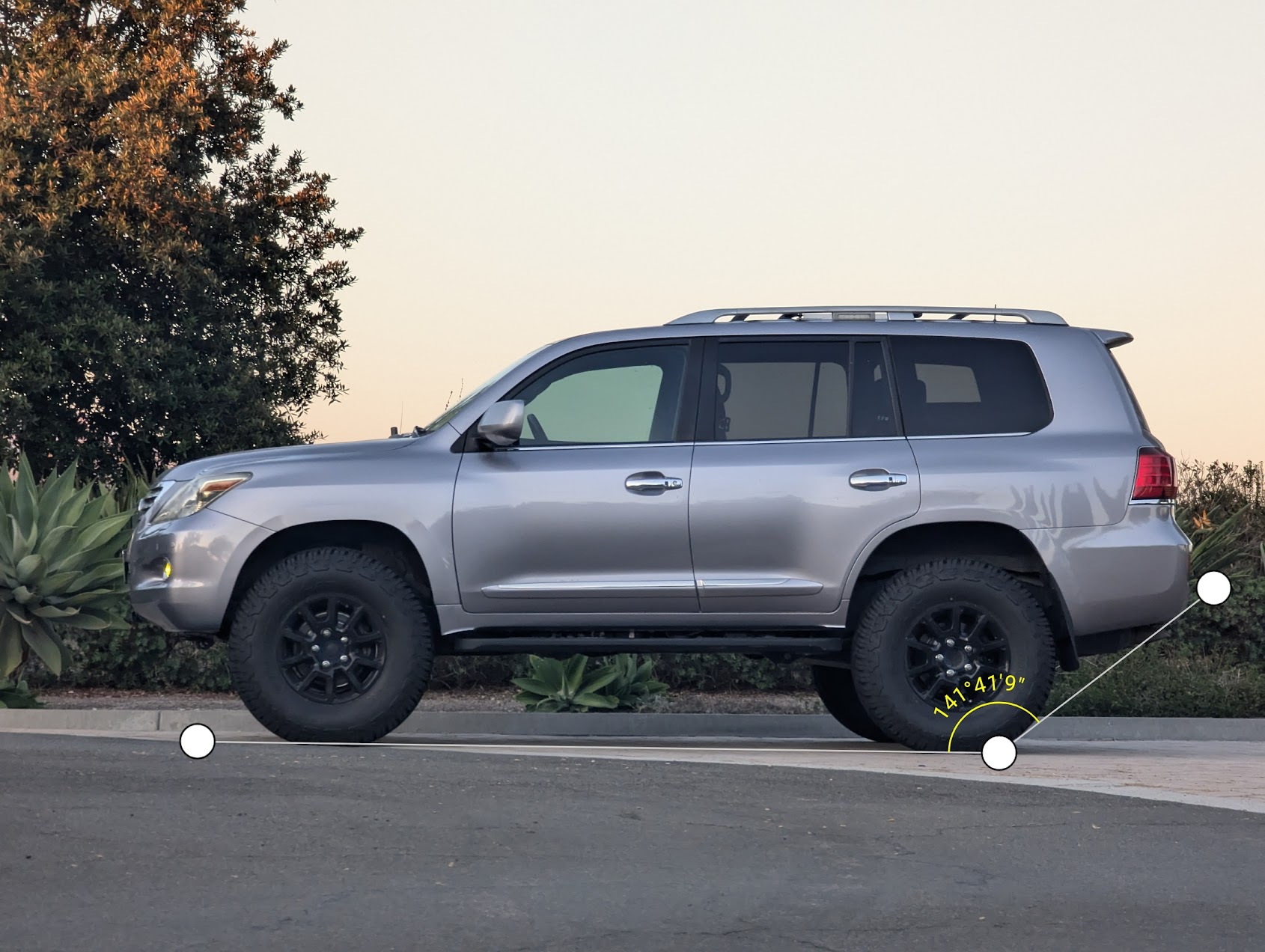

Here's measuring approach, breakover, and departure angles. Not completely scientific, but this method should provide angles within a few degrees of real measurements.
A solid profile shot taken from further back (maybe using a 2x zoom) will provide a better perspective for measuring. On Android, I'm using Angle Meter 360 to get angle overlays. Looks like the app is available on iPhones too.
I'm pulling angles across both tires so I have a better horizon reference in case there is any tilt in the picture. Using basic geometry to arrive at angles. For example, this would be 180° - 138° = ~42° approach.
Breakover would be 180° - 141° = ~39°
Departure is 180° - 141° = ~39°
This is an '09 LX570 on a 1.5" sensor lift, AHC high 3" suspension lift, .75" body lift (that lifts bumpers), and 37x12.5R18 tires to get approach, breakover, and departure angles of approximately 42°, 39°, and 39°.

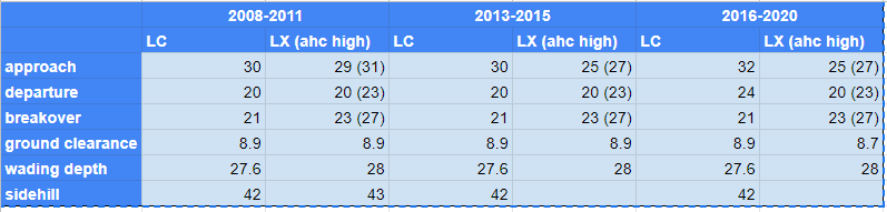

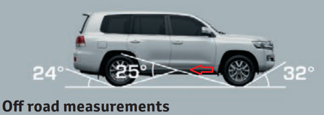

As a reference, here's stock angles discussed in this other thread. I've seen it suggested that a good off-roader will have angles in the 30 range. A strong off-roader should be in the mid-high 30s. For reference, a Bronco Raptor has angles of 47.2°, 30.8°, and 40.5° respectively.
These are big numbers. Wow. I don’t remember the OEM ones but even with the AHC it was never great in the 200’s. But what you’re getting now is awesome.

Sorry missed this. Yes, the numbers have gone way up and the obstacles it will now tackle and clear does support it. The numbers are all the links above but stock for the '09 LX in high was 31°, 23°, 27° versus 42°, 39°, and 39°. I'd say a big part of the improvement is due to the faces of the tires being closer to the bumpers horizontally, than just that gained from lift.
