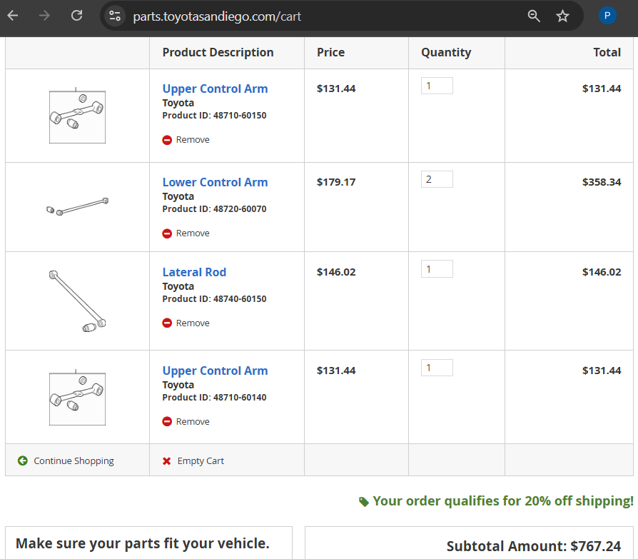

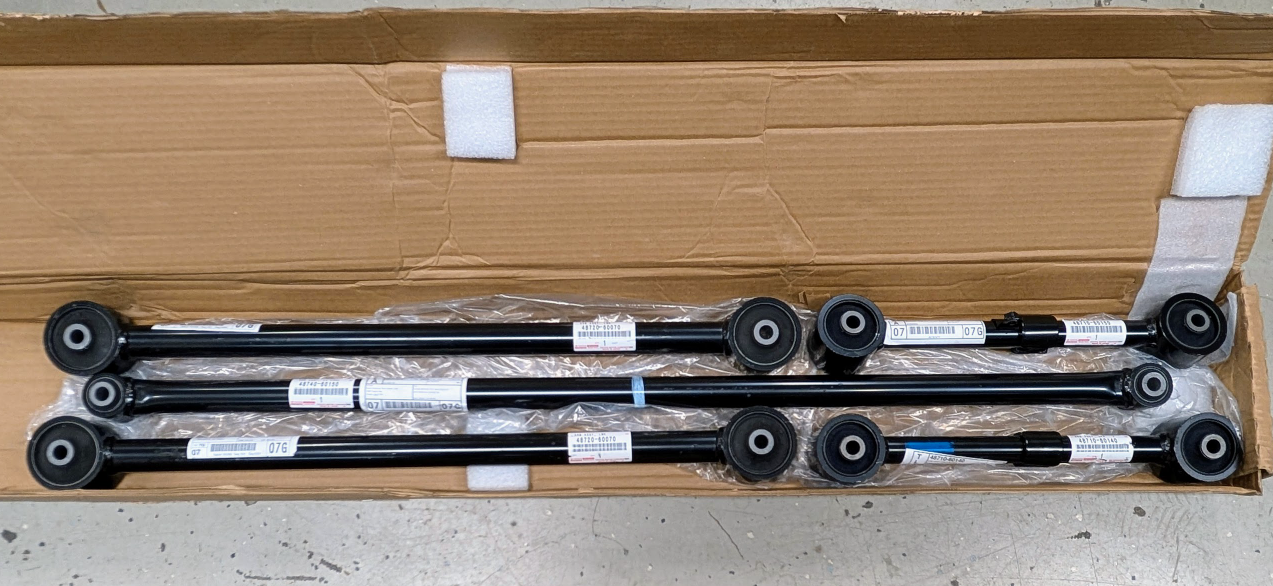

Rear suspension refresh care package dropped in. $767 well spent and honestly rather cheap for a fully refreshed rear end.
I just did panhard, lower links and sway bar bushings and I swear the difference was noticeable and immediate.
Yeah, that's what I'm hoping for as I can tell the rear end is loser, and not just because I'm on tall profile tires. That the original links got me 15 yrs and 180k adventure filled miles. I've got another 2k mile trip here before I get to installing everything.

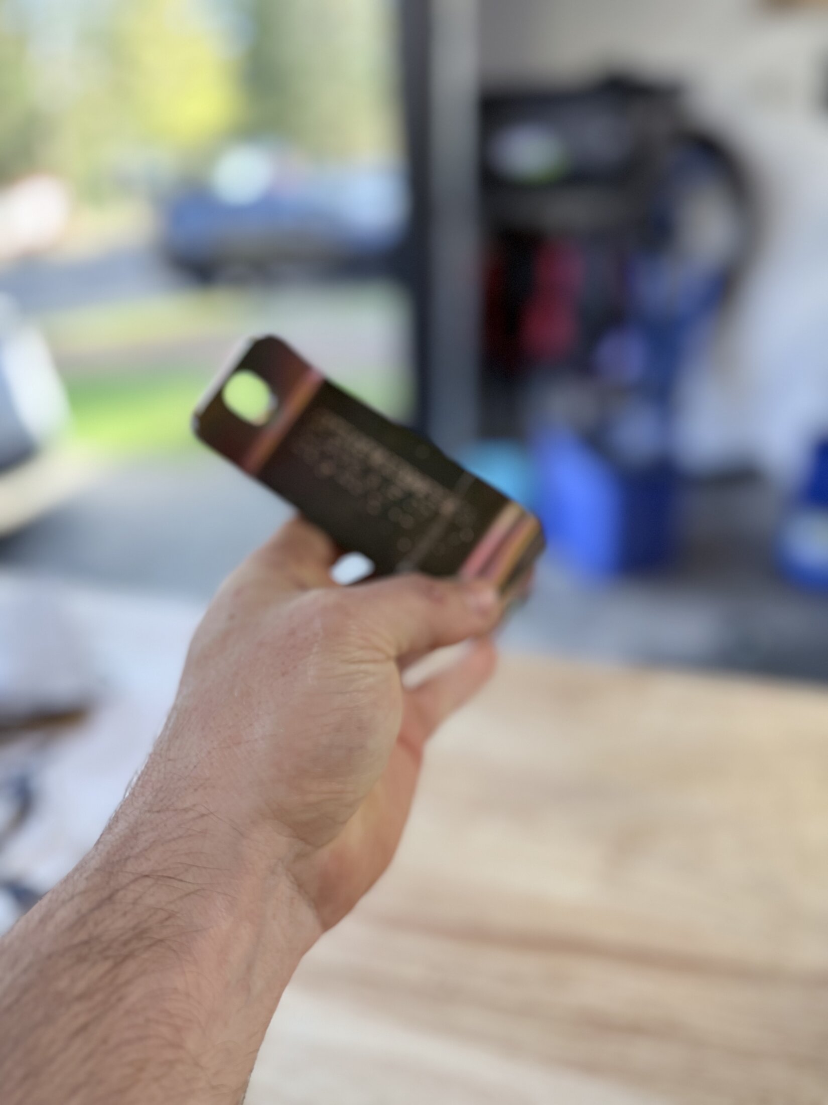

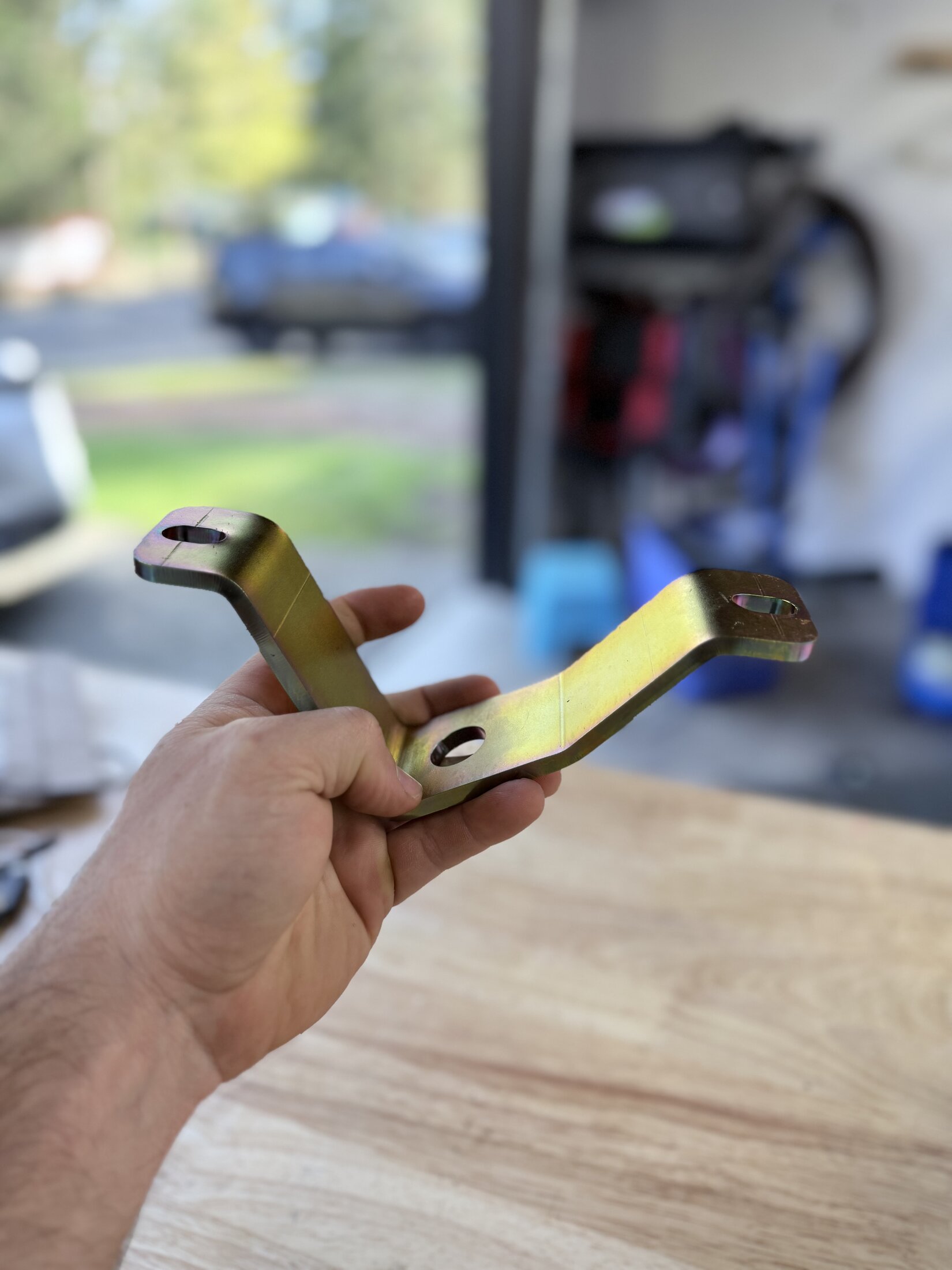

Since you brought it up, I bought longer brackets instead of longer links. They are seriously beefy.

Nice. I did the same recently for a soon to happen project. I ended up buying all Ironman 4X4 adjustable links. They were on sale so pretty much the same price as the OEM. I doubt I need the adjustability, but it’s been said here that the lower links are beefy. And having adjustability might be useful. Hopefully it’s not one of those instances where having adjustability might cause more problems than it solves with all the extra variables.
Also bought 50mm extended whiteline sway bar links. Hope to get it all on in the next few weeks.
There are brackets on the upper control arms for AHC sensors. I’m not optimistic they are not going to need some work.
Nice, didn't know those extended sway links existed. I DIY'd some welded in extensions (top).
I probably did t look hard enough but didn’t find anything that was specific for a 200. Who makes those?
Superior engineering
