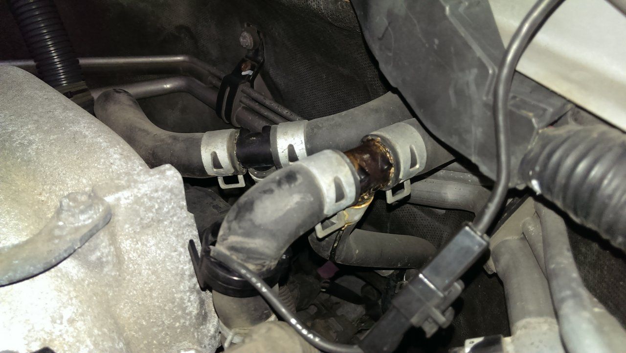

Have you changed your heater core "Tees"? My issue was they were leaking slowly, slow enough not to drip on the ground, but enough to cause air in the system and stop the coolant flowing past the highest point (the "Tees", actually) and into the heater core.
Even with the Tees leaking, the expansion tank will show full, and the radiator will start to show lower levels over time, but it doesn't take much air to bubble to the top of the system (the "Tee" area) and keep coolant from flowing past them into the heater core.
Look earlier in this thread for a photograph of the location and what they are, basically a three way plastic Tee on the left side of the engine near the firewall. They are made of plastic and eventually begin to crumble from the heating cycles. You can order them new from Toyota/Lexus and they should last another 150k miles.

This issue seems similar to what I experienced when my "heater tees" began to leak. The Tees are at the highest point in the cooling system and will trap air in that area, this is just before the heater core and the water pump at idle doesn't have enough pressure to push the coolant "up and over" the area with trapped air. These tees are made of plastic and will eventually fail, it's just a matter of when.
When you bled/topped off the reservoir, you put enough coolant in the system for the water pump to push up and over the area with trapped air, but it eventually leaks out again, very slowly onto a hot transmission and evaporates, so you usually cant spot a leak on the floor. Replace the Tees, that should solve your problem, I'd suggest just going to the dealer to buy new ones, they aren't expensive and they'll slip right in, they are usually good for 150k miles or more...
They are located behind the drivers side rear area of the engine, up high where you can see them easily. They might have some crusty looking material around them, that's the evaporated coolant. If they haven't been replaced they need to be anyway.

Air in the system will get trapped at the "Tees" and cause the same condition as a leaking Tee, as it's the highest point in the system.
