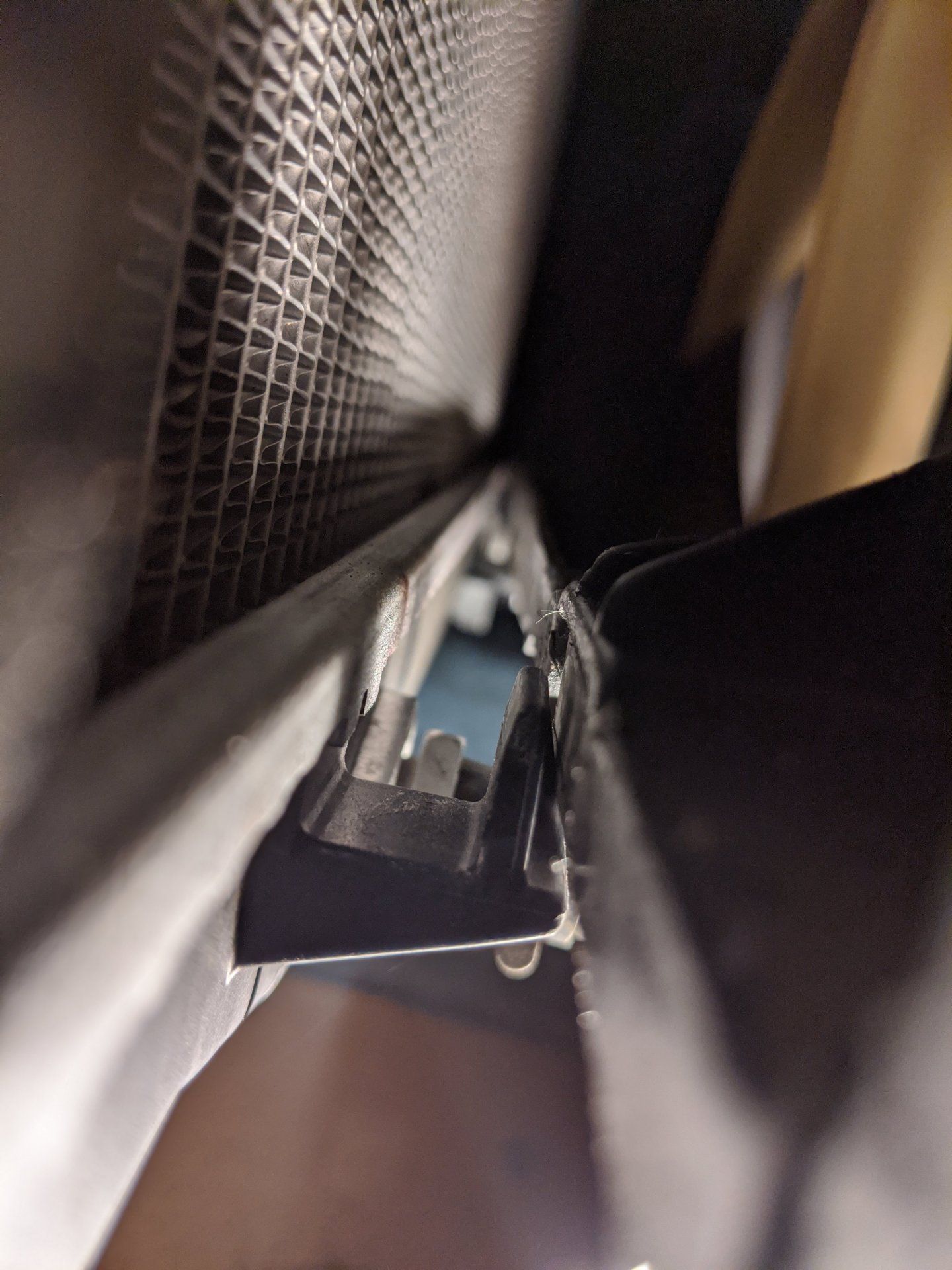

I definitely think it's coming from where the bottom is crimped. I can see it bubble under the crimps and come out through them. See this video.
I basically hooked up a pressure tester, pumped it to 17.1 psi per the FSM and it starts leaking like this.
You can see in the pictures that it's clean above the crimped part but from underneath you can see coolant coming through.

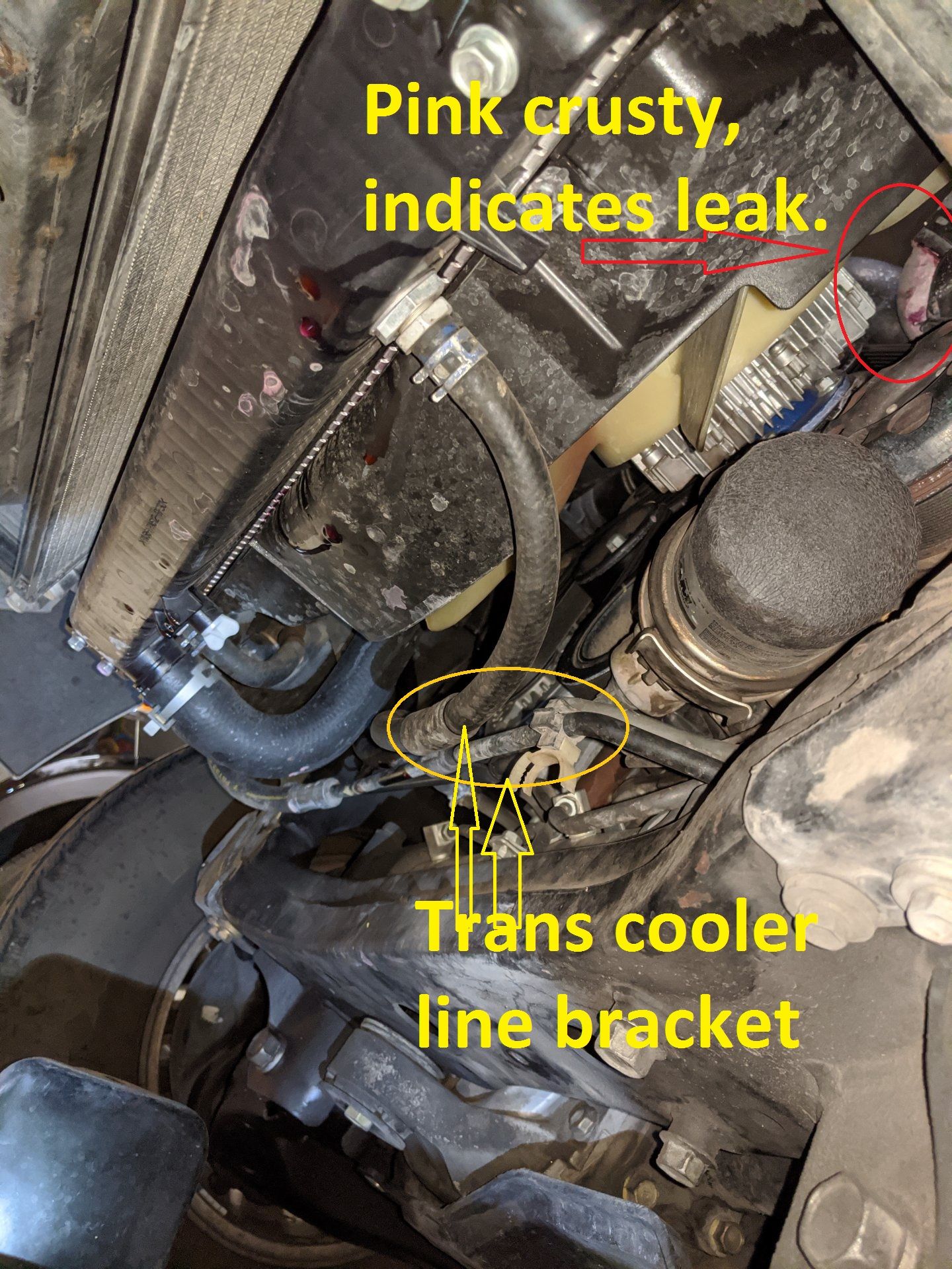

"Pinky crusty" The upper radiator hose shows signs of leak at hose gooseneck of water bypass joint front. I also see impression of OEM hose clamp, but no clamp.
You can see the bracket for the transmission cooler line is broken. It's important to have secured. The cooler line bouncing around, which will loosen the connection. I tie those up, until I get a new bracket in and on.
I ordered new radiator hoses because the ones there look to be in bad shape...again, replaced recently by the dealer. I noticed all the pink crusties as well, but when I pressure test I don't see any leaks from those hoses, just the base of the radiator. If the hoses were leaking would I expect to see leaks from them during a pressure test? I think it might be from an older leak.

Looks exactly like the crimp is leaking. I'd talk to the Lexus dealer, this part is only a year old, no way it should fail that quick. You are only *barely* out of warranty on that part, I'd bet they'll do something. Maybe just ask for the part to be replaced and you can install it yourself?
