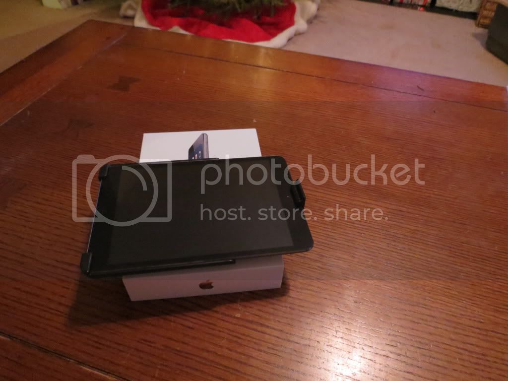

I had some spare airline miles laying around and and used them to buy myself and iPad Mini. I have a Kindle and love it too much for reading to get rid of it. The main purpose for the iPad will be navigation.

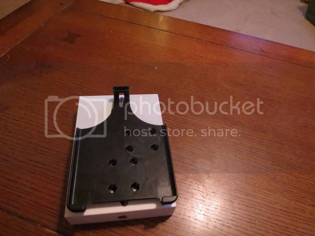

My wonderful wife has already bought me the Ram mount for it. This is the Ez-roll'r and it fits the iPad great.
I still have a few things to piece together before installing it. I will use the ProClip vehicle specific mount and a few more Ram pieces to make it adjustable for access by the driver or passenger.

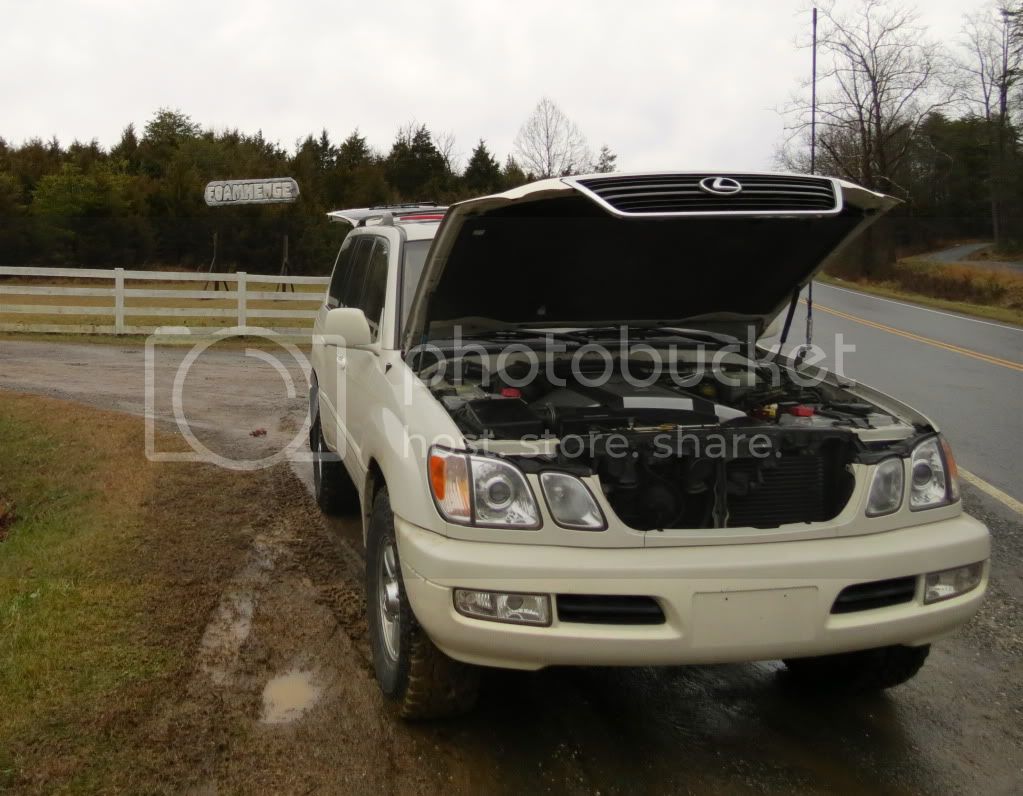

So I still don't have any fun updates.. I have had the timing belt service done. I am having the second new fan clutch installed tomorrow and will probably find out that I need to replace the fan mount pulley/bracket at the same time.
We tried to make a trip with some friends to George Washington National Forest last Saturday and made it all the way to the trails before the engine temps began to climb and I found out that the new fan clutch that was installed the day before had already failed:mad:
So we limped back on the highway and tried to make the best of things by stopping in strategic places to let the engine cool. I planned to check out some things in the Natural Bridge area and was going to stop off on the eastern industrial area in Roanoke to get some pictures. Traffic was too bad in Roanoke and we would have overheated too quickly so we ending up skipping that for another time.

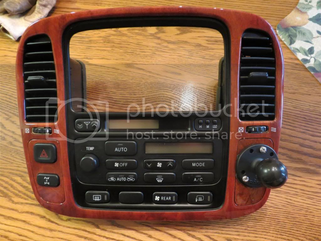

I got around to mounting my iPad today. I was pretty nervous about drilling holes in the dash trim and have been putting it off. I stole a few tricks from my buddy Marten in his GX470. The whole thing turned out great and is really stable. I will be adding a phone mount to it as well once the parts come in.
I started by removing the trim panel surround for the stereo and climate controls. I made a paper template of the back of the panel so I could add a steal reenforcement panel to strengthen the plastic and reduce movement.
I used 1.5 inch Ram balls for strength. The 1 inch would have been sufficient.
The reenforcement plate in place.

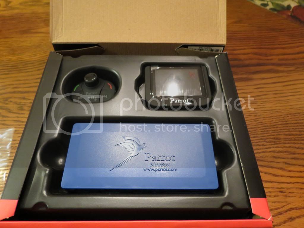

Here are a few pictures of what you get. *beer sold separately
Remote, screen, and brain of the system.

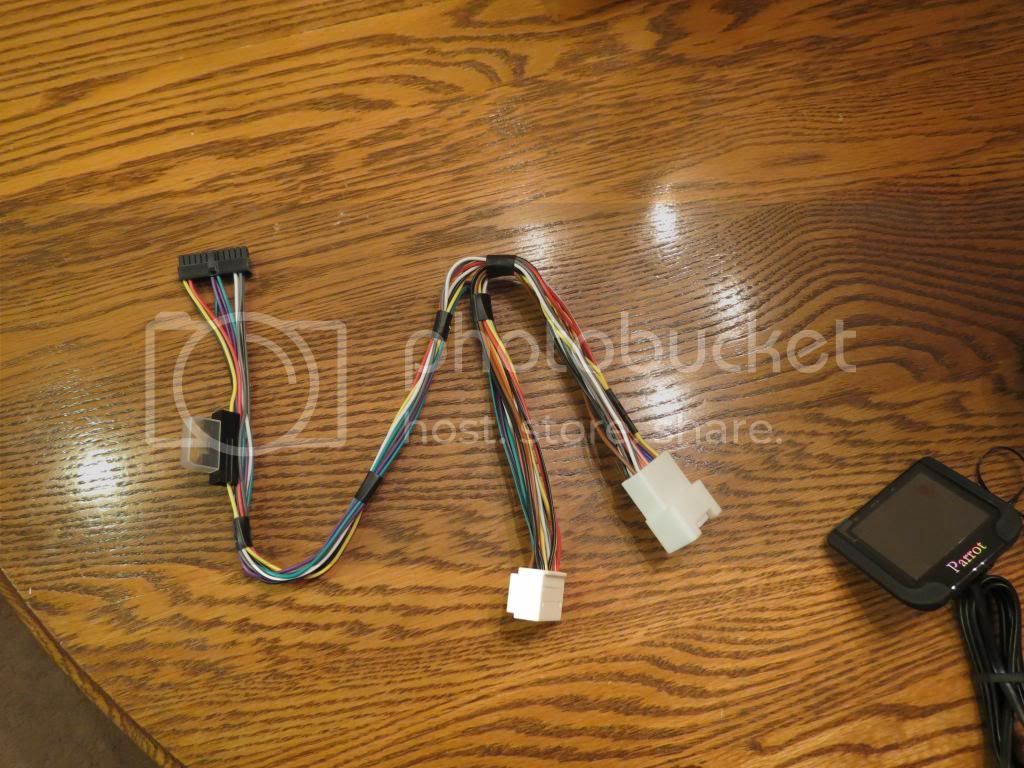

Wires, user manual, dual noise canceling microphone, and additional parts.
The system is ready to install out of the box but I would need to cut and splice a lot of wires from the factory wiring harness in the vehicle. I bought a prewired custom harness with factory connections for my wife's install and it made everything plug and play so I did the same for the LX. Hopefully it will be here tomorrow.

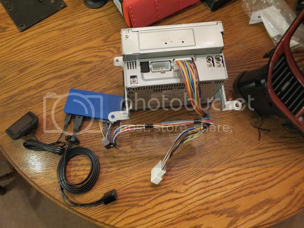

I just completed the install on the Parrot MKI9200 bluetooth integration system. It was extremely simple since I ordered the plug and play harness.
I pulled the radio and disconnected the factory wire harness. Plug the new harness into the radio and connect it to the Parrot blue brain and the other end plugs back into the Lexus.
It is that simple. The most time consuming part is doing a good job of routing the wires for the 30 pin/usb/headphone input, running the microphone cable, and routing the screen wiring.
There is plenty of space behind the climate controls for storing the blue brain and all the extra wiring.
