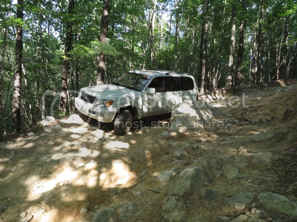

My sister-in-law was graduating from Appalachian State on Sunday, so we decided to head to Boone Friday night and spend all day Saturday exploring. I wanted to drive all of Old NC105, which is mostly unpaved and follows all of Linville Gorge, and a few other unpaved public roads. Sampson road off of the Blue Ridge Parkway was pretty fun, and offered some great views. Richland is another public road in Lenoir that has a section that is unpaved, I came across it on the net and saw some pictures that look like it actually offers some technical four wheel drive sections... we did not make it there but hope to next time.
Another area we missed was the abandoned town of Mortimer. I had read about it from a member on here but need to find out how to get there, I was thinking that Old NC105 ran through it.
Shortly after turning off the Parkway, headed to Sampson Rd we came across what looked to be a salvage yard, but there were some pretty nice restorations in progress as well.
Most of it was just tame fire road.
But there were a few crossings and climbs that offered some excitement.
The best part was the views.
These are from Old NC105.
We saw at least 100 small campsites that I assume are free to use. Some of the roads leading into the campsites got a little muddy and offered an opportunity for some poser shots. I am pleasantly surprised at the flex the LX has in the rear with AHC. We stayed away from the mud. I poked around at some of the holes which got pretty deep, and did not feel like ruining the day by getting stuck.
