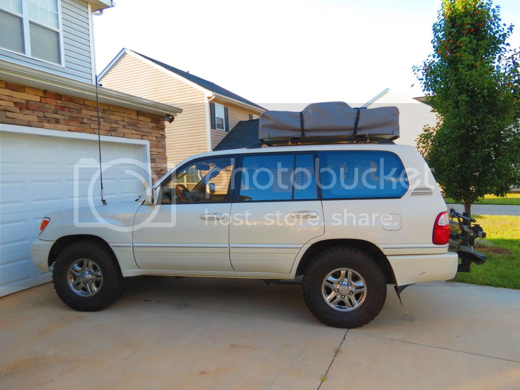

I got my cb antenna mounted. Just need to finish running the coax now. I will try to finish it up Wednesday and get some daytime pictures of the antenna.

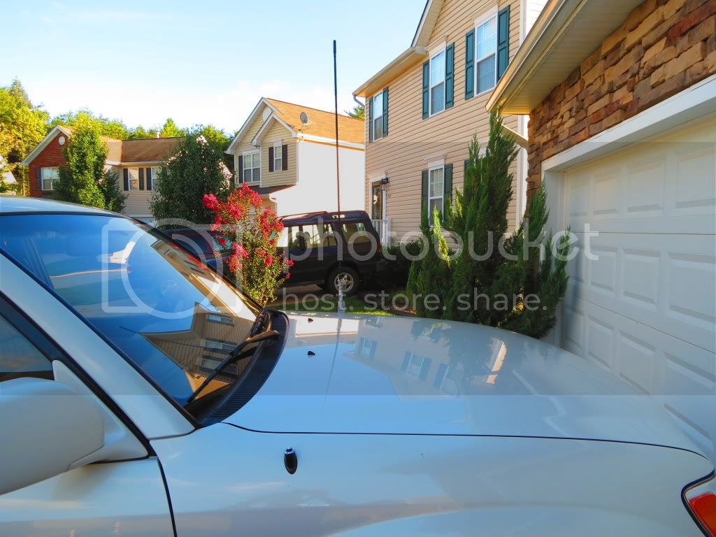

I went with a Firestik adjustable stainless steel hood mount, Firestik heavy duty spring, and Wilson 4 foot silver load fiberglass antenna. I hope this improves the signal of my Midland 75-822. Anyone in my area have a SWR meter and want to help me tune this thing? Will it make much difference? Here are some night shots for now.

Looks good! I have an SWR meter that you can use to tune it.

Here are some better pictures of the antenna in daylight. Still not wired up but it faired well on the commute back and forth from work today.
Nice install!
Interested to see what kind of SWR and real-world Tx/Rx you get with that setup.

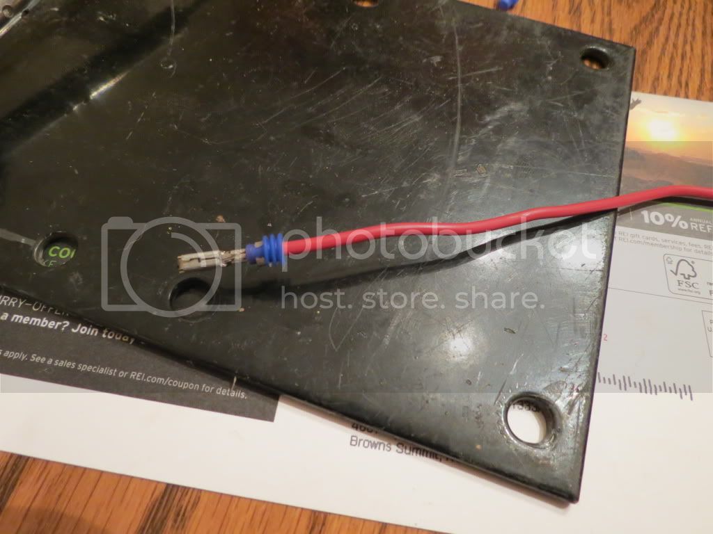

So I ordered my rock lights. The each pod has 4 leds mounted to a metal plate that completely sealed and waterproof. I have 24 pods total. I have wired 4 of them into the factory puddle light harness, (two on each side) that was leftover when I removed the running boards. I will leave these independent of the rest so they only function when unlocking or opening the doors the same as the factory ones did. I will probably use 16 of them as rock lights on a separate circuit controlled by a constant power switch so they can be used as rock lights or camp lights. I am amazed at how bright they are.
I soldered them to the factory harness and sealed all connections with heat shrink. I also added some split loom for more protection.
I am going to look like a spaceship on the trail once the rest are wired in. I will probably wait until I get my sliders on though for placement.

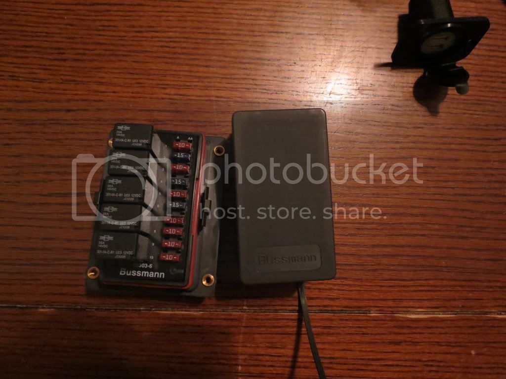

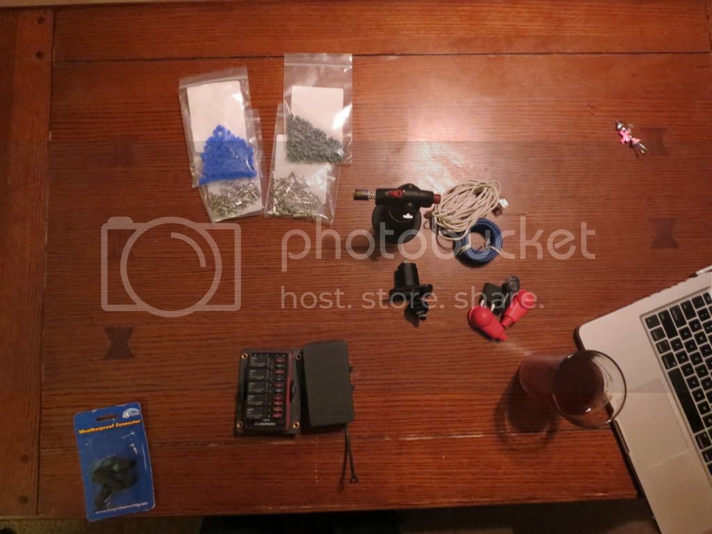

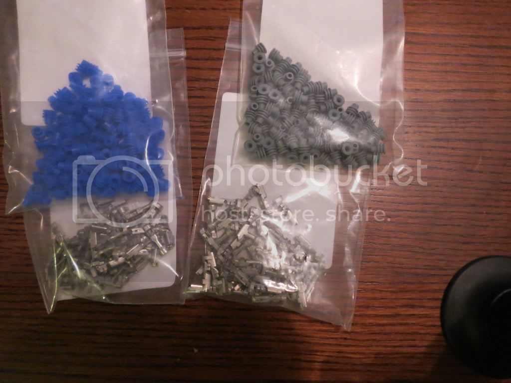

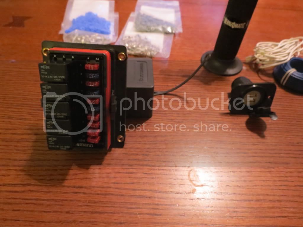

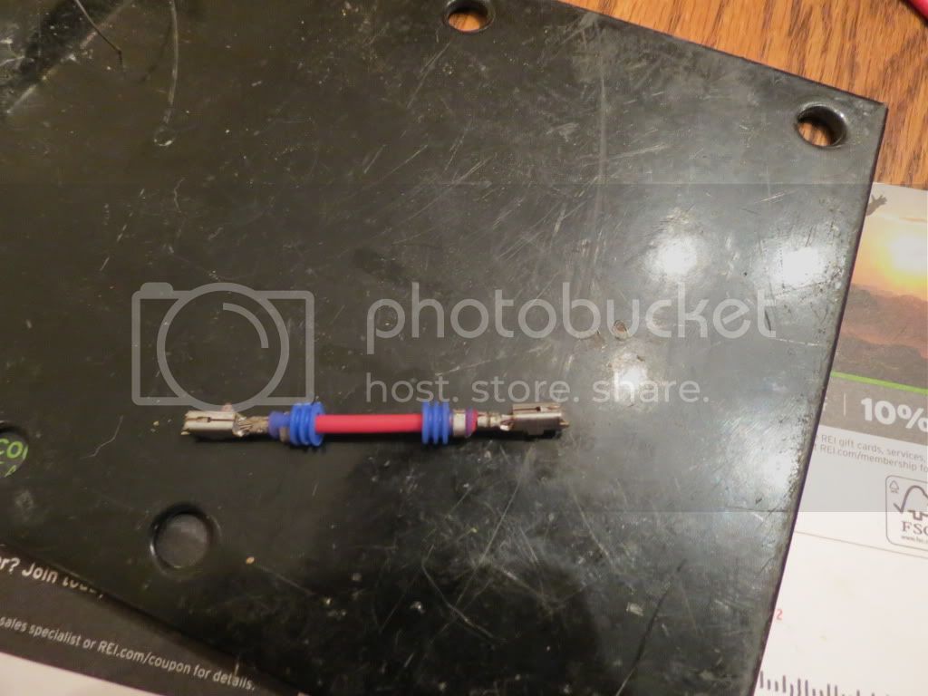

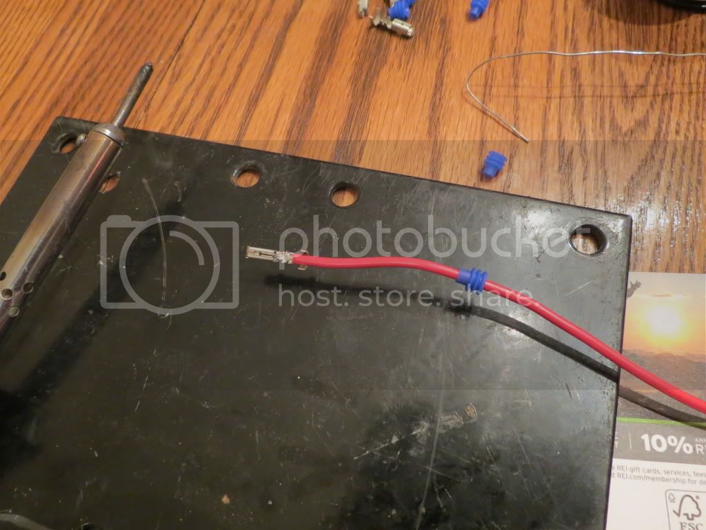

I think I have a lot of wiring ahead of me. I really like things to look as factory as possible, and to be cheap. I had been looking at the sPod for quite a while but couldn't justify the money they cost for my needs. I have yet to order any of my offroad lights yet. Well I stumbled across this and couldn't pass up on the price. It is made by Cooper Bussmann and is completely sealed. It has 5 relays and 10 fuses. I plan to create my own switch harness for 5 different relayed circuits and will still have 4 fuses to spare.
I will post some more pictures once I start wiring it up.

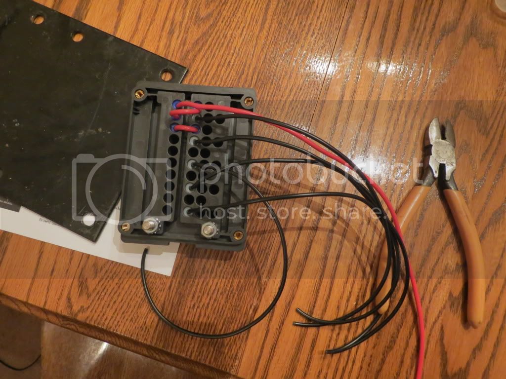

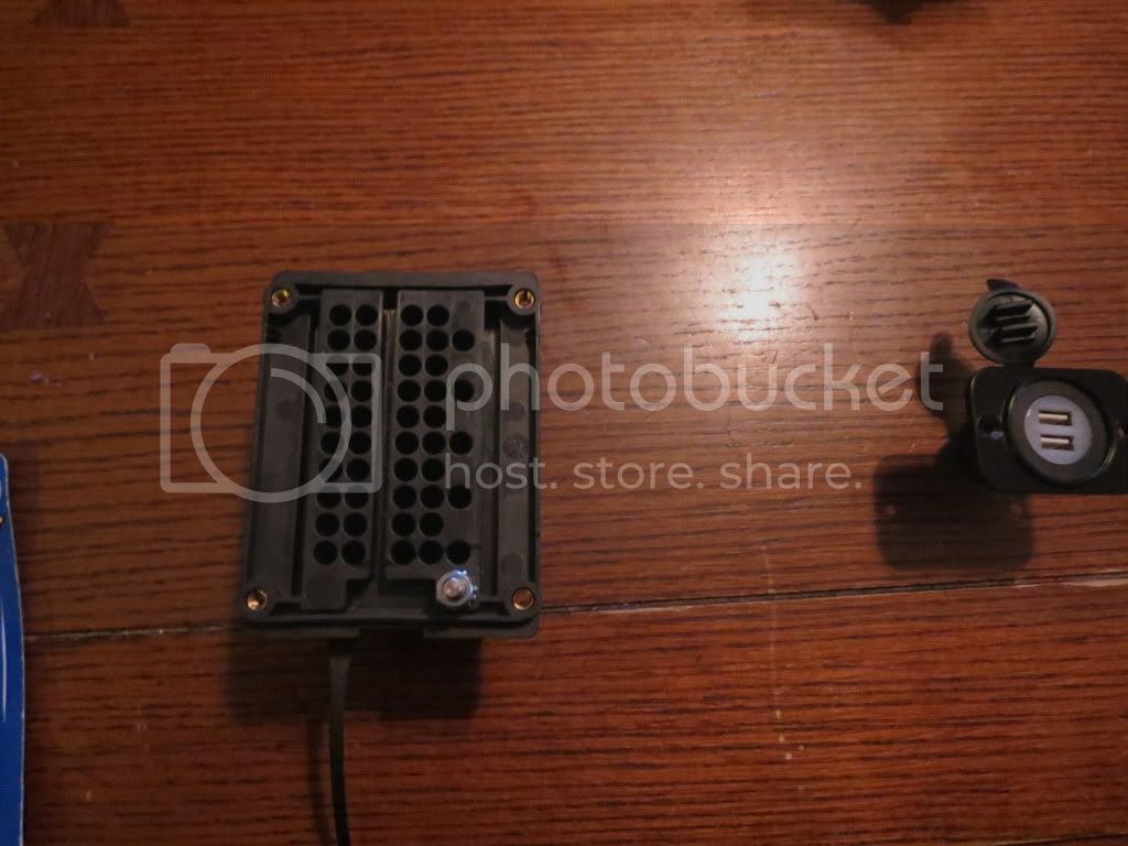

The backside of the fuse/relay box looks like this. It uses waterproof connections and can be custom wired for your needs.

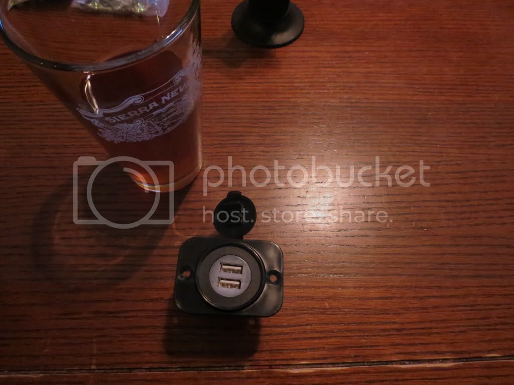

I also bought one of these. I am a little disappointed that the white area does not light up or at least have a power led to indicate when powered but it was a third of the price of a Blue Sea unit and is still built well.

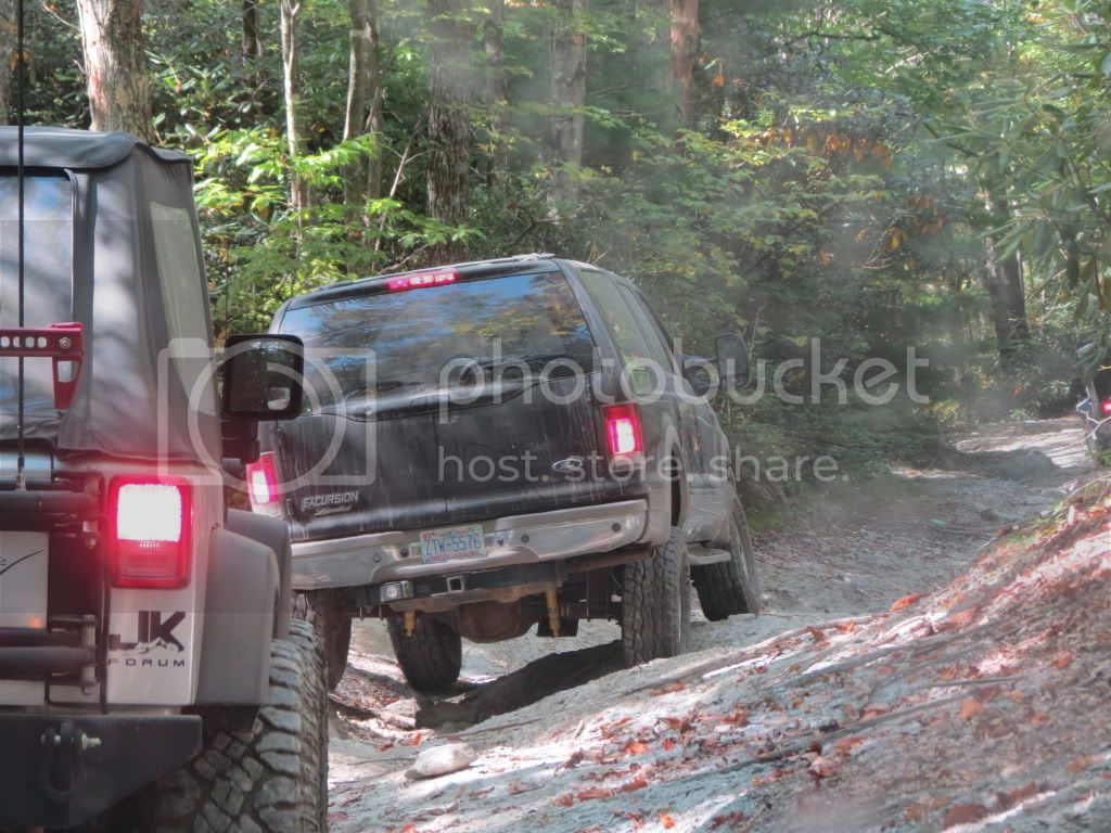

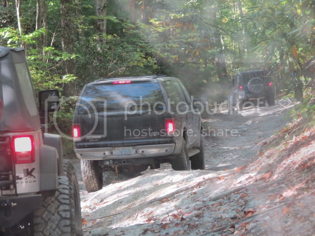

Bushhead came out with his Excursion and showed us all up. He added a 2.5 inch lift since I last rode with him and it made a hell of a difference. He worked that thing through some tight trail with the same ease as the guys in the 2 door Jeeps.

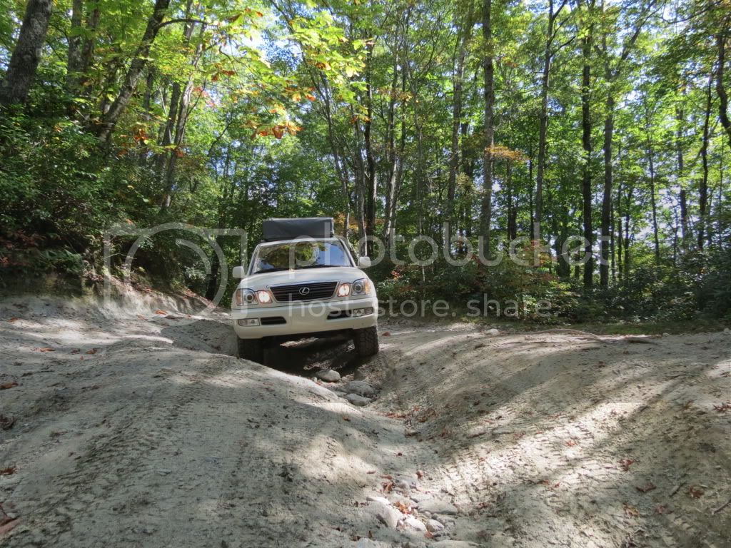

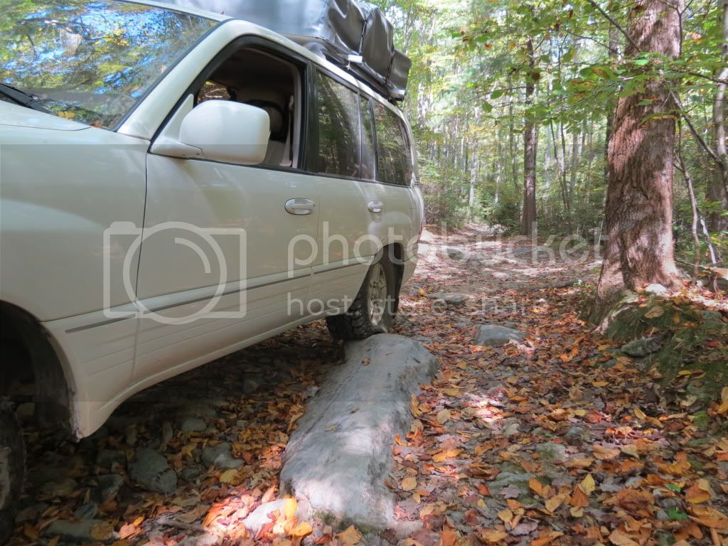

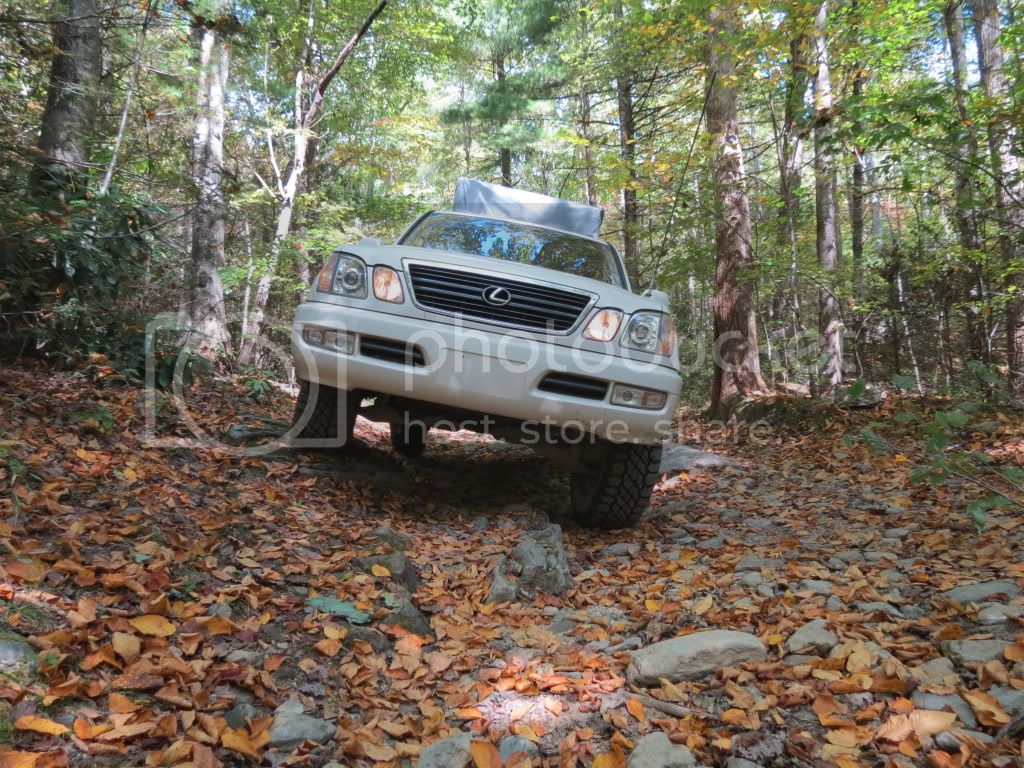

I tried my damndest to lift a tire for a nice picture but could not get the LX to do it.

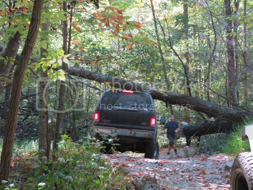

Once again we came to this infamous tree that I cannot make it under. We will bring a chainsaw and make firewood of this thing on one of these trips.

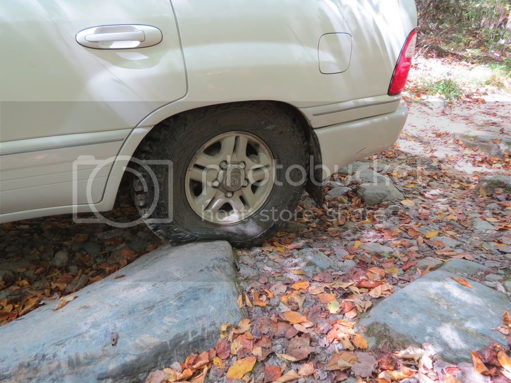

I have had a lot of people ask about the flex of these tires. Well this is at 18psi. When I saw this I thought I might have a flat or my digital tire pressure gauge might be wrong.

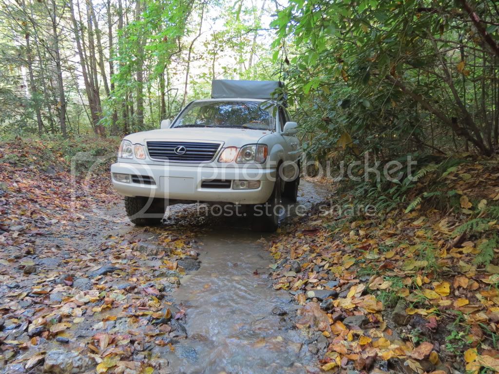

We made quite a good pace fore having such a large group of vehicles.

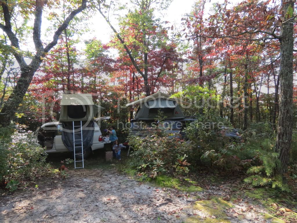

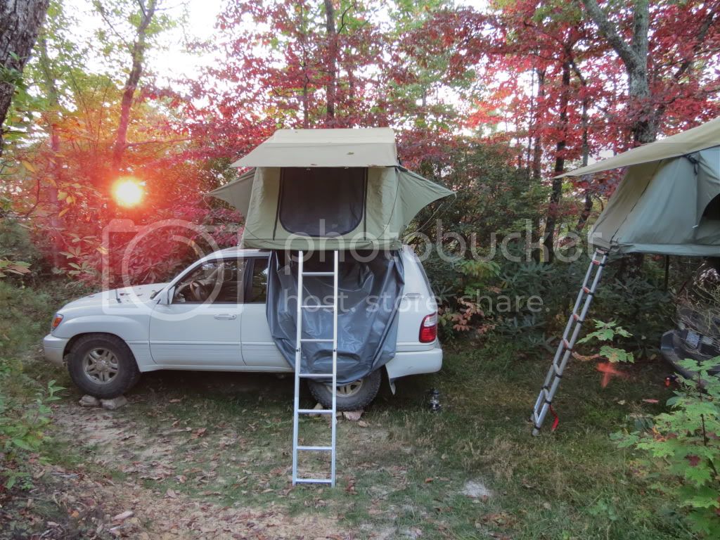

We had an awesome campsite.

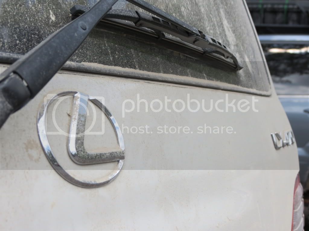

The Lexus had a good coating of dust at this point.
