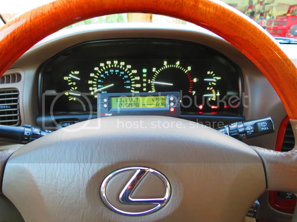

I have been pretty disappointed that the LX only came with the basic trip A and trip B trip computer. I finally broke down and bought a Scangauge II. This thing is pretty handy but a little spendy for what you get. I just have it mounted with some hook and loop for now and will probably get a blendmount to go on the rearview mirror eventually.
What 4 parameters is everyone monitoring on theirs? I have mine set to show corrected MPH since my gauge is off with the bigger tires, MPG, and average MPG. I have it showing voltage too since I am undecided on what else to watch and just installed it today.
I've manually programmed in my transmission temp with comes in useful going up grades. Search and you will find instructions on how to do this.

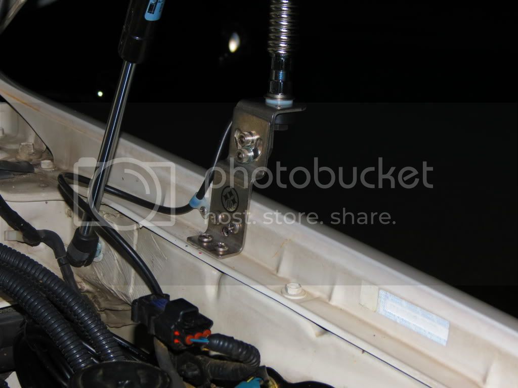

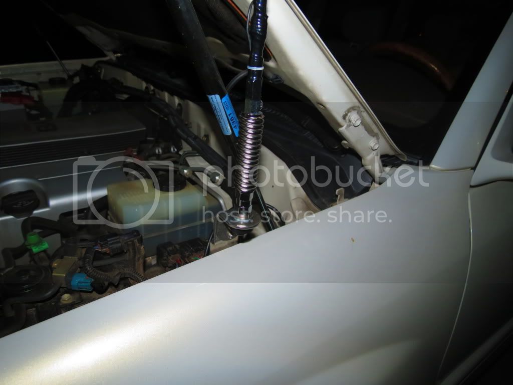

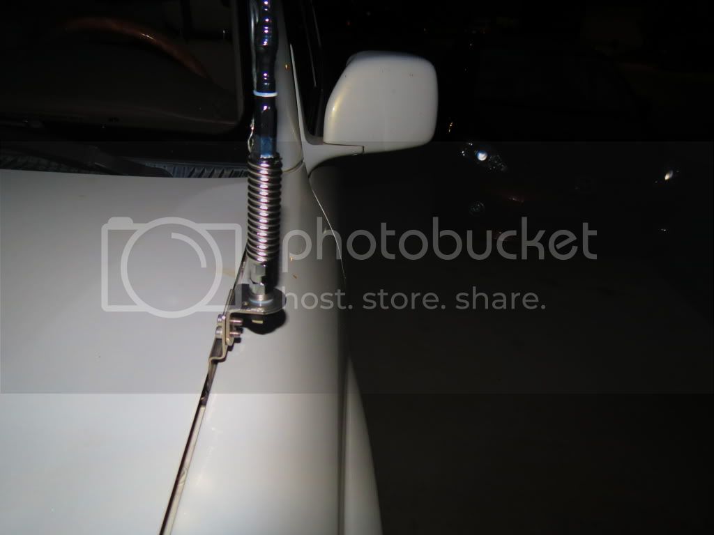

I got my cb antenna mounted. Just need to finish running the coax now. I will try to finish it up Wednesday and get some daytime pictures of the antenna.
I went with a Firestik adjustable stainless steel hood mount, Firestik heavy duty spring, and Wilson 4 foot silver load fiberglass antenna. I hope this improves the signal of my Midland 75-822. Anyone in my area have a SWR meter and want to help me tune this thing? Will it make much difference? Here are some night shots for now.
