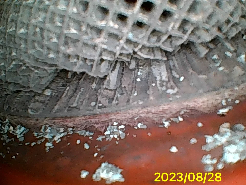

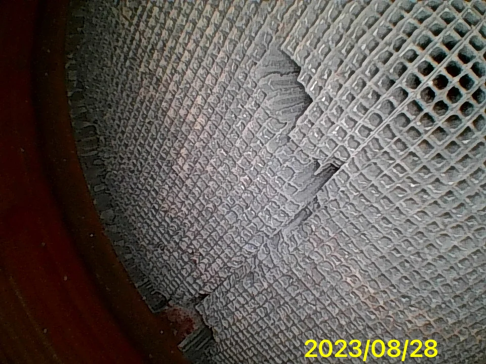

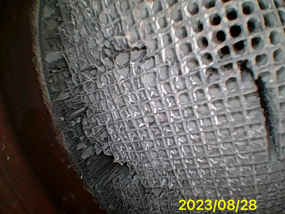

Borescope is very handy to inspect CAT through A/F or O2 sensor port.
Burnt-out CAT, from bad MAF sensor.
