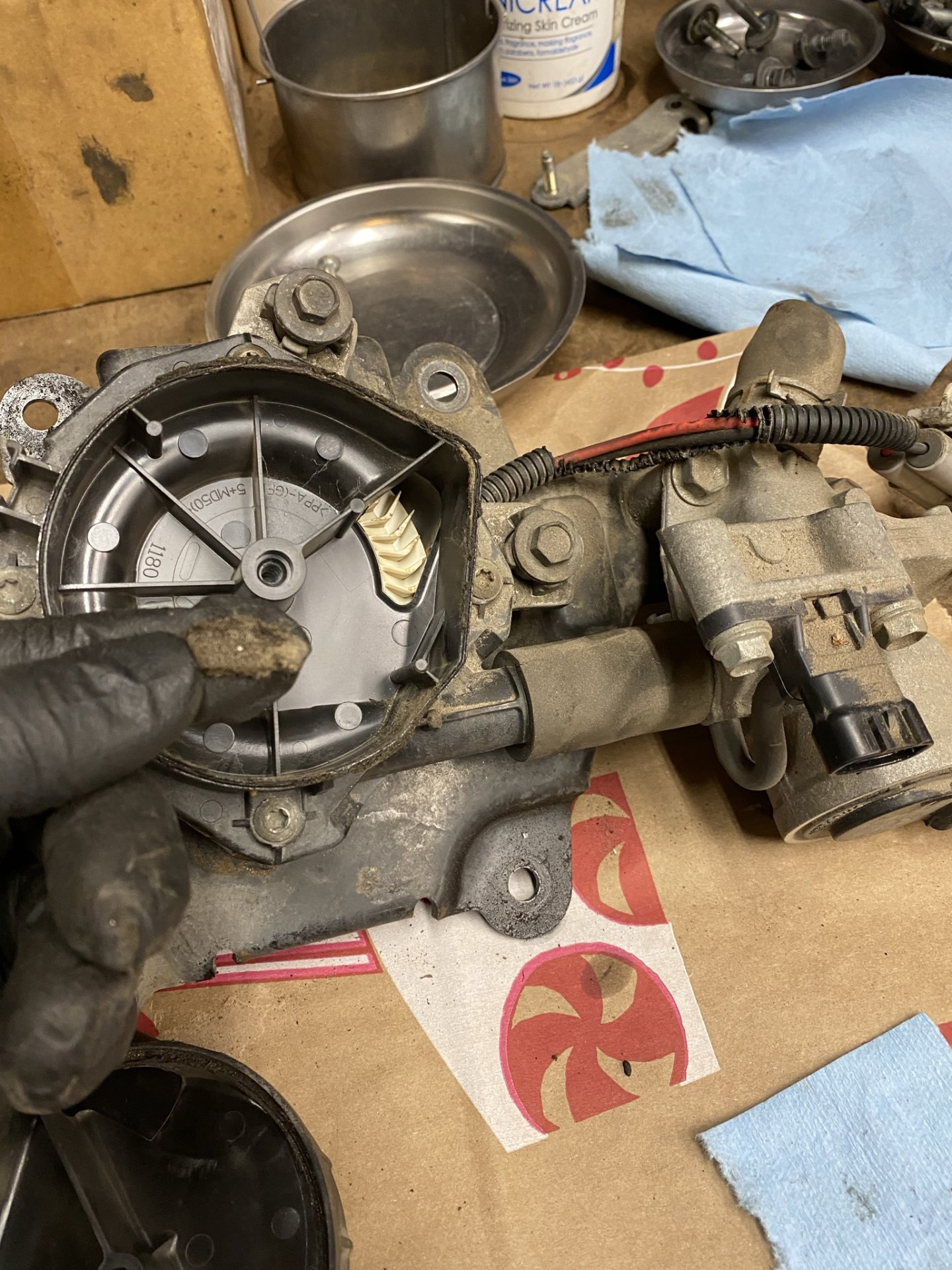

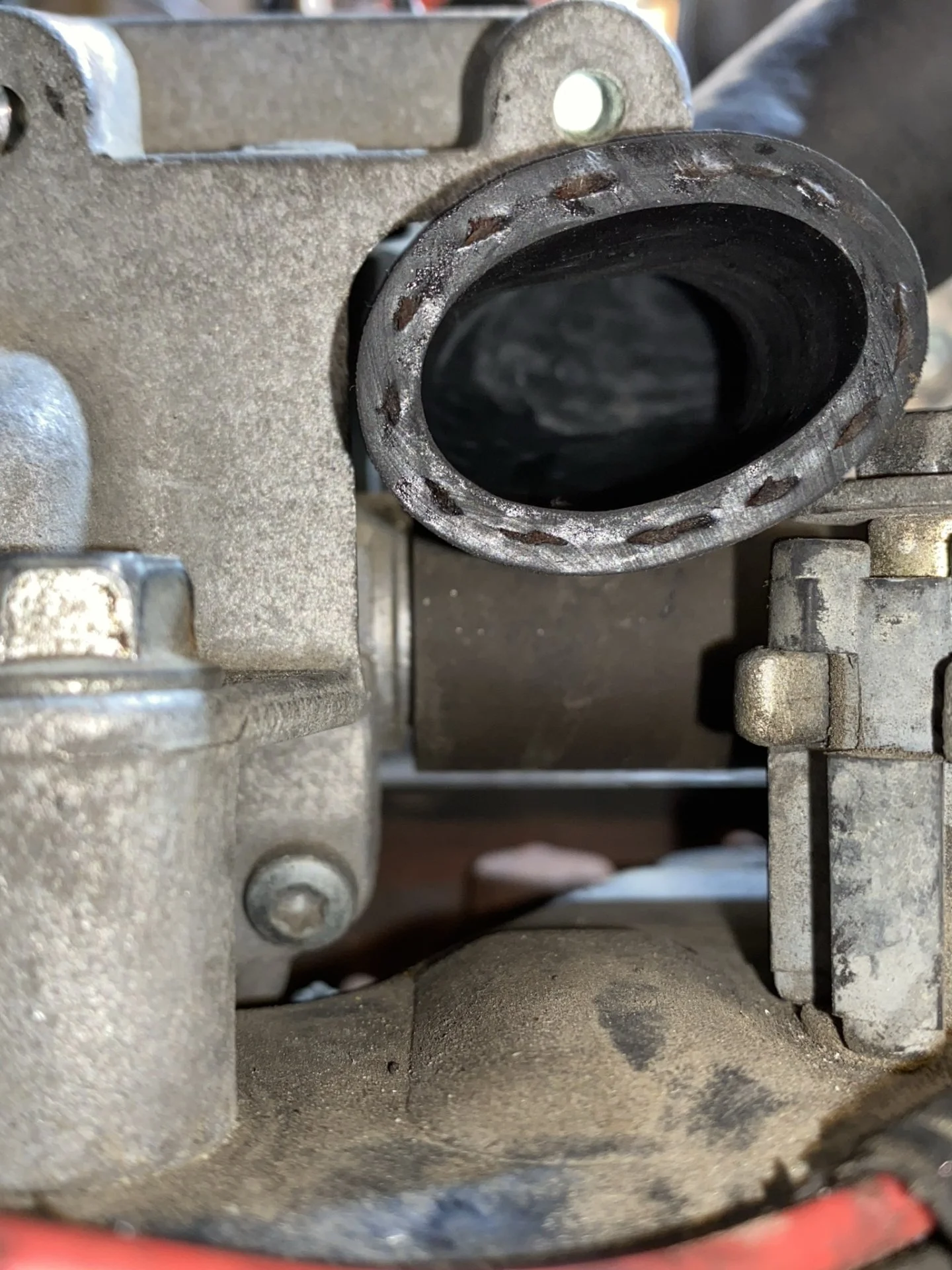

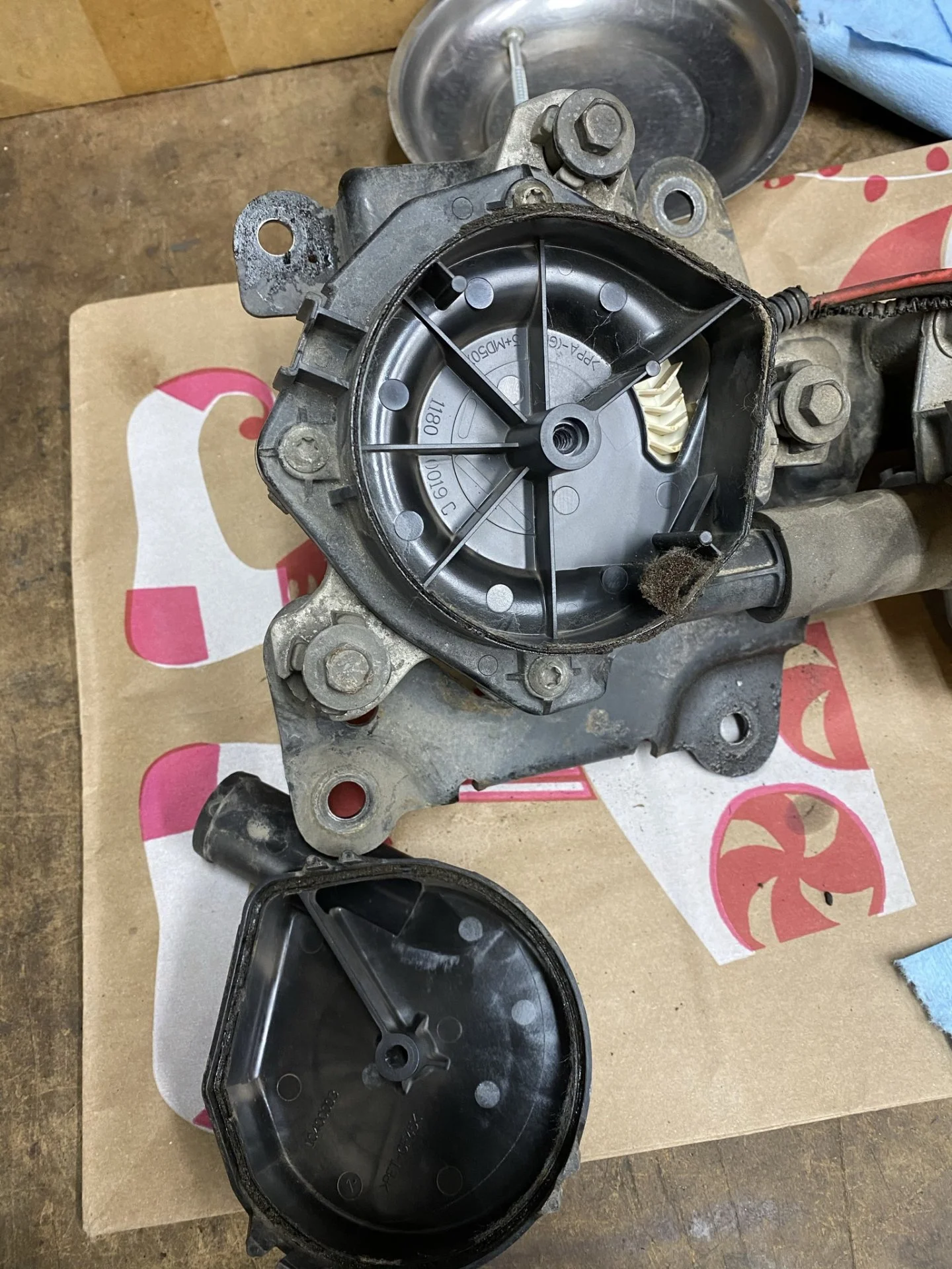

The part in the S.A.I. am I talking about.. Is a small foam filter, just inside the secondary air injection blower fan (S.A.I. pump)
Here is a factory SAI filter in good condition, exposed. It resides, under the top of Secondary Air Injection Pump - Toyota (17610-0C010) (Blower) without bracket, list for ~$600 today.

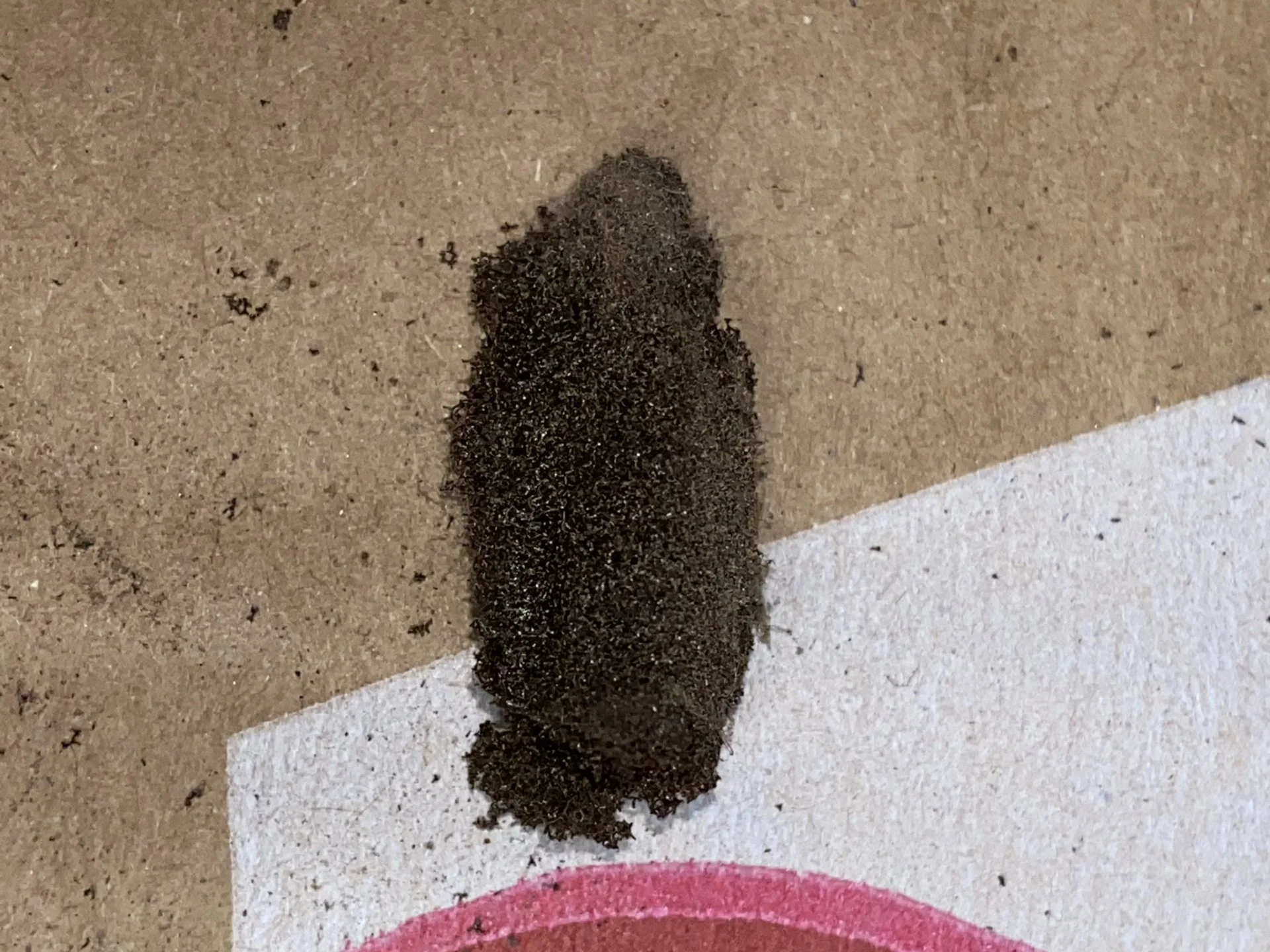

This bit of foam filter material measures, is from a failed SAI filter. It's about 15mm x 5mm. Which is only remnants of a SAI pump filter found remaining in my test engine.

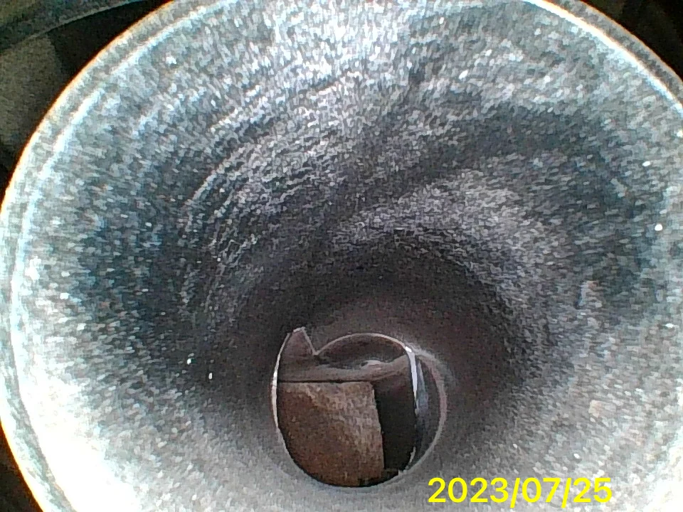

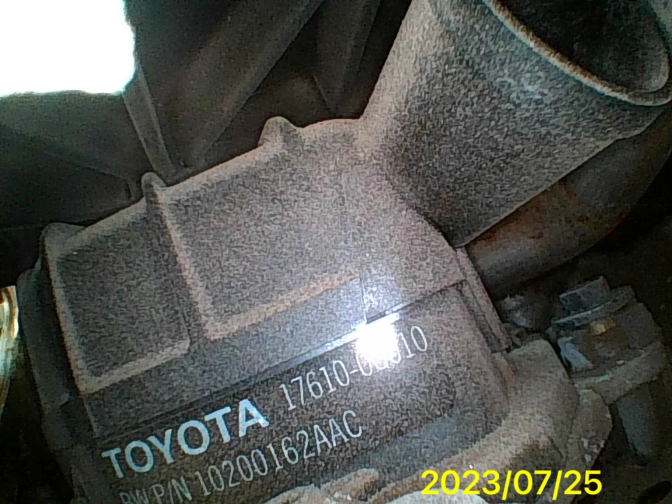

Below are pictures, using a borescope to inspect under intake manifold. I'm looking into S.A.I. pumps intake port. Which in this one, we can see:
The filter is intact, which we want to see. So if getting CAT or S.A.I. codes (DTC), look elsewhere (other than filter) for cause.

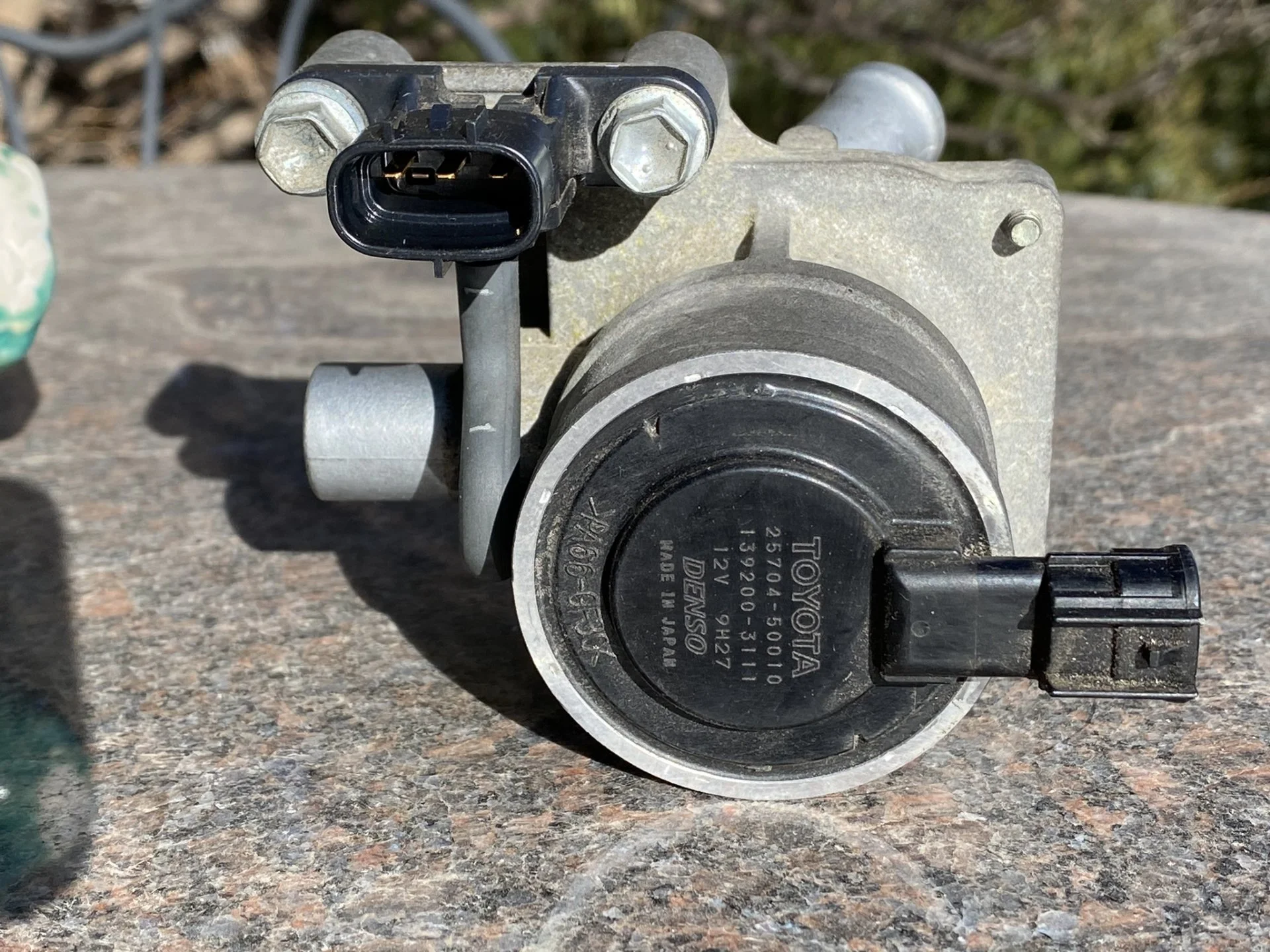

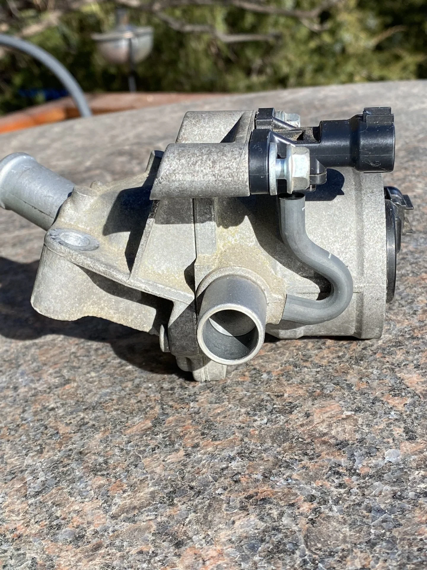

How was I "sure enough" it was the pressure switch:
Basically I tested SW by the book (FSM) and some ways not in the book. Along with all the A.I. components. Replace some with known working parts. Nothing tested bad, nor kept the code from coming back up as pending or active (confirmed). System just kept throwing codes. I'd either get P1445 (BK2 sw stuck closed), which seem to come up the most. Or P1442 (BK1 sw stuck closed). Or both, if I went long enough without clearing codes.
The P1445 came up first (found studying history of vehicle) and was before my ownership. That switch which sits on back of water bypass joint rear, on the right side (BK2). PO had Midas replace, which they used a NAPA aftermarket SW. My first attempt after testing (tested OKAY), was to install used known working OEM SW BK2. Made no difference. I also swapped out the VSV switch connect to it and vacuum line used to attach them, with used known working OEM sw and new vacuum line. I preformed all test, before and after. All test OKAY! But codes kept coming back.
The only difference I could see by simply looking into the main switch and my used switch. Was color variation. My old switch had grayish dirty appearance inside, the used (on my shelf) looked silver and clean inside. Used replacement main switch did the trick. No DTC in over 40 cold starts at time of writing this, since install. Which was ~10 months after I removed internal AI pump filter (remnants of) and replaced with my external replaceable filter with mod.
Likely it's just microscopic debris in pressure switch or it's feed tube. FSM has us test pressure Switch at ECU. Which tested okay. Had I, just replaced the pressure sensor only. Than I'd know for sure, it was sensor. But if wrong, I'd than have to pull intake manifold again. So I just toss in the whole main switch (used OEM know working), which had pressure senor on it.
Main switch (old factory installed from test VVT engine). Pressure sw attached to top with 2 bolts and vacuum hose connected it to switch body.
Inside switch has a grayish tint, most notable on round shaft inside (rod). Other used switches I have, where filter was still intact. Rod is shinny silver and inside has a cleaner appearance.

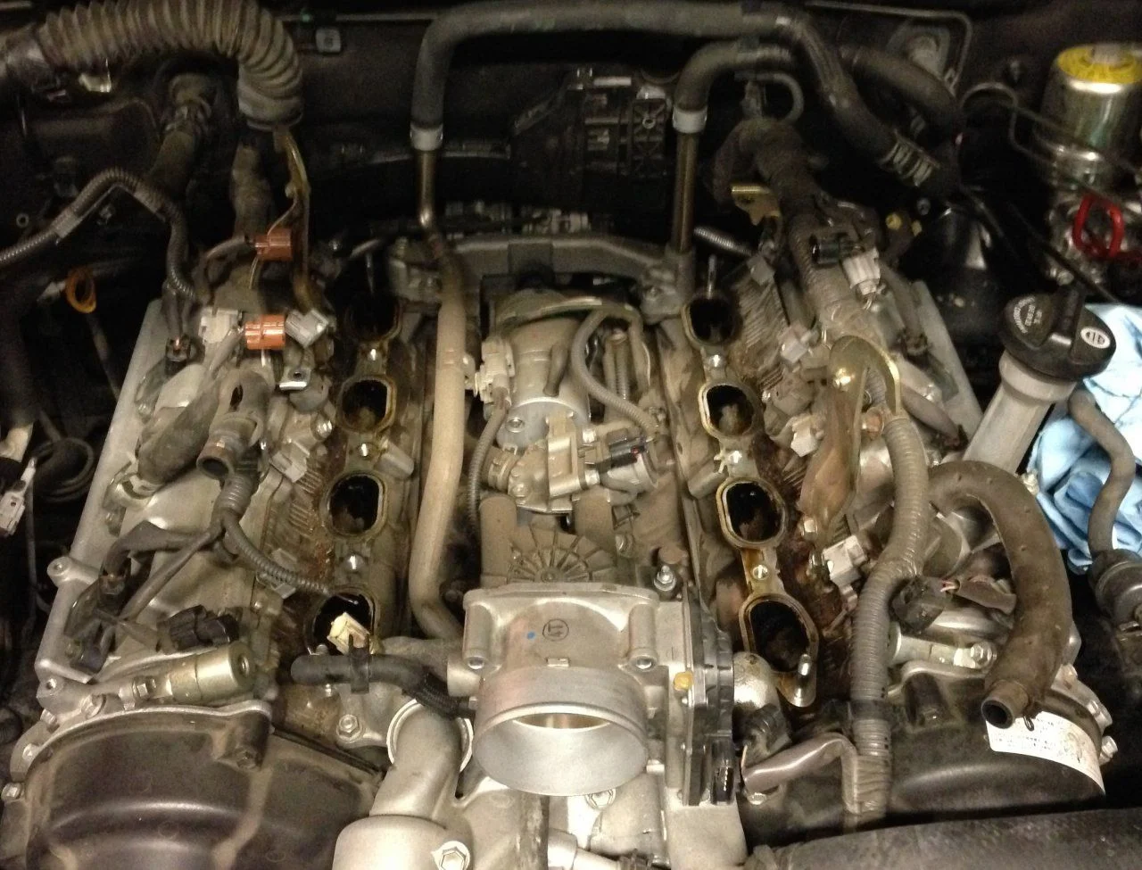

  1. The very most important part of this job is cleaning top of engine first thing. The area between heads and intake manifold (IM) hold sand, dust and grim. We do not want even 1 grain of sand, getting into intake ports, on valve seats or dropping into cylinders. That is a compression killer and can lead to engine that looses power, smokes and damages CATs. My final step before installing intake manifold. Is the get up on the engine with a flash light and shop vacuum. With small hose on vacuum. I vacuum every single particle out form the intake ports.
  2. Disconnect battery negative cable clamp
  3. Remove throttle (TB) bod bolts & nut. We'll just be leaving TB sit in place. As no need to remove and makes IM lighter and easier to handle
  4. Remove IM
  5. Remove screw form top center of S.A.I. air pump (blower) cap.
  6. Heat cap around where in butts to air pump housing base. The heat (heat gun, hair dryer) softens the adhesive seal.
  7. Left cap up while warm, off base of air pump. I pull one one side by, lifting up by holding, 1" air inlet nipple. As one side comes up I gently pull at all side and remove cap. Keeping seal, in/attached/glues whatever sides it stick to. Often some in cap and same remains on base. Keep seal clean. We'll be reusing without removing.
  8. Remove any filter remaining in air pump and vacuum area clean of all dust and debris. Any dust remaining, can result in issues later, with air pressure sensor. Even valves of switches.
  9. Inspect impeller blades. If damaged consider replacing.

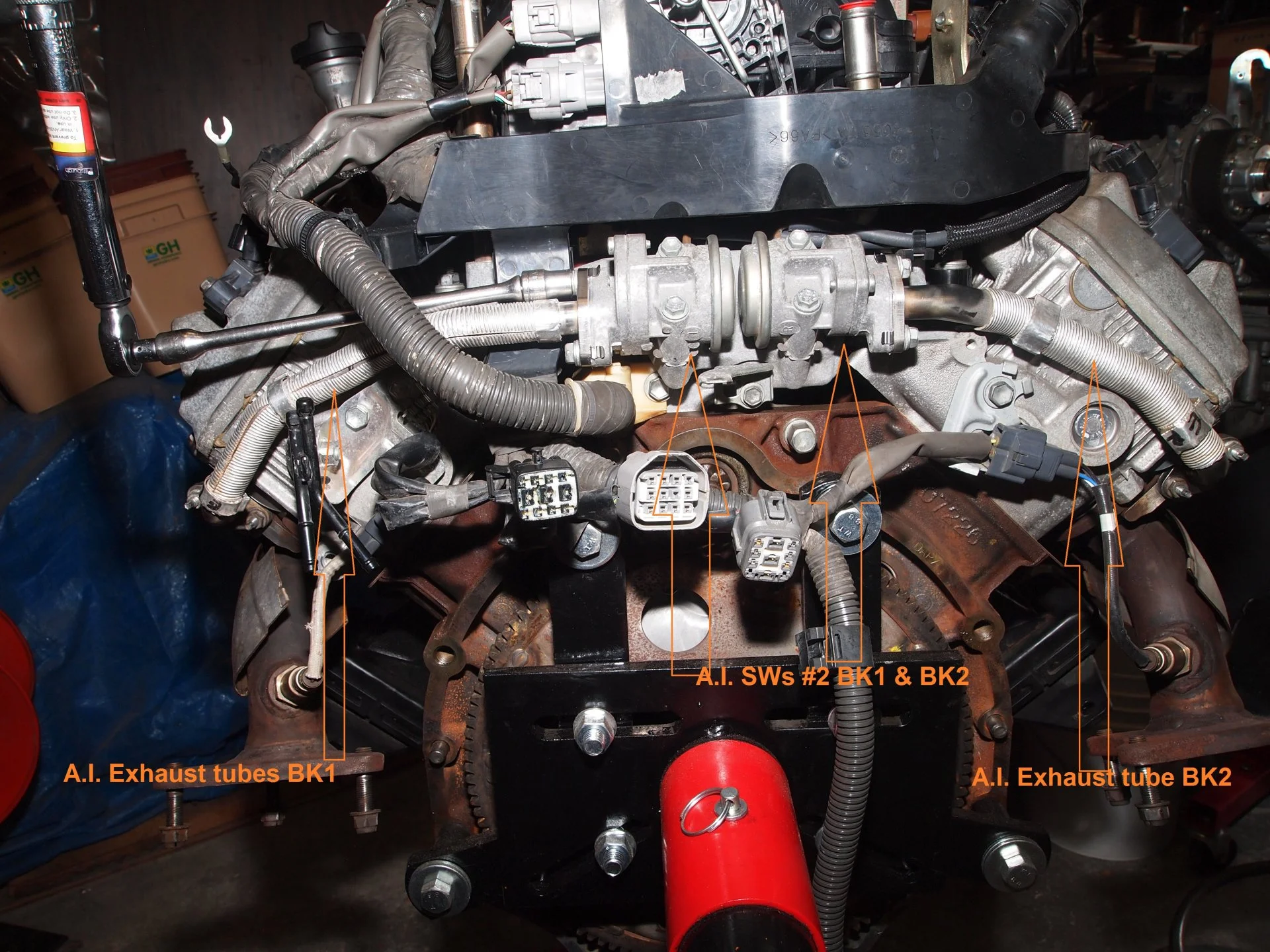

  10. Inspect motor, main switch operation. See attached PDF
  11. Inspect BK1 & BK2 switches. Make sure both have vacuum lines attached firmly. These SW can be accessed with IM in place

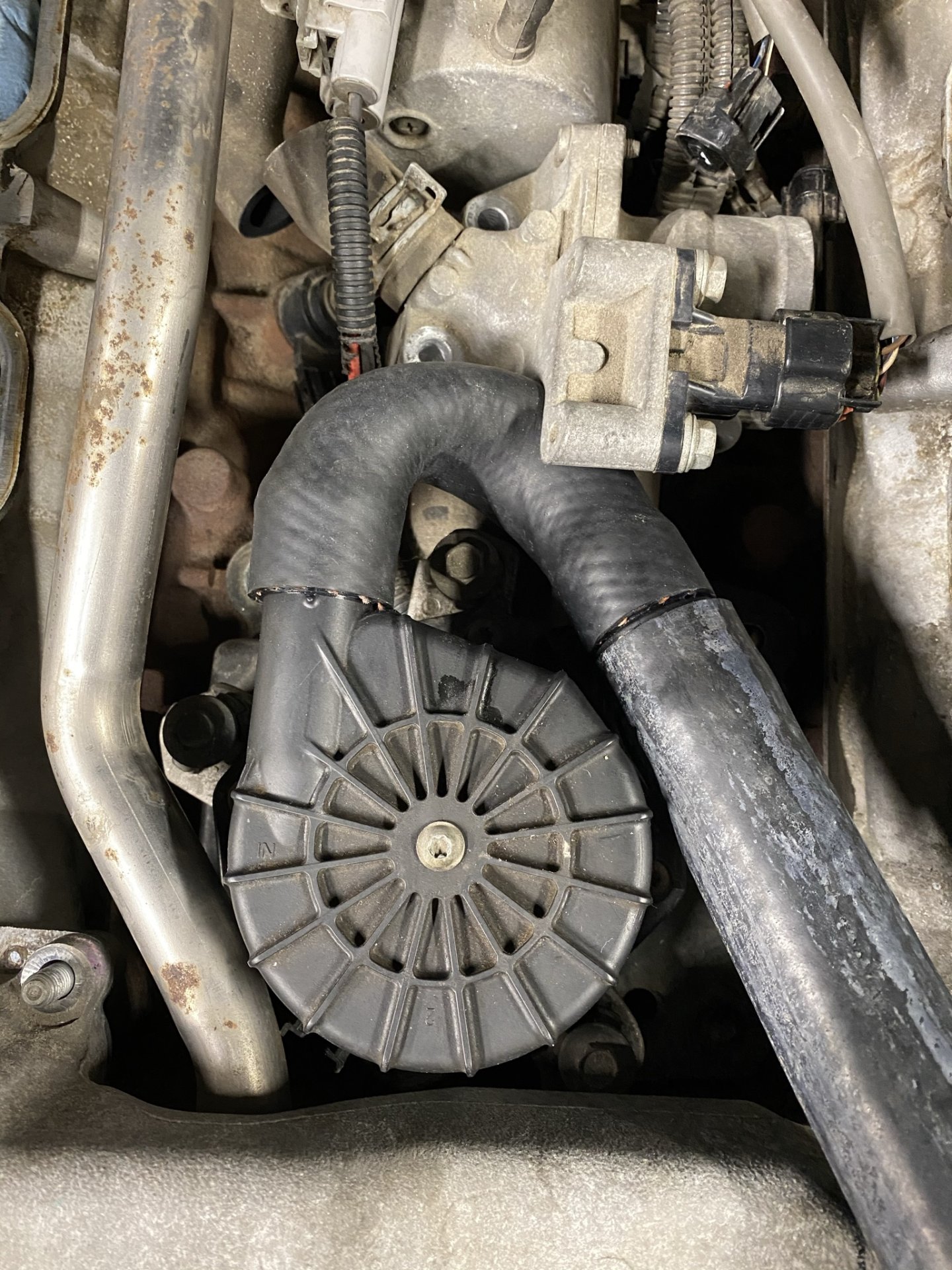

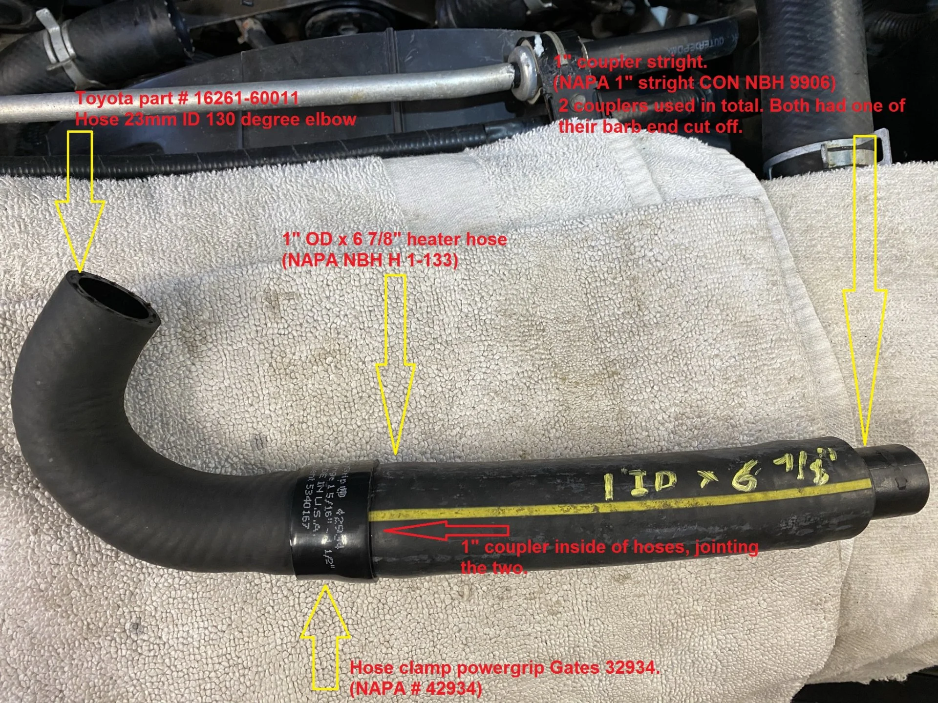

  13. Build the hose, with rubber hose elbow, couplings, 1" x 6"7/8" hose, heat shrink clamp and filter.
  14. Attach our now built hose assemble. To air pumps caps 1 " air inlet nipple. It's tight so I lube with either dish soapy water or Toyota rubber grease.
  15. Make sure where elbow hose, passes between narrow area of main switch. Its not pinched close. It just a matter of turning hose to get relaxed fit.

This was to be my first prototype, as a model. But this works so very well, and all components easy to obtain locally. So I'm just sticking with this assemble for now :hmm: .
The power grip is a heat shrink clamp. Inside the hoses is a 1" barbed coupler. The coupler(s) come with barbed ends and a smooth shaft/pipe jointing the barbed ends. I cut these down, so that one end barded and other end smooth. By simply cutting off one end. The barb end is inside the 1" heater hose. The smooth end of one, is in Toyota elbow hose. Then the heat shrink clamp seal and clamps the hose onto coupler in the two hoses. The other bard coupler has smooth end protruding out end of hose, for attaching filter onto. The heat shrink clamp is a safety, making sure hose will not pulled off elbow.
I cut along red line, and dispose of red X's side. Bevel and smooth my cut, for easy clean fit on hose.
The screw clamp holding 1' hose onto the A.I. pump, is not really needed. That hose is very very tight on the A.I. pump without it. But as a safety, I used it.
Here you see before either clamp installed. The hose is a supper tight fit onto A.I. pumps top 1" OD inlet port. So it is very important to place elbow on pump at correct angle (orientation), as it's near impossible to rotate once on.
Note the slight pinch (smash-down) narrowing bend in the elbow hose. As its crammed between area in main switch. This elbow hose, is a very tight fit, as is just a tad too large. So I very carefully twist hose to relax so not pinched. It's most relaxed fit. I looked inside for you, to make sure kink would not obstruct air flow, it did not. Works well tight, as it can not bounce around.
I cut the hose to fit at 6 7/8" after I attached assembly to pumps top. So that the air filter would fit sung between throttle body and water bypass joint goose neck. I did not want the hose or filter vibrating or bouncing around. Which could damaged hose assembly, filter, throttle body plastic cover or wires in area. It works very well, sit nice and sung from end to end.

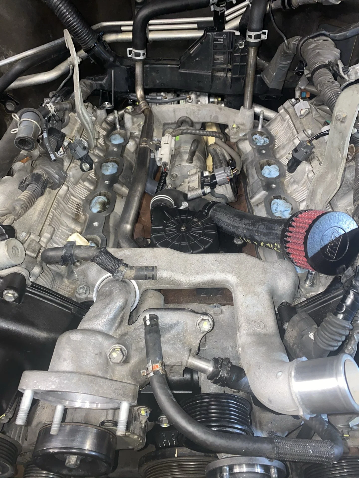

With just one hand, I can grab filter and remove it.
Hose assembly fits very nice between Intake manifold (once installed), head and water bypass joint front.
The filter is a UNI 1" (motorcycle filter). It is easily replaceable. It's is a compressed foam filter, molded to rubber ends. The rubber works very well, reducing vibration, and aided in sung fit. Even if I does get some minor vibration or bounce, it's not going to damage throttle body plastic. Manufacture claim good for 2 to 3 years, depending on use.
I considered using clamp to secure filter to hose assemble, but no need to.

As for removing the intake manifold. For me that's is easy. It a starter job more or less.
I do replace all intake gaskets as I always do any gasket removed. Since I disconnect throttle body and leave it resting in place. I replace its gasket as well

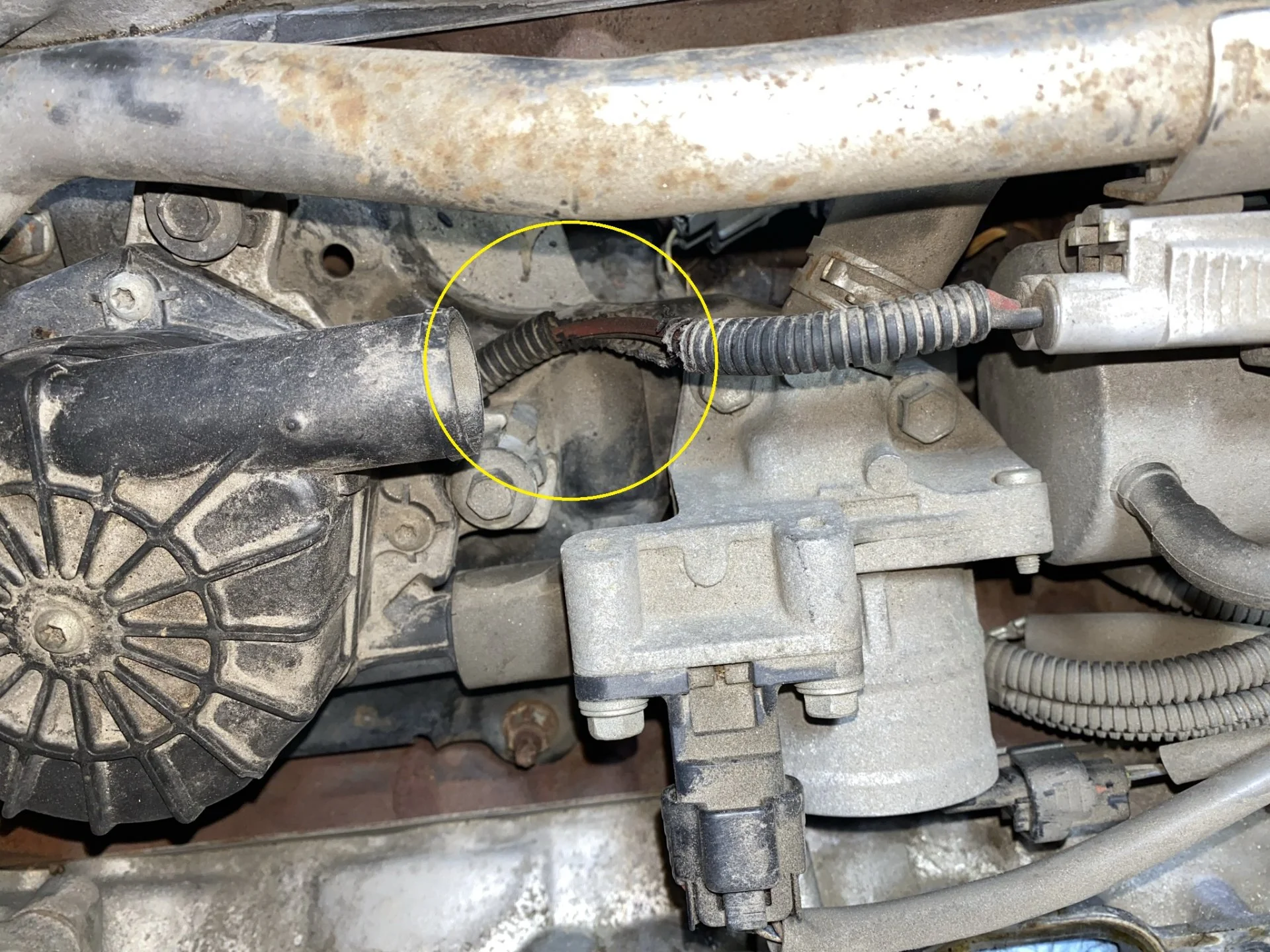

Some wire housing block, the locking clip busted. So I replace those wire housing block.
On all wire housing block, needed. Look for 5 digit number on it. Add prefix 90980-***** in front of numbers you get off wire housing housing. This yields correct part number (P/N) you'll need.
I use small curved needle nose pliers. To carefully breakaway wire housings block plastic, from wires pins within. I take picture beforehand, so I make no mistakes, as I am inserting into wire/pins into new wire housing block.
Here's two often need replacing, if removed. Like when R&R starter with this service.
90980-11149 2 wire housing block main SW.
90980-10845 Pressure sensor 3 wire, wire housing block.
Often, I'll find the clip/bracket to hang wire housing block to water crossover pipe, busted. I remove from wire housing block and insert new clip.
82711-1E320 white bracket clips into water crossover pipe.

1 Toyota P/N 16261-60011 Hose by-pass. Has 23mm ID ~130 degree elbow
1 Toyota 96112-10330 25mm screw Clamp. This elbow hose to pump/blower inlet pipe. A continuous pressure clamp, would be better choice. Like what we see on all water, oil and vacuum hoses in the 100 series. No clamp is actually needed. I just add as safety.
1 1" ID x 6 7/8" heater hose. NAPA 1" OD heater (021) NBH H 1-133 (by the foot and cut down) They're cut from a roll of hose. So have a bend, which I use bent to my advantage in angle hose out from under intake manifold.
2 1" coupler straight. NAPA 1" (25.4mm) Straight CON NBH 9906. These each need one end cut off. Leavening equal length out, from a signal remaining hose stop in center.
1 Hose clamp, heat shrink. NAPA Hose clamp powergrip (Gates 32934) NAPA 42934 1 5/16 Min to 1 1/2" max
1 Air filter 1" 1" UNI UP-107 ( UFI-UP-107 Summit. or Amazon: Universal 25mm w/SM diameter. or Auto Car Universal.
Yellow show rout and points to Toyota 96112-10330 25mm screw clamp, that's just a safety. In list above.
Red circle 90980-10845 Pressure sensor 3 wire, wire housing block. Mention above as need only if removing and lock of wire housing busted. I'll add to: I suspect this pressure sensor gets dust in it's air pressure sample port. This may be the cause of DTC, of stuck close SW BK 1 or SW BK2 or both. Dust gets in if, filter has stop filtering.

Almost a year after installing this S.A.I filter mod, on my test vehicle. I was still getting some S.A.I DTC. I suspected the pressure sensor attached to main SW, had become compromised with dust in the very tiny orifice. I tested the pressure sensor at ECM (CPU) as prescribed by FSM) spec 1v to 2.2volt). It test okay at 1.19Volt!
[ Edit May 2023:. No S.A.I DTC after replacing main SW with it's air pressure sensor. No CAT DTC since adding replaceable SAI filter mod. With the exception of 1 CAT DTC pending (Ran scanner, every-time I drove for nearly 2 years to pick up pending DTCs). Which was due to about 100 short drives in 3 moths (less than one mile), on cold engine start up. Without ever getting up to full operating temp or driving at HWY speeds (RPM). ]
So I pulled the intake manifold again. With intent of replacing the pressure senor. Once I got in there I decided to go ahead and replace main SW, sensor attaches to. Upon inspection of main switch, I note graying inside on it's main valve. IMHO, was a confirmation of dust blow through the system, due to it's failed filler. I elected to just go ahead and replace main SW with a good used I had on hand. Why? Didn't want to pull intake manifold again in near term. I felt I could have gotten away with just the pressure senor swap.
Gray on shaft of main SW indicates contaminates getting into system

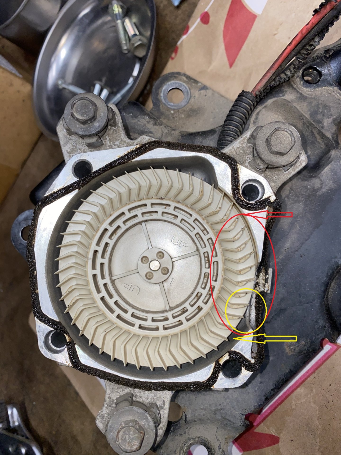

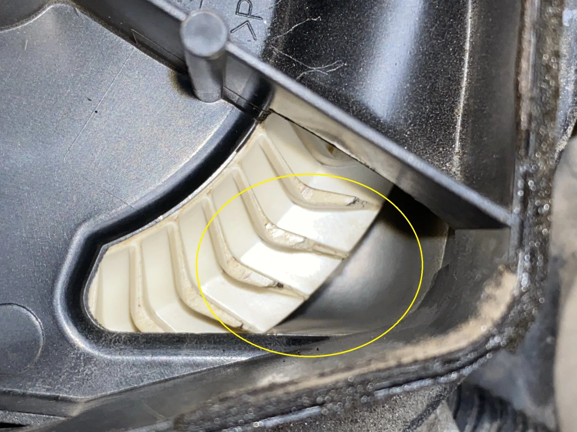

I do think filters foam, is just the start of CAT damage (clogging). The fan blades plastic, in this test case, added to clogging I suspect. But only the start of clogging CATs!
DUST blowing in over time, IMHO becomes the final nail in the coffin. The straw that broke the camel's back, as the saying goes.

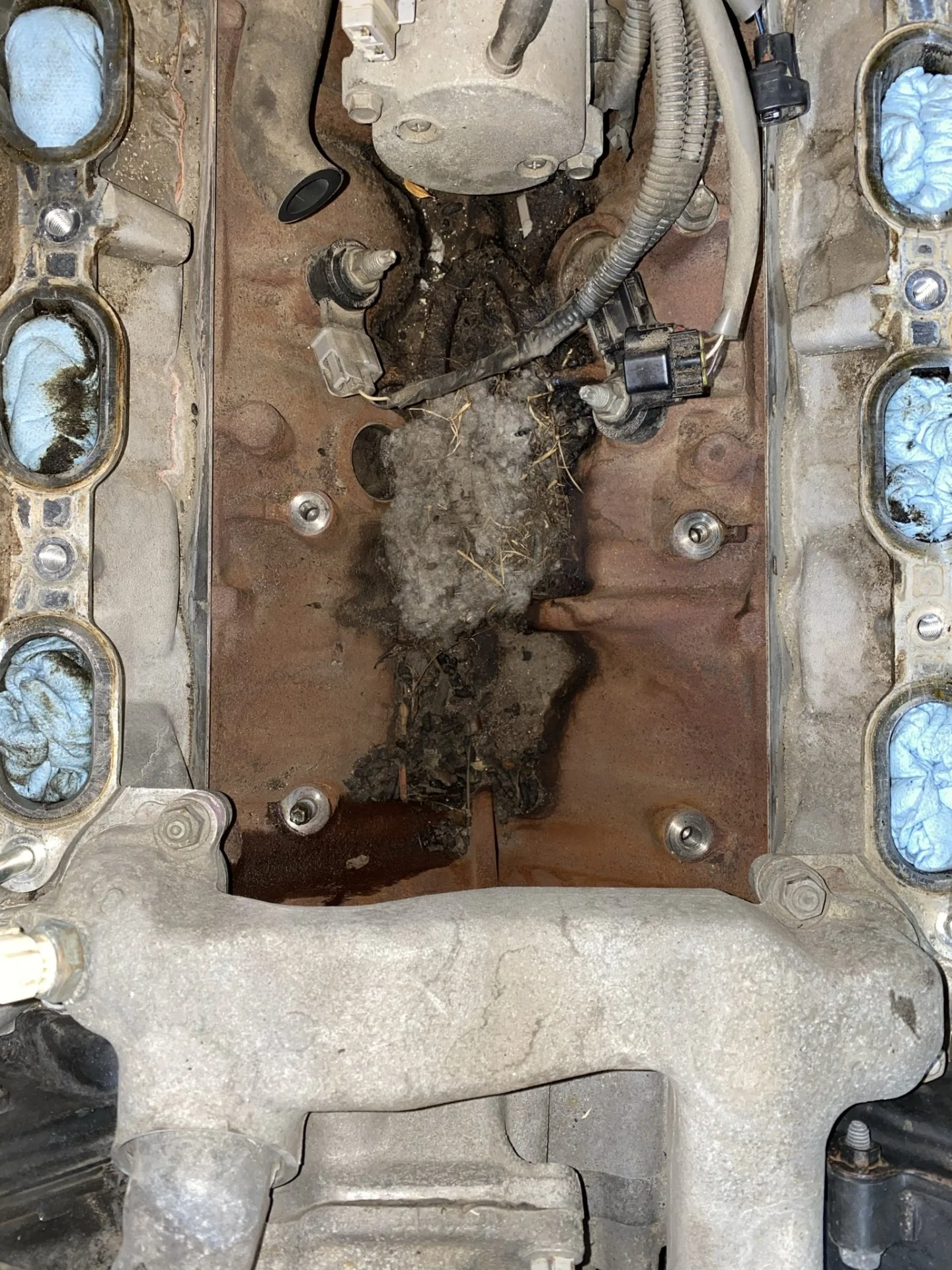

Anyone that has done a starter job, knows how much dust builds up in the engine valley. Even in a daily driver, that never sees dirt roads or trails. Imagine a rig following others on the trail. How much dust builds up under intake manifold, where the AI is sucking air from. Albeit only ~90 seconds on cold start up, it adds up.

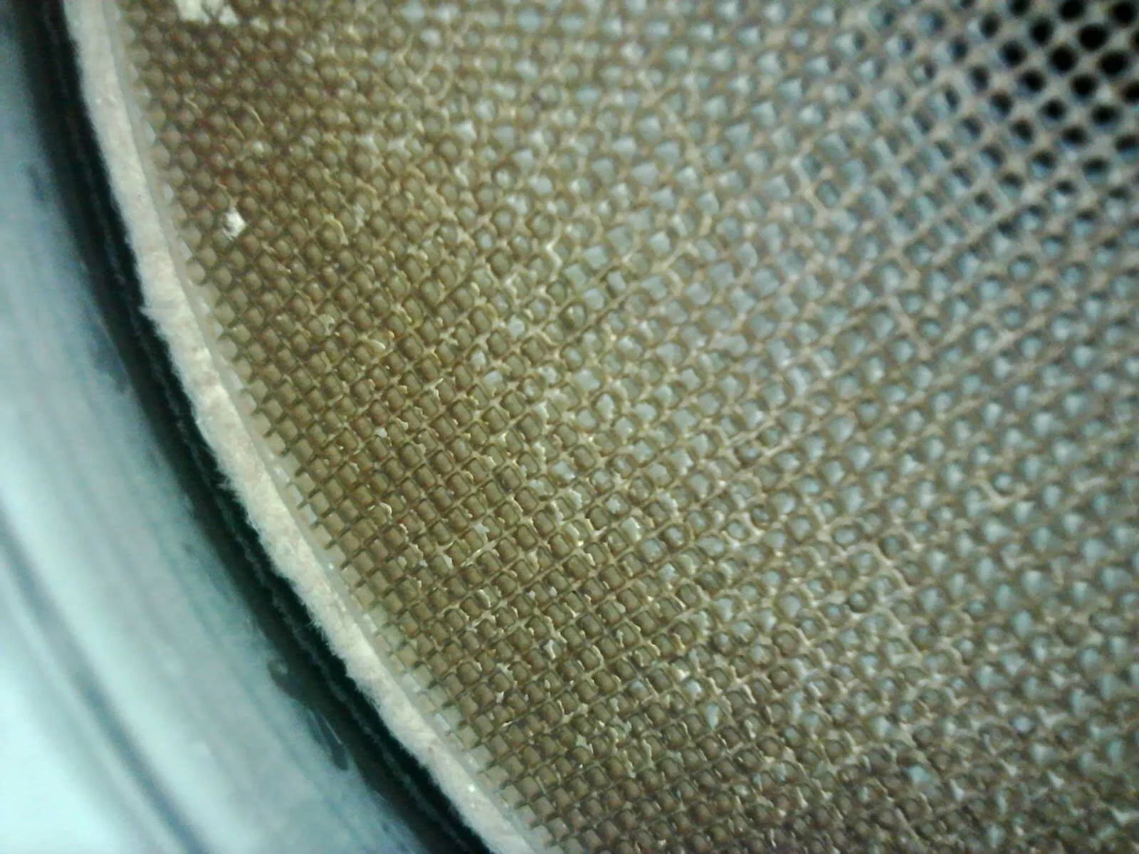

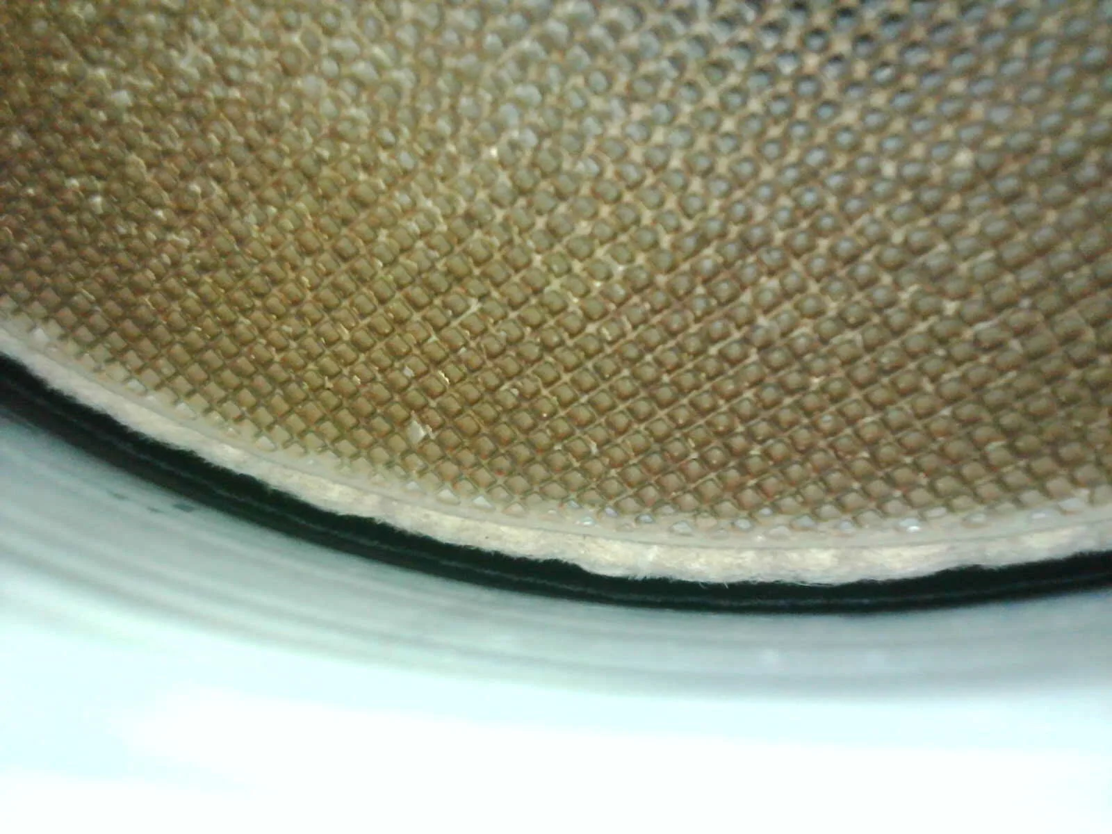

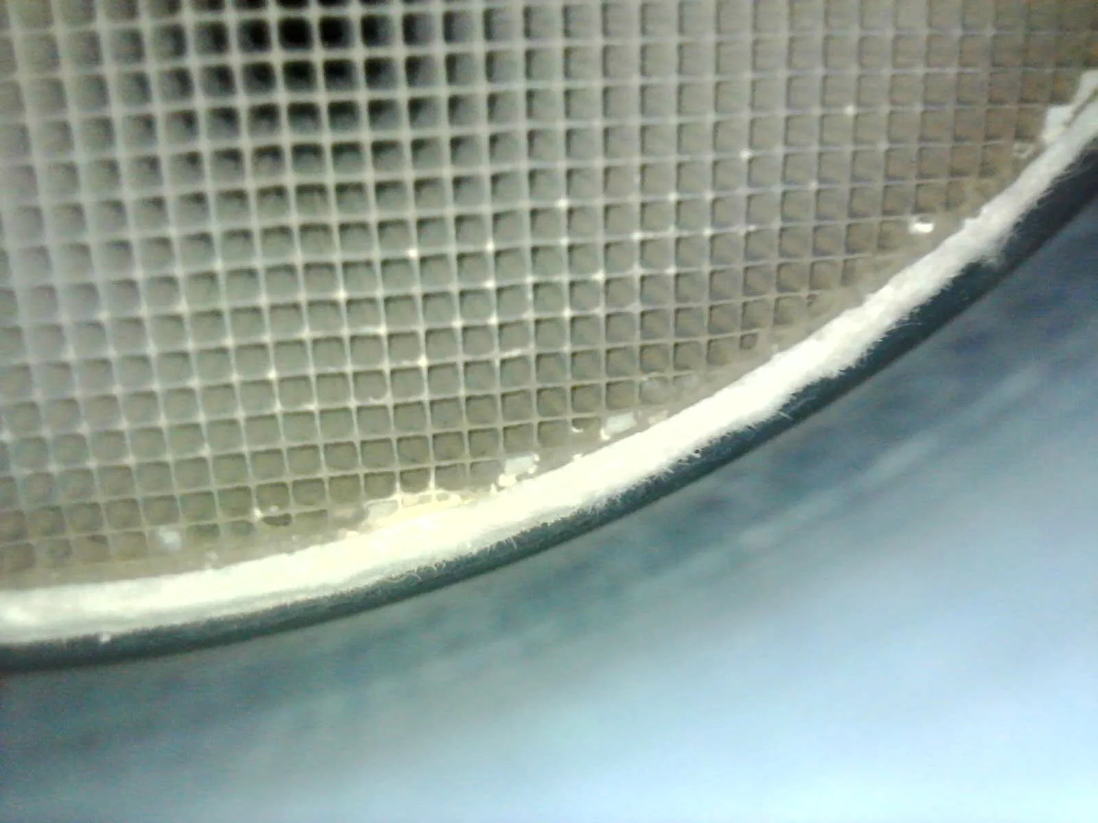

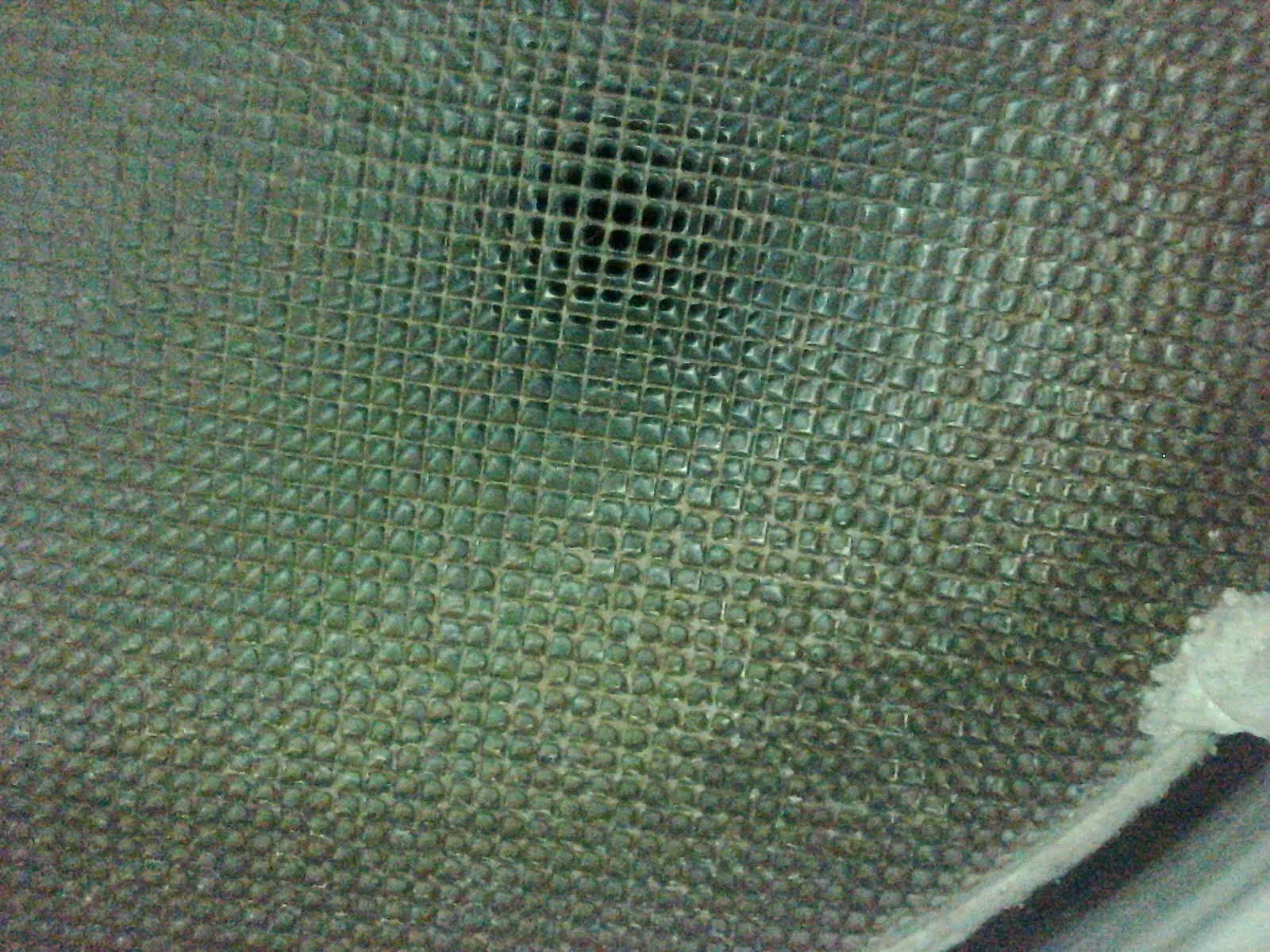

I tried to clean CAT of BK1 (OEM factory) & Bk2 (Davico CAT installed by PO) in my test case. I used 44K, Seafoam fogger, Chevron techron, Cataclean with many Italian burns (high RPM runs to cook off gunk from the CATs). Did not help. Note: Side benefit of this. When I pulled intake manifold. The intake ports of heads were cleanest I'd ever seen, near new looking.
I even pulled A/F sensor of BK1 only, and sprayed Seafoam directly on factory CAT face, while engine running. Made a little mistake, in leaving Seafoam straw in A/F port, while I crawled out from under vehicle, to turn key off (kill engine). That few seconds without fluid of Seafoam running through straw, melted straw. Subsequently I ran my snake camera into port and found clump of hard melted plastic on face of CAT. Even after Italian burn at 5K RPM for 10 minutes more that 1/2 dozen times, clump of melted plastic straw remained at side of CAT face.
I also scoped the CAT material (two in each VVT CAT), from between them thought 02 port and from the rear. The face of CAT looked clogged, with some improvement after Seafoam. The backside of forward CAT along with face and backside of aft CAT looked clear, very clean without appearance of clog.
So sure seems a clog issues. But does this also damage CAT, by coating internally reducing effectiveness. IDK, but certainly possible.
After melting plastic straw accidentally in AF port, a clump appeared at bottom of CAT BK1 face. Even after doing more Italian burns (high RPM HWY runs of ~7 to 10 minutes repeatedly, to cook CATs).
Back side, which appears very clean without any signs of clogging..

I've some evidence (pictures above). Plastic may indeed, be a contributor.

Sticking to CAT face and internal channel:
Yes, A.I. filter was obviously put in place to filter out dust from the air entering the system. So how much dust and of what composition can a CAT handle and what would make dust stick more so than other times is key.
Seems sticking in CAT, would be more of issue in rigs that idle excessively and/or run at low speed (RPM) on trails or roads. This condition of low RPM does build up gunk, that despots on CATs internally. Giving dust more to stick too.
As far as what composition of contaimines in dust, that is most detrimental to CAT. Or how much is too much contaimets in a CAT, before they're damaged to point we get a DTC. That would take someone well above my pay grade to answer. Which perhaps, as this thread devoples and explore the possibility. Will get more answers.:hmm:
@jerryb, it was for this test rig. I wanted (want) those sweet CATs you've hanging on your wall. I'm still interested in them ;) Even if just to borrow, but more than willing to buy them..
I could be wrong here about the CAT being damaged, from unfilter air blow directly on them. This thread may help answer that. May even prove me wrong about the CATs, perhaps! That's fine!

I'm not first to add a filter. Just first to give a solution on the VVT 4.7L, that I know of.

So after a year or so of testing this engine and working over systems. I came up with a theory as to what took out the CATs, as it did take them both out. Theory relied on finding a A.I. filter gone or disintegrating.
So at the being of 2021, I finally pulled the intake manifold and A.I pump. Sure enough I found the A.I filter gone! Or just the tiny bit, remaining, as seen in OP first picture.
I do have some question as to what happened and how to filter was damged?? Which I'll get into later.
But there's no question. A.I. filter is very much needed in street legal VVT 4.7L.
Why/how are these A.I. pump filters damaged.
Well IDK for sure:

Filter loss may not be happening to all. I say"may not". Because in my test case, I did have rodent damage. History at Lexus.com shows in 2012 at 67K miles (~7 yrs & ~90K miles, before CAT codes reported). A Lexus Dealership repaired rodent damage to VVT cam sensor wire and both knock sensors replaced. Knock sensor damage is sure sign rodent were under the intake manifold, where A.I. pump and it filter are located.
But it is possible these filter may all degrade, falling apart on their own over time. I say this, because of what first made me even consider the A.I. filter a central player in issues. Was ebay ad for rebuilt A.I (Secondary Air Injection Smog Pump), and a TSB from Toyota.
Ebay seller claimed to a be a Toyota Master mechanic. He stated he: rebuilt A.I. pump by replaced the filter, it was the failure point he claimed. I was looking at this ebay sellers statement: in the light of a TSB my Toyota Parts guy handed me,. After I asked what parts are, associate with A.I. codes P1442 & P1445 I was getting. In the TSB, it states as note to parts list: "Replace only If damaged by debris. Reuse parts when possible" What debris and where from, I'm thinking. Then I saw ebay ad :hmm:
BTW: I did and I am still looking at all A.I. parts from my system for debris. Which I've not found any big enough to see with naked eye. What I do see is internal parts look gray & stained. Whereas other used A.I. parts (different 4.7L VVT) i have, internally look clean & shiny in comparison where filter was still in place.

Chew marks:
These may be chew marks on impeller blades. But chewed-up or busted fins extend further than 4 fins opening exposes for rodent.
I found remnants of rodents in engine valley. Likely old from 2012, just not cleaned out. See chew marks on wire protective wrap housing, next to air intake tube. A full size mouse would likely have difficult time if not impossible, to squeeze into ~3/4" ID air intake tube of pump. But certainly a baby mouse could squeeze in. So it could be I've a rare case here of rodent eating the filter perhaps, perhaps not, IDK.
In addition to chew marks, I found old nest under the A.I. pump and main Switch.
