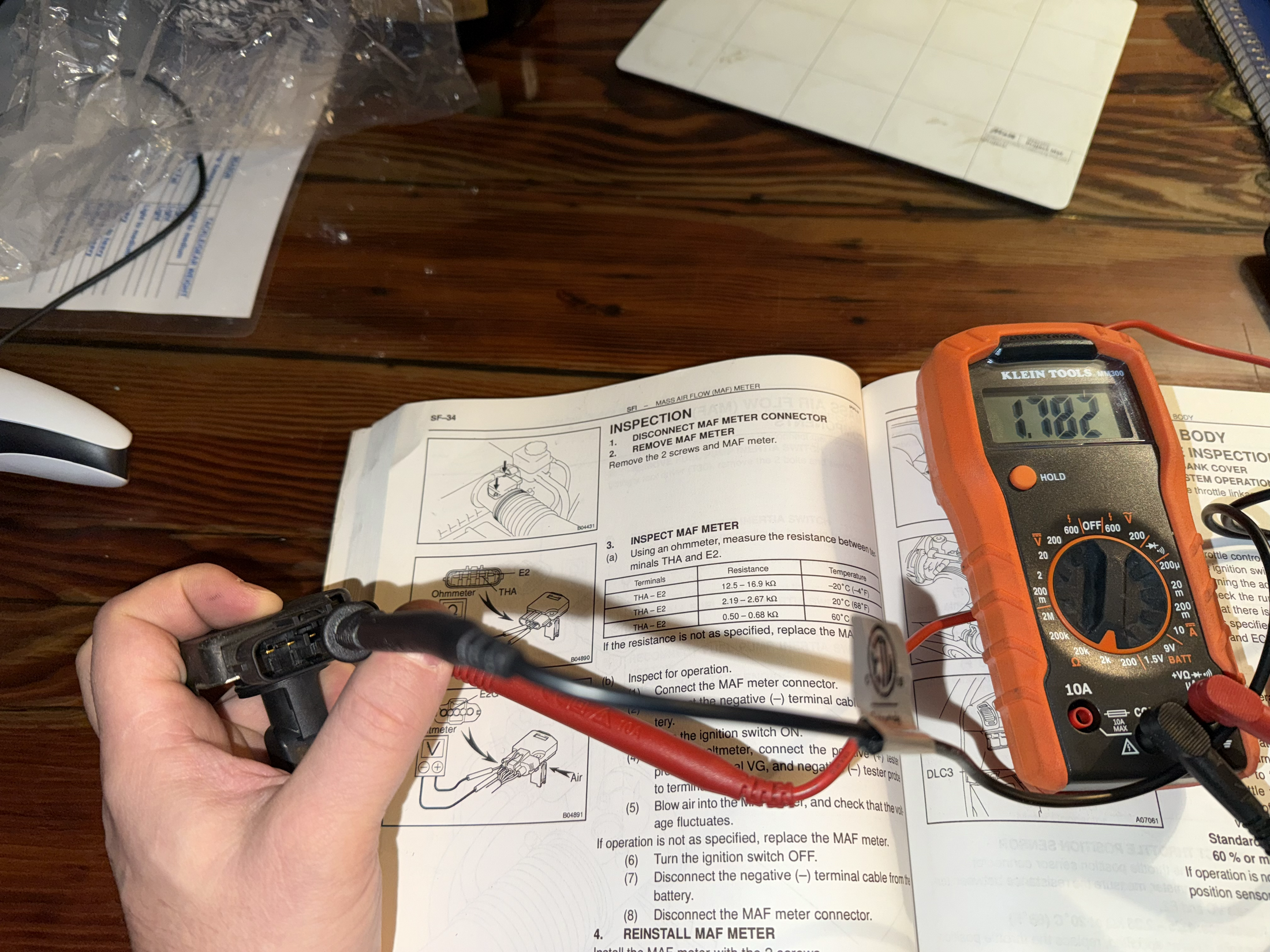

I bought my new MAF sensor from the dealer, and paid the premium for peace of mind. I tested out the old sensor according to the FSM. The temperature of my sensor I estimate to be approximately 75 degrees, which is the temperature in my apartment, and my ohm read out is approximately 1.8.
According to the FSM if the sensor temperature is at 68F this should result in an ohm reading between 2.19 to 2.67 ohms. I'm going to say my resistance reading is not correct, and the sensor is faulty.

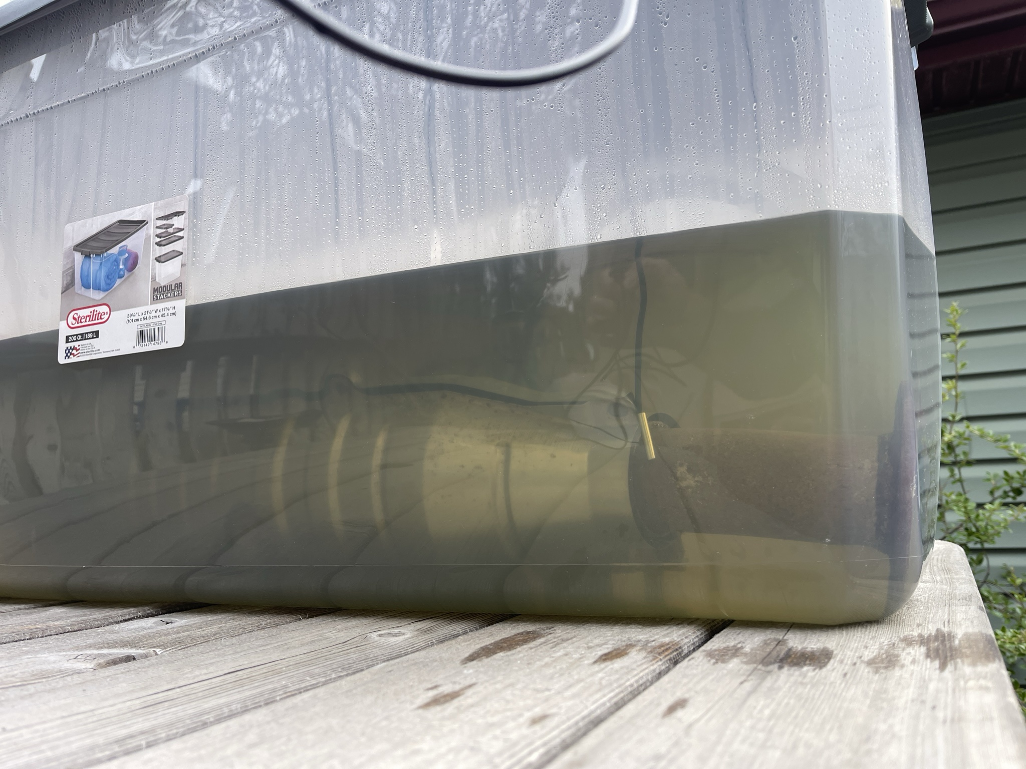

I finally got around to pulling my cats today. Fuel economy is terrible and I'm throwing all sorts of O2 sensors codes.
Here's a quick peek at the honeycomb media prior to letting them soak. I'm going to try the circulating 160'F Citric Acid/Oxalic acid bath. I'll be running 4 new O2 sensors as well. Hoping this restores their functionality!

I laid the pipes and filled them with lacquer thinner overnight. I shook the fluid a few times and changed their orientation to try and expose all of the honeycomb media to the fluid.
It definitely came out quite a bit darker/yellow/oily along with some soot, but I was hoping for a little more ‘evidence’ in the fluid.
I’m trying to figure out a large shallow plastic container that will fit both pipes. I’ll fill it with distilled water/oxalic + citric acid, and then circulate and heat the bath @ 160’F using an old Anova sous vide machine. Hoping to get that finished this weekend and I’ll report back again.

Fresh hardware and it's all buttoned up. No more P0420/P0430 codes.
B1S2 voltage is high-flat (~0.96 V) while B1S1 lambda oscillates—exactly what you want from a catalyst with good oxygen storage.
B2S2 has a heater feed/ground issue that I'm going to chase down, at which point I can 100% test everything, but I'm optimistic the cats have been sufficiently regen'd. I'm really stoked - OEM cats are ~$1500USD/ea
Here's a breakdown of what I spent on this process:
~ $40 - 2 gallons laquer thinner
~ $15 USD - 5kg citric acid
~ $15 USD - 2kg oxalic acid
- $35 USD - 25 gallons distilled water
- $30 USD - Large plastic bin
- $20 USD - 2000w pool heater stick
- $20 USD - 900lph aquarium pump
- $20 USD - misc hoses, t-fitting, hose clamps
= $155 USD for the acid bath kit ($65 in consumables)
- $160 USD - genuine denso upstream o2 sensors x2
- $90 USD - genuine denso downstream o2 sensors x2
~ $30 USD - 10x exhaust studs, hardware, gaskets
