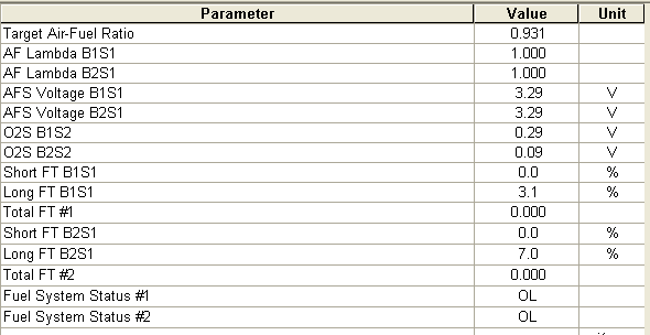

I'm waiting for replacement Bank 2 Sensor 1 (Denso 234-9051) o2 sensor to arrive. I'm running a cheap amazon sensor at the moment, and bank 2 fuel trims are higer than bank 1. I'm gonna chalk this up to being a cheap sensor, and it should even out once I install the Denso unit this week.

What are fuel trim, while cruising steady ~65MPH?
