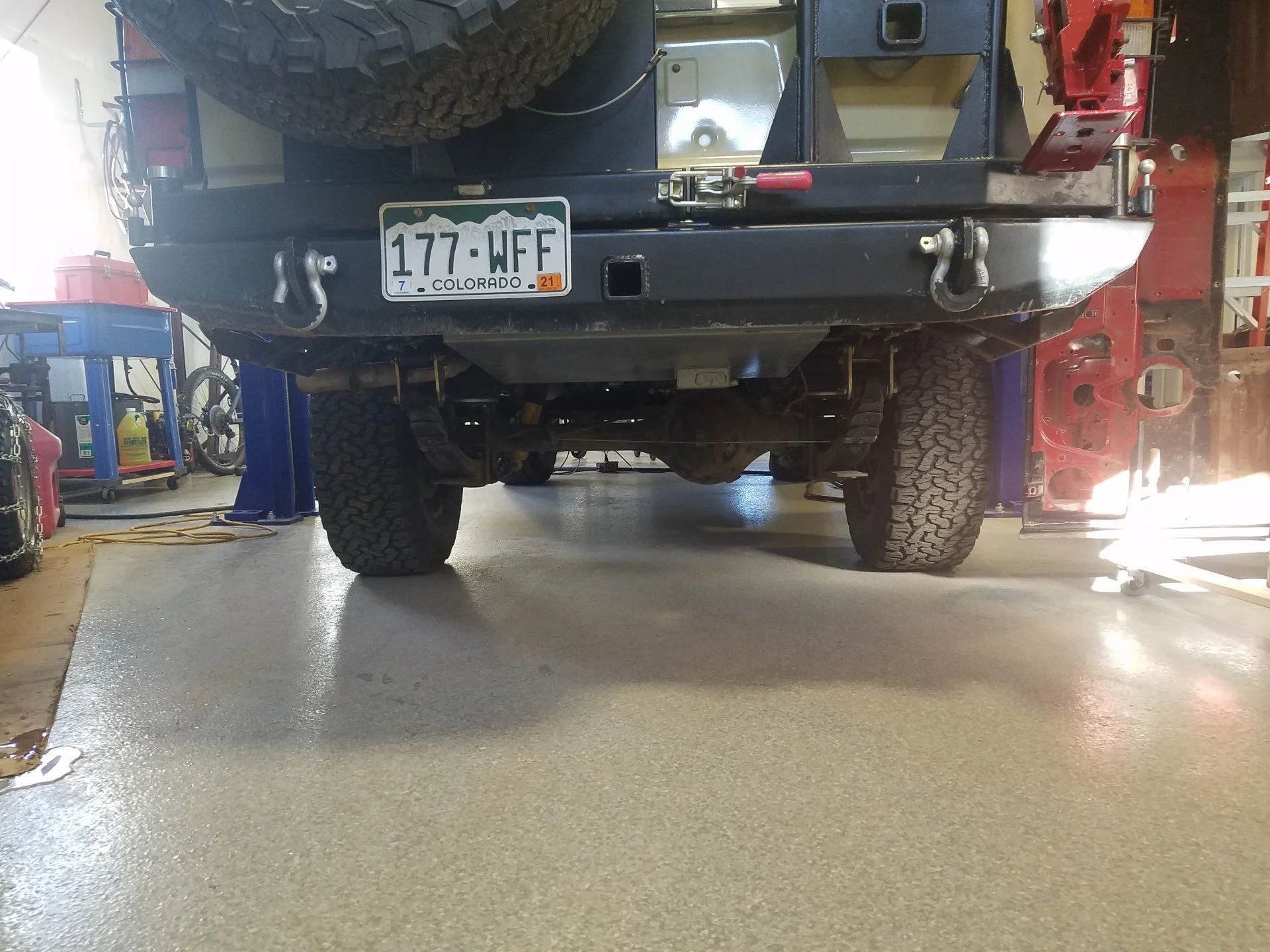

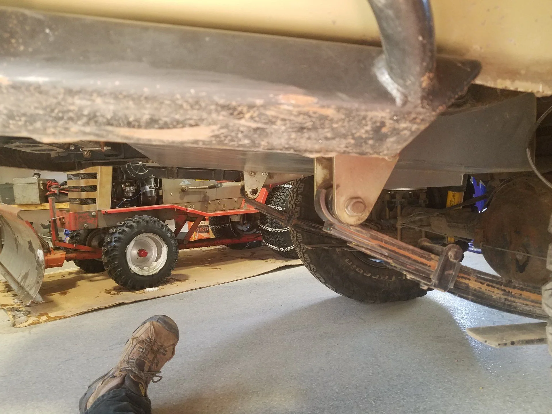

Anyone have any installed pics of their LRA tanks showing the clearance and how it hangs under the truck?
Expect that it’s lower than your current spare by a few inches. I’ve never hit my spare off road and I don’t do buggy style rock crawling so I’m not worried.

Attached are a couple of pics of my LRA 38 gal. tank.
Absolutely no regrets, it is hands down one of the best mods for my use of the truck. We do a lot of solo multiday trips with no set agenda, so the extra fuel provides a lot of peace of mind and extended range when exploring . As far as hard core wheeling with it, it I think that it is not the limiting factor on what trails you can handle or where you can go, the 2.5 " lift and 33's on my truck, for instance, are more of a limiting factor clearance- wise than the tank. I have never hit it (knock on wood), and we typically run Cruise Moab 6-7 level trails.. Metal Masher, Kane Creek, Steel Bender ,Poison Spider, etc.
Hope this helps your decision.
Thanks for those @DickM, those pictures really helps seal the deal. That doesn't hang down nearly as bad as I had thought, and looks decently protected. My rear bumper is similar to yours and would be the first thing to hit in most cases. Makes me realize I certainly need a set of those quarter sliders too.
