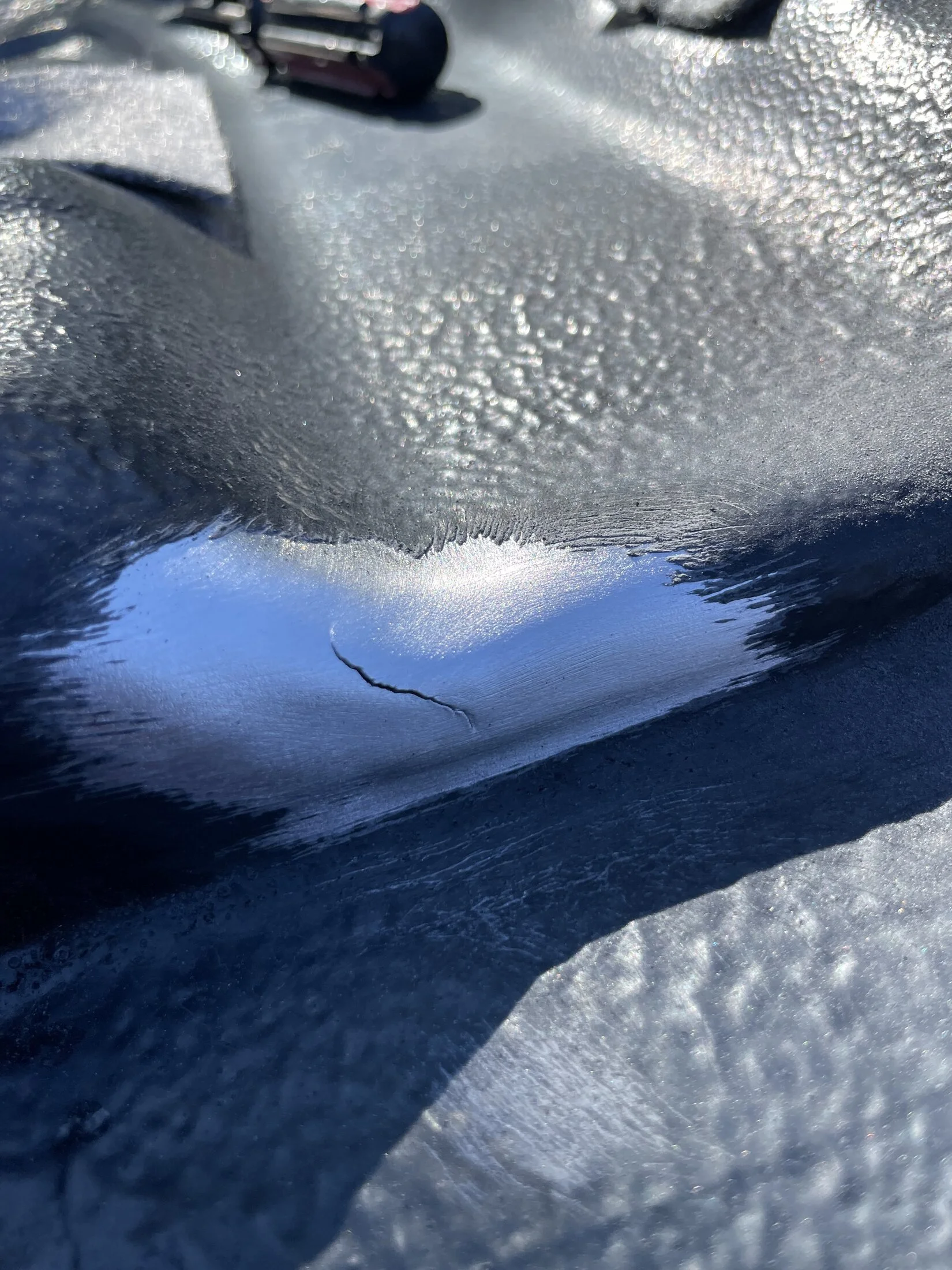

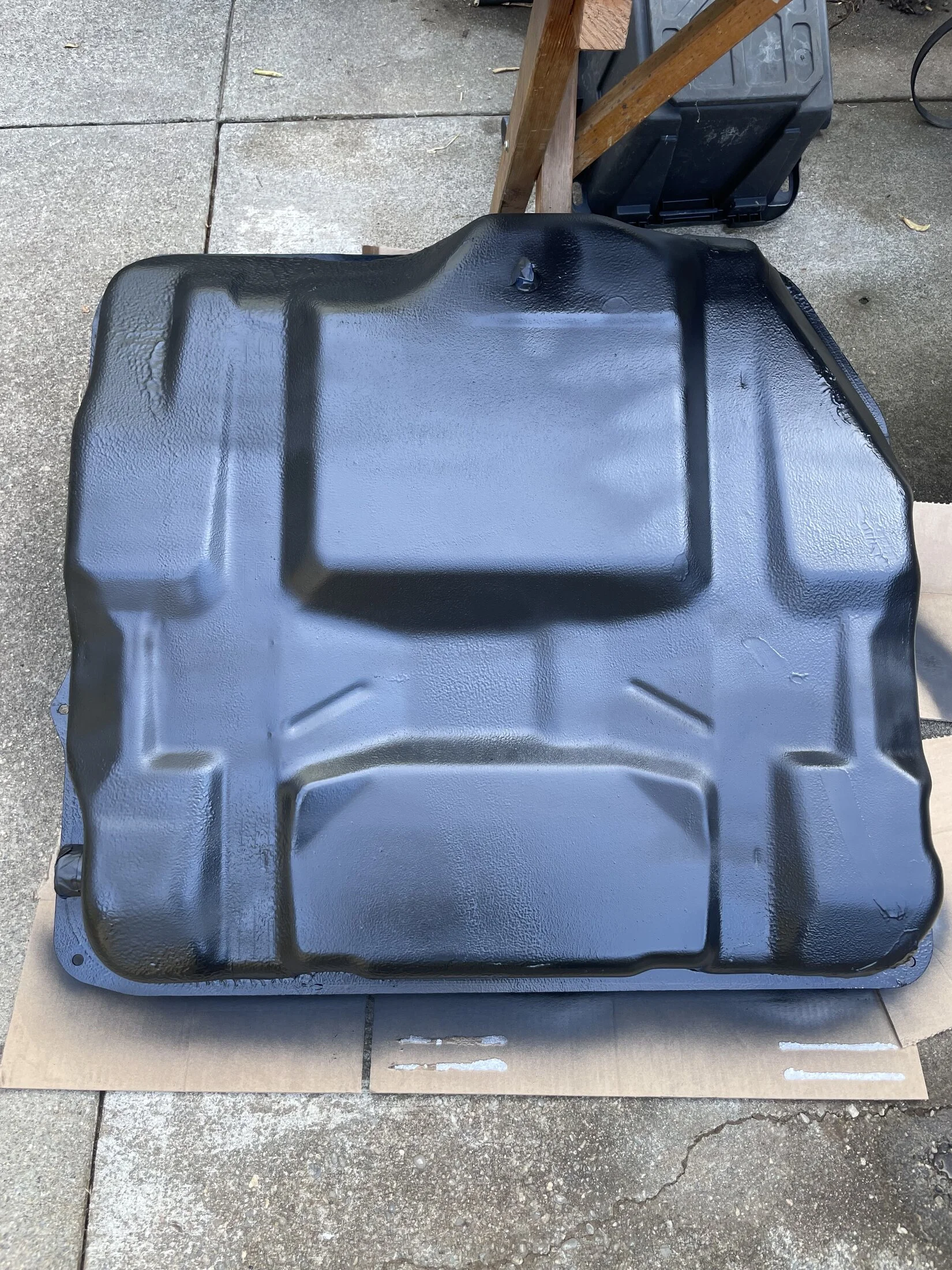

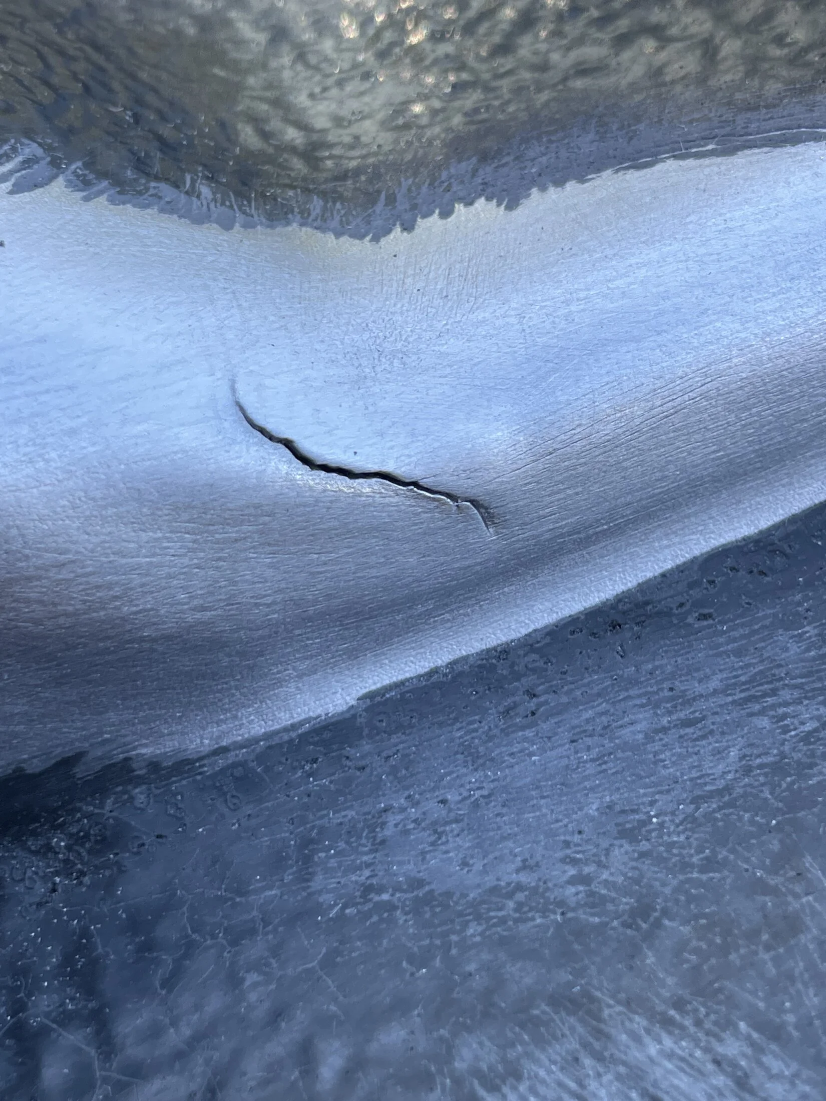

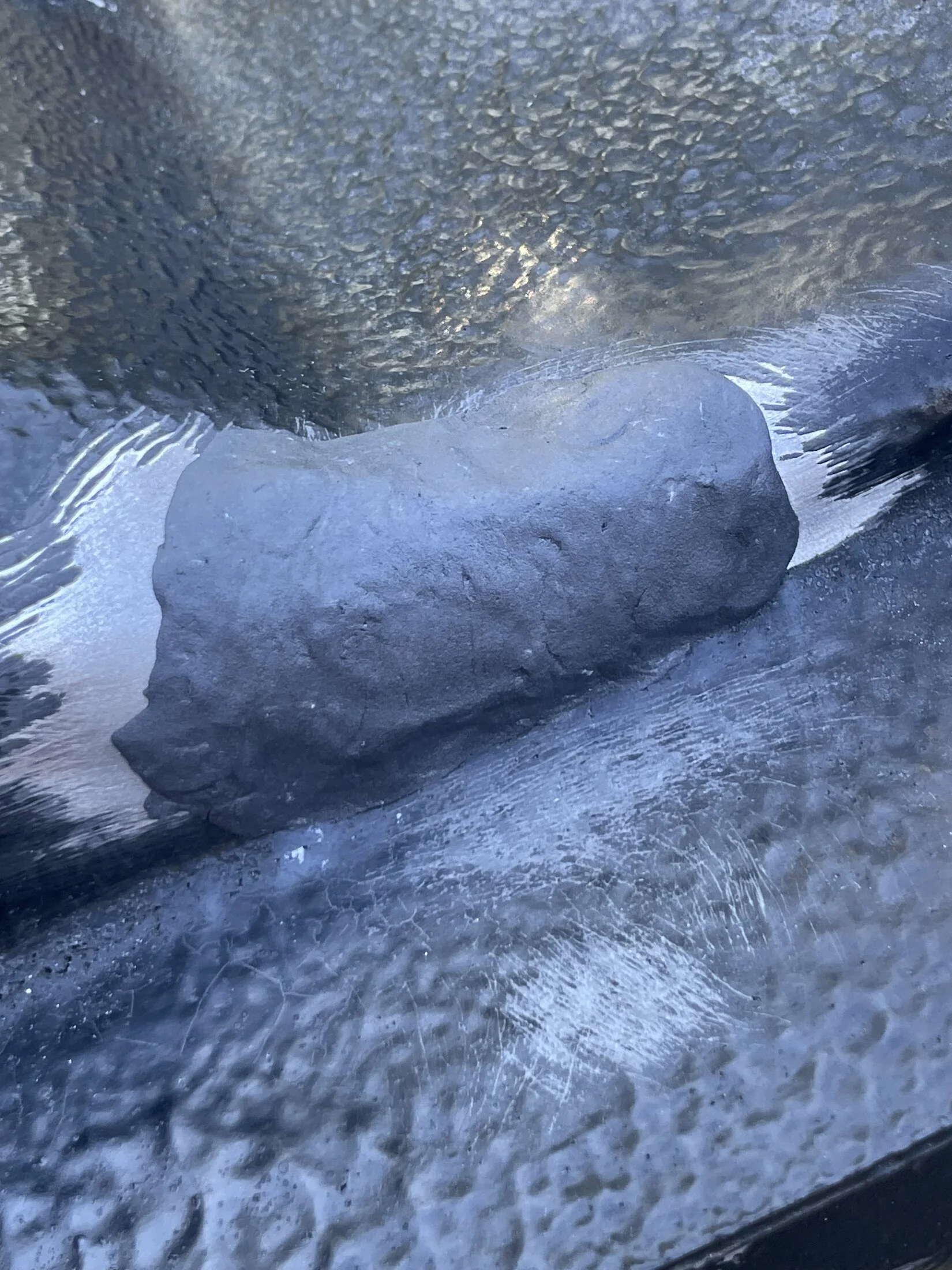

FJ62 has been parked due to a fuel ⛽️ leak, but finally was able to patch it with JB Weld. 3/4 inch Crack is on top of the tank so it’s not too bad. This is a temporary fix, but also took the time to clean 🧼 up the undercarriage of the rig and put a couple of coats of undercoating on the tank.
Looks great. Hopefully you can find a shop to weld that some day. Fuel tanks crack happen (among other reasons) due to stress from pressure cycling, so your JB weld may not last on a hot sunny day. Just FYI - I hope it holds!
