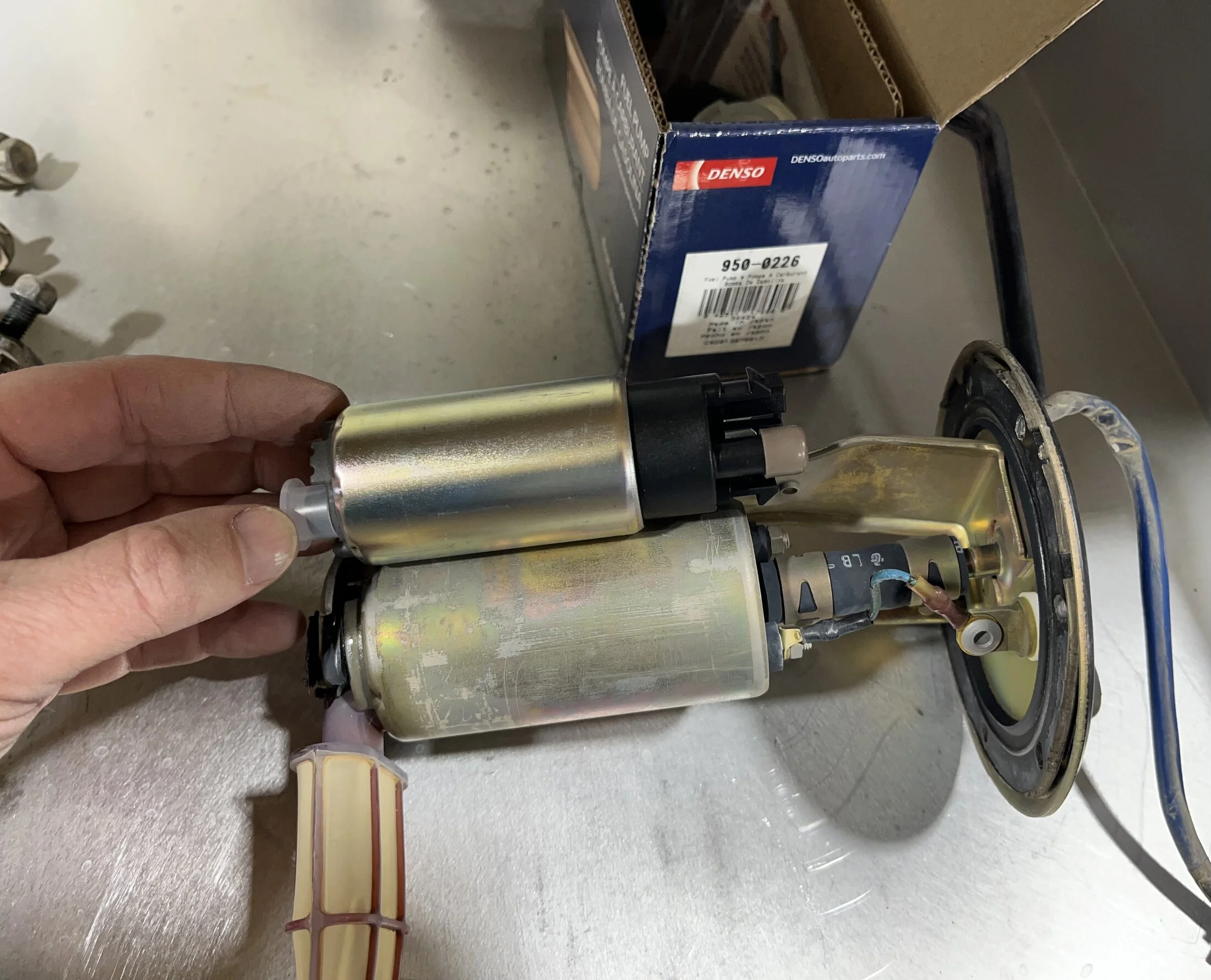

Planning for an LRA 40 gallon tank installation soon with the currently installed 3fe. However I anticipate an LS swap maybe in the next year or so. Ideally I'd like to build the fuel tank system once. Burntoast thread mentions using the Denso 950-0226 pump with the LS.

The only reason I didn’t go tanks inc is that their pump is a Walbro. You could go with that setup and then swap the Denso if you want. I wanted OEM reliability and noise (both which may or may not be issues with Walbro.
Assuming the stock fuel pressure regulation is working, I can’t see an issue with the new pump (either one)

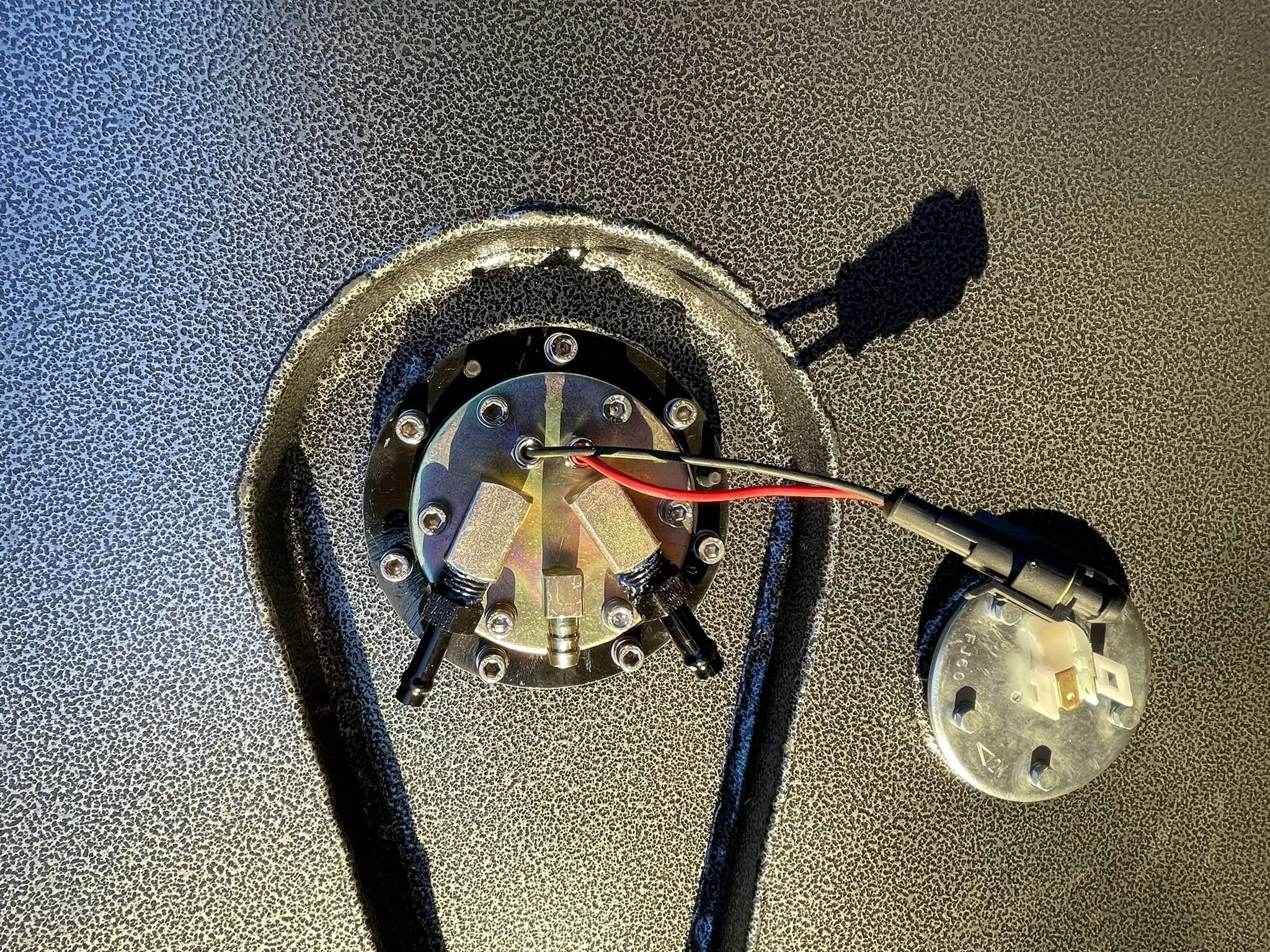

Here's a pic of Tommy's adapter, I used the Walbro 190LPH pump and have had no issues with it and it's pretty quiet. I only hear it priming pre start up.

Last night I primed the fuel line then started up and ran in the shop. Got it up to operating temp and everything was great, I could tell the pump was on but barely heard it. I got on the road this morning and this pump started whining as heard here. It was consistent all the way to work, barely any change at all stop light or during acceleration. Granted there’s no sound deadening in right now, but the old pump was silent so this is a huge difference. The whine drops a bit when I stab the throttle - I’m wondering if this whine is due to the lower PSI regulation for the 3FE? Tank has about 15 gallons of fuel and there’s at least 1/4” clearance from the tank to the bottom of the pickup filter, so I don’t think it’s a supply problem. I’ve got an adaptor coming to test the pressure at the rail but the engine is running excellent. Did I get a defective pump? Any thoughts?

Ok I did some troubleshooting tonight. Installed a fuel pressure gauge. At idle it holds 50psi and the pump is silent. When I blip the throttle the intake manifold pressure drops, which lets the fuel regulator ramp up and my gauge pegs out to the mechanical limit and stays there - which is well above 80psi (where the gauge numbers stop).
I removed the return line at the tank and let that feed into a gas can to make sure there were no return restrictions… there aren’t.
I did a bit more than that, but the conclusion is that the stock regulator can’t drop enough pressure/flow for this pump. I think the fuel line pressure is too high causing back pressure on the pump which is causing the whine. It’s consistently dead quiet until I blip the throttle.
So at this point I’m thinking I’ll just get a 3FE pump and I’ll have to address the pump again when it’s time for the LS.
