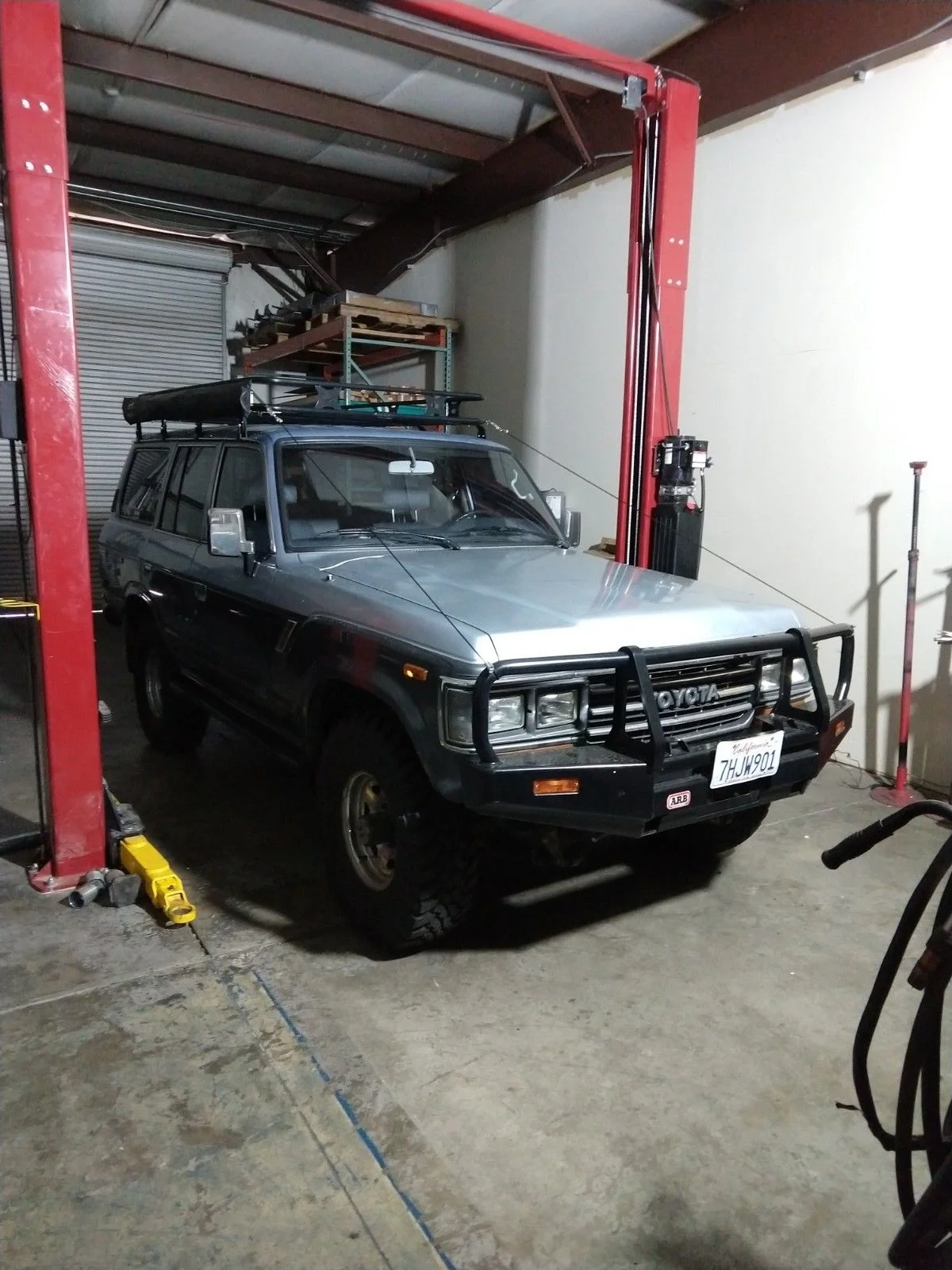

the pics above remind me that we cruiserheads may want to plan for roof rack goodies too... There goes another foot. And goes for the door too.

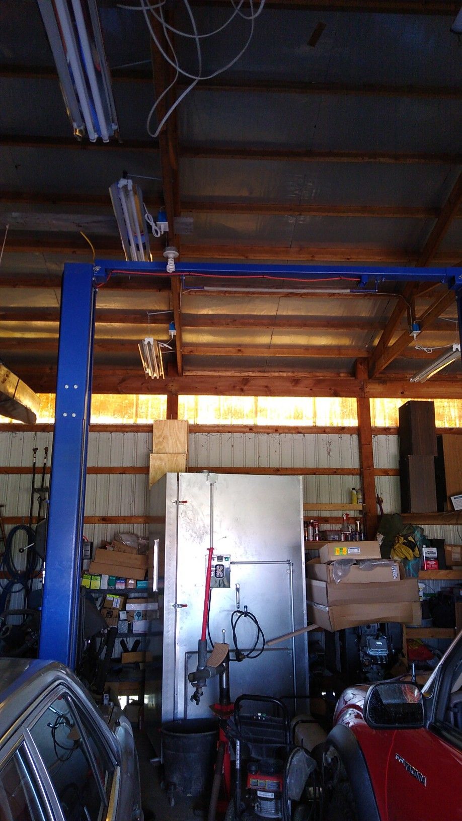

Our shop has a hair under 12' ceilings. We've got 2 floor plate lifts like what Jason posted. At 12' ceiling a Cruiser is still fairly low. I'm short and I can't stand up straight under most trucks on the lift. We've also got a mid rise lift that we use a ton. It's great for brakes, suspension, oil changes, etc. You just can't get to the middle of the drive train. The mid rise is way more stable feeling than the 2 post though.
Trusses are supposed to be 12'. I didn't build the barn. Lift from Harbor Freight. Don't think they sell them anymore. Lifts a 60 series high enough.
