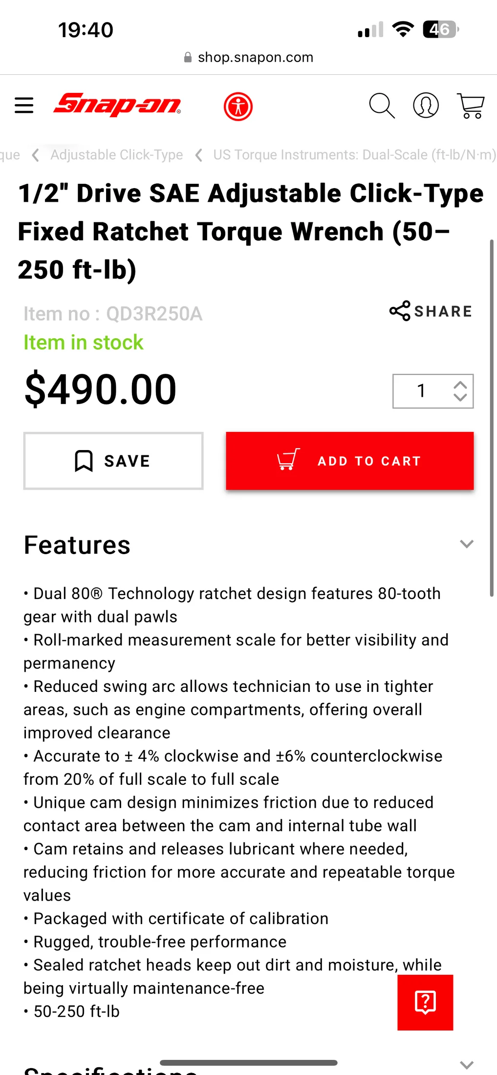

I’ve used a husky torque wrench that’s the same spec and never gave it a second thought. A click style 50-250 ft-lbs from snap on is rated at 4% +\-. IMO if you’re that worried I’d buy a gear wrench, Icon or husky and send it out for calibration and call it good.
