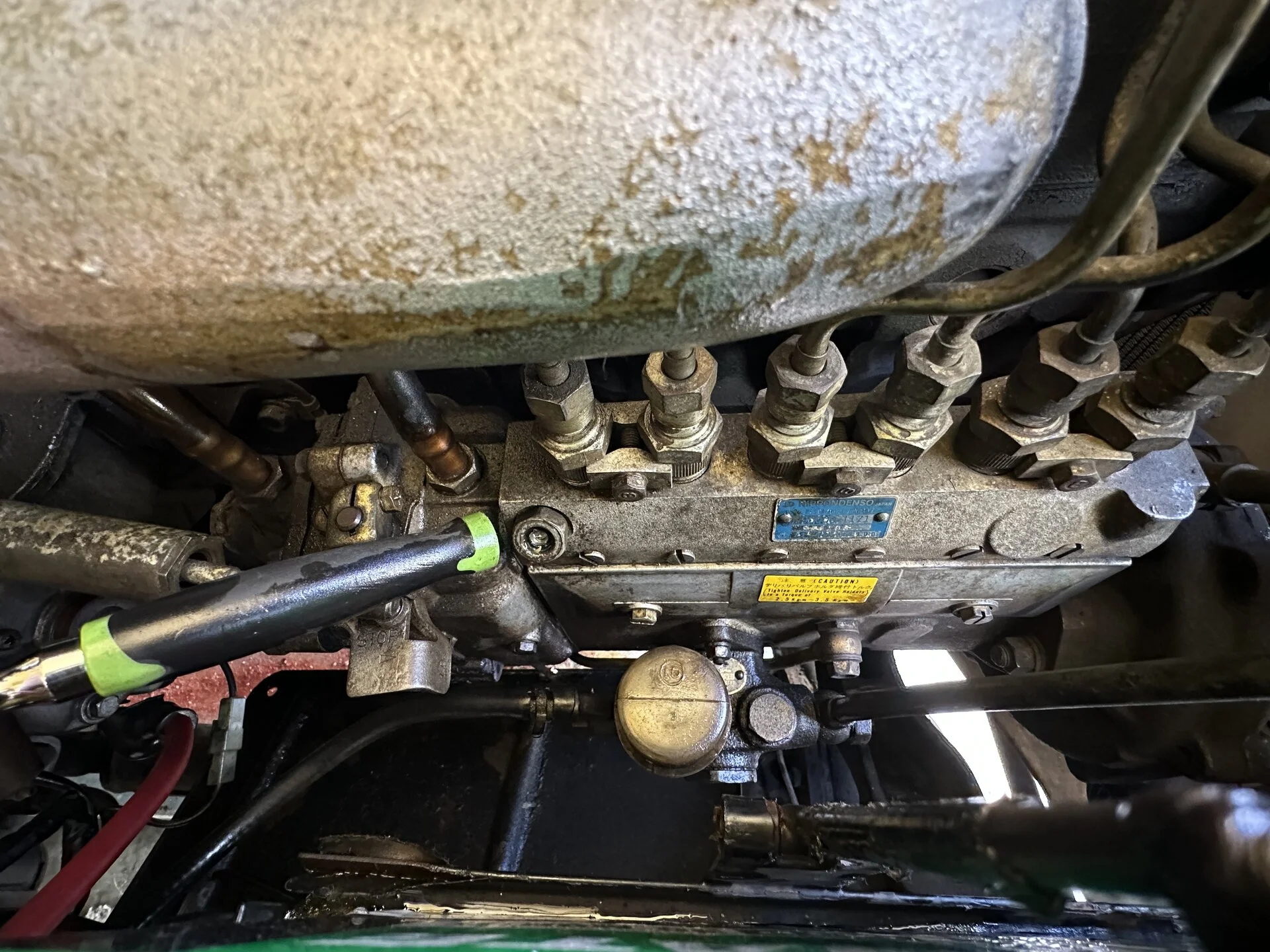

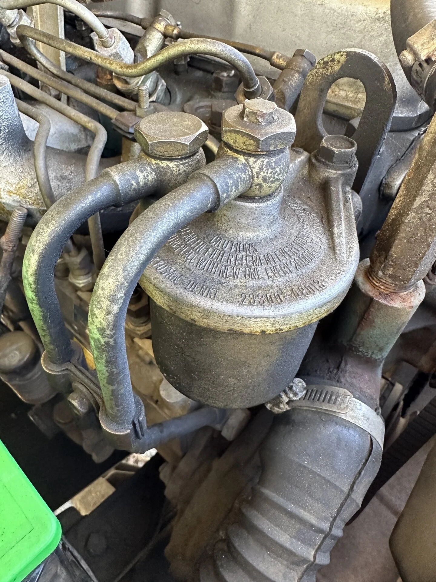

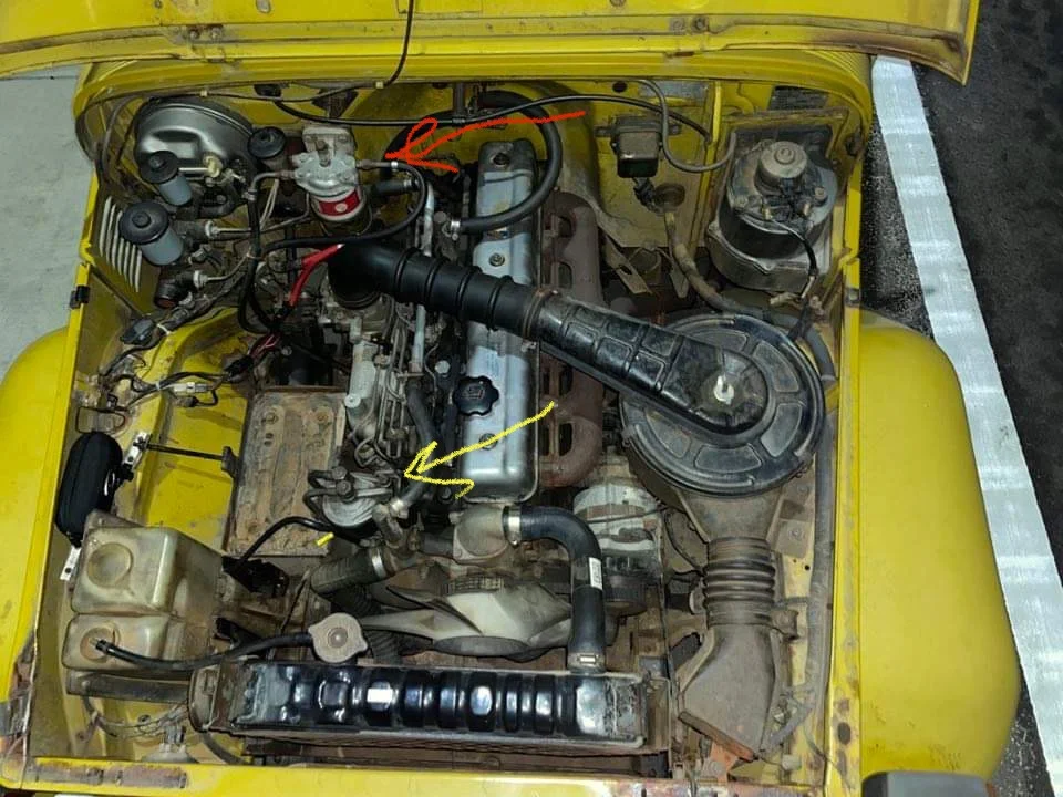

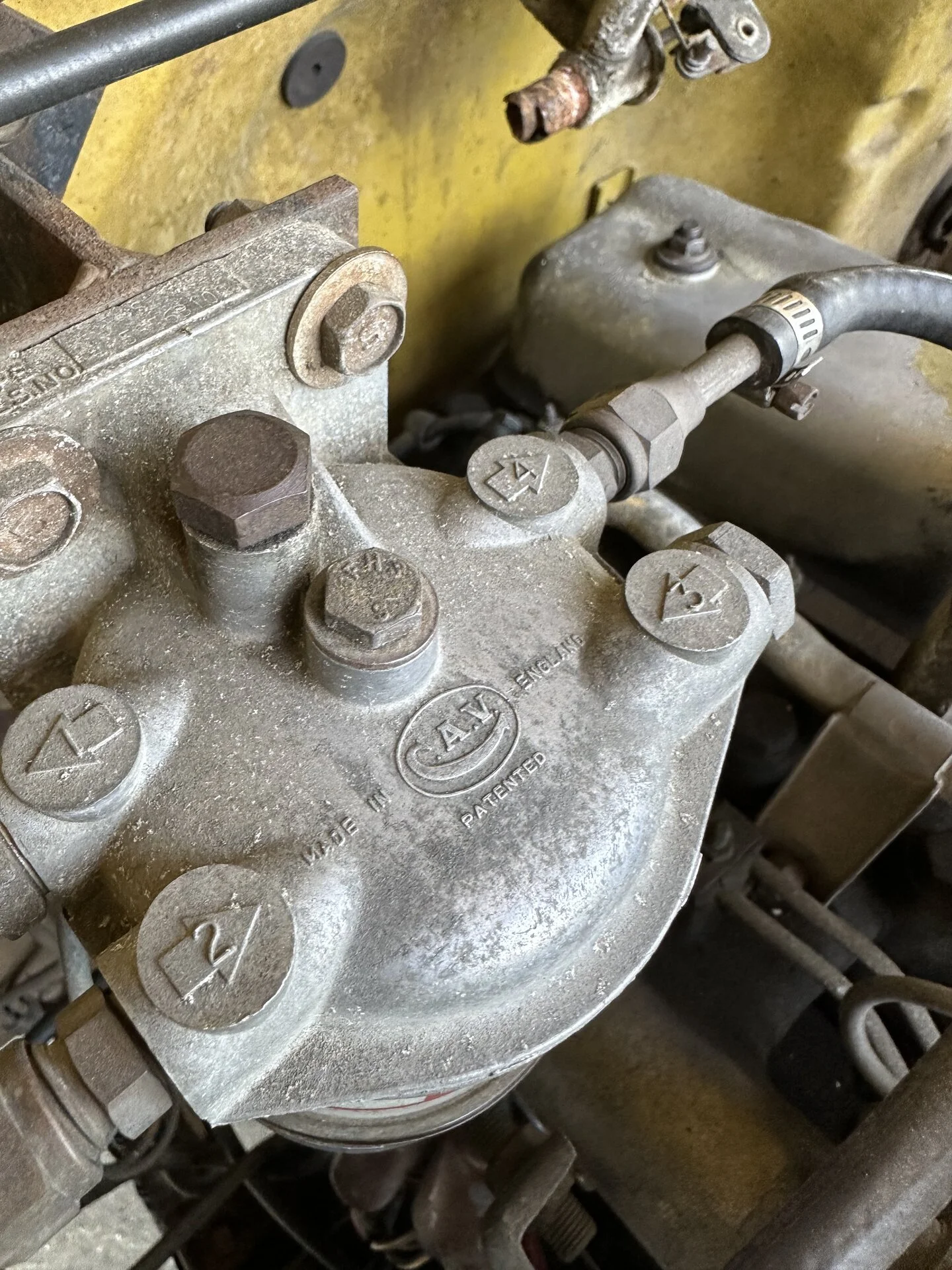

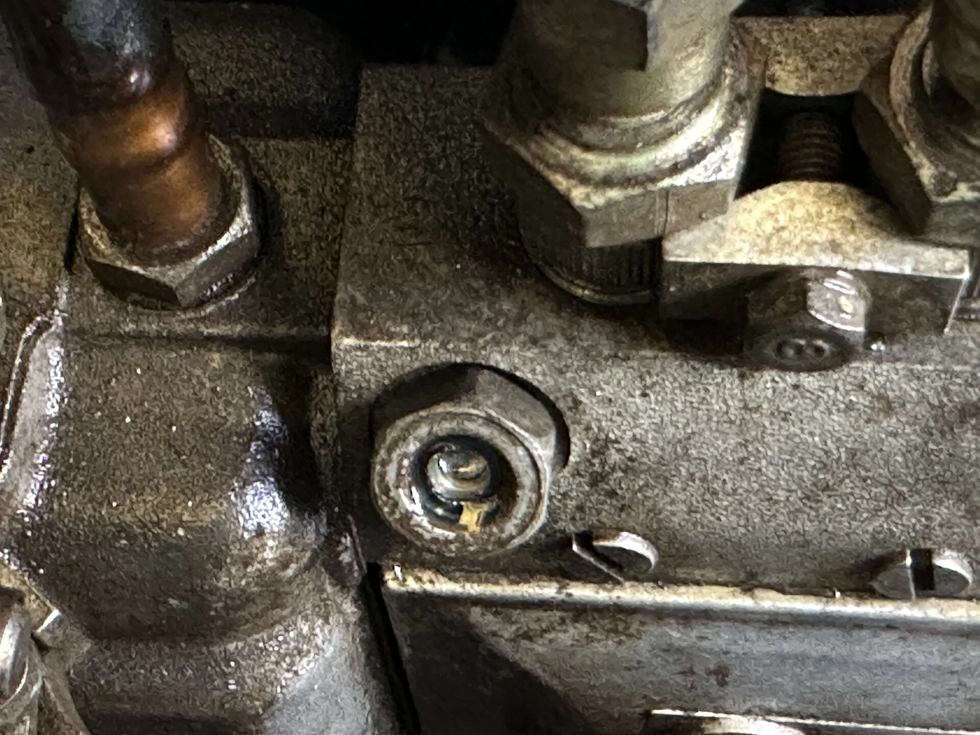

I made some good progress today and a small mistake. All sorted but here are the photos again:
Post in thread 'Low power 79 HJ45'
Low power 79 HJ45 - https://forum.ih8mud.com/threads/low-power-79-hj45.1318480/post-15074705
In the first photos two arrows
1 stock filter close to water pump
2 after market sedimenter mounted on firewall right side next to steering
Bleed on top of stock filter is there, I just re-bled from there.
Bleed on left of injector pump is something I did not touch previously and while running I bled from here and she started sounding normal again.
Mistake made, I busted the injector bleed nipple while bringing it snug but I found a shoulder bolt to resolve for now.
She seems to be a lot better now thanks for all the help. It’s been great to learn and next time I can do the whole bleed in less than 1 hr.
