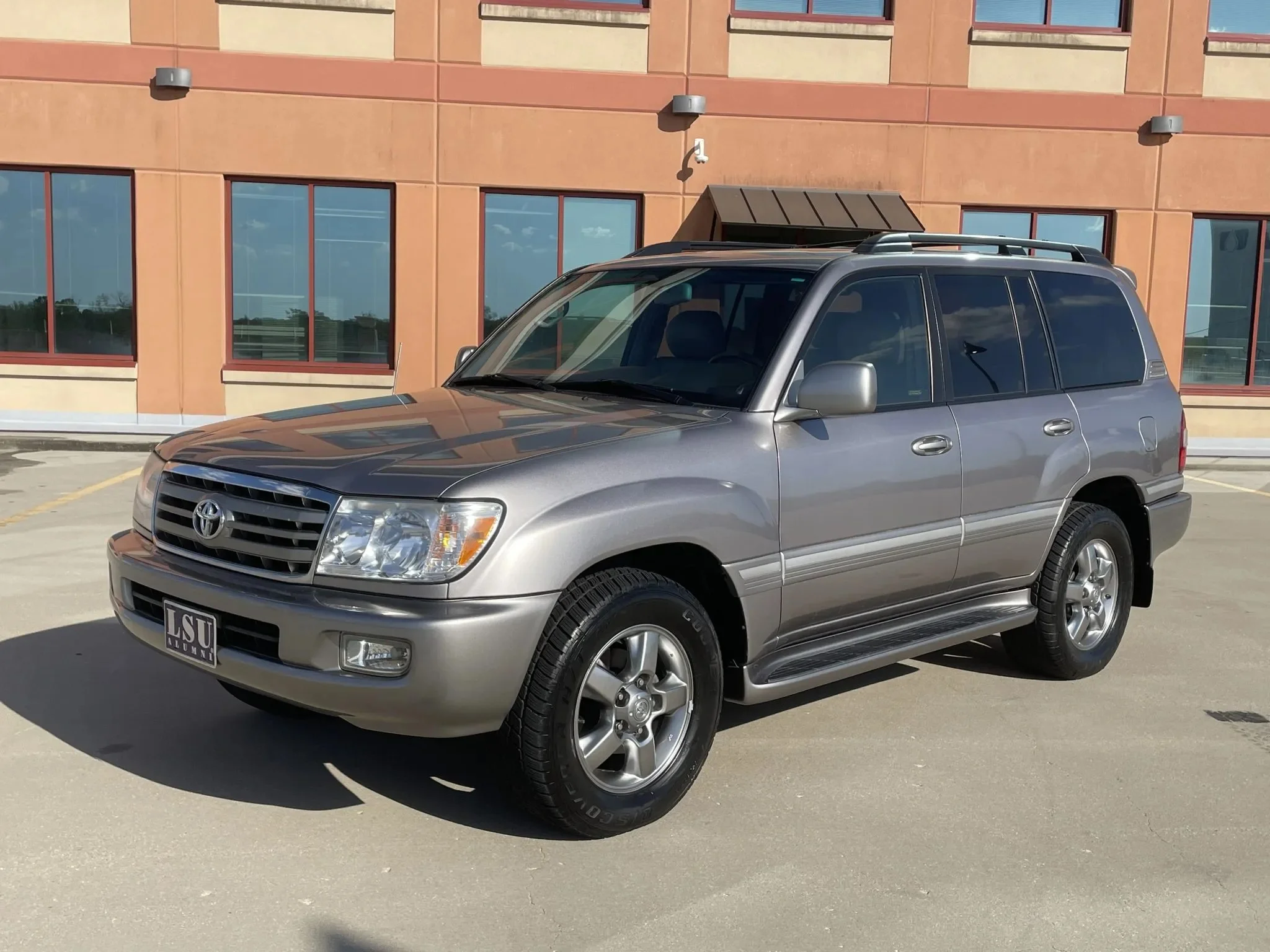

How many saw the Thunder Cloud, 24K miles 2007 Land Cruiser, on BAT. Winning bid of $62,500 Dec 22 2024. WOW! :eek::clap:
The lowest miles I've seen on BAT or every had my hands on.;)

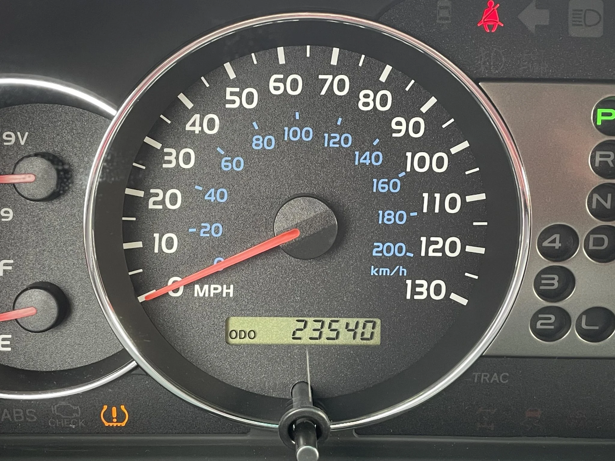

In this 24K miles 2007. Story given was: Pride & joy show car. Driven on HWY. Round trip 20 miles to church, with a few other trips. Had other vehicles, used for daily drivers. No high water, no dirty roads.
Vehicle service history and carfax support milage use statement. For first 16 years, then use miles drop off. Subsequent statements indicate health issue, prevented driving much if at all last year or so. Parked in a car port.
Service history did have a few red flags:
Oil & fitter interval long then 1 year, at 4 to 5 year. This would be as maintenance light came on, each 5k miles.
No coolant flush in service history.
No Time belt in history.

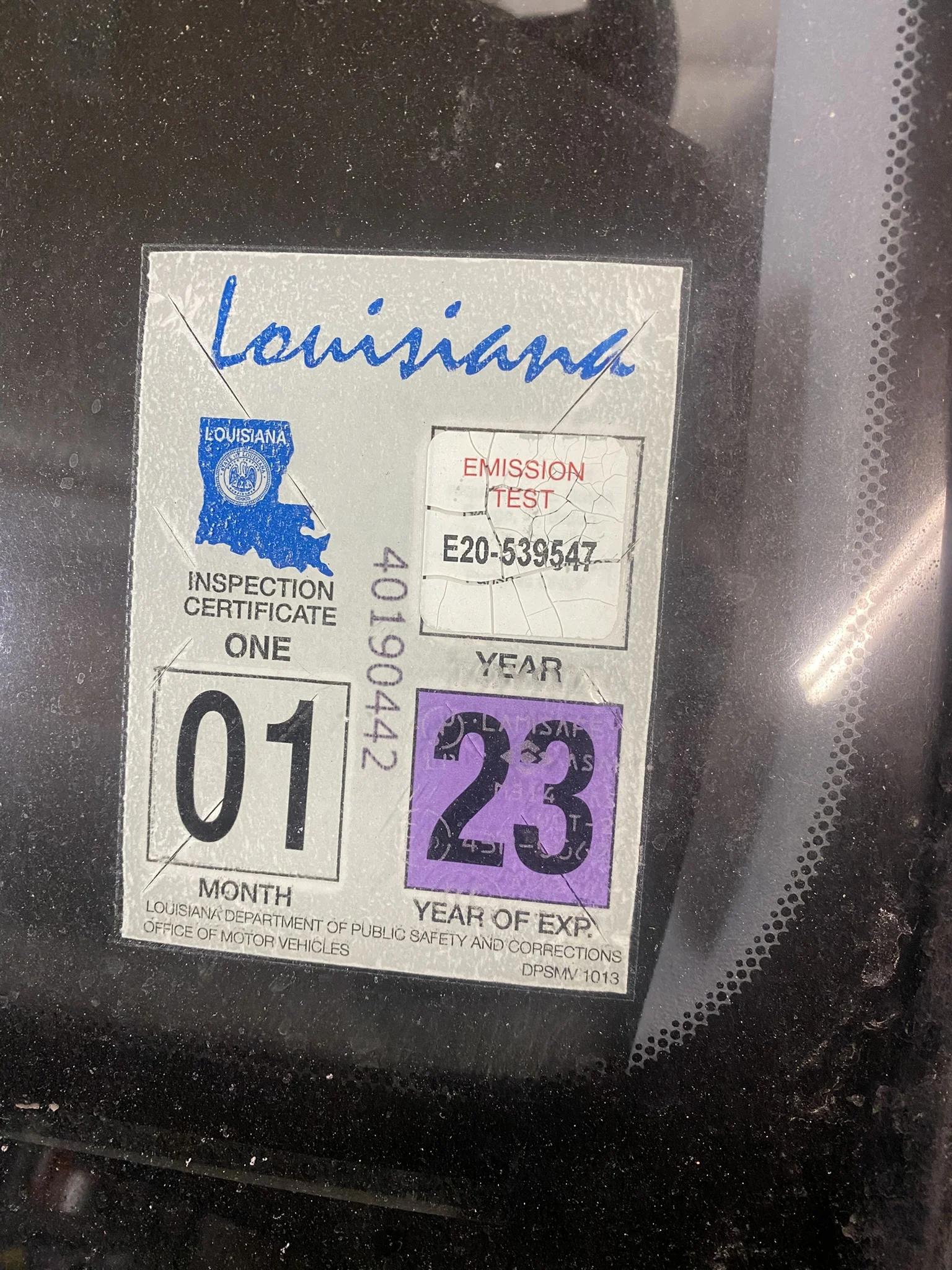

DTC of RR wheel speed sensor, cleared did not come back.
Fail emission test, pass a few days later.
ABS lights and alarms, coming and going. Note: Mechanic stated needs driven more.
Pictures in BAT, most very good. But some of undercarriage glare made impossible to see if rust issue. Asked for more pictures, due to rust concerns. That glare in some may have hidden. No more pictures given. Reson: Not enough time to get pictures, due to time and distance before end of bidding.

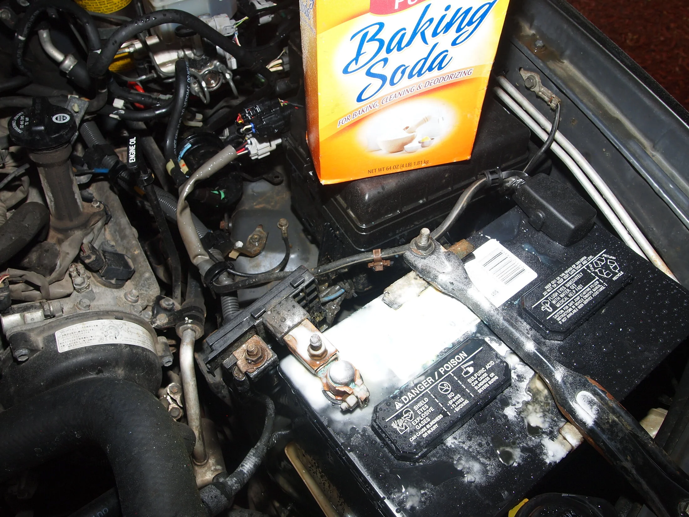

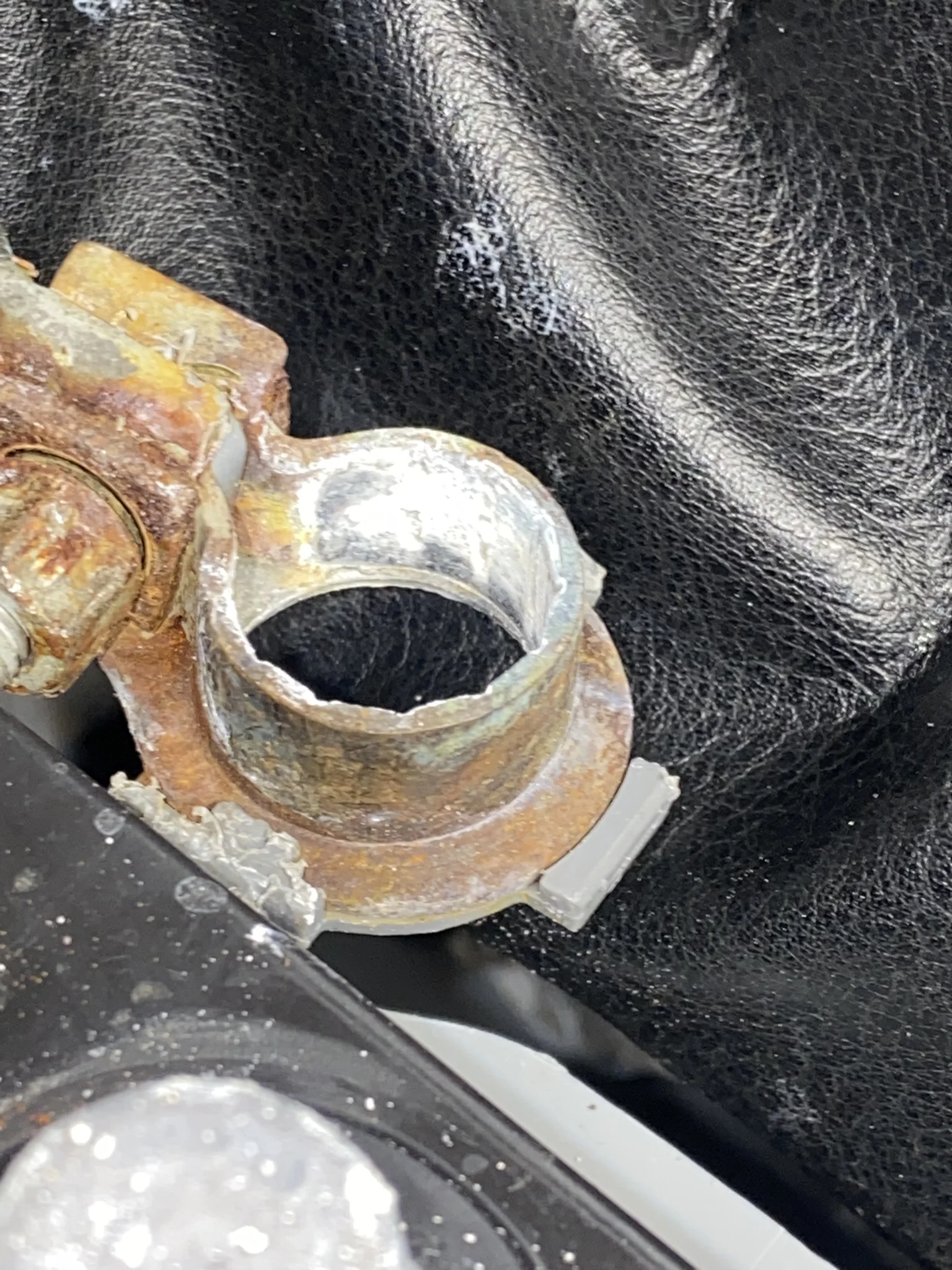

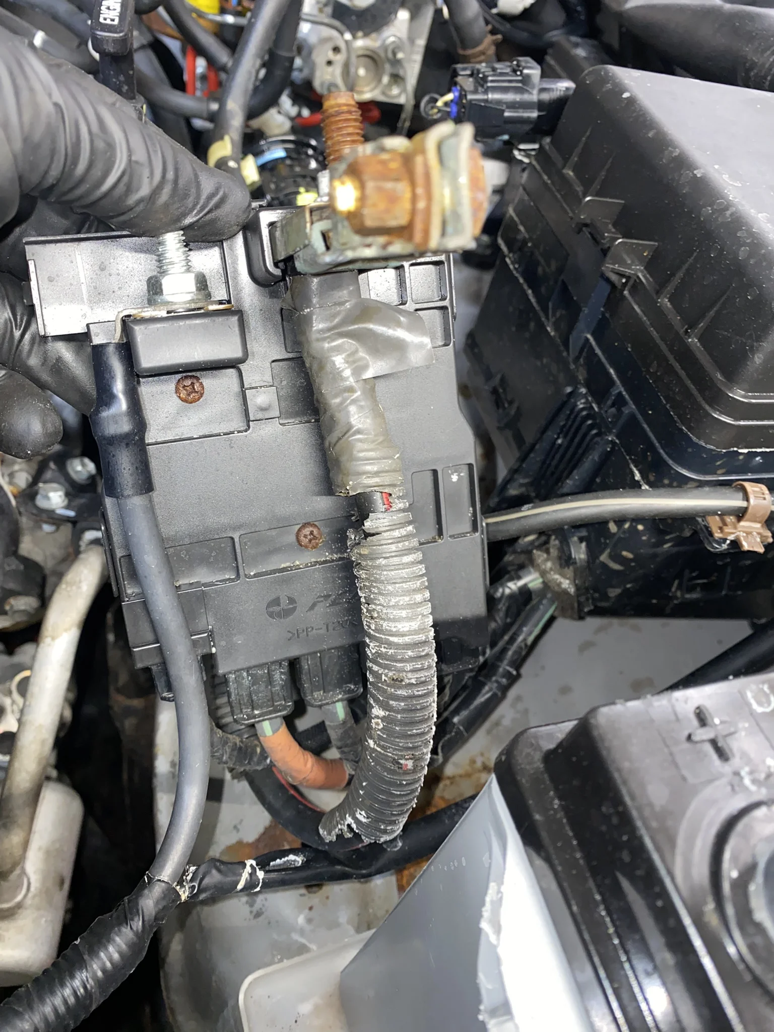

  • Battery issue. Battery was replaced, but even the new weaken (sulfated). Indicating not being keep fully charged. Very common if just sets month at a time.

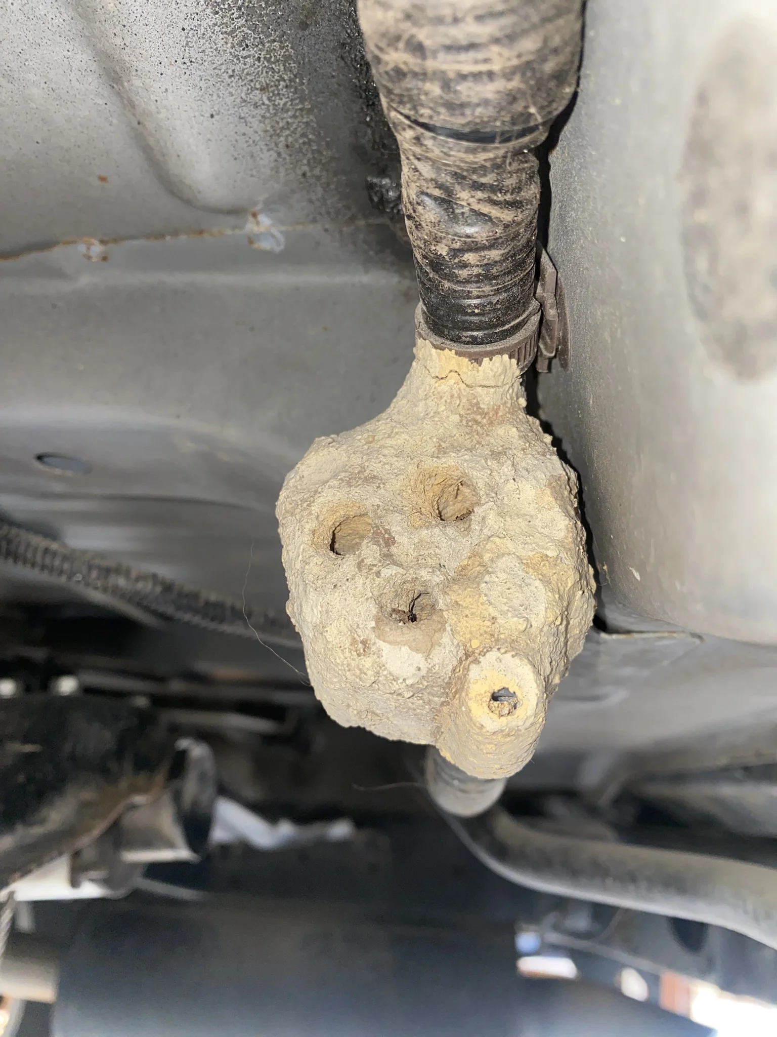

  2. Wildlife. Got lucky here, in not have rodents nest with a tons of chewed wires! But some wildlife was nesting. Some spooked me and some areas still a concern. More on this later.

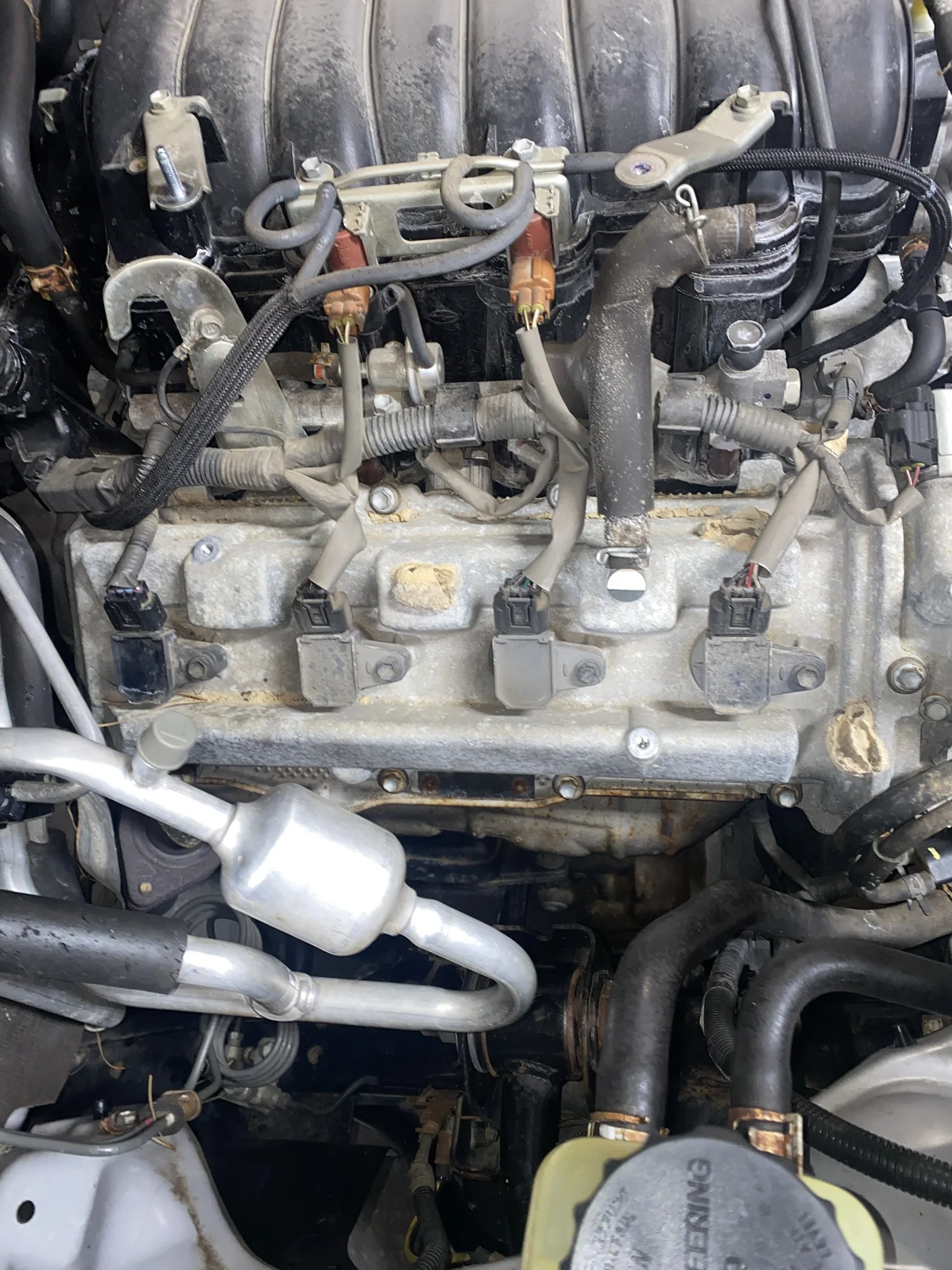

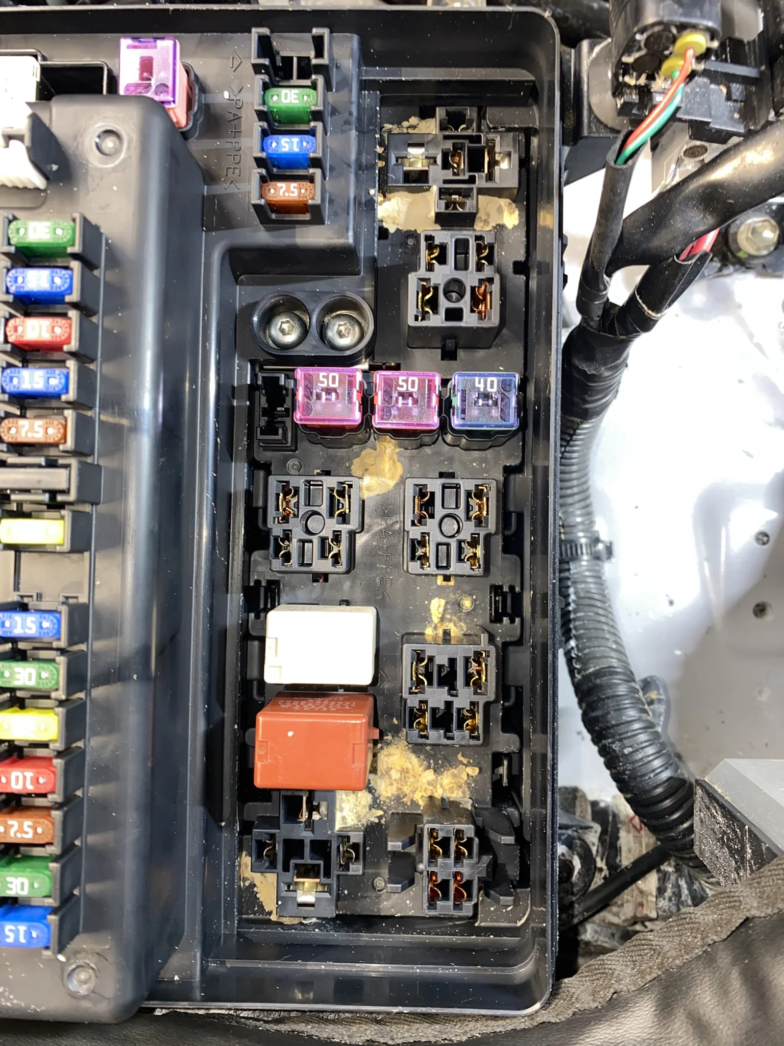

  • Foam rubber, was/is disintegrating like sand, when touched. Big surprise and a bit of a revelation. This would have nothing to due with being parked for prolonged periods. It would have to be Environmental and may indicate not garage kept. It not what we see in my region (Colo). So was not expected at all by me.

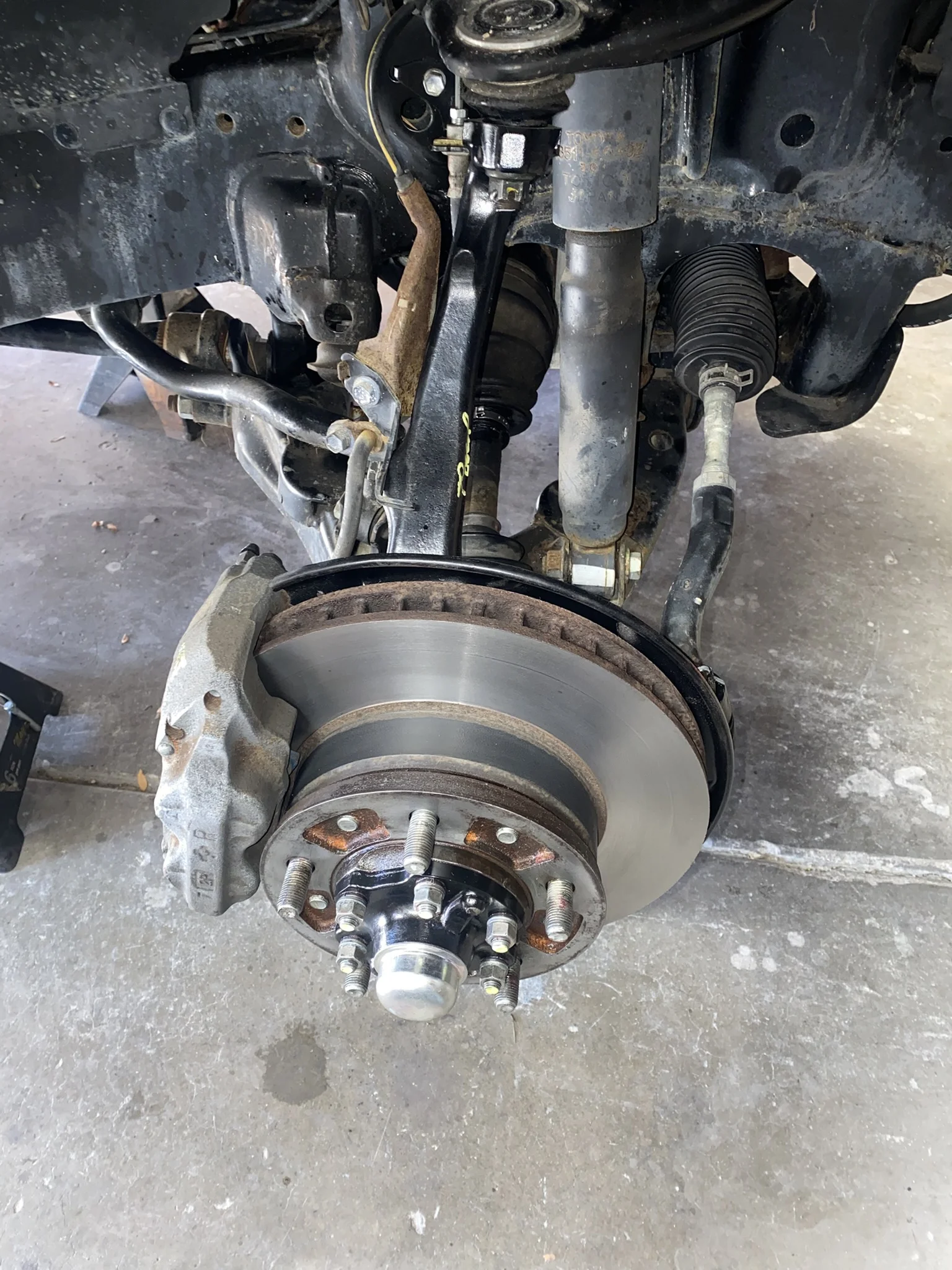

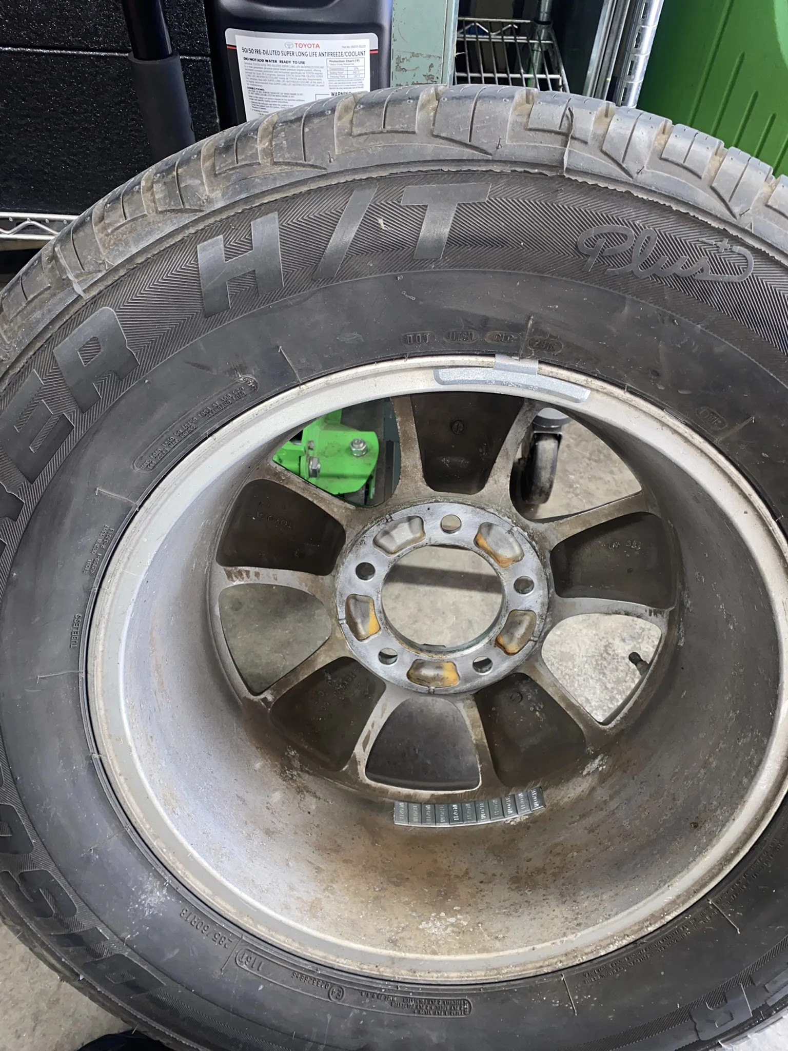

Improper PM, Hands that touch (service), not reading/following owners manual (OM) "Do Not OVERFILL Fuel Tank":

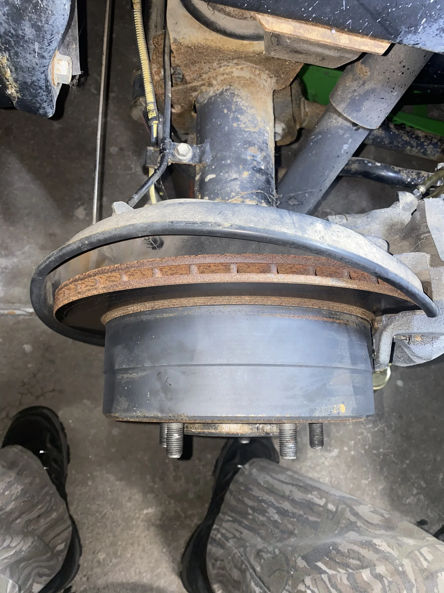

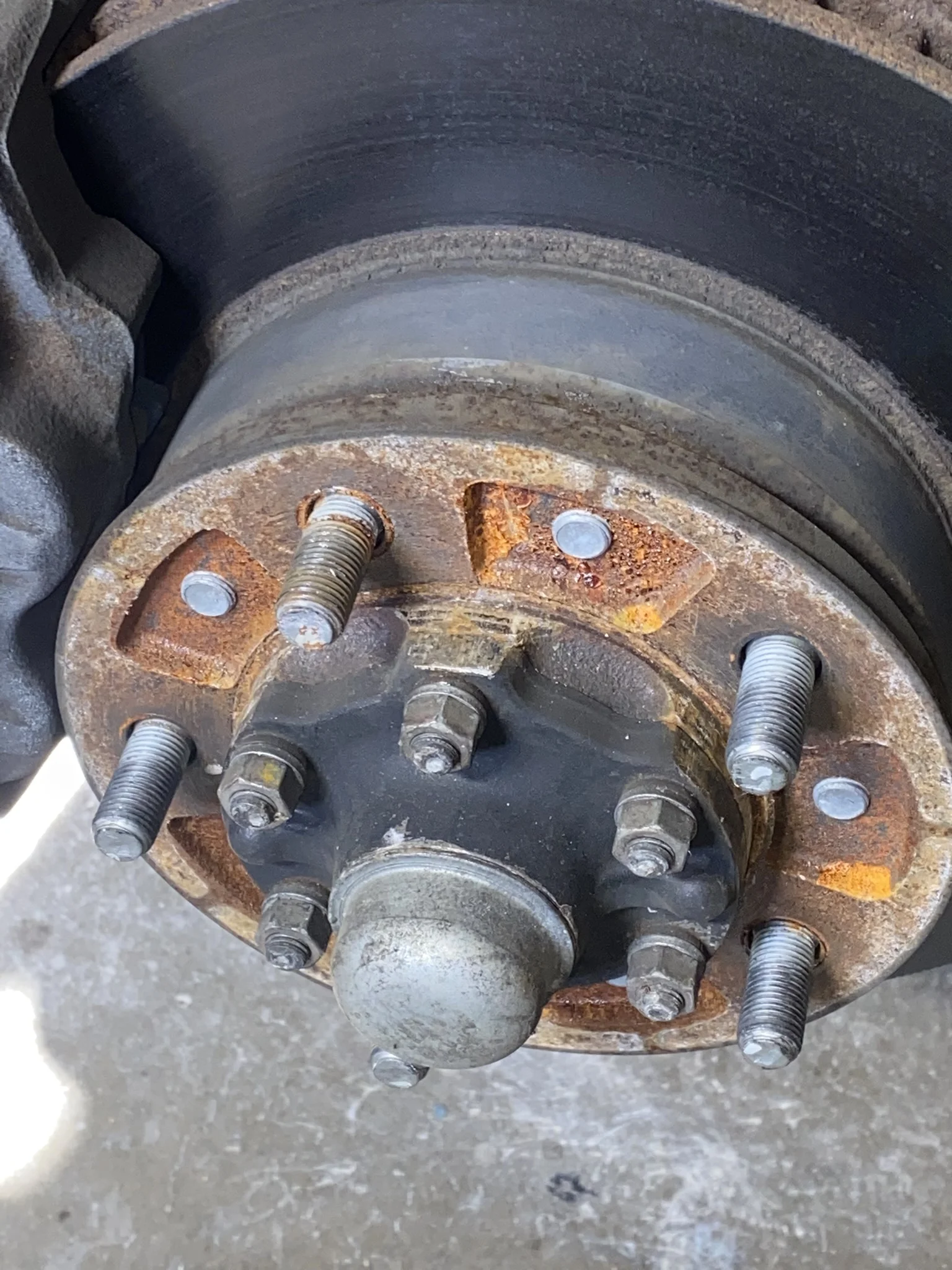

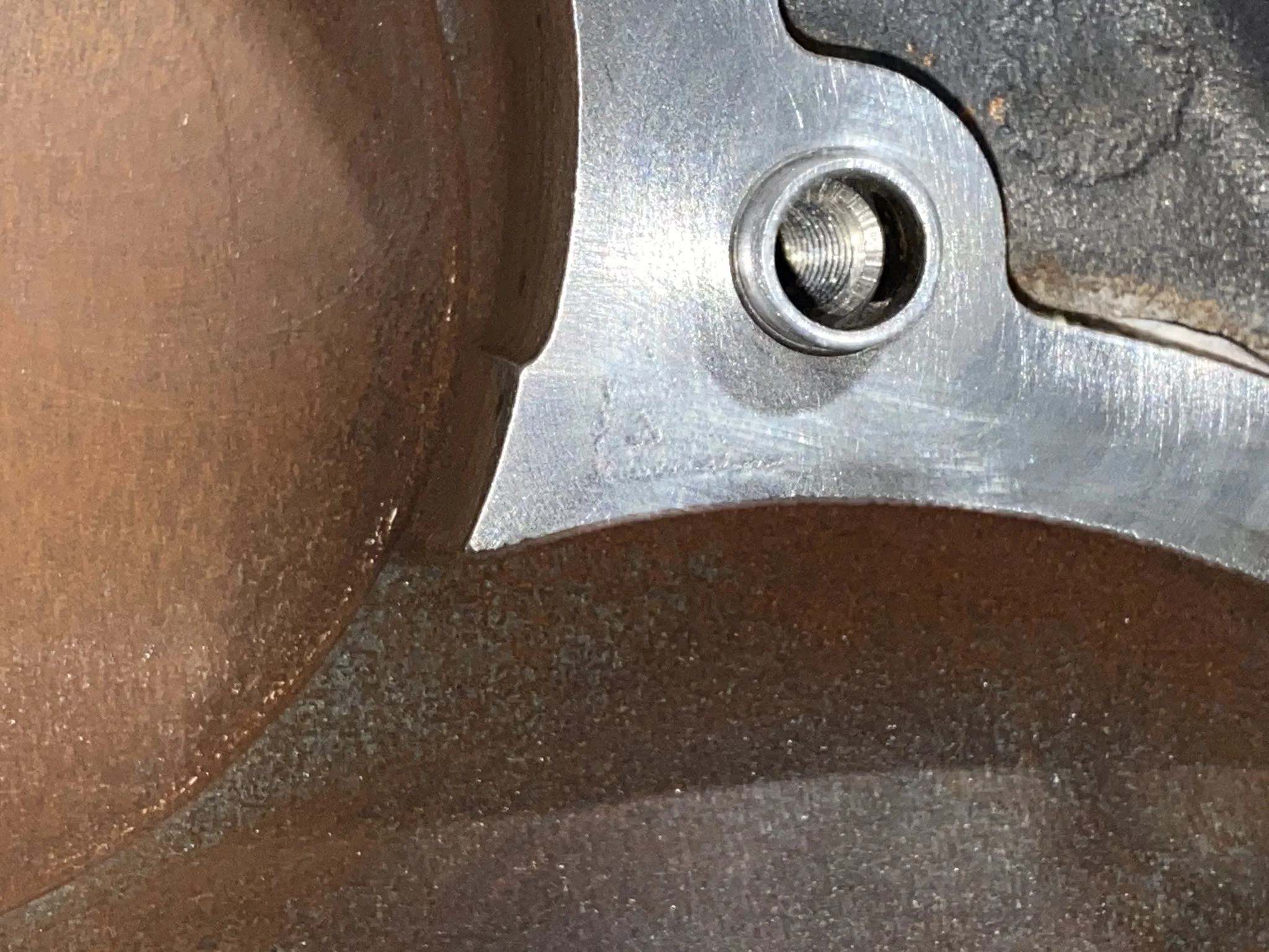

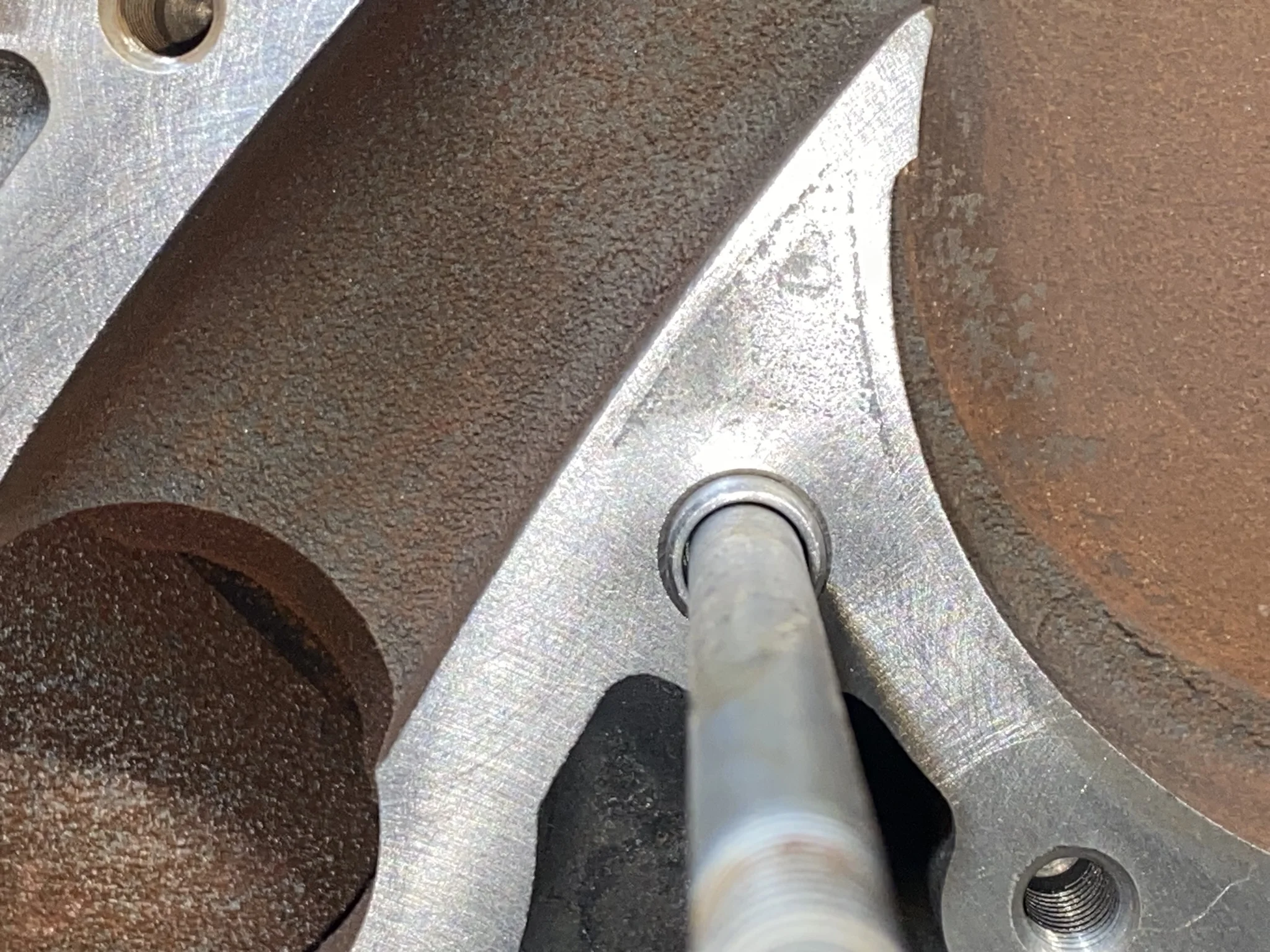

  1. These turned out to be the biggest surprise and issue to correct. Not all what I thought I'd find at 24K miles and based on history at Toyota & carfax and seller statement & pictures.

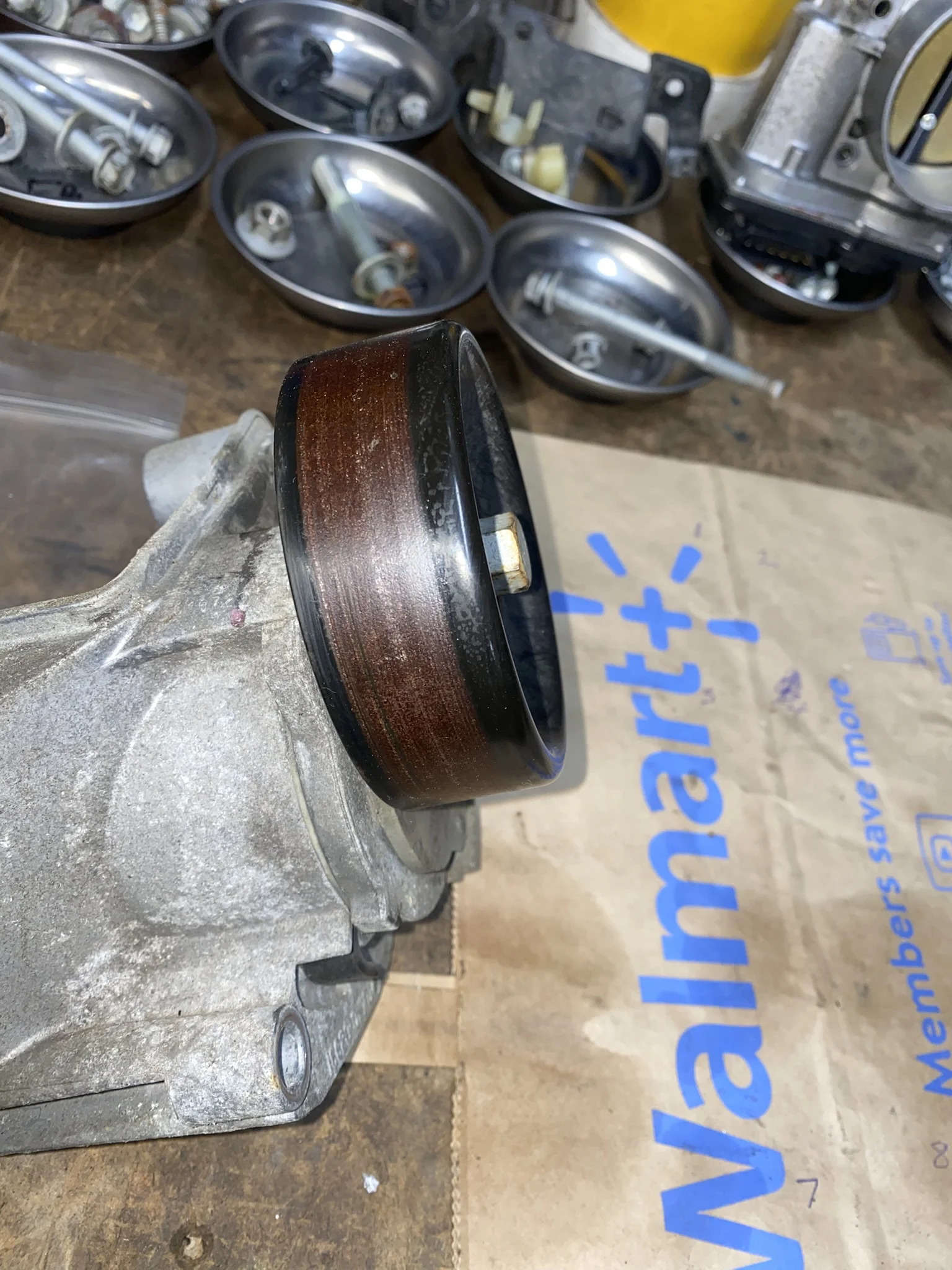

  2. Wheel bearing shot.
  3. Contamination under hub flange grease cap.
  4. Axle snap ring groove damage, of FDS.
  5. Hub flange and hub damage
  6. A/T fluid over filled 1 1/2 qt.

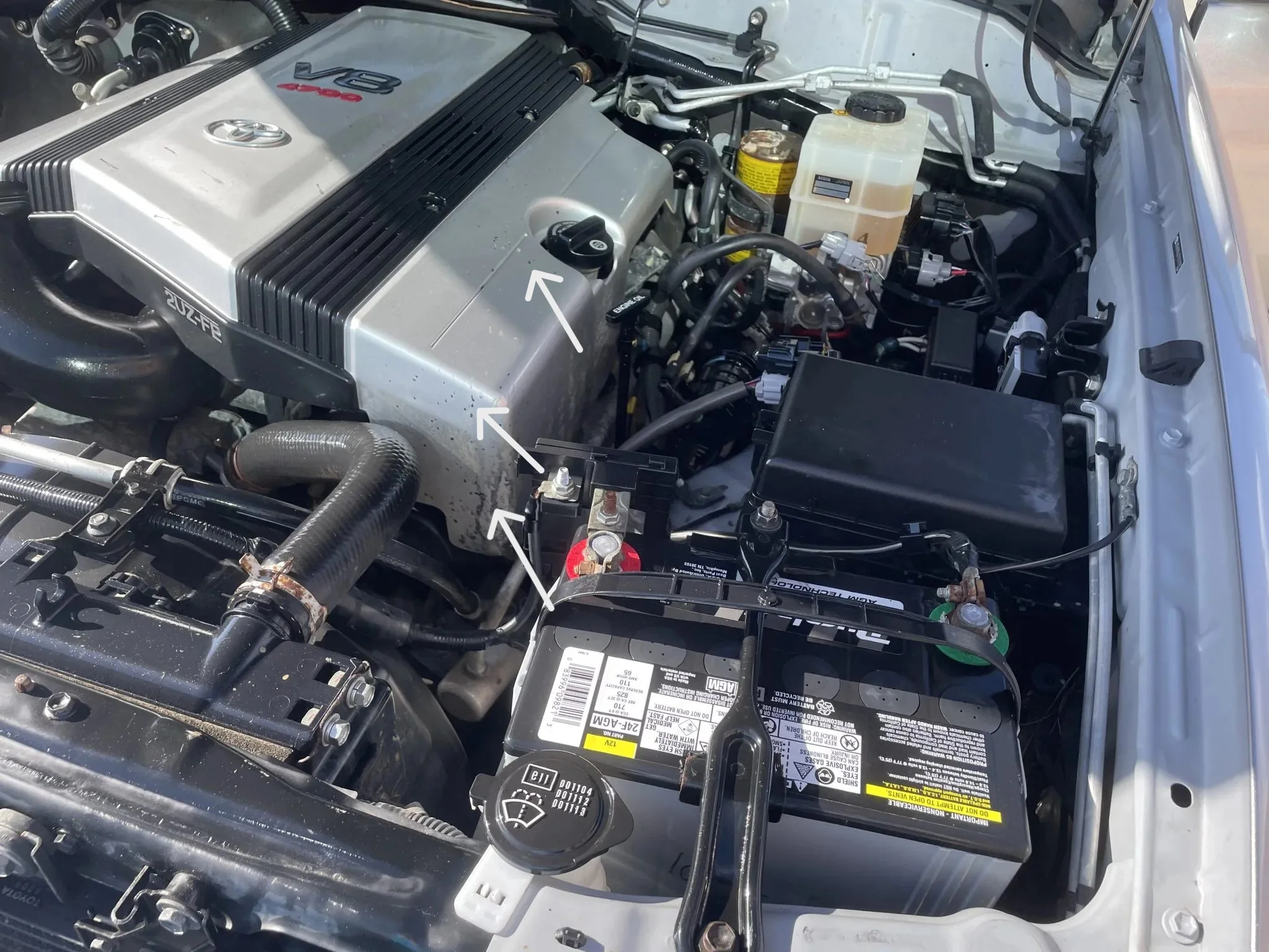

  7. Battery acid damage.
  8. Rotora excessively machined down.
  9. ABS issue.
  10. Plastic clips
  11. Under carriage bolts and hatches
  12. Tire/wh balance.
  13. Wheel lugs.
  14. Charcoal Canister.
  15. Propeller shaft & spider lube.
  16. Oil in engine to long.

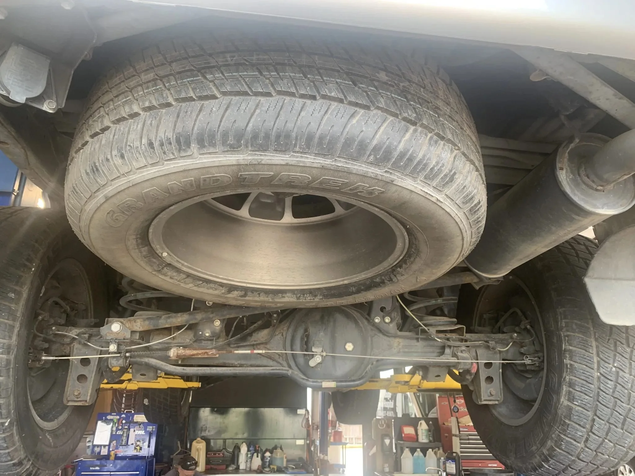

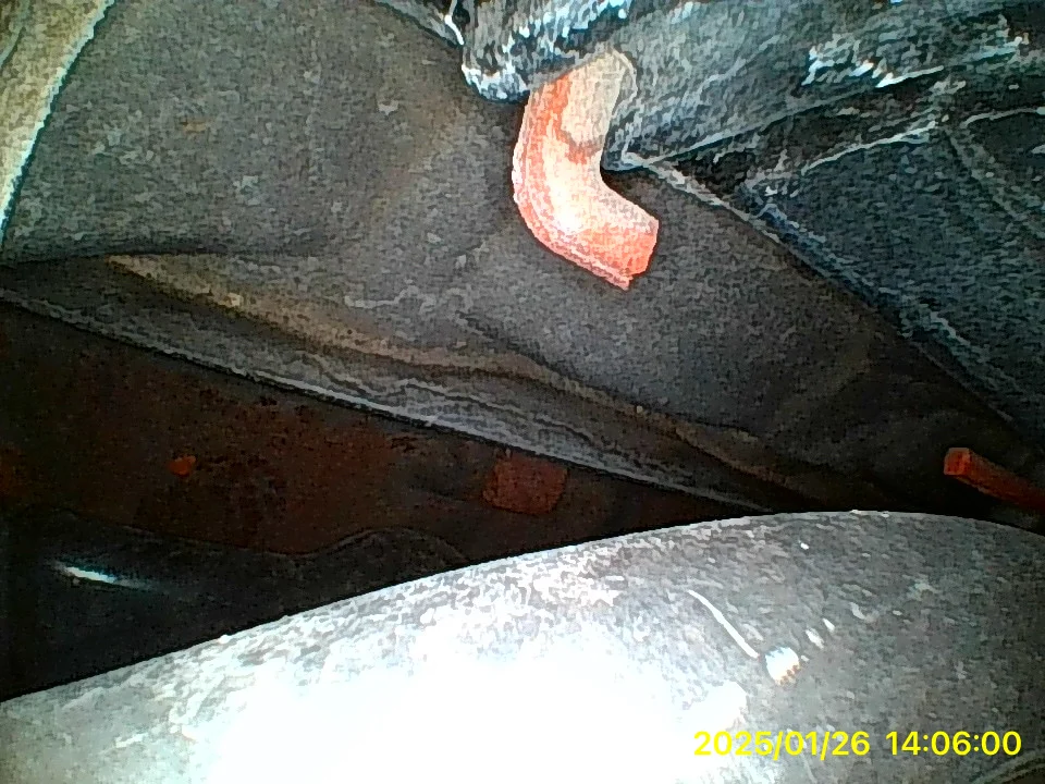

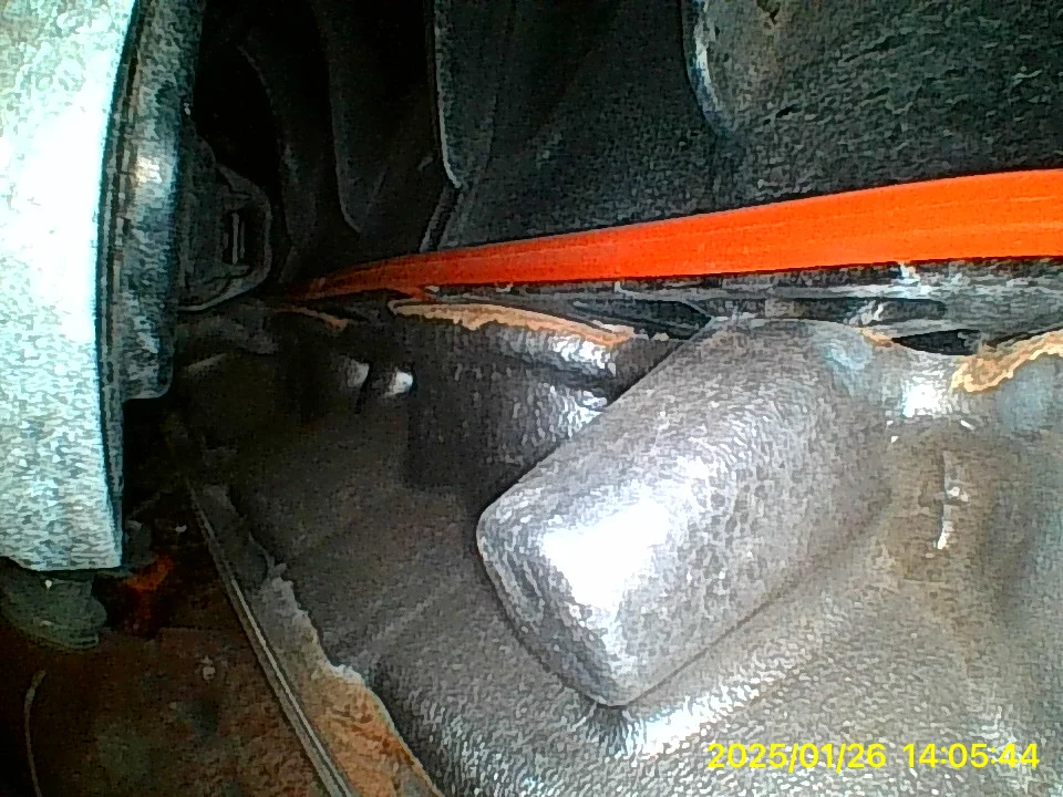

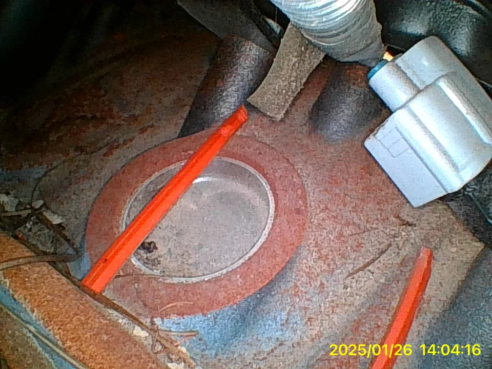

I had, ask for more pic, as was unclear as to how much rust. I felt picture were a bit to selective, in not revealing.
It's not bad, kind of spotty rust & crud. Some areas showroom fresh others bit nasty, but should clean up nice if time put into the spoty areas.

This CC was very bad. So seems overfilled, was done and done very often in it's est. ~80 fill ups.
Seems got lucky, on this one. Found and caught one mouse, that must have hitch a ride in transport. So far, I only found minor chew damage. Intake manifold gasket.
It's just the rubber that hold the individual port gaskets on a string.

Chassis, is spotty. Likely, driven in puddles of salt water, on road at/near Gulf. Some may have been from, drive rain, where parked. Undercarriage likely, as most, near washed.
Headlight plastic foggy. Likely where parked caused.

Engine cover, has acid burns. Indicating battery had acid corrosion build up. As such, likely battery voltage and resistance issues downstream.
The BAT pictures showed what, I noted as acid burns. Seller explained as oil: "Thank you again. The engine cover is not scratched up. There was some oil spilled during an oil change and it was never cleaned by the dealer." Which was likely an honest opinion, but wrong:
We must never just wash off acid, with only water even soapy water. Doing so spreads the acid, which eats into paint and metals.
It was acid burns on the engine cover and around battery on other areas body under the hood. Indicate acid washed from battery, without neutralizing first. It also tells us. A lot of acid build up over time. Which will create issue with; charging, low voltage and amperage.
As acid builds up on top of battery, it can get rather bad. The acid damage/burns indicate, battery not properly care for. This acid works it way into battery clamp, fusible link and wire contacts. Which it did in this case.

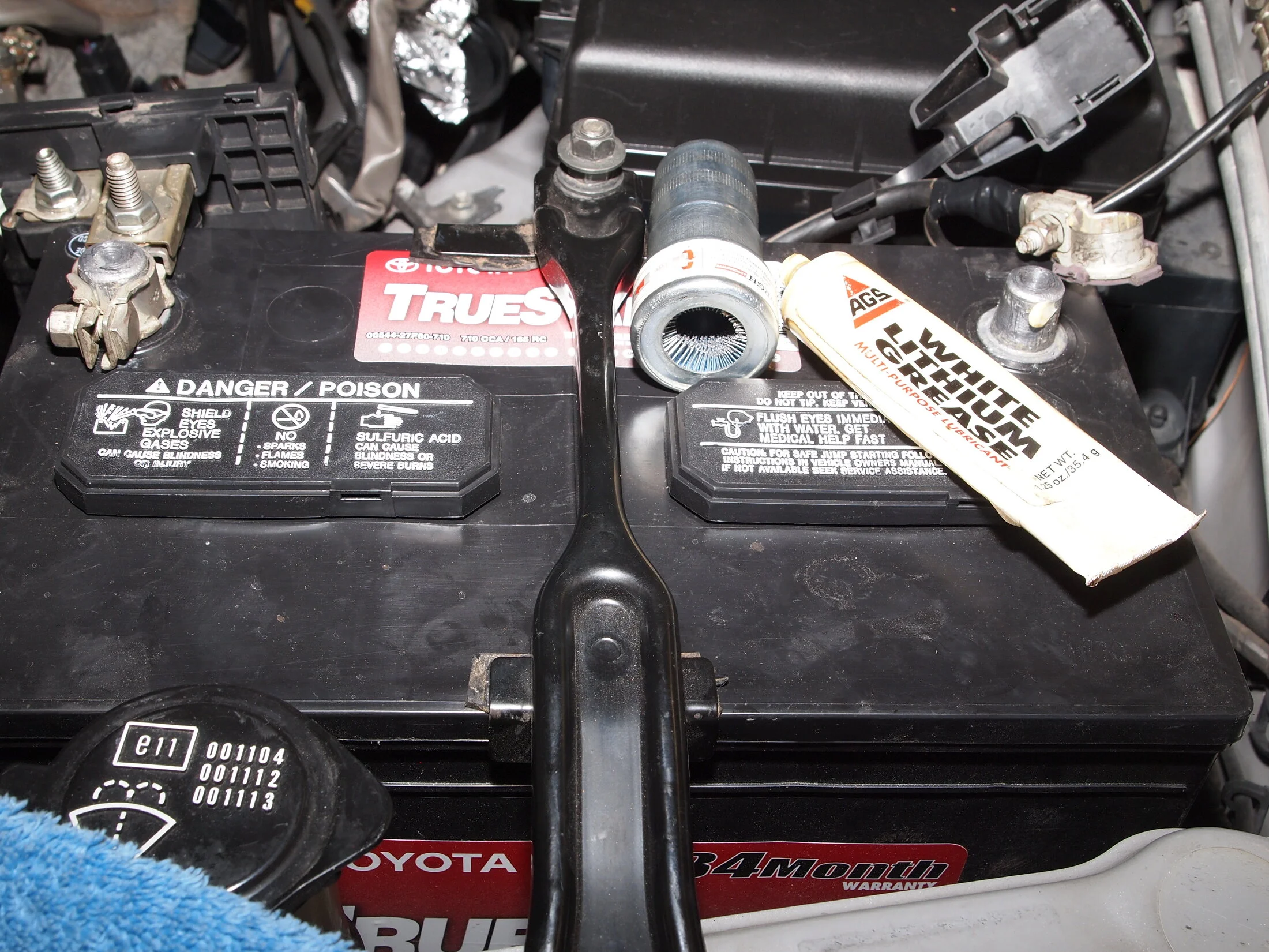

We must use, baking soda and water solution to neutralize the acid. Then clean battery post & clamps.
Oxidation between battery post & clamps, inhibits current. I use white lithium grease on clean battery post and clamps to keep oxidation at bay.

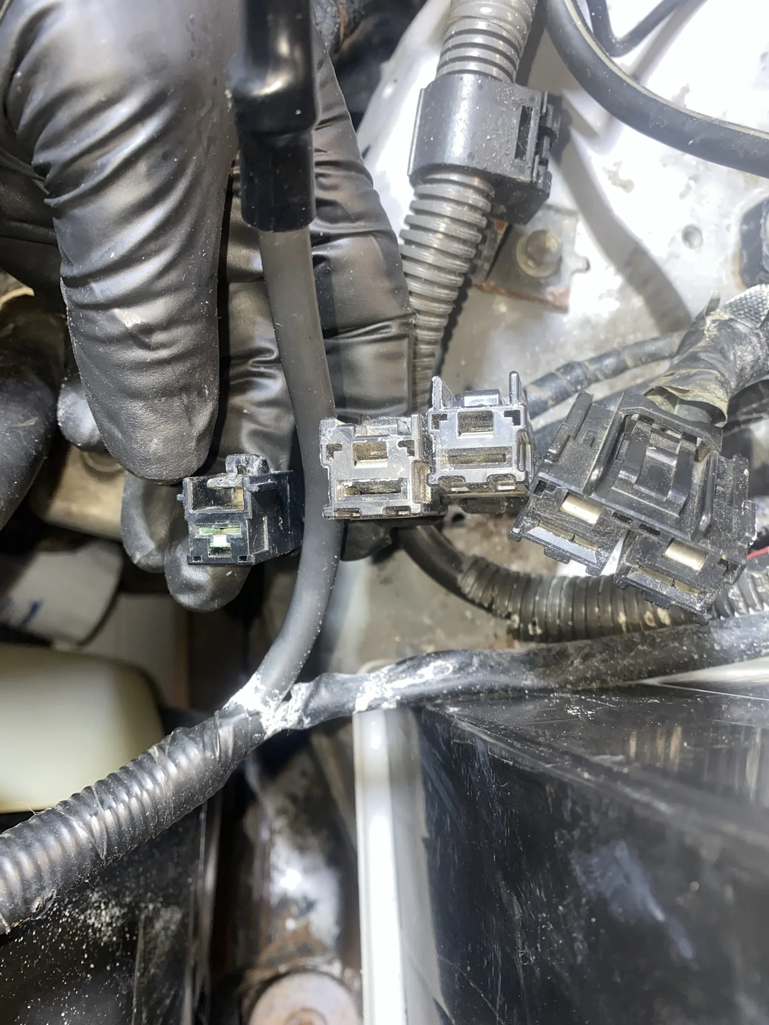

Found acid had gotten into fusible link, hung off battery:
The acid results in corrosive build up between connection and the corrosion inhibiting the current flow. This increase resistance in electrical wiring that delivers current to fuse box and on all down streams points current passes through and to. It is damaging. For example; Like running a leaf blower, drill, vacuum, etc, on a long extension cord of too small a wire gauge to carry proper amperages. It can burn-up their motors. One can feel the increase heat from resistance, in wire, by touching wire. It can also affect relays, contacts, and even the computers.
Replacing positive battery clamp, fusible link and one wire housing. As well as cleaning wire lugs/leeds/clamps. Help reduce ABS alarm frequency, even more than just a good fully charged battery did.

I'm "guessing", the black on rotors is/was from braking on rusty rotors. Indicating vehicle sat for prolonged periods, allowing rust to build-up.
I found the rotors black and variation in thickness between inner & outer disk surfaces (out of parallelism).
I'm "guessing", the black was from braking on rusty rotors.
Which if black iron of rust deposits, is sign vehicle parked extended period. Since mild rust (few weeks of sitting), wears off while braking fast and rotors are shin-up quickly. Letting wet rotors disk sit longer periods, without driving. Rust can get thick and unevenly deposited on disks. Then braking may not clean off to a shinny look, and surface gets uneven deposits. Which means runout goes out of spec. Perhaps the strange garb of with lite braking, was related to the blacken surface of disk. So use OTV brake lathe to clean and turn rotors disk.
Stock video on file, not actually this 100 series.
Rotor disk, after being machined with OTV lathe.
Hub and wheels deglaze/rust. Which is so runout of wheel hub, transfer through to wheel and tire.
Interesting, I found the front rotor disk at 31.08 down from std 32mm thick when new. After turning, they're now down to 30.65mm (minimum allowable 30mm).
So they will not likely be turnable again. That means these rotors have been on a lathe once or twice before. Either a deep cut of ~.0.90mm, or cut twice ~.45mm. Possible correcting disk runout due to rust. And or trying to correct ABS Alarm issue. What was interesting. I see signs pads also replaced. The rears shim kit and wear indicator, install same as I do and I have written about in mud.
If we take seller statement of how driven. Which HWY driving, typically very little braking for the miles. It is strange, to see new pads at 24K miles. So it does point to chasing braking issues and rusty rotor disk. Or, something wrong with sellers story!

Pulling relays, I found even more clay under them. It was unclear if mud deposited from top or perhaps oozing up from being inject from within seal underside area.

So I became concerned, clay in fuse box. May be affecting voltage or resistance of current to brake master. I ended up drilling a hole into side of fuse box, to get a peak with borescope at sealed underside. Where I did find more tan clay. So ordered a fuse box from Toyota. But once looking over the new fuse box, and how constructed. I had less concerned clay was the current issues. I went back into fuse box, looking for any signs, on male & female prongs & plugs for any clay or oxidation. Non found! Even though I still have concerns, clay in fuse box, may one day result in issue. At this point. I felt power from fuse box to brake master, was as it should be (good and clean).

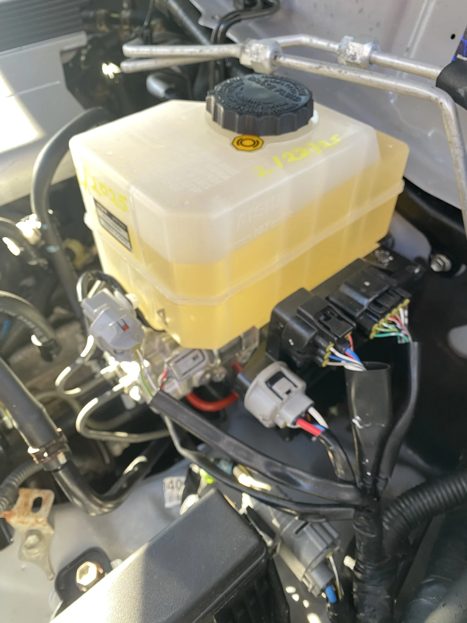

Replaced brake master:bounce2::bounce2::bounce2:
Slightly low battery voltage, with clean power to brake master. Pointed to brake master being finale issue. With some concern, it could be brake CPU.
Even though ABS alarm now only issue, with slightly low battery voltage. And only first few minutes into a drive. It is, issue with the most important control of vehicle. Its braking a traction control.
So next ups, which was actually one of the first thoughts we may end up needing. Brake master was replaced.
This was final piece of puzzle. Now even if battery drawn down to 9 volts, I could not get alarms. I've test driven ~200 miles now over 7 days, no alarms.

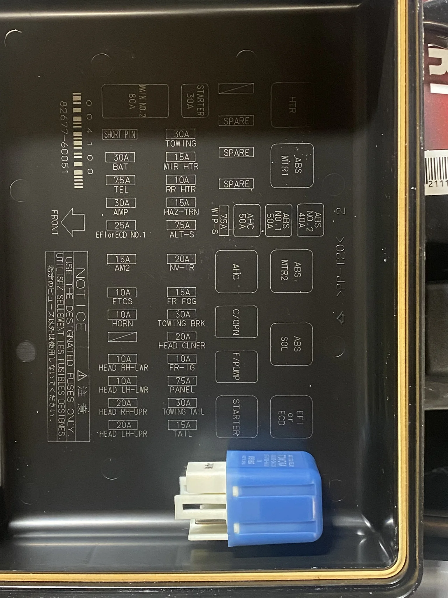

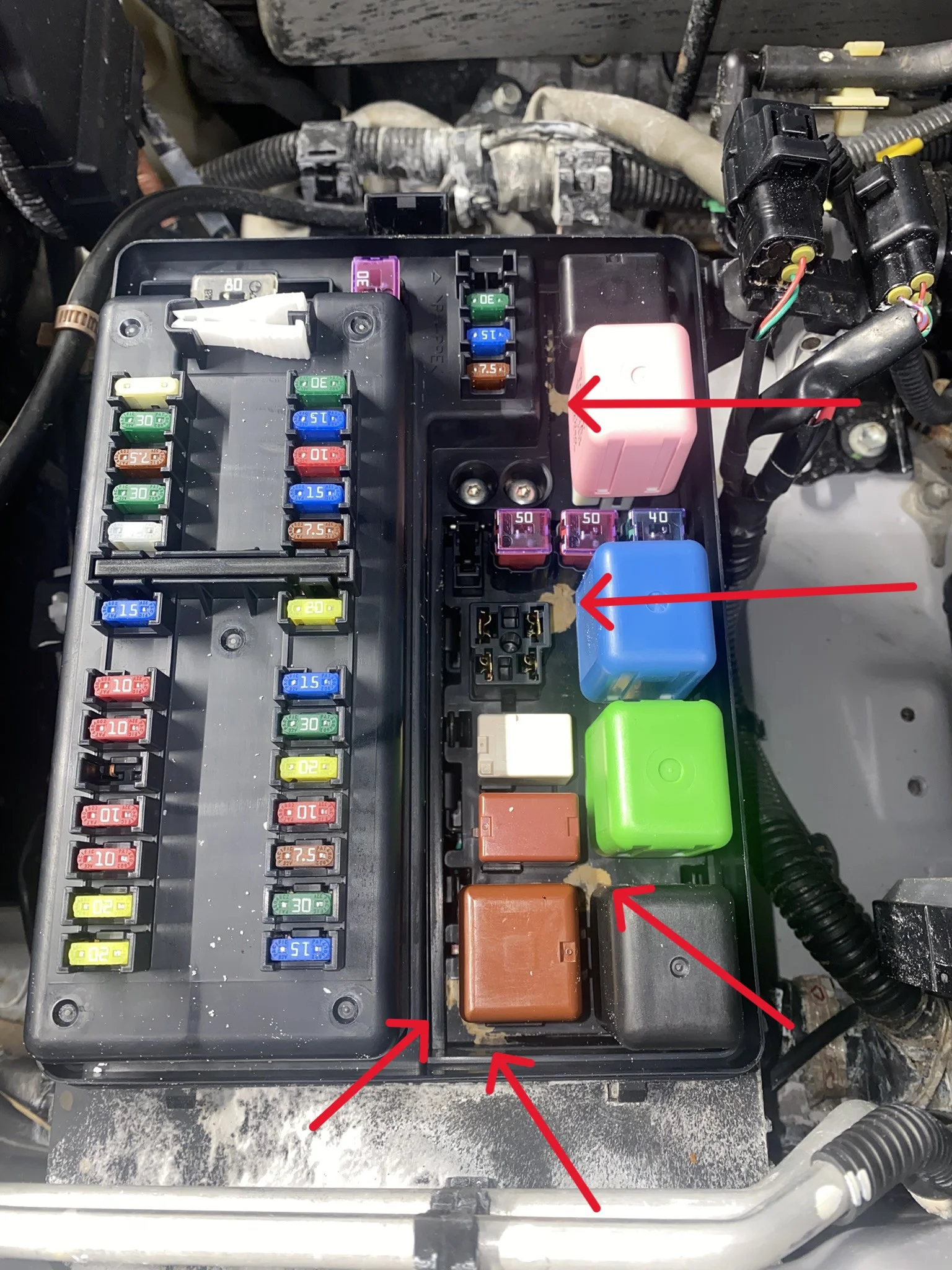

Fuse box & relays was next in power chain to brake master. So I took a closer look inside fuse box. I notice a small spots tan, in relay block inside fuse box.
I drilled a small hole into relays side of fuse box. So I could use my borescope, to look if clay in sealed area. There it was, clay in underside!
We still have some concerns, as to how deep into fuse box the clay was deposited by wildlife. That minerals in clays, may become issue in time. Damaging metal contact/leads. But It is not the ABS issue (we had) today.

My bet finale piece of puzzle, was brake master. So I replaced it. ABS and brakes have worked perfect since.
Same tan color clay, I saw from wasp nest around engine area and undercarriage. I don't know what all type of wildlife is 40 miles north of gulf coast of LA. Nor, how fast they can inhabit and build nest or deposit mud/clay. My guess, some of what I found would indicated, parked for a very long time outside.
A Wasp nest and clay deposit, found everywhere:
Had I replace the relays and brake master (includes flush & bleed) as a first step. Likely would have corrected issue in the short term. But if the battery fusible link and wire from it to fuse box. Not cleaned up. Issue would likely resurface in time in one form or another.

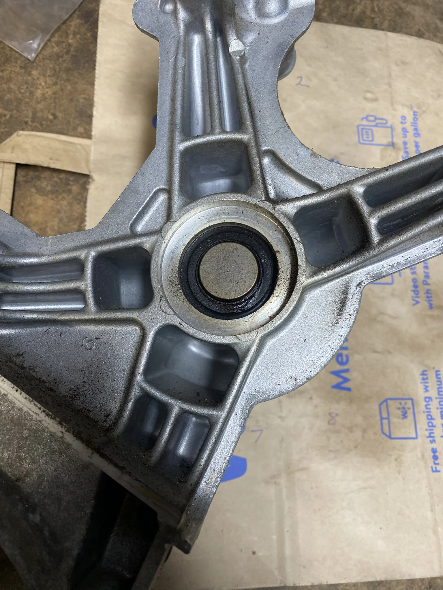

What I found while in there, was a bit surprising. In that fan bracket was bad, and fan belt tension was on its way out.
The fan bracket (FB) bearing, had a sound when spun. At first I thought my ears were deceiving me. 24K and a bearing sound. Then I saw the oil/grease, coming from rear seal of FB. I'm very tough on grading fan brackets, when doing a T-belt. Even if bearing feels/sound good. Any oil from seal, I do not reuse. This FB, was a no brainer, but surprising.
Interesting fan belt (FB) tension pulley, had thick rust. I wire brushed off rust, finding deep rust pitting in pulley. The thicker the rust, the long period the engine was not run. I replaced, the fan belt tensioner assy.

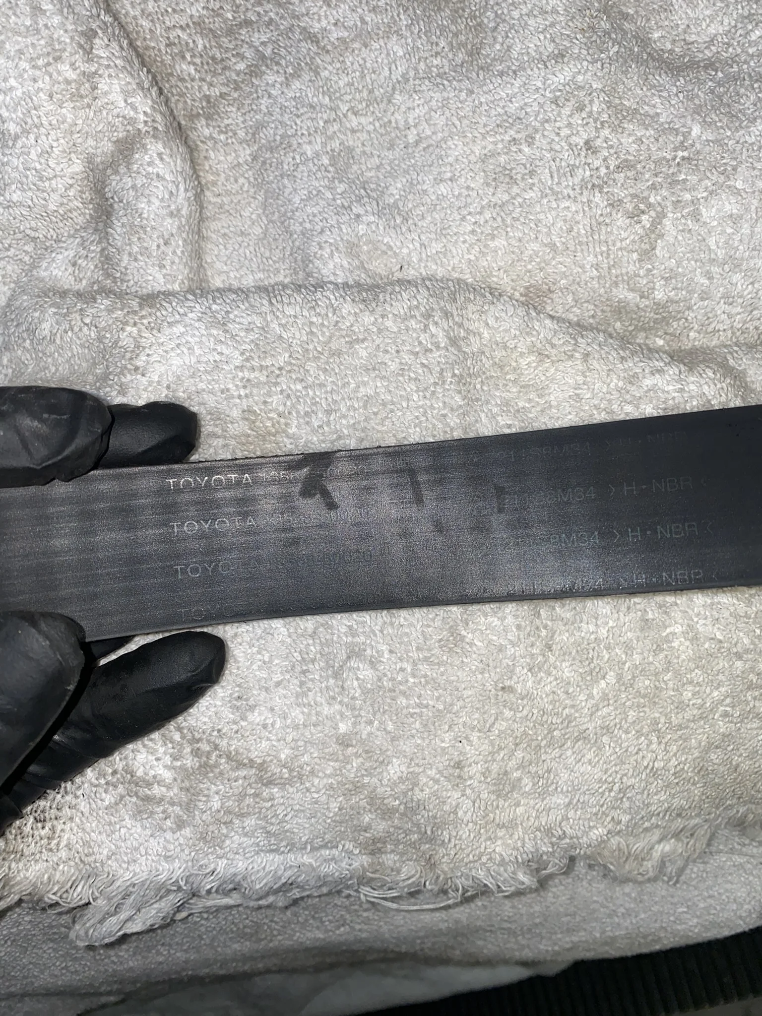

Timing belt (TB), had factory lettering still readable, but some rubber missing from outer surface. TB tensioner pulley, had some rubber stuck to it and rust. Indicating, prolong period of engine not run.
