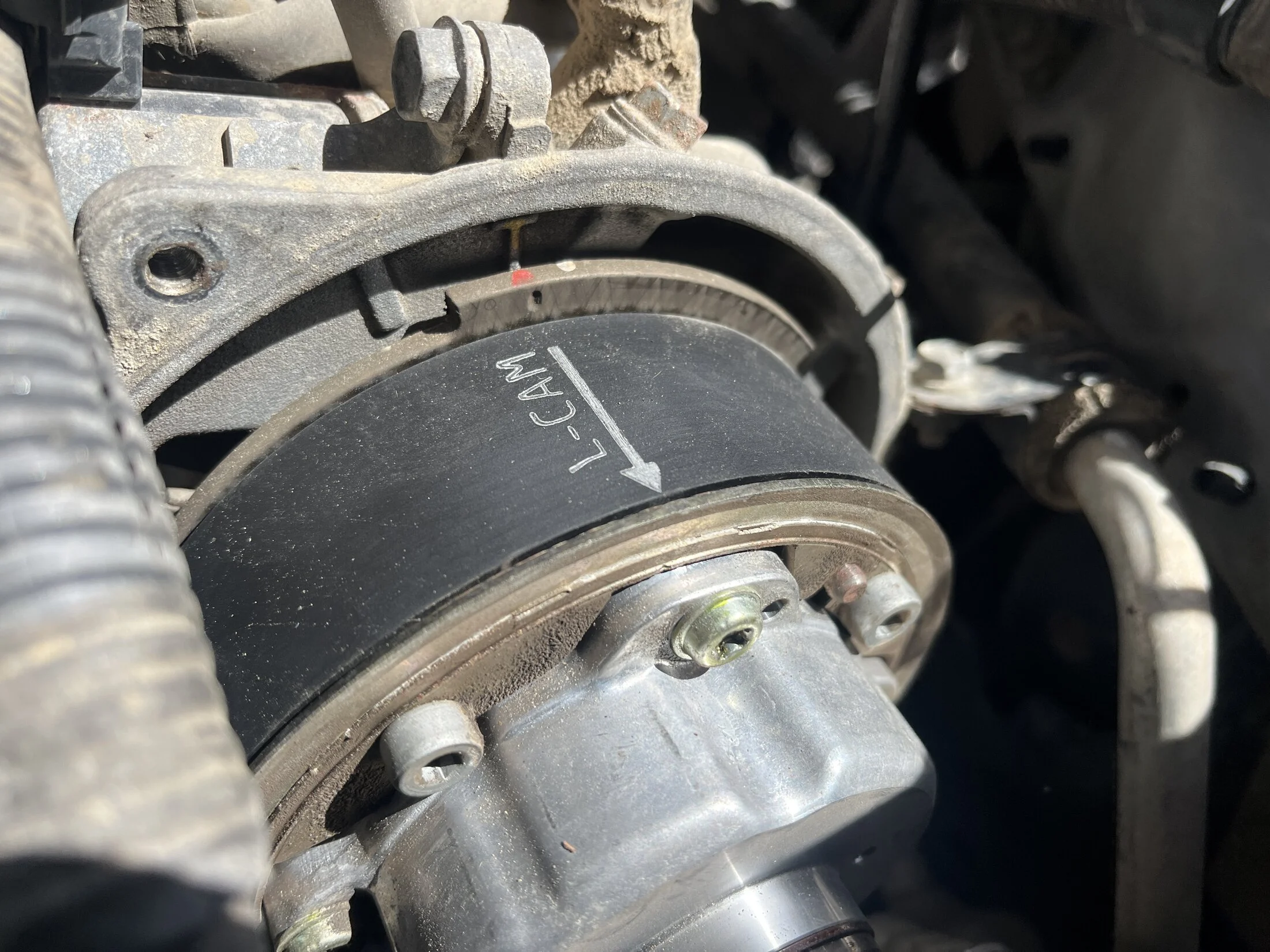

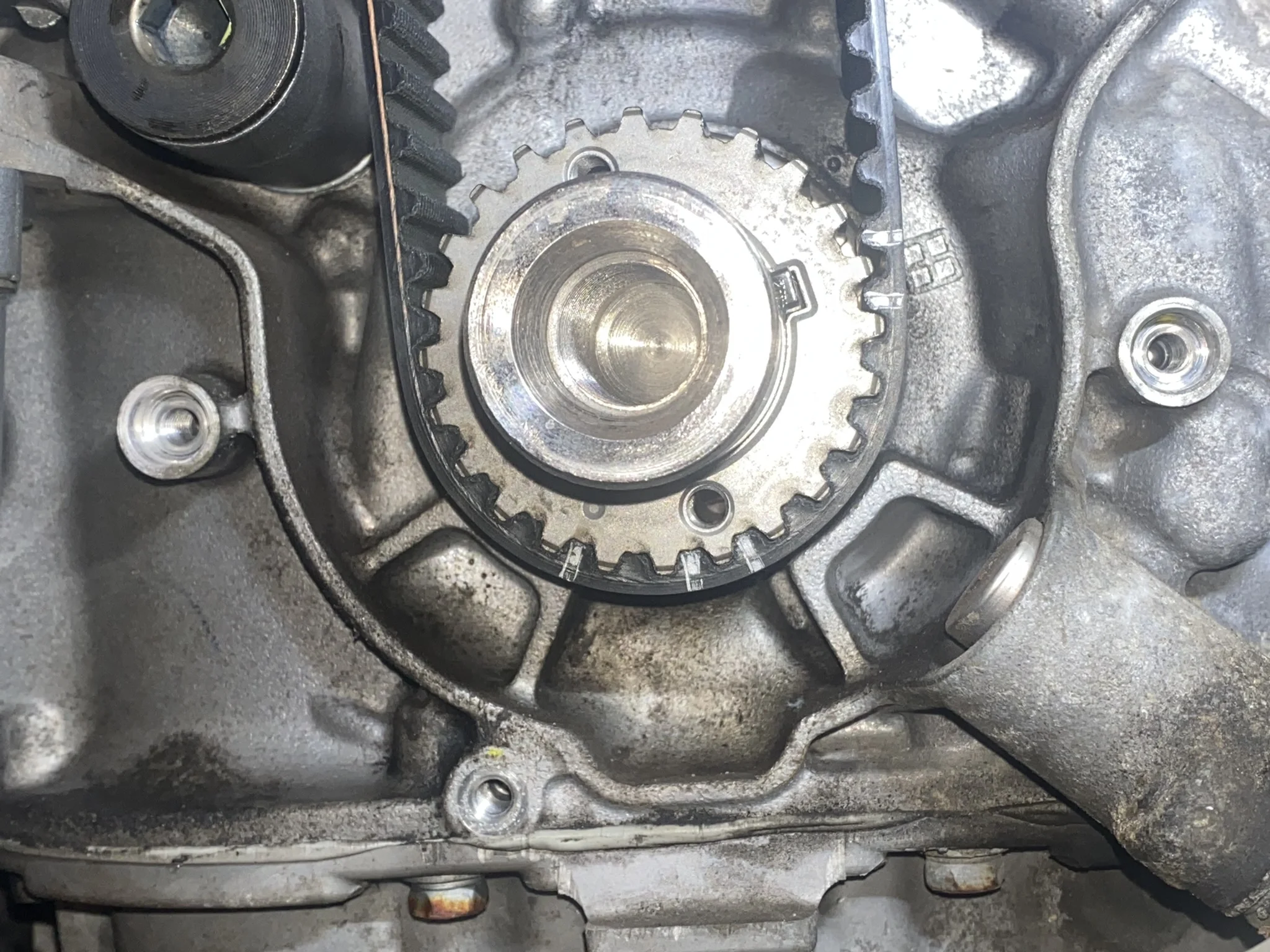

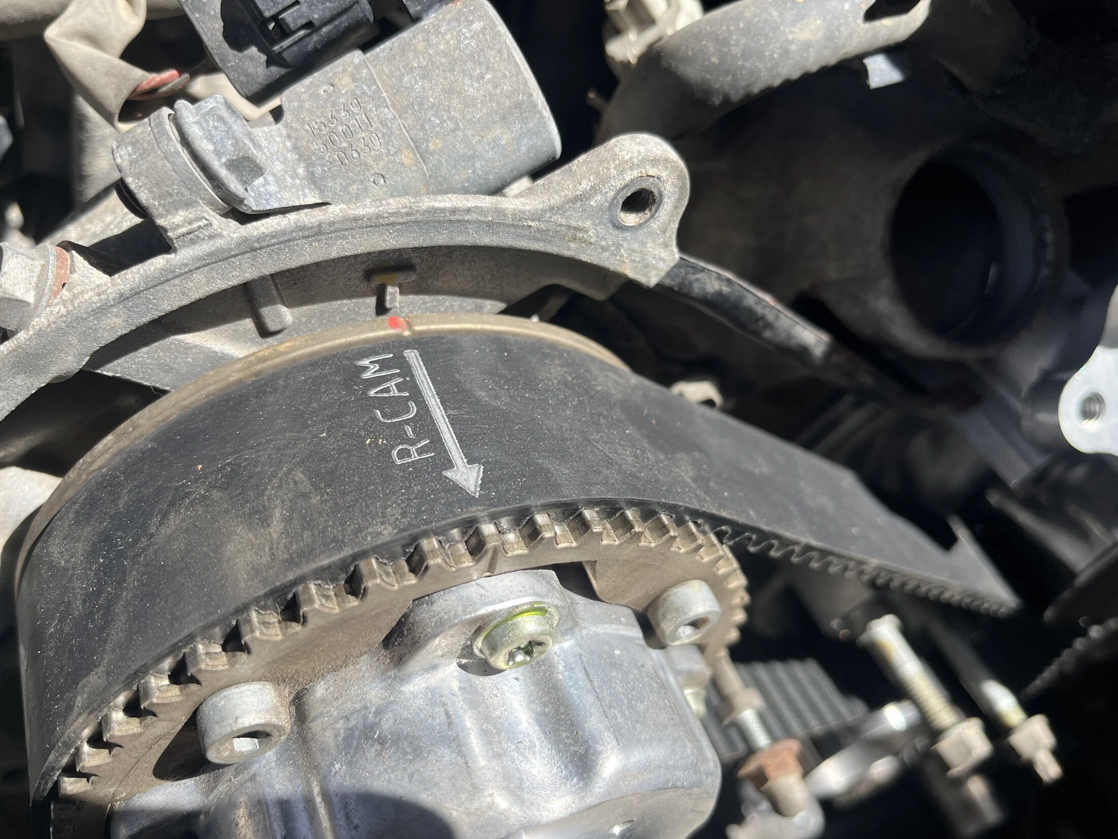

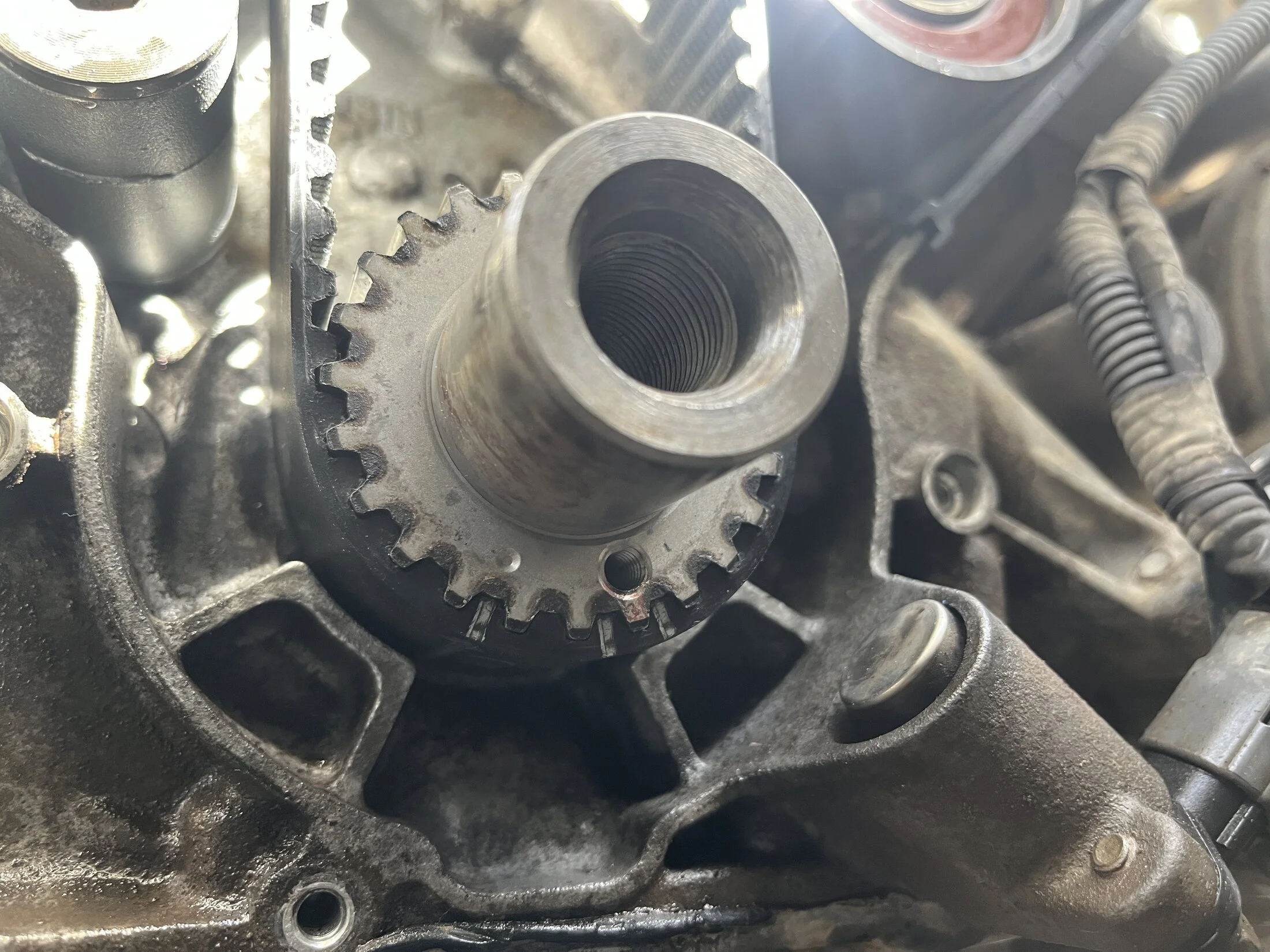

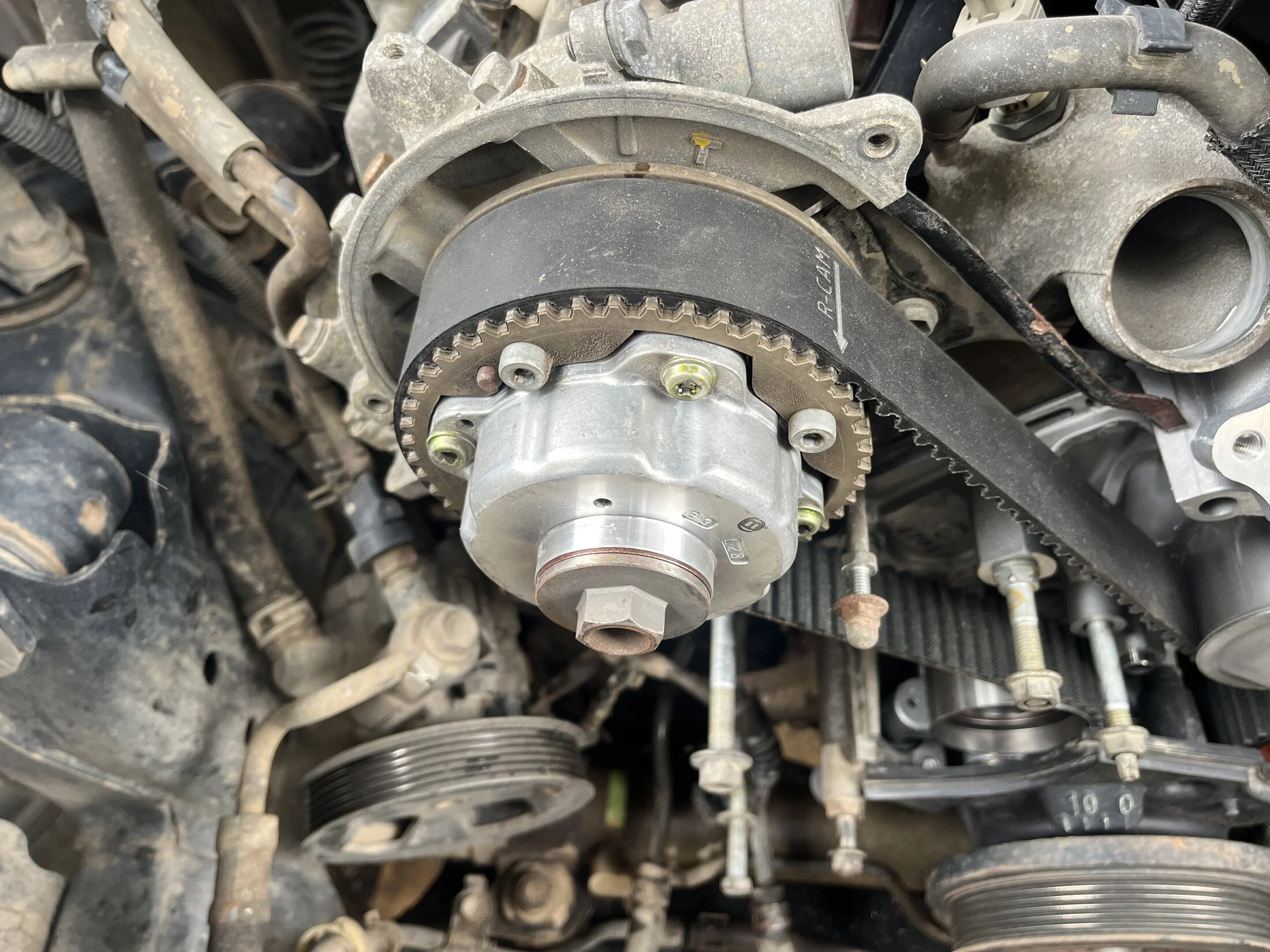

Crankshaft TB sprocket. Also had some rust & rubber stuck in teeth, I brushed out.
Assemble when smoothly. Note: Yellow paint indicate torque and done.
I'll note: I do disassemble and assemble (time), the 4.7L 2UZ-fe VVTi engine differently. Than non VVTi.

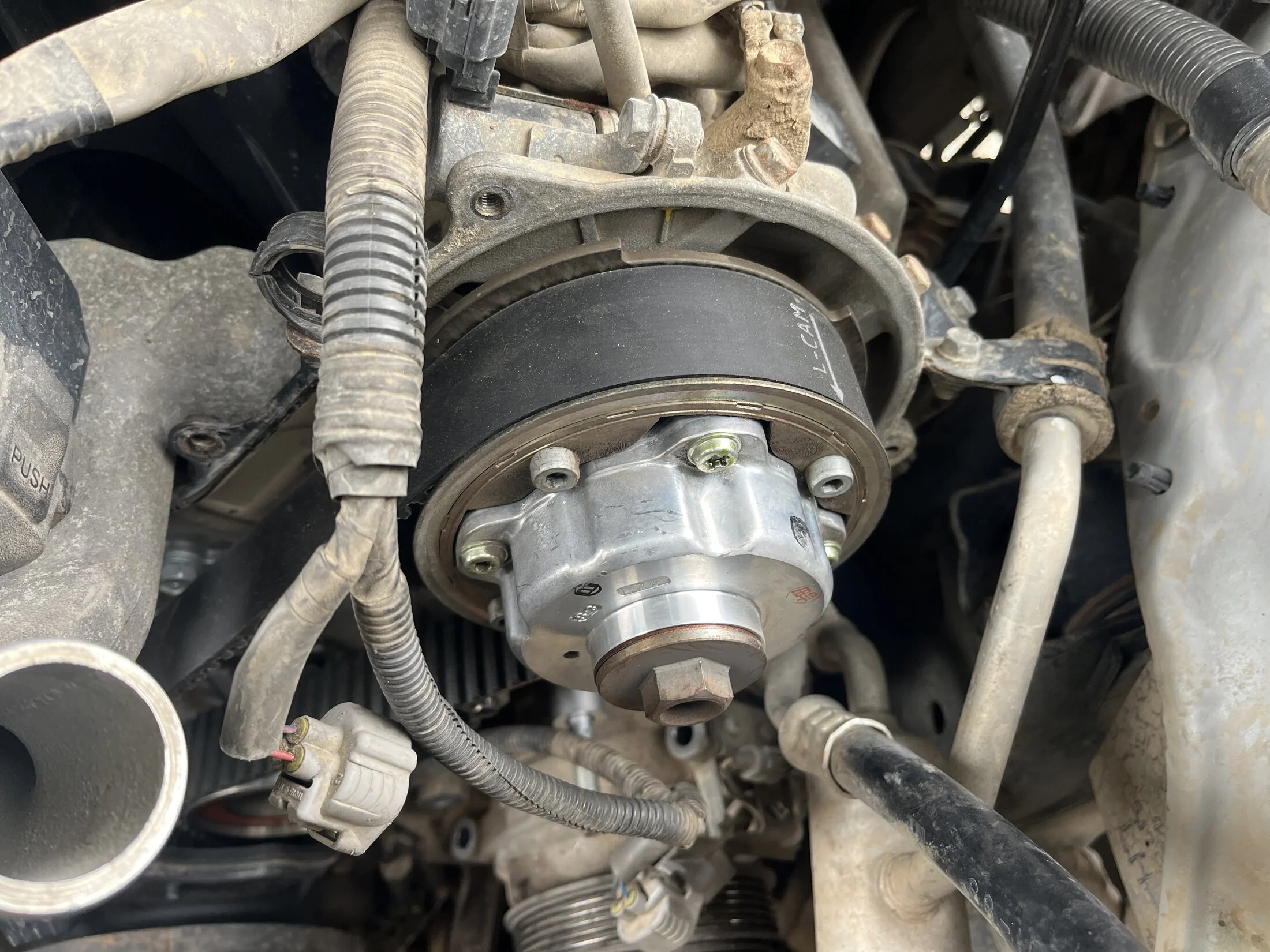

I set: With the camshaft sprocket timing marks, to the "T".

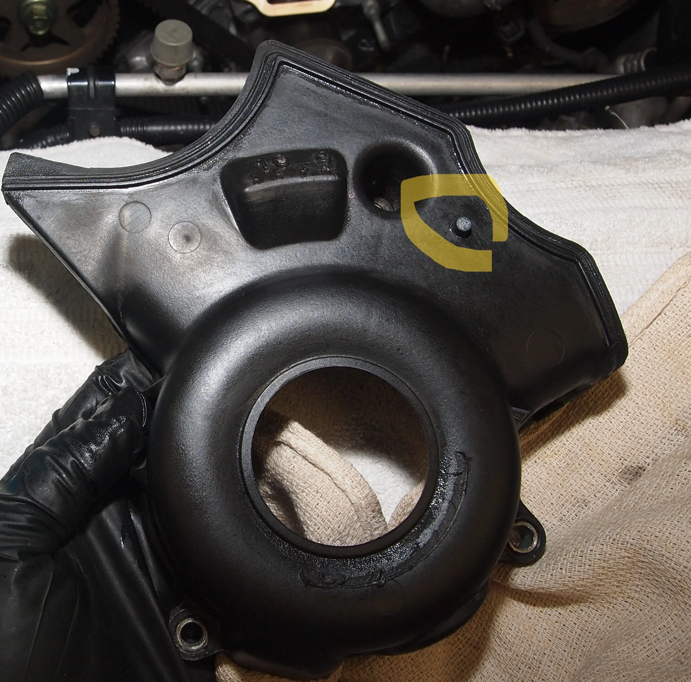

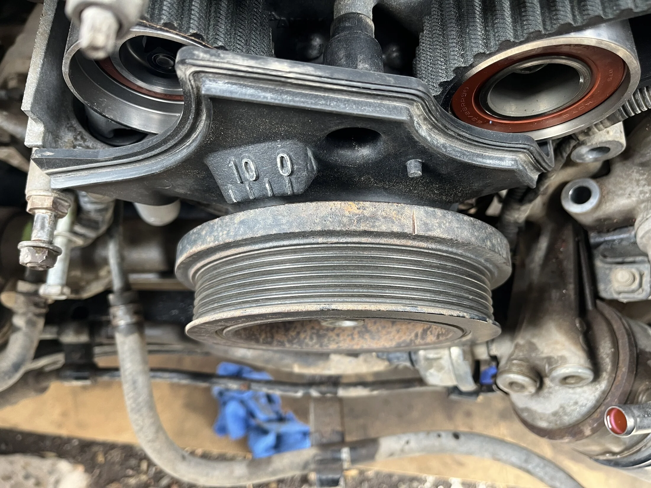

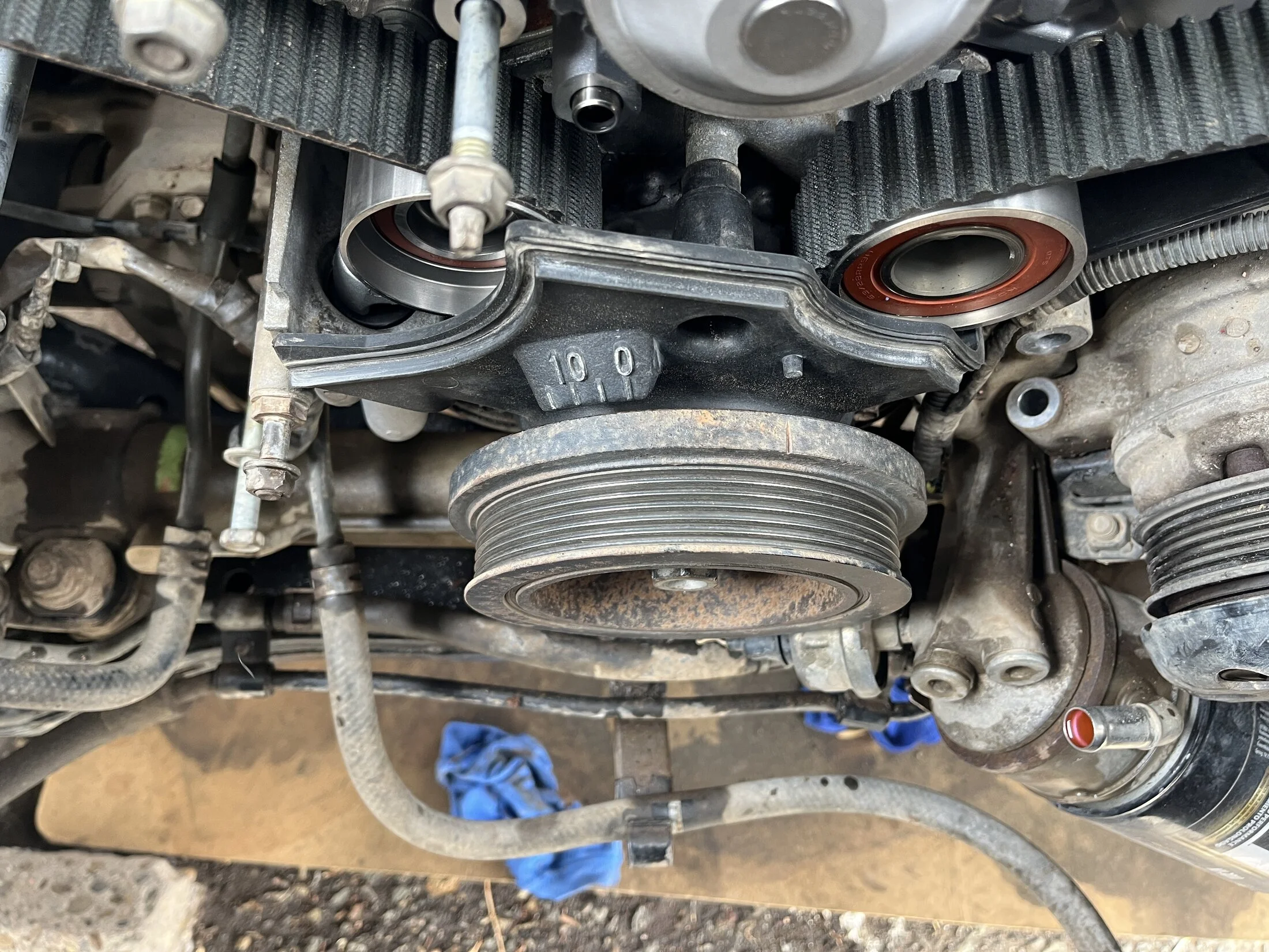

The harmonic balance (crankshaft pulley) zero line (while line). To the nub on timing cover. Which also has the crankshaft sprocket keep, pointing to square on oil pump housing.

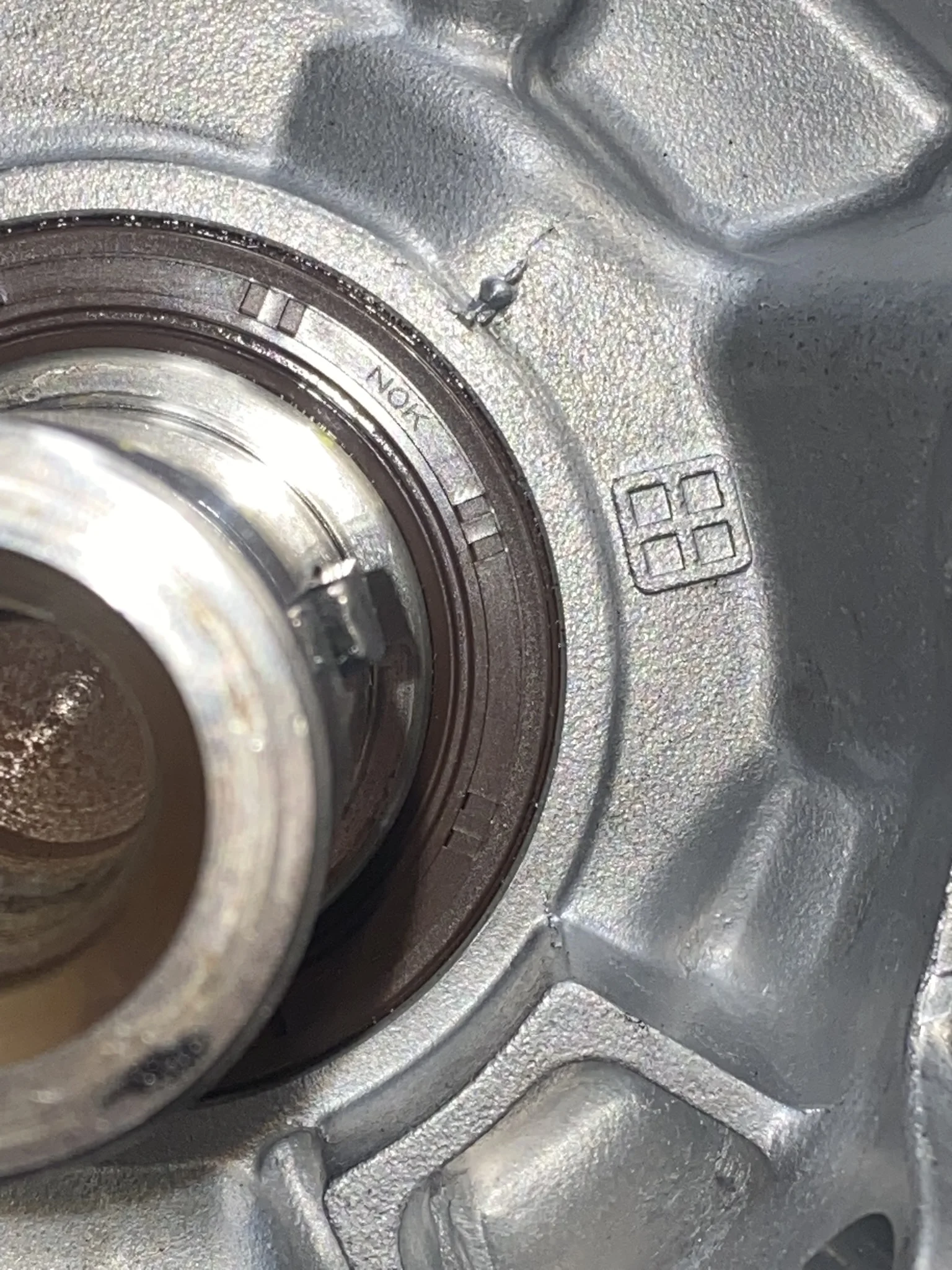

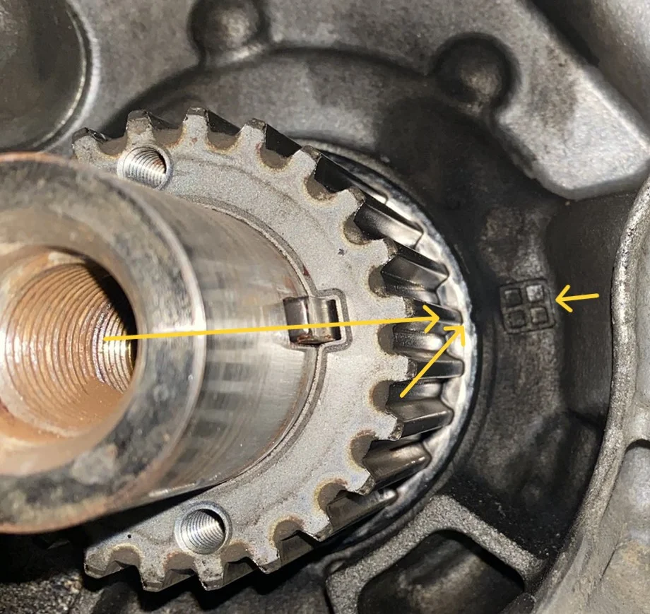

This orients the crankshaft. So that sprocket keep point at square on oil pump housing cover.
Which timing mark (V notch) on CR sprocket, corresponds to CR keep.

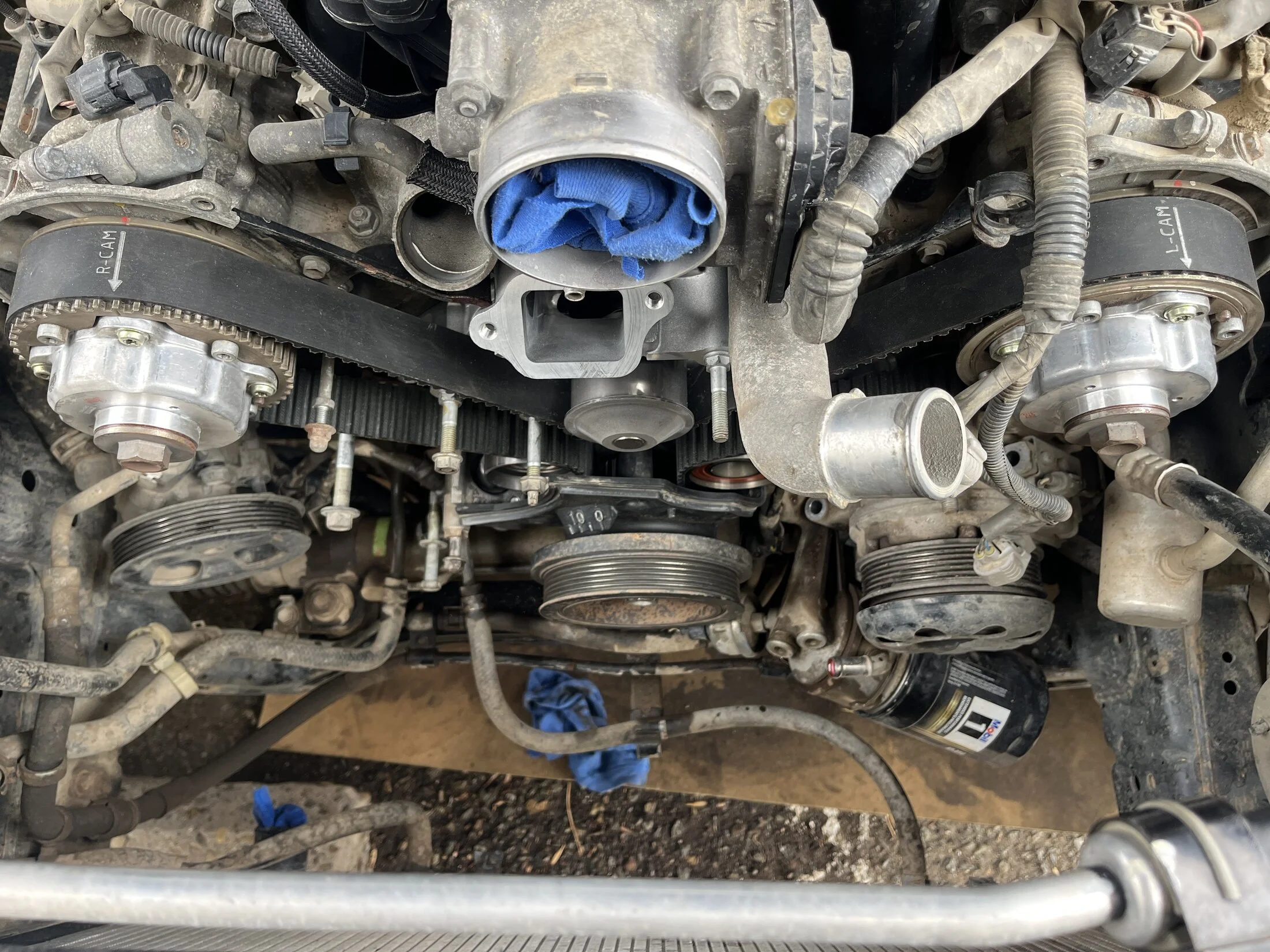

Hey Paul, I'm doing the timing belt on the Unicorn ('07 VVTI) right now and ran into a bit of an issue...
New belt on and the timing marks all lined up. They look just like your pictures above.
I reinstalled the pulley, pulled the pin on the tensioner and rotated the engine a few revolutions and found that the timing was now off. Strange but ok.
So I took it back apart. I put the cams back on the "T" and the crankshaft to zero (white mark on the plastic cover aligned with notch in pulley).
Extra careful this time, I lined the timing marks back up and reinstalled the tensioner.
I rotated the engine until the belt made a full revolution and the crankshaft was not at zero. I had to turn the crank quite a bit further to get the notch to line up with the white mark on the cover.
I turned the engine around for an additional cycle and the timing marks were even further off.
Not sure where I'm going wrong here. This is my 3rd timing belt job and the 2nd VVTI, I didn't have these problems before.
I think I figured out where I went wrong. I should have just made two revolutions of the crank and checked to see if the timing marks on the camshaft gears were lined up. Instead I turned it a lot more and referenced the belt. Lesson learned. It was probably correct to begin with. Oops.
I've spun things around so much that now I need to verify TDC before I go any further. Can I do that easily without removing a valve cover?
The marks on the belt, will NOT line up, once crankshaft turned. We're only concerned with marks on the crankshaft pulley (harmonic balancer) and camshafts.
We spin the crankshaft smaller sprocket, clockwise 720 degrees (2 revolutions). To get the larger camshaft sprockets to turn 360 degrees (1 revolution).
Each 2 revolutions or crankshaft, all sprocket marks will line up again and again. That is timed.

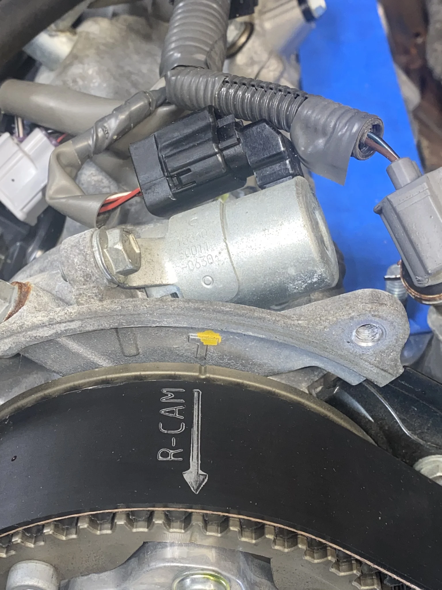

Timing marks:
In other threads, I've said; Time (the 3 marks) camshafts to the straight lines (not the "T"s), with crankshaft sprocket "V" notch to the nipple on the oil pump housing.
In this thread I say camshafts sprockets to"T" to and crankshaft sprocket "V" to the square (white nipple on cover) on oil pump housing.
What's the difference in marks. As fare as timing, none. Provide we don't mix sets. In reality either set of marks, can be use. In either VVT or non 4.7L.
But when we use the straight lines. The camshaft are sitting with some of its lobs, riding high, pushing open some valves. With their spring tension from open valve's spring, pushing against camshaft lobe. If we move the camshaft, just the slightest bit. Spring tension, will then move the camshaft abruptly. This can result in interference. According to Toyota. The 4.7L is an Interference engine.
"Interference; is piston top coming in contact with valves face.
In the 4.7L non VVT, we seen many cases, we didn't interfere. We've many instances of non VVT breaking the T-belt under-load, like passing on HWY. New belt and all is good.
I had a non VVt, out of time case, come to me. Where camshaft sprockets bolt, was not torque down. BK2 sprocket spun, shearing the knock pin. Which knock pin, is the timing pin for camshaft to sprocket. It also pegs, sprocket in fixed position on camshaft. BK2 camshaft spun, to multiple out of time position, in relation to crankshafts. First a little more on each start and engine ran. later no start, just cranked and cranked, over and over again. No interference. Camshaft sprocket was found to be ~180 degrees off time.
The concern with the VVT 4.7. Is, it is an interference (make contact with piston to valve) engine. By using the camshaft to "T"s, and crankshaft to nipple on lower T-belt cover (crankshaft sprocket "V" to square) marks. The Camshaft lobs are not riding on high point. So no valve spring tension on camshafts. So no risk camshafts spin on their own, with just the slightest movement.
Once belt on. We can use other set (3 points) of marks to check timing. We have no risk of interference, with belt on. When timing marks line-up. Provided we don't mix and match time marks.
