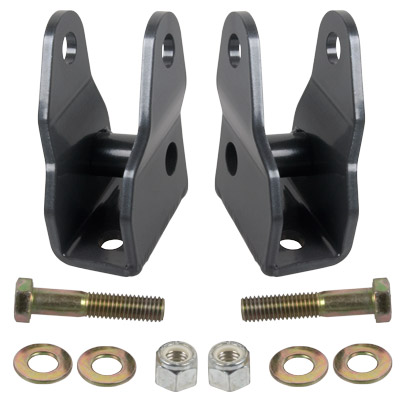

Sweet. If you were able to make a similar mount for the front LCA, which spaced up the shock eyelet by ~25mm, I think it would be WAY easier to install than the shock-top spacers/studs that everyone seems to be using.
Am I missing something here that makes a shock-top spacer better than an LCA/bottom-eyelet spacer? Is it preload that you are looking for? The bottom end would be easier to install, requiring zero modification of the AHC fluid line, studs, etc. If people need to be able to hold more load, then I guess compressing the springs is necessary, but if not a sensor lift and bottom end spacer might do the trick.
Here's a photo of the 100 series solution from Japan 4x4...
image-jpeg.1311628
A similar solution could fit into the "pocket" of the 200 series LCA and extend the mounting point upwards by ~25mm, achieving the same thing as @turbo8 has done at the rear.
Someone school me here ;)

It worked well on the 100 series with the Japan 4x4 spacers without welding required (drilling required, however in the 100 series). The nice part is it should be fairly cheap to fabricate, easy to install, and total reversible. I could envision a fairly simple billet aluminum or steel design working. The key would be making a very tight fit, and fastening it into the shock "pocket" of the LCA. A strong secondary fastener would be ideal to prevent any play. Certainly welding would be another option here, but less easily reversed in the event that someone wants to go back to stock.
There are definitely a few ways to skin this cat, however: The top spacing, a "spacer" on the bottom, or possibly LX600 shock replacement...still waiting on a guinea-pig/hero for that last one!
something like this could be fabricated to fit without calling in the rocket-scientists.
It worked well on the 100 series with the Japan 4x4 spacers without welding required (drilling required, however in the 100 series). The nice part is it should be fairly cheap to fabricate, easy to install, and total reversible. I could envision a fairly simple billet aluminum or steel design working. The key would be making a very tight fit, and fastening it into the shock "pocket" of the LCA. A strong secondary fastener would be idea to prevent any play. Certainly welding would be another option here, but less easily reversed in the event that someone wants to go back to stock.

A bolt in thingy like the one pictured in #352 looks like it would be impossible to limit to 20mm, that looks like a full 2" offset or more, which would be way too big. I was thinking of just re-fabbing the mounting tabs on my lower a arms. Or perhaps even easier, welding a 20mm sleeved extension to the lower part of the shock.
