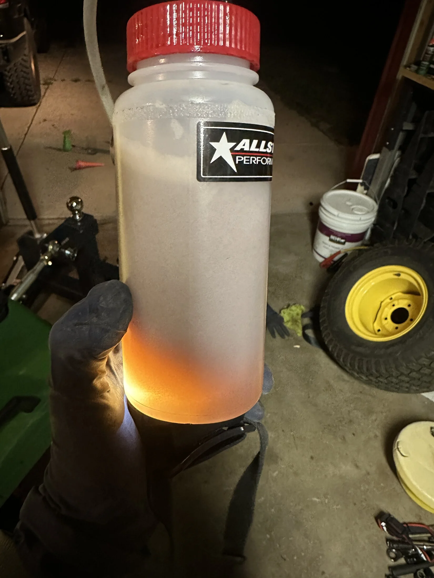

My LX had a major brake issue more than a month ago and had to sit until I could start working on it the other day because I have a million projects and another car to drive in the meantime. Well I have fixed the brake issue and actually upgraded to 35s at the same time. When I got the new wheel/tire setup on I was surprised to see it appeared the truck was in Low setting. I hadn’t put it there, something made it sink. That was strange. Then I turned on the vehicle and noticed the AHC pump was running really loud compared to how it usually sounds.
I replaced the AHC fluid and all globes in October of 2024 and bled everything well but I wondered if maybe some trapped air had gotten somewhere it shouldn’t while the truck was sitting. I opened the access door to the fluid reservoir and it was slightly below the line in between min and max. Realizing it was a little low, I decided to add some more fluid and do another bleed. I add some fluid, then drive around for a little bit. Then I start with the 5th accumulator. I put the bleeder tub on the drain bolt, break it open and am surprised to hear stuff coming out, but the tube appears empty. So I’m like holy crap there was a TON of air. I open the drain bolt a little more to see if it will speed it up and give me a little fluid too. Eventually some fluid starts to come out but it actually starts to leak out from around the threads. I wonder what the issue could be, so I close the bleeder, look down and my bleeder reservoir is COMPLETELY FULL of what looks like chocolate milk.

Photos attached, the one with the bottle I’m holding my headlamp behind it to backlight a little.
are you sure that’s water? What does the viscosity feel like in your hands? Looks like your fluid is full of small bubbles.
I’d put some aside and add water to it to see if there is visible separation.
It’s a pressurized system. Unless you left the top off the reservoir or it was not secure, I don’t see how water to enter.
I bled until I got to clean fluid last night and ended up dumping that in the same waste bucket with the milky fluid last night. When I dip my hand in it it doesn’t feel like like what I would expect from pure AHC fluid.
I took the last bit of unused AHC fluid and mixed it about 50/50 with some water. When I swirled it around the result was a chocolate milky looking substance similar to what I extracted last night only less dirty looking.
I can’t imagine how water could have got in either but clearly something isn’t right regardless. No reason for the truck to have settled down into L on its own, for the pump to be acting up and for extracted fluid to look that way. I’ve seen dirty AHC fluid many times and when really bad it can be almost black but I’ve never seen it brown, cloudy and milky. This is similar to what engine oil looks like when contaminated and ran with water.
