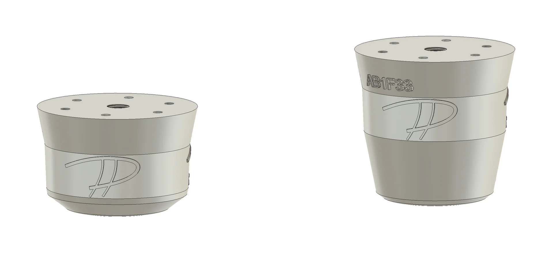

Hey Folks, I've been working with @grinchy to build a bumpstop for the LC200 with AHC and LT.
We have designs for front & rear with and without LT ready to roll - and we're looking for product testers.
Offering 20% off if you're interested in trying these out and giving us feedback on fitment and feel. Use code PERRYTESTER at checkout.
All of our bumpstops have our built-in compression damping and progressive spring rate, and we price them at what we'd be willing to pay. You can outfit a full vehicle with our bumps for ~$200.

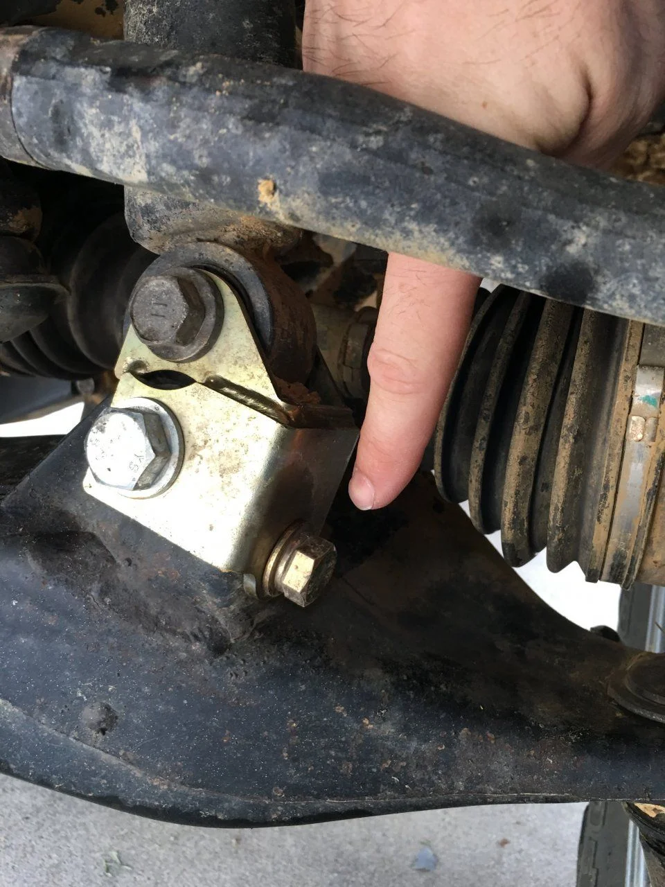

Sweet. If you were able to make a similar mount for the front LCA, which spaced up the shock eyelet by ~25mm, I think it would be WAY easier to install than the shock-top spacers/studs that everyone seems to be using.
Am I missing something here that makes a shock-top spacer better than an LCA/bottom-eyelet spacer? Is it preload that you are looking for? The bottom end would be easier to install, requiring zero modification of the AHC fluid line, studs, etc. If people need to be able to hold more load, then I guess compressing the springs is necessary, but if not a sensor lift and bottom end spacer might do the trick.
Here's a photo of the 100 series solution from Japan 4x4...
image-jpeg.1311628
A similar solution could fit into the "pocket" of the 200 series LCA and extend the mounting point upwards by ~25mm, achieving the same thing as @turbo8 has done at the rear.
Someone school me here ;)

Nothing wrong with your thinking except that the top spacer solution sees no shear forces, only compression and is "safer". Unlike the lower eyelet seat extension which is more susceptible to shear and torquing, as well as potential geometry changes. The top bucket spacers are just sat in there and stationary, whereas that solution is in a component joint that is made to move and does see twist and torque forces during use.
But yes, esxeentially it is more easy to add stroke that way. I personally did not want to mess with that.
