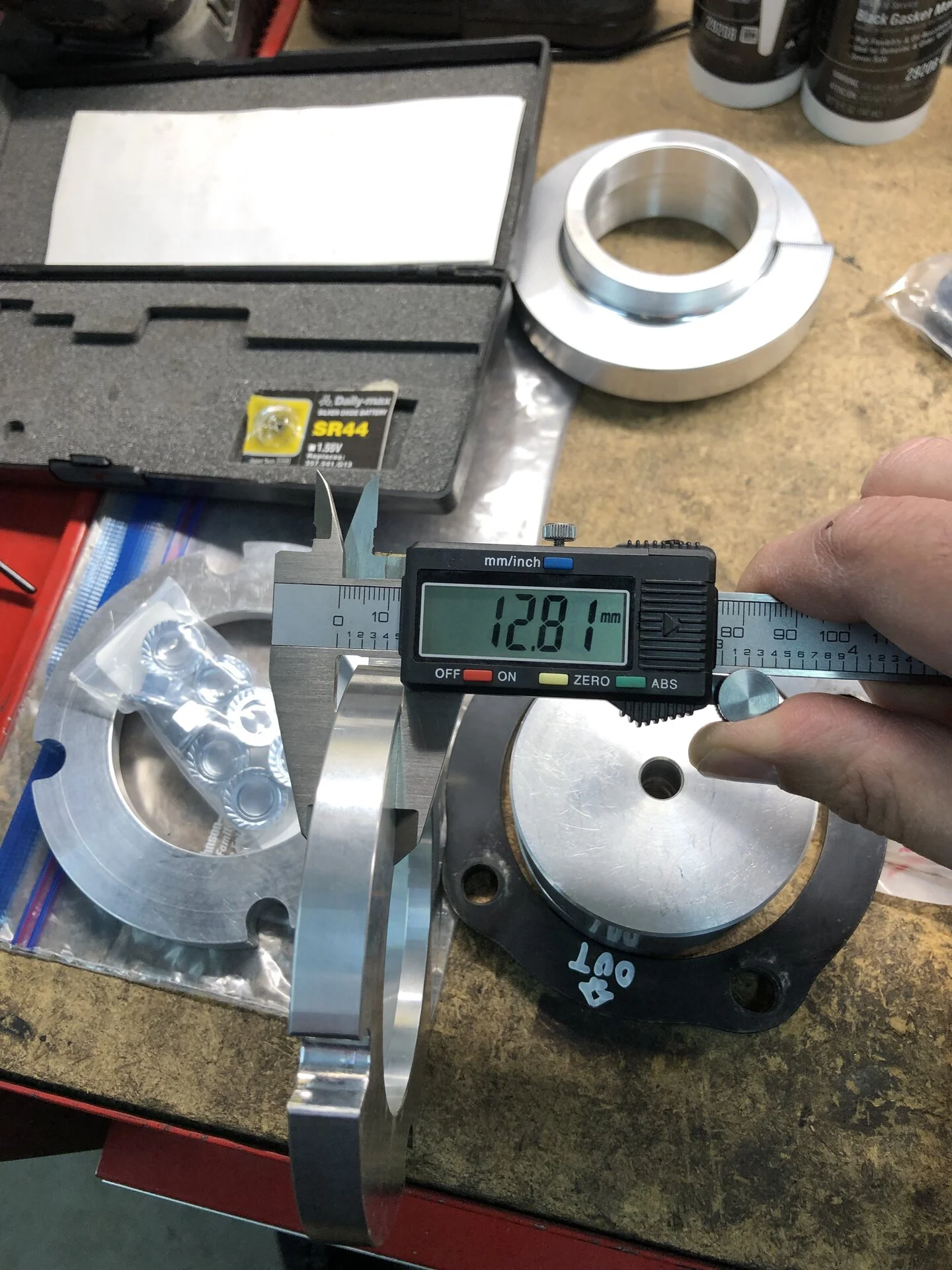

I know it’s not as tall as you want but the Westcott spacer is 12.8” thick…
and in my mind, this is the thickest spacer that you can use factory studs with. Barely.

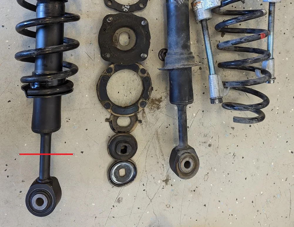

Part of me thinks that if I had to do this again, I may have just cut the lower shock standoff to extend and sleeve it. With a welder, that job would not be too bad.
Filling that root and keeping it from warping even a smidge without a jig seems like a nightmare though
Maybe I'm not describing it well, but with a sleeve that has the right inner diameter, a fixture wouldn't really be needed. Yes, would need a bit more standoff particularly at the reservoir part of the shock, and there's ways to minimize heat input. Can get even fancier with a pulse TIG.

I can, looks like you want a 17mm thick spacer?
If 12.8mm is as thick as you can go without requiring longer studs.
To use delrin you would have to use longer studs if going to a 17mm thick spacer.
I have a feeling no one wants to press in new studs and want a bolt on solution.
Will stock studs stick out any when a 17mm spacer is put on top? If they do, would cutting/grinding the studs down enough to clear the top of the coil bucket be acceptable?
