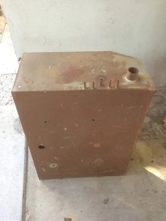

I found this one today. The seller claims its for an FJ60 but I'm gonna check it out. It looks homemade to me, not a long ranger or any other manufacturer. Any thoughts on it? I'm trying to figure out the holes the side. Also, where the heck would the sending unit be installed?

It looks similar to a Man-A-Fre tank, or maybe is? The ports on the side are the various vent line connections to connect to a stock 60's tank, so it looks like an easy swap.
IMHO, how can you go wrong for $200, unless it's damaged or rusted out?

It looks similar. I see a few differences though as its missing the tabs on the side to mount it as well as it may be missing the sending unit hole. I'm going to try to get together with the seller this weekend.
^^^ See if it is baffled inside as well. That is important I think.
