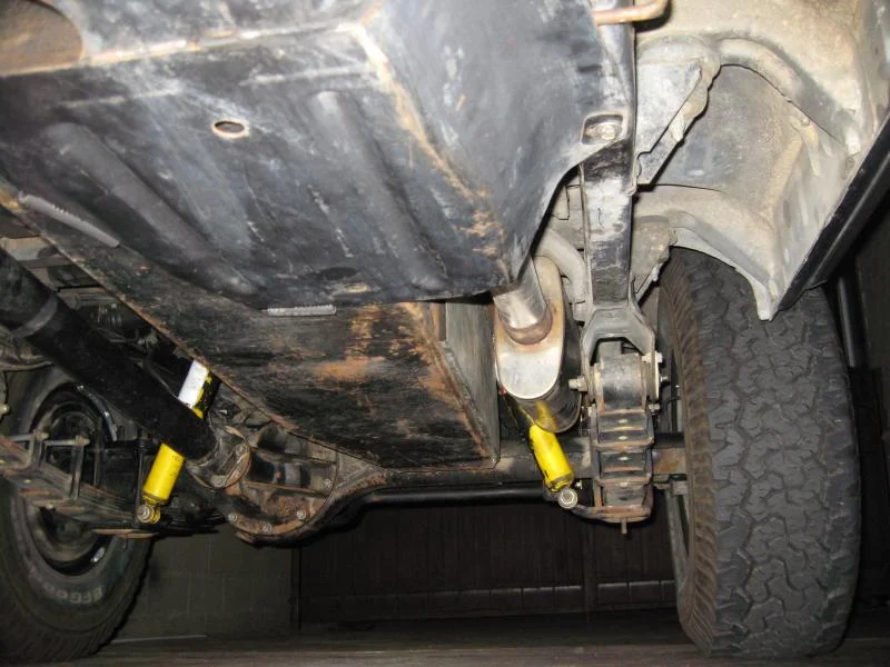

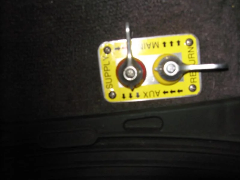

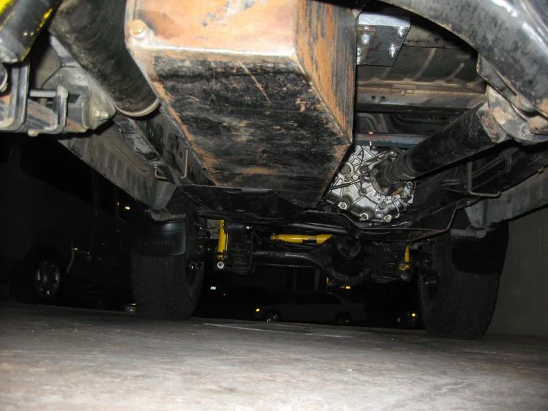

Here a couple of pictures.
I say take it to a tank guy n have them tell yah / or weld four tabs on your tank.
I would not use straps on a tank that big n with sharp corners like the MANAFRE tank has...
I got a 46 gal tank build for half of what maf wants... and it actually fitted the first time I installed it...

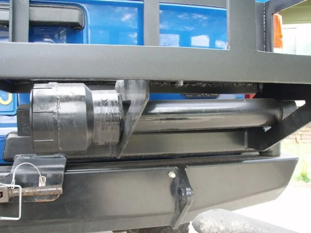

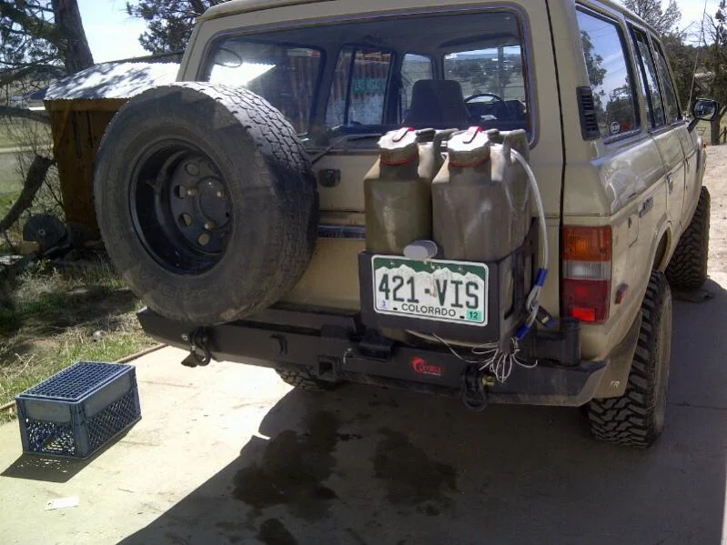

you know...... you could make that a 3 can basket....
n mount a spout carrier under that basket made out of abs pipe..
attachment.php
Actually I have one of the old tray-type carriers I was thinking about bolting on the left side of the exisiting, should I need to carry ten gallons of gas and five of water or fifteen gallons of gas. I like the spout Idea. Might build me a carrier thingie. The Hi-lift will go in the right if it doesn't block the tailight.
