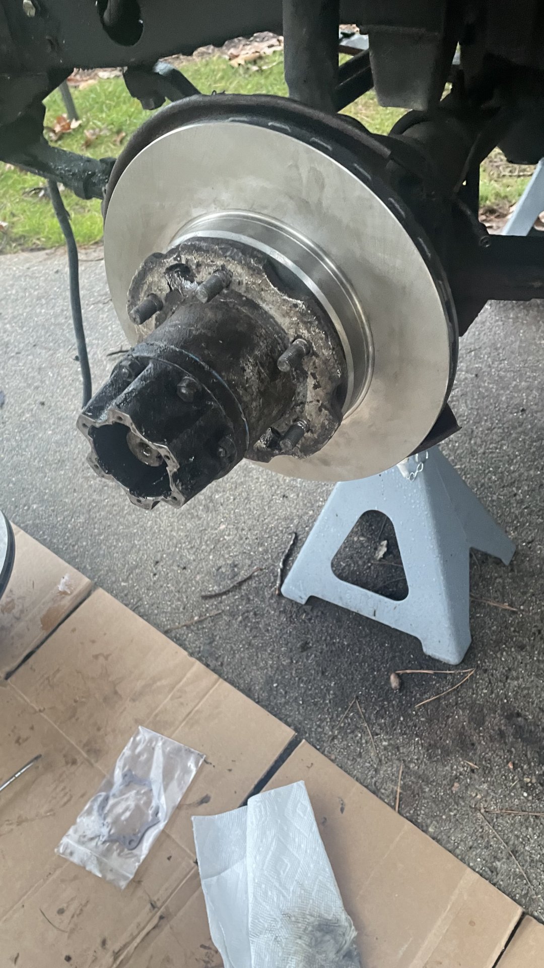

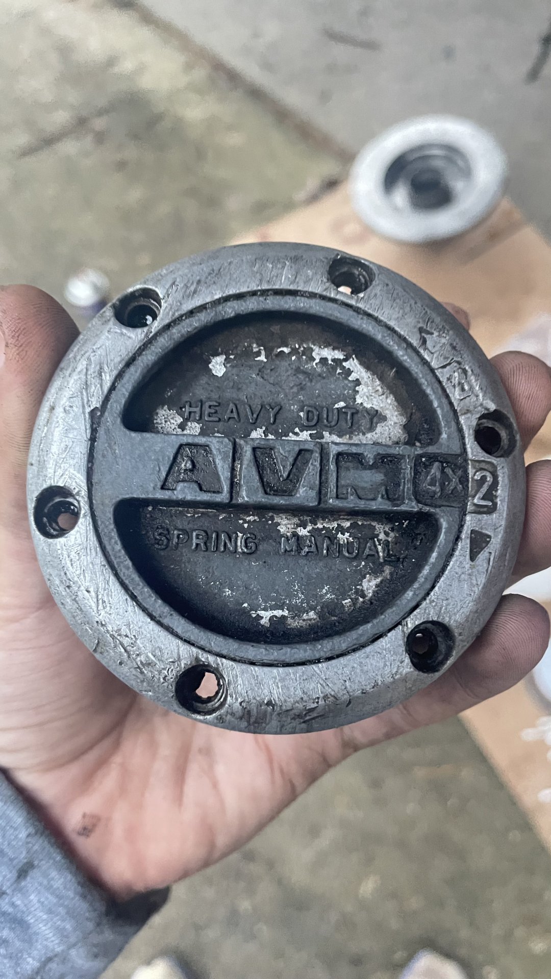

So I got everything lined up, had someone experienced come and help me through the process, and I finally got to the point of just putting the locking hub on, and my hub locker won’t spin. I saw another thread that had a similar issue, but in that one, the axle was hard to spin when an 8mm bolt was run through it. My axle spins fine and has no issue. I’m stumped. What could be happening?
Does it work when removed from the axle?
No. I don’t know why, but it only works when it is bolted up. The other side I just bolted it up to a hub, and it spins like that, but not when it is unbolted. Not sure why
Are the guts lined up properly, and lubed?
Yeah. I’ll take some pictures when I get home. I put a light layer of grease in the parts that are supposed to move, and on the teeth. These pictures are from the gasket issue. That is resolved.
Can you turn the dial when it's not installed?
Sounds like a great science project.
Turns out the most trivial issues have the simplest fixes. For the life of me, I couldn’t figure out the part that was failing, so I just sprayed the part with a ton of WD40, and turned it with vice grips, and it’s like I broke a seal, because now it spins perfectly fine. Thank goodness it wasn’t something bigger, because I did not want to take my knuckle or hub back off again.

I ran into a similar situation after rebuilding a set of Asco hubs. Turned out the replacement O-ring was the offending piece of kit.
Did you toss the old O-rings? If not try a comparison with the new. Like @middlecalf alluded to^^^ you may want to take it apart again just to check it after the vice grip coercion...

Break may be the key word here. It will now rotate, but does it engage? If your lockout turns so hard you need vice grips to crank on it you need to back up a step or two and investigate why
Go over to YouTube and watch “Free Wheeling Hubs - Land Rover Restoration Part 9”.
This vid covers your AVM vintage hub. Assembly/ disassembly/ restoration. About 10 minutes long.
I did my best to clean it, got most of it shiny, put some grease on it, but I didn’t take the hub locker apart like the video. Earlier, I put the caliper on, and it was rubbing against the rotor, not sure why it’s doing that, so I’m probably going to have to take it all apart anyway, and I’ll clean it more then, and probably be more surgical with it. I suspect a possible thing is that the bearing seal may not be completely in, and it is making the rotor stick out slightly, but I am not quite sure yet. I’ll take it all back apart tomorrow and buy some primer and paint to repaint it all after I am done stripping it and stuff.
The part works correctly, and spins by hand, but I initially had to spray WD40 and use vice grips to get it started the first time. It is no problem to spin by hand now.
