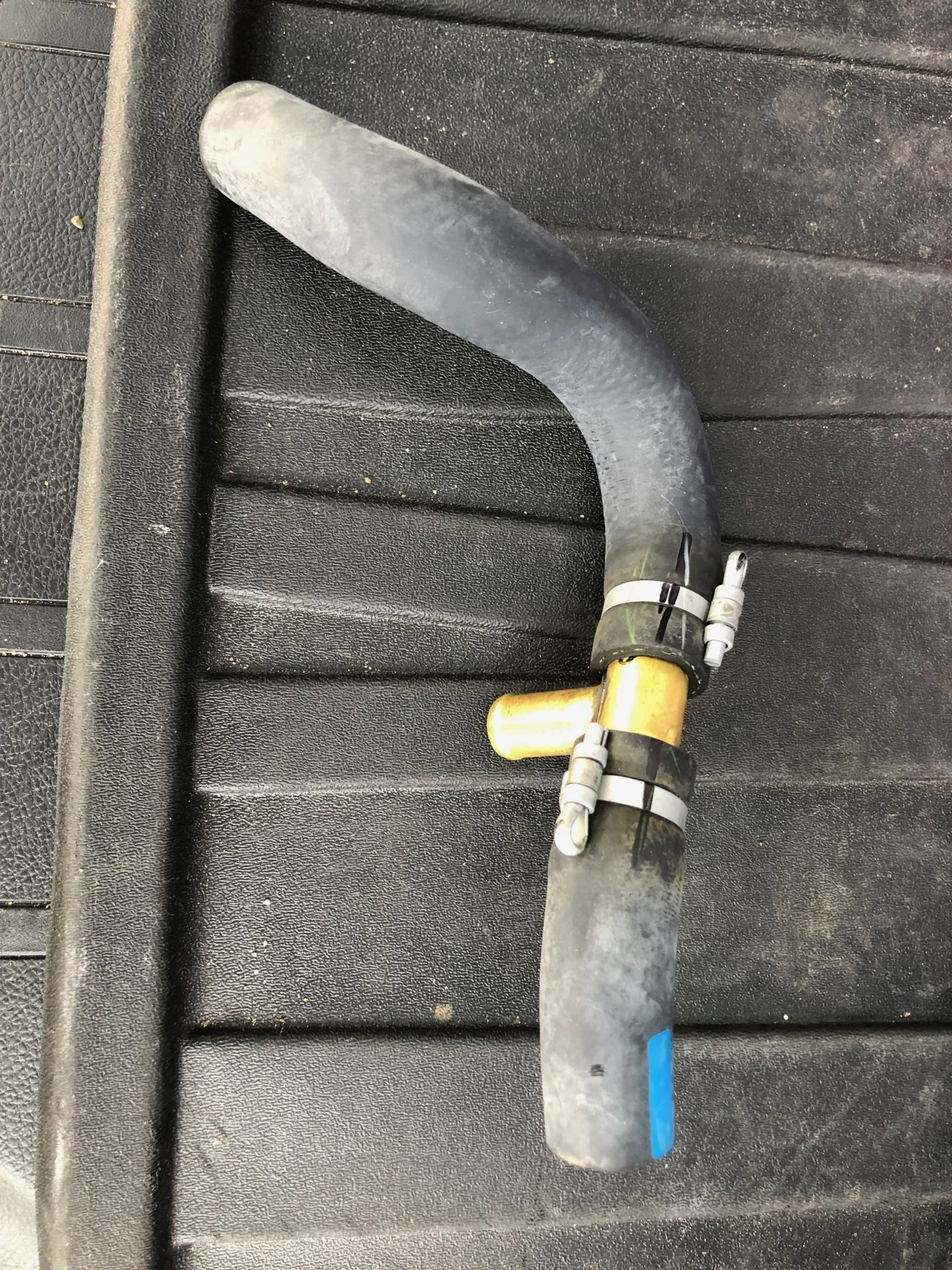

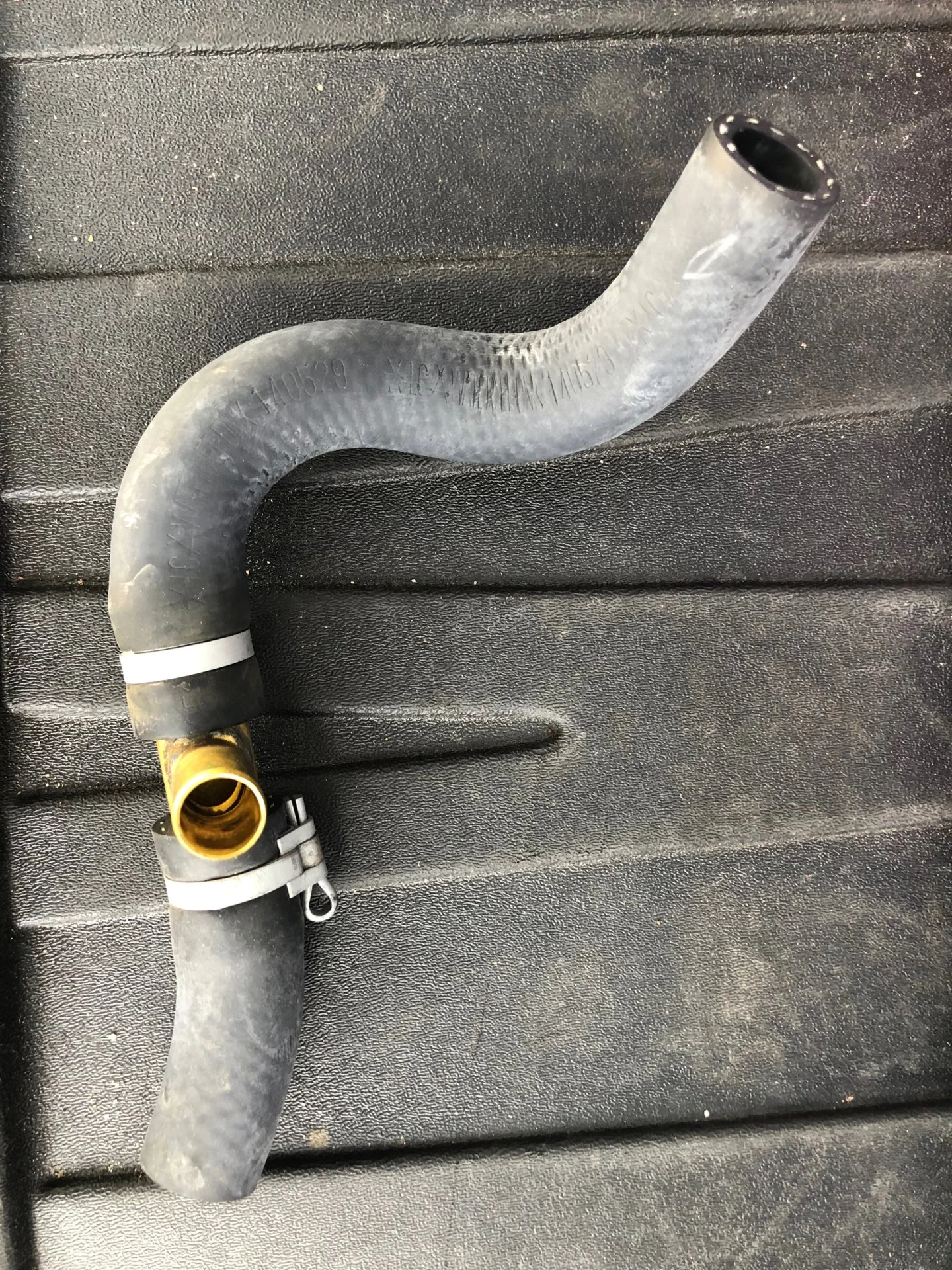

If you buy the entire 80 series heater hose assembly, it should come with the brass T.... or at least it did 6 months ago.
87209-60290
Buying the 80 hose kit is the way too expensive way to go- but I was throwing so much money at my '05 LX the first two months, that is the route I took along with new hoses and clamps.

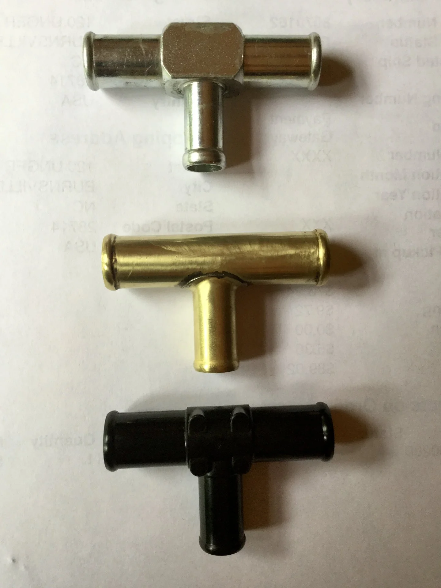

Here are the three choices I considered.

it’s not expensive for an 80 owner (OP) as the entire assembly is used. The 100 owner would bastardize it just for the Tee.
I actually have one of those assemblies with the brass T packed away in the parts stash but then had recently gotten a bunch of unused heater hoses separately from someone selling his NOS parts after he got rid of his 80.
Then considered using the plastic T (and saving the assembly for the future) partly because the brass T does corrode and turns green, but AFAIK they rarely actually fail. Then remembered how the plastic heat control valve in an 80 series distintegrates with age causing the side pipes/nipples to burst without warning, so figured the plastic T would likely age the same.
But wanted to get some actual use data from over here in the 100 forum to see if anyone knew how long the plastic T's actually did last. As discussed above it was confirmed that yes, they do crumble with age just like anything else made of plastic and exposed to hot coolant.
So there you have it.
I went ahead and cleaned and sanded the old brass T then painted it with a 2k Epoxy primer and paint. That should decrease future corrosion to some extent and I won't have to worry about it failing catastrophically like the plastic T.

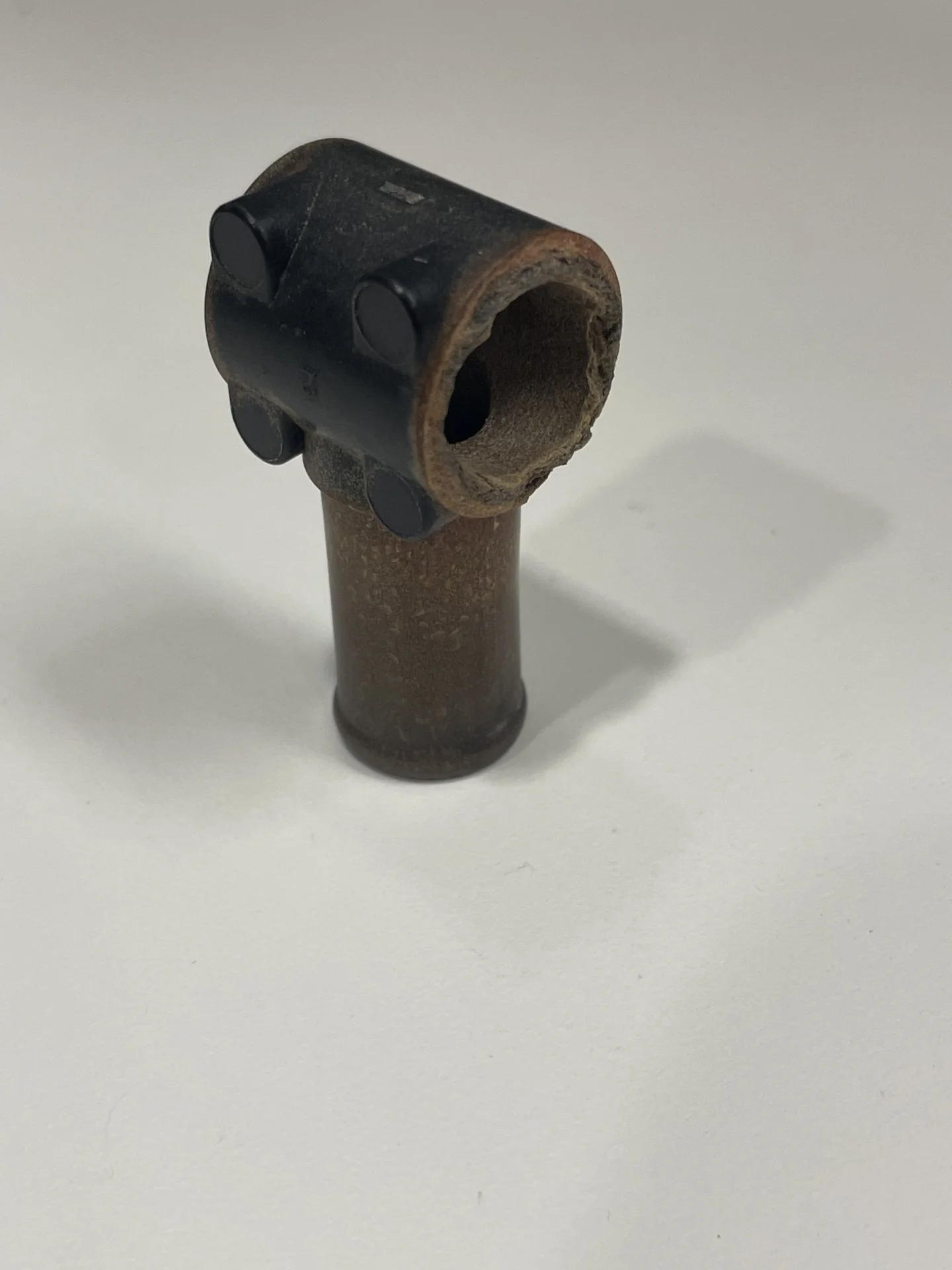

My tees ended up turning into a crunchy wax-like consistency. I wish I would have replaced them when I swapped the radiator earlier in the year. Had I done that I’d have saved the cost of replacing radiator fluid I.e. hassle.
Opted to flush the system of the broken bits that got loose.
Went with OEM Toyota parts as the original appear to have 230k on them.
